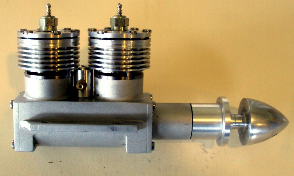

      That runs very sweetly as do your other engines. Is it from plans or your own design?
      J
      #102478

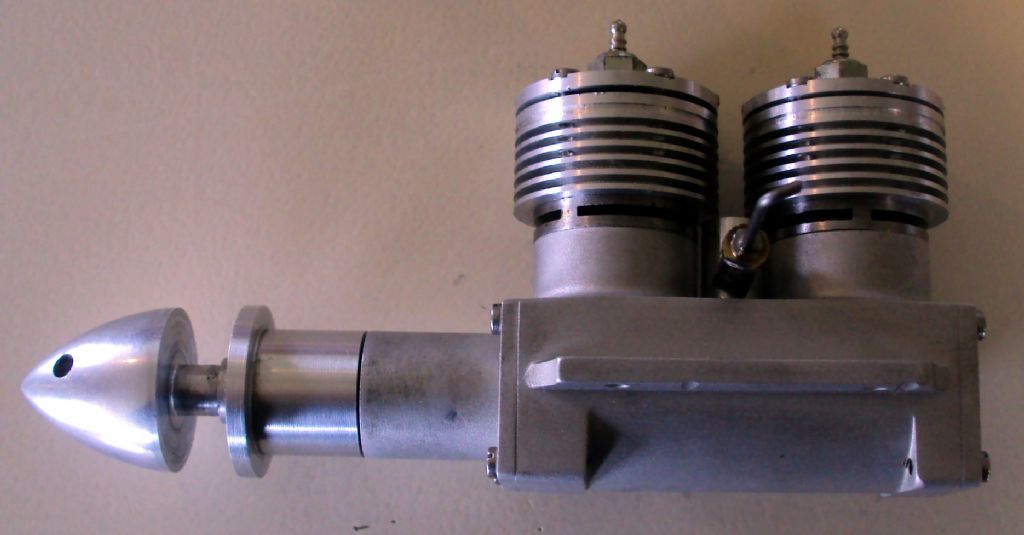

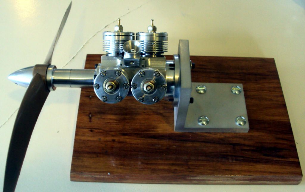

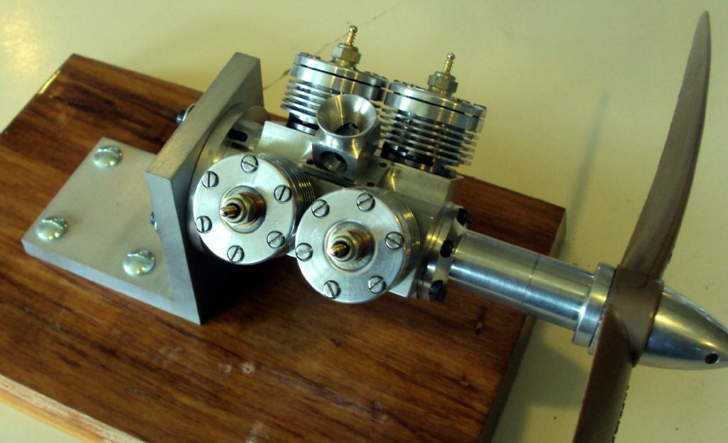

      dean clarke 2
        @deanclarke2
        thanks for the good comments, all the engines are my own design, the twin on here was my very first engine build, i cheated a little with this engine as i have used proprietry cylinder liners, 1 with a piston but the other i had to fit another original piston to it, lapped it in but otherwise i made all other parts except bolts and glo plugs. the engine runs not to bad for a first timer but i think my eyeometer was out a little on the intake port timing but never mind it still runs well. the v4 was my third engine and the first v4 i made. again propietry liners were used but this time i lapped the liners and made new piston etc for them. the crank is a 1 piece affair with the conrods split on the big end. crank is 4140 ht steel and rods are 2024 t6 alloy. be bolts are ht 00/80 cap bolts cast iron pistons with all other alloy parts from 6061 t651. after seeing ramonds mlling out the cases from solid i gave that a go with the 2nd inline twin. will upload the rest of my engines today. the v8 is the first engine i have done where i have made the liners as well.
        thanks
        dean
        p.s. all engines are made useing manual machines and scribbled scetches with a few dimensions no plans as such

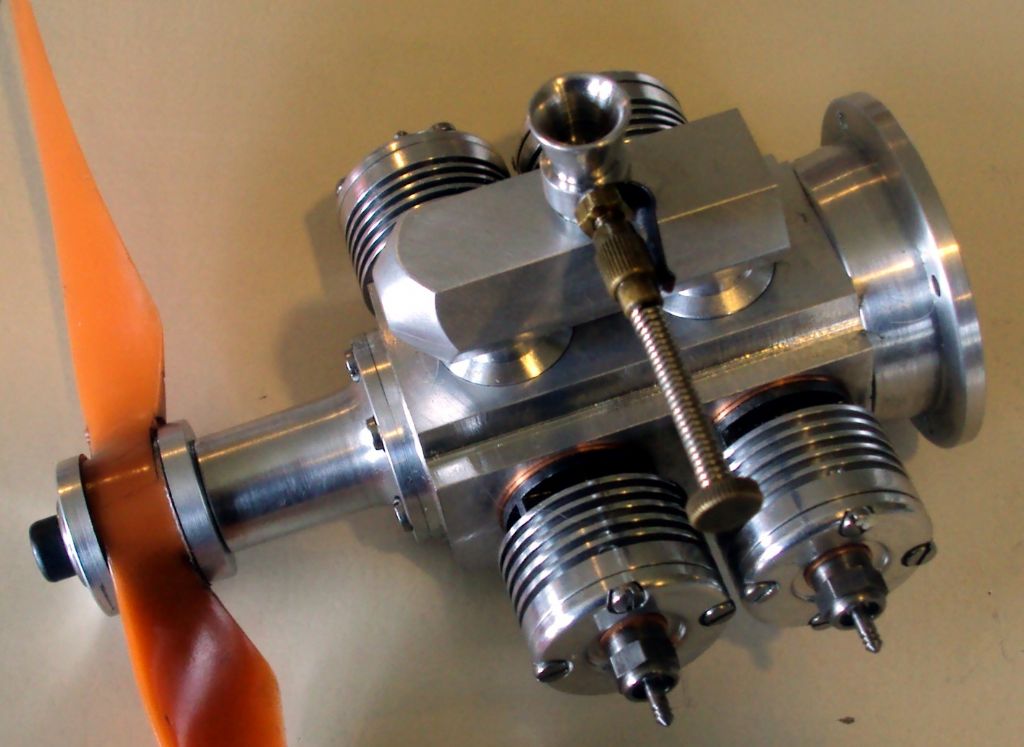

        #102491

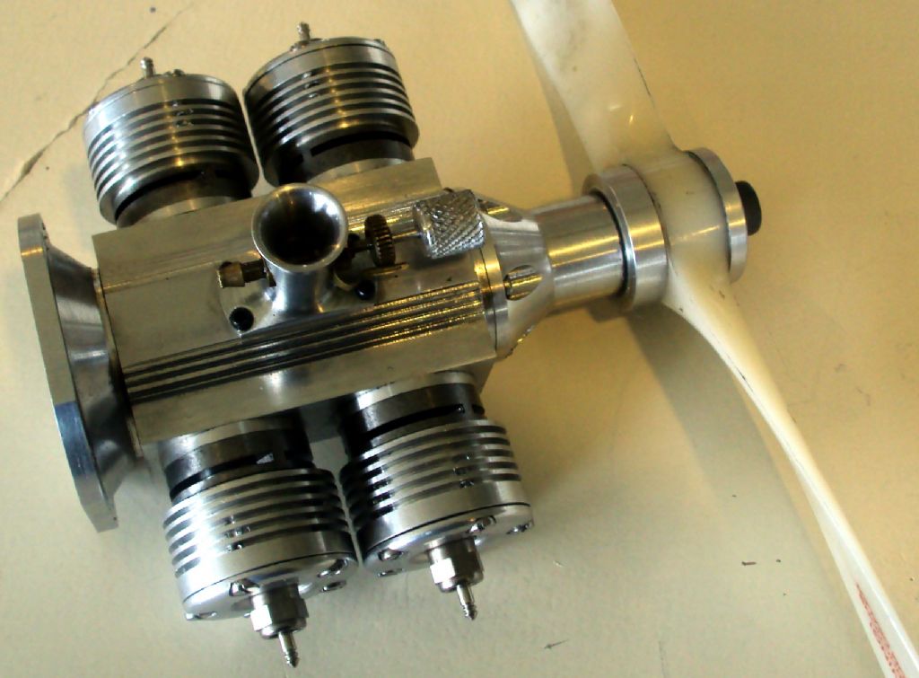

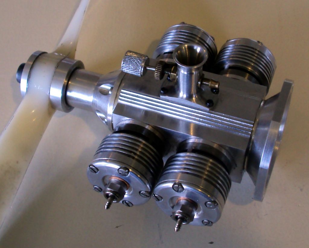

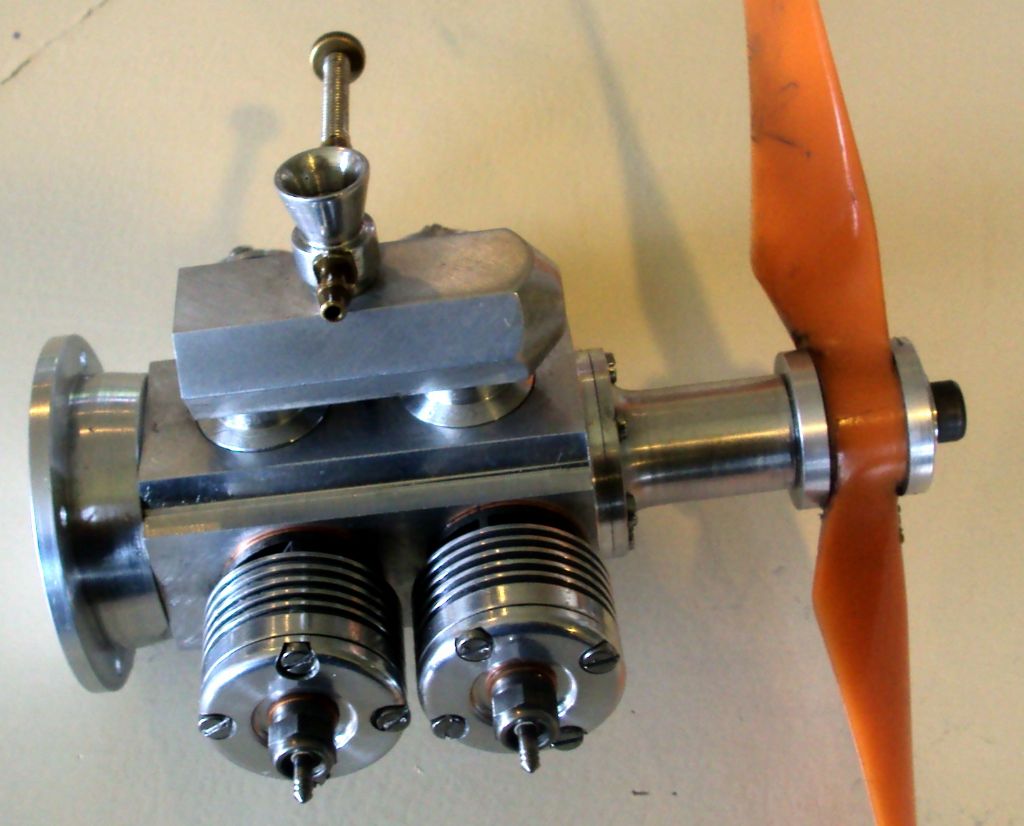

        dean clarke 2
          @deanclarke2
          2nd eng b.jpghere's a few more of my engines, hope you enjoy.
          Dean

            Utterly and completely brilliant work
            Bob.

              Nice!
              The inline twin is a lot like the Taplin Twin.

                  hi guys, just wondering if anyone has come across multi cylinder glo engines not running when the plugs are turned off? any ideas on a cause? my v8 just doesn't want to keep running without power to the plugs. runs perfectly when they are connected.
                  dean
                  Edited By dean clarke 2 on 27/01/2013 06:32:35
                  #110178
                    Probably plugs not getting hot enough which is likely due to the slower reving nature of your engine.
                    There are different temperature plugs available but not something I know enough about, have a look back through my Firefly thread as I think Ramon explains it there.
                    **LINK**
                    J
                    #110180
                    Roderick Jenkins
                      @roderickjenkins93242
                      I'm sure Jason's got it right, although it's probably cooling down that's causing the problem. The "explosian" during the ignition cycle re-heats the glow coil. With 8 cylinders the plug has to wait 8 times as long as a single would for the next heat input and so has probably cooled down to a temperature that won't inititiate the burn. I'm afraid I don't know whether a hot plug equates to a long dwell.
