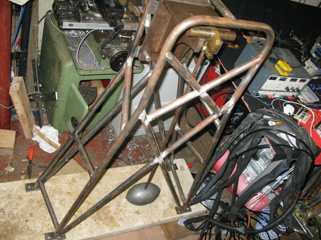

                                        18 years ago, i read Accurate Clock Pendulums , published 2004 after listening to a R4 book review, of course.
                                        Shortt are out of my price range, Enthused I made an oak 2 part mould for a bi-linear bob cast in type metal also from Keighley 11Kg bob, split the mould, not enough weight and got it cast at metcalfes in Keighley. Bought quartz pendulums 2 , ground a recess in each end to hold a split washer. everything made from ironless aluminium bronze. 3/4 inch steel pendulum head platform with dual single piece suspension springs
                                        I cracked the first pendulum attaching the bob , the spare was broken in a move.
                                        2021 got a JD2 tube bender for another project and ended up building a frame for the top pivot , Ive got a steel pendulum rod as a place keeper, .
                                        Q 100K ~ 300K , thats what I measured i16 ? years ago with the top assembly bolted to a cellar wall
                                        Just seen this thread , thanks for posting. I will read it all tomorrow. .

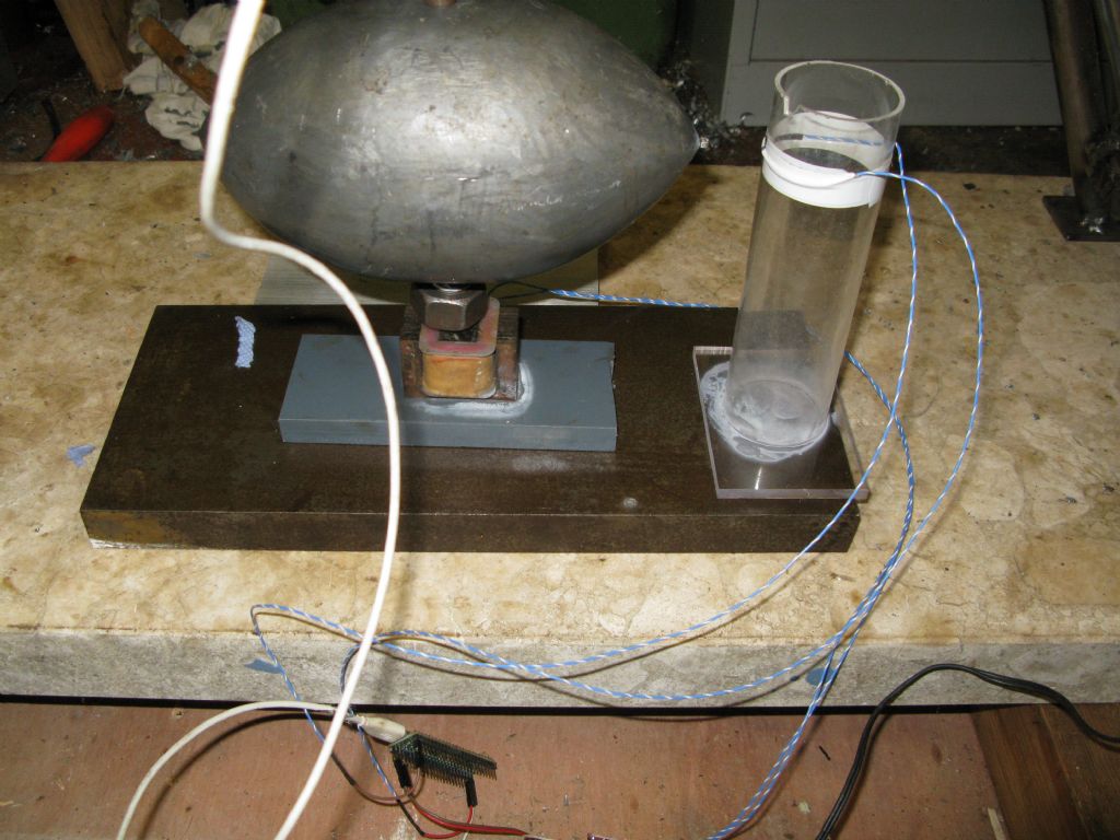

                                        I'll post some pics , looks like we have a common appreciation of something that is (almost)? undefinable. Time

                                          So I put my pendulum together with a electromagnet, teensy 4.1 . a reed relay with a magnet on the bob to time the fet coil power from 12V . It went so well the pendulum smashed into the glass reed relay and smashed it,reed switch self destructiontube steel frame
