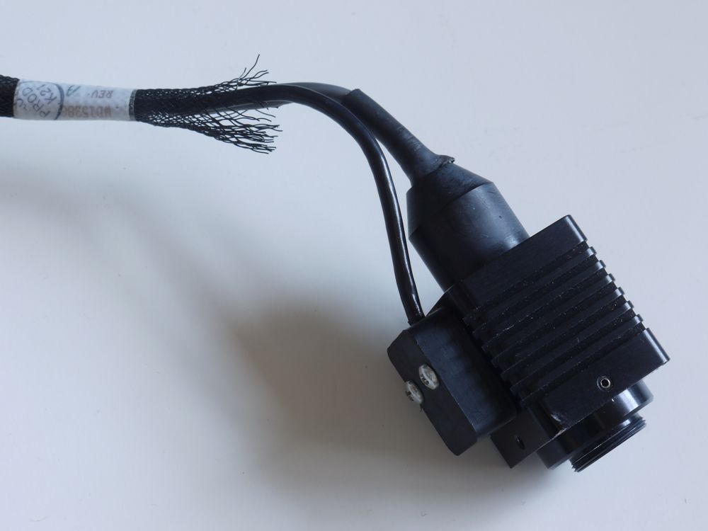

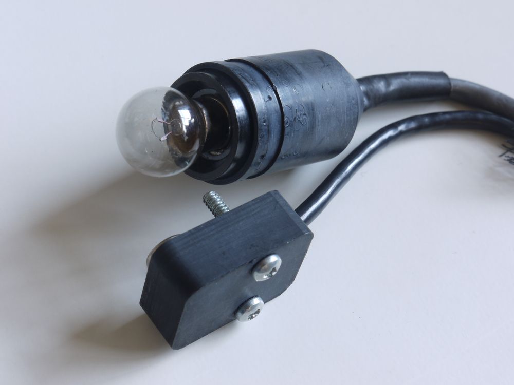

        O.K. … Just to put this nonsense to bed.

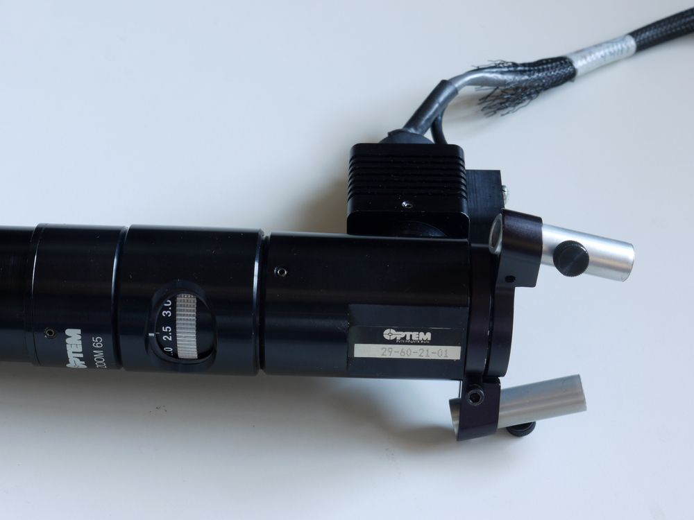

        1. General view of the business end; including the two lens attachments for off-axis fibre-optic lighting.

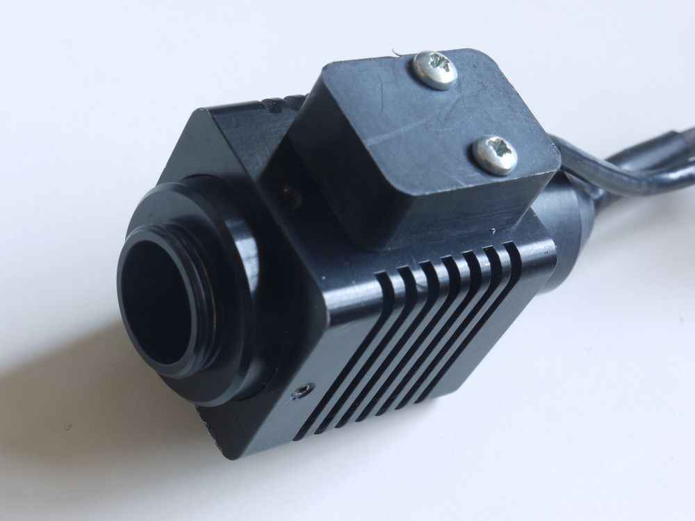

        2. The lamphouse for axial incident illumination.
        3.

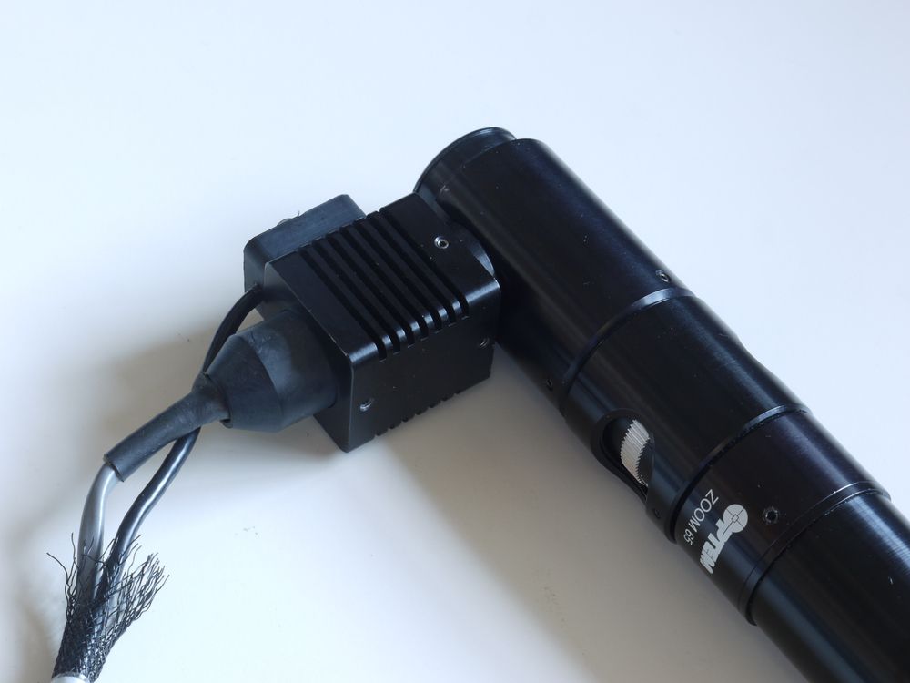

        4. Showing the resin block

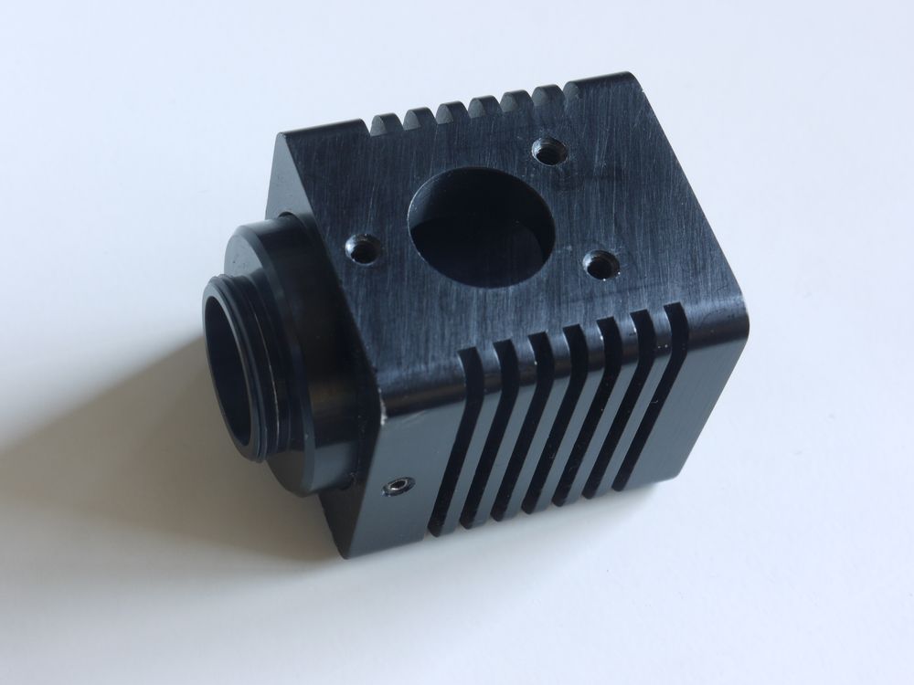

        5. Photocell port.
        6. Lamp, and photocell block
        7.

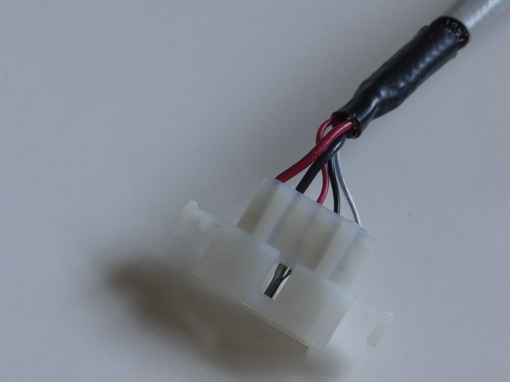

        8. Cable connector.
        It now seems most likely that the transparent-sheath wire connects to a screen !!

            Perhaps it is used to tell you if the bulb has blown
            #335901
            Martin Kyte
              @martinkyte99762
              Well I think it's just a plain old photo diode like this
              **LINK**
              and it can only be used in a feedback loop to set and regulate the level of illumination, I would have thought.
              regards Martin
              #335902
              Russell Eberhardt
                @russelleberhardt48058
                Closed loop brightness control?
                Russell
                #335903
                Martin Kyte
                  @martinkyte99762
                  Just said that Russel so I agree.
                  Martin

                        I just came across this thread, and Im way late. But I actually have one those 2470 wedge bonders. The part you were asking about is a photodiode so the machine can tell how bright the light is. When running in automatic mode the different sections need different amounts of light and it used this diode to check that its output is consistent.

                            No problem at all. Funny to come across the part out in the wild. How did you end up with it?
                            Also, funny to note, the diode in it has been ball bonded, not wedge bonded.
