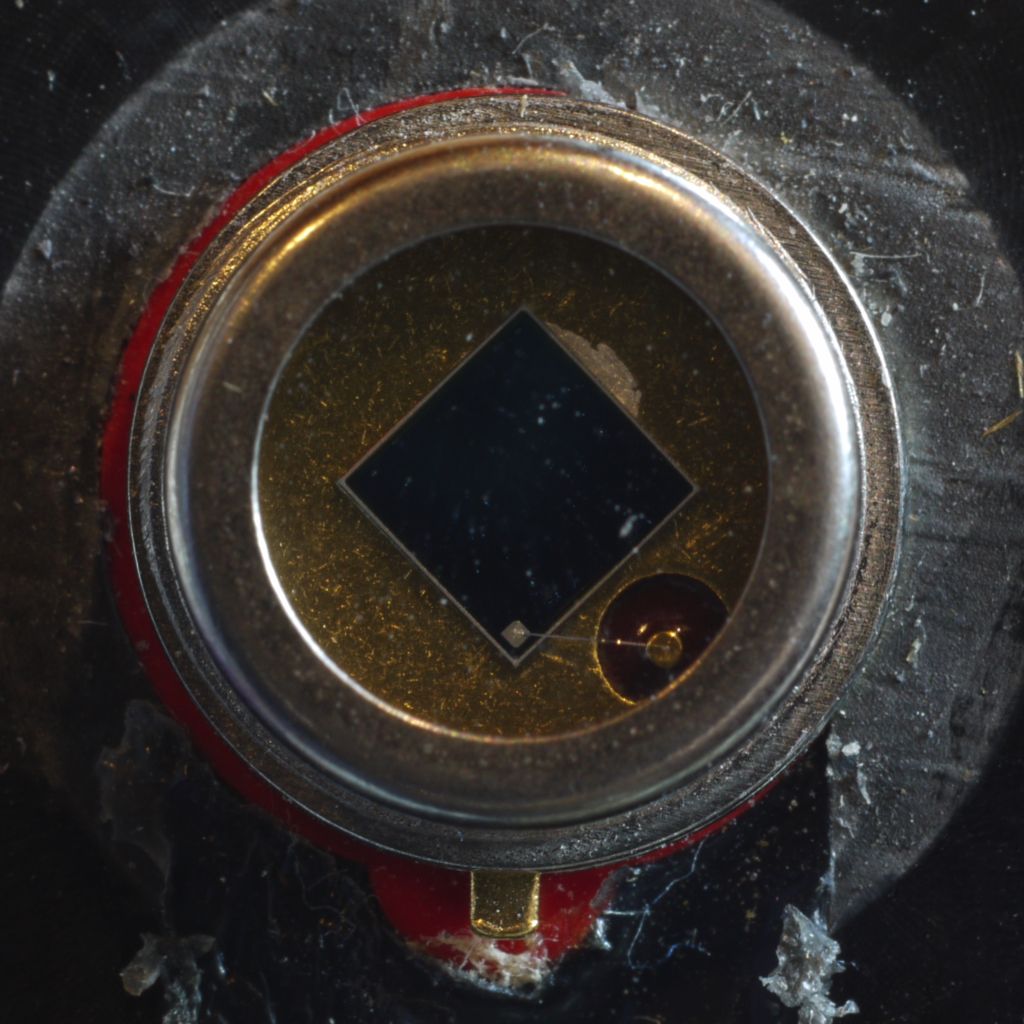

      This device has three leads connected to it, and I presume it to be a photocell of some sort; or perhaps a photo-switch. … but it's potted in a block of black resin, so the markings are obscured.
      Does anyone recognise it, please ?
      Edited By Michael Gilligan on 07/01/2018 16:11:17
      #34370
        Can you please identify this PhotoCell ..

        Tim Stevens
          @timstevens64731
          Black resin might mean an ultraviolet detector – ?

          Dave Daniels
            @davedaniels93256
            PIR sensor IC ?
            One similar to this ??
            https://learn.adafruit.com/pir-passive-infrared-proximity-motion-sensor/how-pirs-work

            Michael Briggs
              @michaelbriggs82422
              Looks like a phototransistor in a TO-18 case. The lower rim of the case is visible, markings would normally be on the side of the can so it is probably an unmarked device.

                Sorry if I did not make myself clear … The can is potted in resin for structural purposes only; the window is not covered, it is 'looking at' a small tungsten filament bulb which provides incident illumination on a microscope.
                P.S.
                I don't have proof but I think this [Optem Zoom 65] microscope tube was originally part of a "Hughes-Palomar Bonder" and the resin block is part of their customisation.
                  I'm not doing well today blush … I have a streaming cold and shouldn't really be posting questions.
                  The can is considerably bigger than TO-18, so is probably TO-5
                  Yes, the markings would normally be on the side of the can … but it's potted in a block of black resin.
                  For my pennance, I will measure the diameter [hopefully tomorrow]

                    Well I'm disappointed – I was hoping for the much-loved ORP-12.
                    Worst come to the worst, just fill the top off a low-power, high gain transistor in the same size can. Carefully shake out the swarf and make an epoxy or similar window.
                    Phototransistors are/were generally very poorly characterised (i.e. the circuits should be very tolerant of different sensitivities and have ample latitude for adjustment if required).
                    It worked for me in the 80s so it should still work now.

                      To be honest, Neil, it was just idle curiosity … It probably works fine; if only I knew what it was there for !
                      Here is a Hughes-Palomar Wedge Bonder surprise
                      http://www.tarasemi.com/product/hughes-palomar-2470-v-wedge-bonder/
                      … all I have is the litle black tubular unit that their video-camera uses.

                                At the risk of further complicating what I mistakenly thought was a very simple opening question:
                                The CCD camera is at the top of the black tube, and the device I want to identify is at the bottom; appended to the incident illuminator.
                                I haven't found a brochure for the original 'Zoom 65' but this is the updated version:
                                **LINK** http://opspe.com/IS/pdf/RZ65%20brochure.pdf
                                … which uses fibre optic illumination, via the cylindrical connector, instead of the tungsten bulb of the original version.
                                There's a beamsplitter/combiner in the lower end of the main tube which makes the light path co-axial with the image path, and thus provides shadowless illumination.
                                P.S. The little resin block is, I am almost sure, a custom component added by Hughes.
                                The photocell in question may do nothing more than tell the system that the light-bulb is on or off.

                                            I hate to say it but you can clearly see that there is only one bond wire going to the die. So it must be a component with just 2 connections ie not a transistor. It's possible that the package has 3 wires but one of the them may just be to the can, or simply that package only came with 3 leads, one of which is entirely redundant.
                                            Perhaps I'm missing something?
                                                Murray
                                                Not at all, Murray … You are very probably correct.
                                                The specific device has an uncommon appearance, which is why I was hoping someone might recognise it visually.
                                                The connections are all embedded in the resin block, but I believe that the relevant cable has three cores.
                                                The wiring harness has a five pole connector with two cables … Two thicker cores feeding the lamp, and three thinner ones apparently going to this device.

                                                  I have probably half a dozen different opto sensors that have the same internal appearance (square sensor chip and one bond wire) but without being able to read the case marking would not know what each one was. I doubt very much that one could identify the part number of your device without reference to the original manufacturer.
                                                  Unless I missed it, you did not say why you were trying to identify it? If it is actually working then you could do you own tests with different light sources and generate some sort of response curve so that you could at least determine its operational purpose, my money would be on it being in a feedback loop with the lamp filament for constant illumination level

                                                    I must have led a very sheltered existence, Ian blush
                                                    This is the only one I recall seeing with the chip mounted diagonally to the tab, and with the seal so close to the window.
                                                    As for why … idle curiosity
