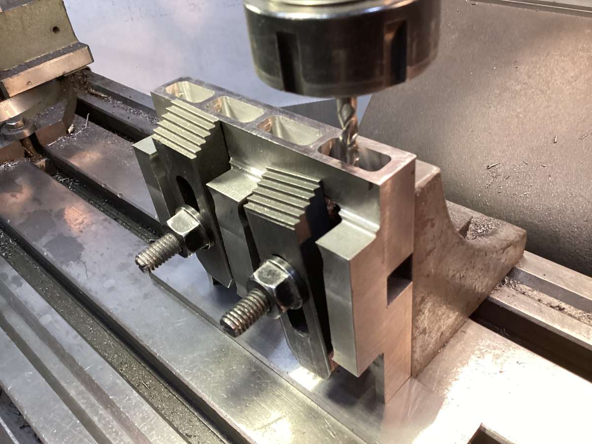

          mine is started, but it’s very slow going, recovering from a seizure in bed at the moment, and it looks as if the gestation period will be very long.   The condenser body  is mostly completed. I have made a few changes to the overall shape of the bed plate.
          here’s the milling of the pockets on the front of it. I have also changed your method of attaching the extension for the hotwell, making the seating for the condenser outflow part of the bed rather than being on the top of the extension piece.  The connecting passageway  to the hotwell being drilled through the end of the well ( and plugged) rather than milling out for the plate on the base IMG_1252What is certain is that the engineering is very very interesting

            This design, I’m sure, lends itself to a decent degree of personalisation but do make certain of any dimensional changes as there are so many parts that need to be in more or less perfect alignment. I think I made a calculation error on the hotwell extension, not realised until I fitted the pump levers when it became noticeable – not much but enough to realise that somewhere I had made a mistake despite double, and more, checking of everything. I did in fact have to take the slightest amount off the top to give a tiny clearance. I went back over my figures but could not find where the mistake was made.
            Looks like you are off to a good start – I hope your journey with it proves as enjoyable as mine has been👍
