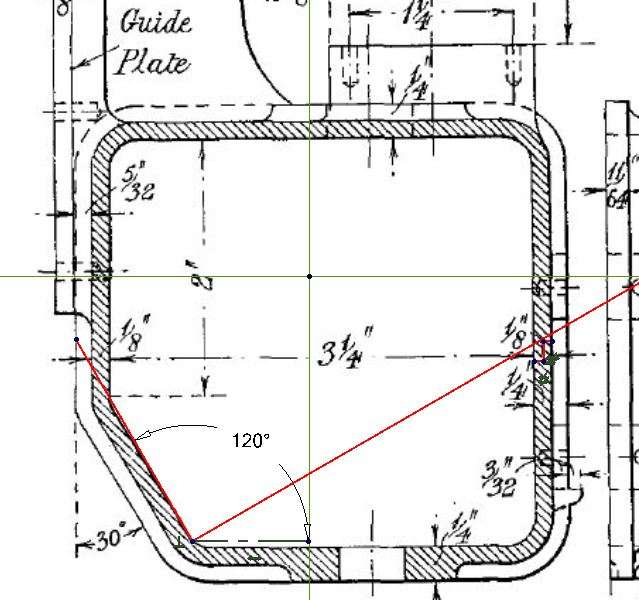

                      Hi   What a cracking idea to use bearing fit for the tubes. One end can be fitted with a conventional gasket and the other fitted when the time comes
                      im currently drawing all the main parts in Fusion  at full size, then it can be scaled and printed out without recourse to the calculator to do the sizes. It also helps me to work out the machining order, and to see all the dimensions which are not too clear in some cases   Not found any mistakes yet!
                      Just completed the condenser drawings  but struggling to work out how to cut the internal angle.   Current thinking is either multiple passes with a ball cutter, finish with a file, or set it at an angle then use a small dia fly cutter ( similar to a boring bar]   A standard cutter hits the top edge when it’s tilted.   It’s a complex build and I’m looking forward to starting, but go to paint me loco first!

                        Zan, it looks to me that a straight cutter would do it provided you did not have a horizontal split line too far up the side of the condenser. Or would a vertical split be possible as that would give a lot more access.

                          Ah,  thanks for that.   I don’t like the idea of a vertical split could make the assembly  a bit weak and lowering it gets it too close to the bend and possible complications, but the solution just came to me, make the split at two heights with the back being lower. A lot easier! ( as long as it still clears the pump mounting “bosses” at the back)

                              Zan – personally I wouldn’t get too hung up on the internal angle as it’s just not that important. I did mine by step milling with a ball nose and filing the high spots off. Calls for nothing more complicated than a list of movements to follow – it’s actual surface finish and/or angle to the outside plays no useful part at all in the scheme of things (save one of personal satisfaction I guess)

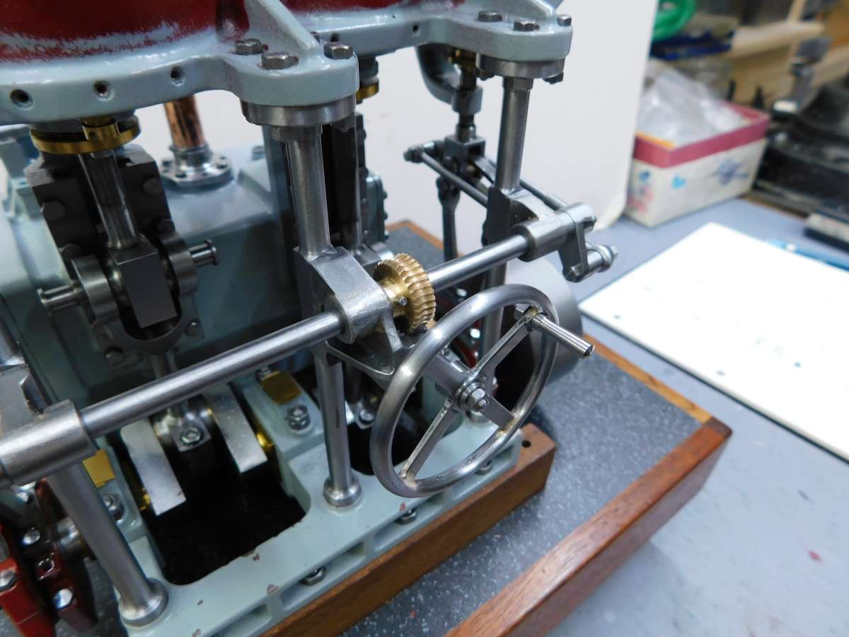

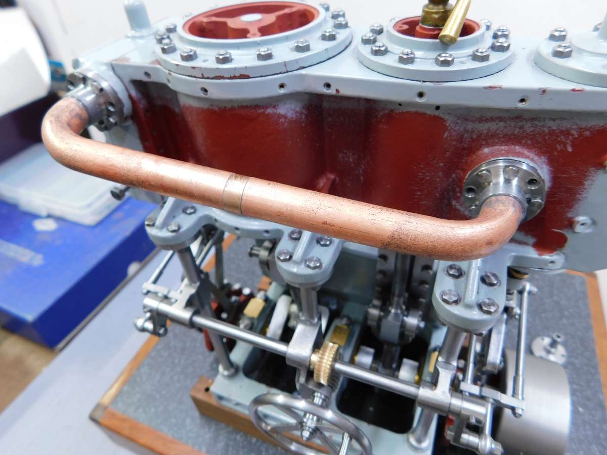

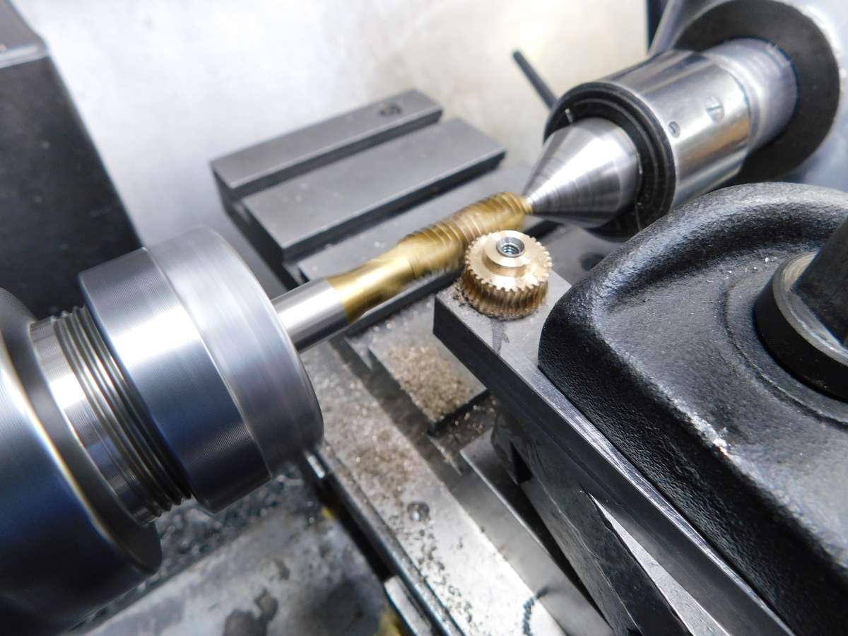

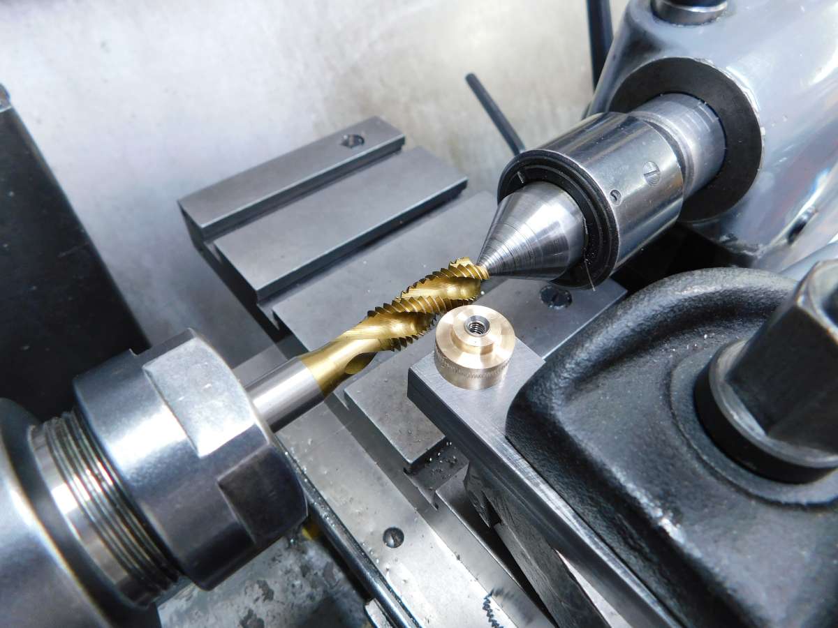

                                        Ramon Wilson
                                          @ramonwilson3
                                          Yesterday saw the final touches to the valve gear with the making of the handwheel to set the reversing gear. As mentioned elswhere I tried using a tap for the hob to create a worm wheel. This was a first time and had no idea what to expect. A holder was made with a threaded spigot to take the blank – the blank itself being made thicker to bring the are required onthe lathe centre line. From the intitial touch on the blank began to rotate and cut – the whole thing was finished in less than a couple of minutes  before I realised I hadn’t needed a hold down bolt
                                          Marine Compound (155)
                                          Marine Compound (157)
                                          The whole operation went very smoothly and a constant eye was kept to see if there was any deformation of teeth at the start point – two were made, just in case, and a worm cut to a few thou under the dimension set by the previously machined bracket. A small amout of ‘running in’ was required and it could all be assembled
                                          Marine Compound (159)
                                          Marine Compound (162)
                                          The steam pipe was made in two parts aand joined with a bronze insert, the whole thing assembled in situ using JB Weld. Much easier that making a jig to silver solder not to mention the need to bend the ends at the exact spacing. The bronze insert is thin walled with an inner diameter larger than the flange holes so no restriction as suc
                                          It runs very smoothly and on very low pressure though the exact psi isn’t known at this point in time – I will do a video once I have the Inlet Valve made – at the moment it’s still the airline stuffed in the inlet flange!
                                          Next up though is to work on the pumps at the rear
                                          Marine Compound (164)
                                          That’s it for now – hope that’s still of interestt to some
                                          Tug
                                          #769822
                                          bernard towers
                                            @bernardtowers37738
                                            Lovely work as usual Tug and i bet you were surprised how well the tap made worm worked!!. I have often wondered if it would work very well using the hobs off my hobbing machine?
                                            #769867
                                            Ramon Wilson
                                              @ramonwilson3
                                              Thanks Bernard – yes I was surprised how easy it worked in the end – couldn’t quite ‘see’ beforehand how the number of teeth would work out exactly on the circumference. It was surprisingly easy to see when ‘equilibrium’ was reached, the worm just made to suit.

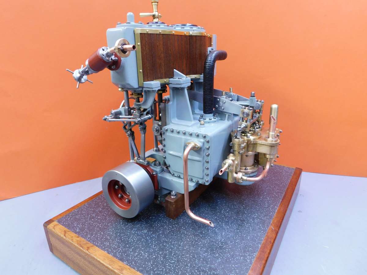

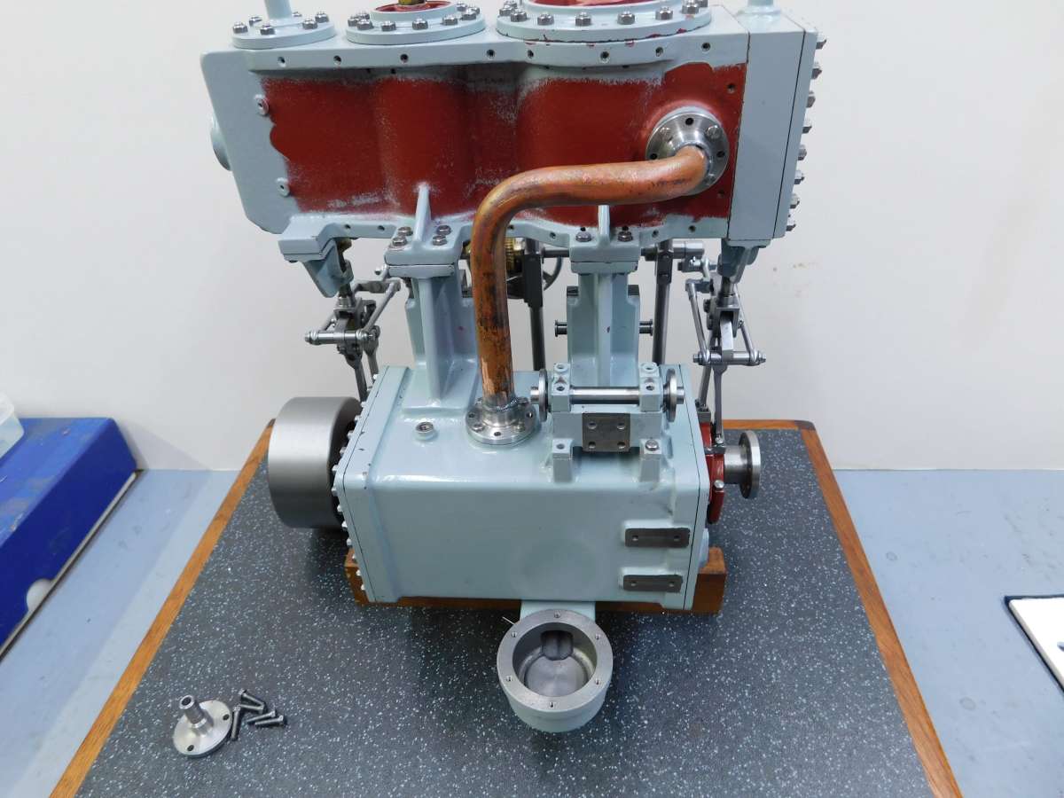

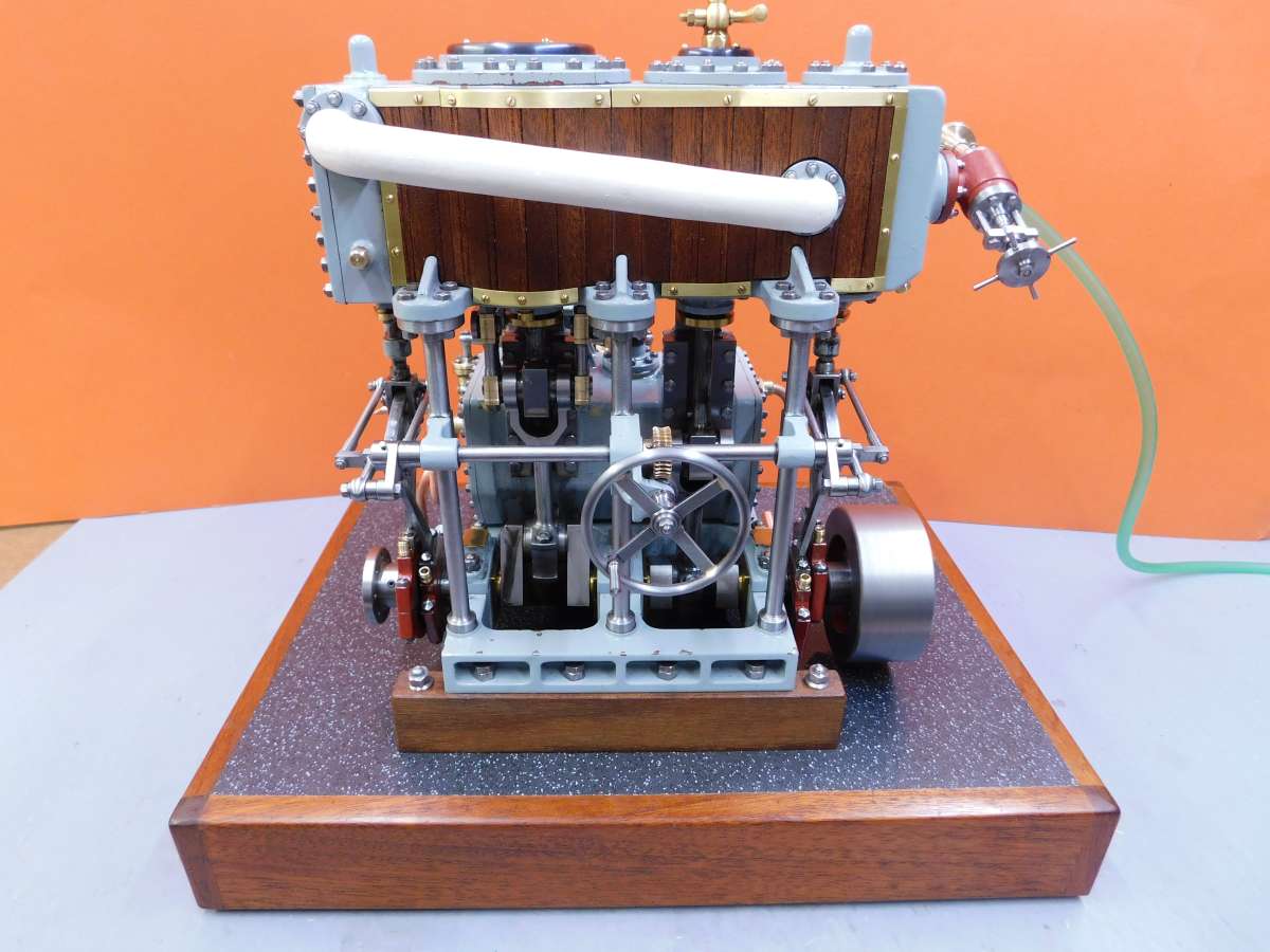

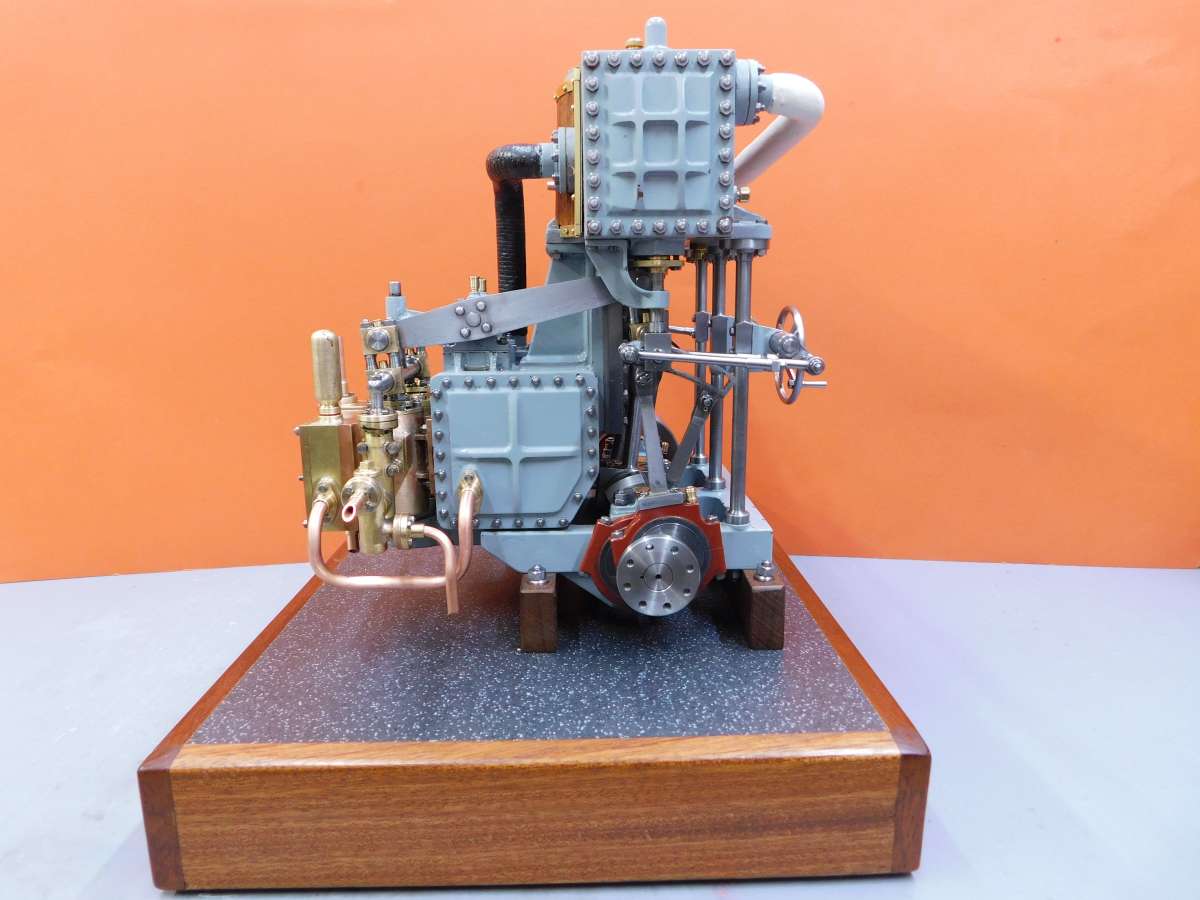

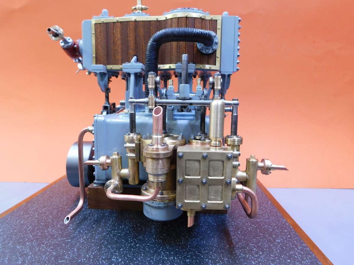

                                              #784035
                                              Ramon Wilson
                                                @ramonwilson3
                                                Hi guys, for those who may still have an interest …
                                                Well it’s finally finished and up and running – It’s proved a really lovely project to get ones teeth into. The drawings are excellent –  I don’t recall any errors though you do have to search for the odd one here and there on other matching parts. It runs really well – well, as well as I want on about 40 psi at source and will slow to almost single strokes with the stop valve virtually closed. There’s a short video here https://youtu.be/_KuWKWbssIg
                                                That’s it then, I think it very unlikely that there will be another ME project so I guess this is my ‘swan song’. That said though one ‘never say never’ eh
                                                All the best to those who have followed and commented – I think this will be my last contribution as I have many other things I want to do before I’m just too old to do them.
                                                Best to all – Tug
                                                Marine Compound (166) - CopyMarine Compound (168) - CopyMarine Compound (172) - CopyMarine Compound (171) - Copy
