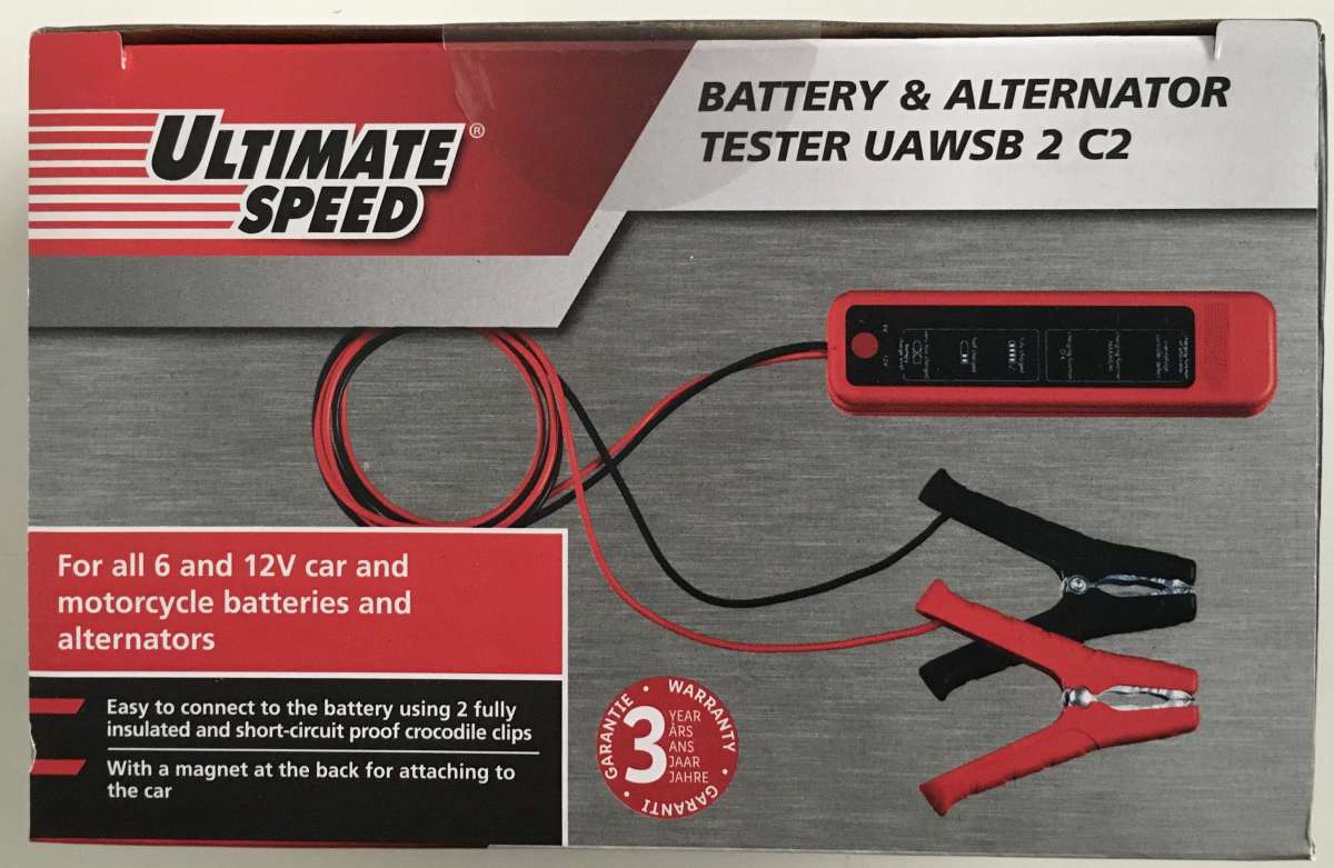

      Ultimate Speed’ Battery & Alternator Tester UAWSB 2 C2, from Lidl … with 3years warranty … on sale today [in Prestatyn, at least] for £1.19 each.

            duncan webster 1
              @duncanwebster1
              So what does it measure? Just volts?

                #732194
                mgnbuk
                  @mgnbuk
                  Yes – basically a bar graph type voltage display with the Leds colour coded (green = optimum, amber = marginal & red = iffy).
                  Just a little micro controller inside using an analogue – digital input & having the Leds connected as outputs.
                  Simple to use for someone without a multimeter (or maybe the knowledge to use one) – just clip the leads on the battery & watch the lights. With the engine running it shows if the battery voltage rises when the alternator is working, but indicates overvoltage as well as low voltage.
                  I fitted one to the bike after it had to be pushed aboard a ferry in Holland having boiled the battery dry due to a faulty volage regulator, just as a simple & inexpensive indication of what the bike voltage was. Came in useful later on when it was intermittently undercharging – eventually tracked down to a duff diode in the rectifier.
