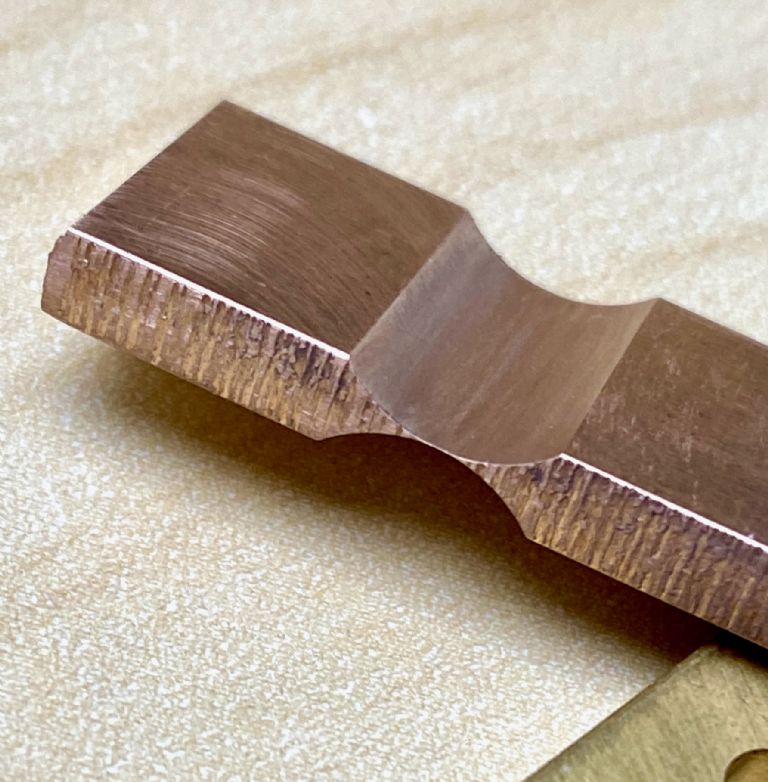

                        I milled a hinge in phosphor bronze.
                        The strip is 1/8" thick and about 0.5" wide. It was cut using a 3/8" ball-end mill, and the tops of the troughs are about 1/4" across. The minimum thickness seems to be about 0.003".
                        This time I had it clamped flat against a table, and such that it could be flipped precisely in the same position. After milling, I sanded the troughs lightly to remove most of a tiny central groove that the ball-end mill tends to leave behind.
                        This material is a lot springier than brass, but it will still deform or eventually break if bent more than some modest number of degrees. This happens without warning. The amount of bending that is tolerable is fine for a pendulum, and across that range it acts as a decent spring hinge. Whether better than a strip of spring steel, etc., is unclear.
                        The big down-side of this sort of hinge is fragility – they are very vulnerable to even slight fumbling. Some experimentation with different thicknesses should be done. But I think typical strip of spring steel or beryllium copper, etc., should be much more robust.

                          Impressive that you got the minimum thickness so small yes
                          But it does, I think, serve to demonstrate the problem that I was suggesting we need to avoid.
                          … not only is the thickness transition quite steep, but you will inevitably have machining marks [i.e. additional Stress Raisers] running in the most unwelcome direction.
                          As a “thought experiment” … Compare that to a spring-steel strip, thinned from [say] 0.004” to 0.002” by the method I proposed.

                            I don't view the transition to be steep where it matters – it's rather gentle, really. You can use a larger ball-end mill to make it more gradual if desired. You could round off the shoulders, too, but I don't see that as being a big source of problems.
                            But yes, you would want to polish out any machining marks in the troughs. I should have polished the edges of the strip before the milling, too, but it was just a test.
                            Even what I did so far was decent (light sanding with 400 grit using paper wrapped around a rod). But with hand-sanding it's almost impossible not to thin the edges of the hinge more than the center. Maybe a jig could help, but it still wouldn't be perfect.
                            That idea about thinning an already thin strip – have you tried it? I wouldn't have confidence that it would work out well for similar reasons.
                            The big take-away for me is that this metal, cold-worked 510 phosphor bronze in "spring temper," thinned to ~0.003", still does not have the right sort of spring to it, and is certainly too fragile, to be used in a practical clock pendulum.
                            Because I'm a romantic, I might still try to build it into a pendulum. But I'd want to compare it to an alternative, such as my knife-edge pivots, e.g. to see which results in the best Q.
