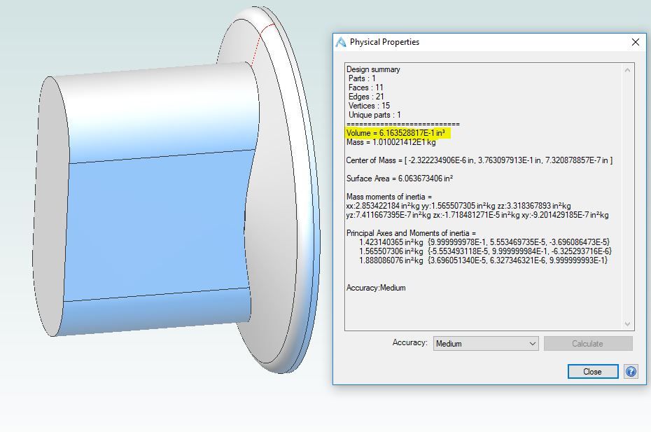

                                          I just had a quick look at the Centaur drawings and looks like the compression ratio works out at about 4.5:1.
                                          Bit of guess work on the head cavity which I came up with 0.64cu.in for. Piston stops 1/4" from the head so at 1.5" bore that s 0.44 cu. in giving a total of 1.02cu.in.
                                          With 2" stroke the swept volume is 3.53cu.in
                                          Therefore total volume 4.55 : unswept 1.02
                                          Edited By JasonB on 04/02/2019 08:27:46

                                            Thanks Jason!, This morning I used a pipette to measure the combustion chamber volume.
                                            The chamber is at present completely unmachined although I have the spark plug hole drilled it was taped off.
                                            Volume measured 8cc so with a swept volume of 57.8cc it works out to 7.2:1
                                            I shall mill out the deep part of the chamber (up to plug) although I don’t believe there is much to come out, more of a clean up operation. I will then bore out for the valves, which should end up fairly flush with the inner surfaces. I will then measure again, after which the shallow tapered part of the chamber will be the only part which could be machined to lower the ratio.
                                            Do you think I ought to aim for something like 5:1? as this is a one way journey!

                                                  My mistake, I did not allow for the big end bearing.

                                                    The Compression Ratio is volume of max space: volume of Min space – I make it 8.22:1.
                                                    And the claims for engines at whizzy ratios are all aluminium engines. I bet your model is cast iron – which does make a big difference. And my view is that 8.22 to 1 is pushing your luck if I am right about this.
                                                    Regards, Tim
