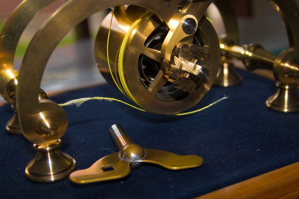

          For the time being and to bring this up to date, I found that the line had thinned. This wasn’t all that obvious until I got down to taking the photograph. For the record, the thinned thread came from close to the break, and was subjected to the greatest tensile stress, whereas the thread below it came from near the fusee termination.
          For the record, here's a picture of how I found the clock (and fusee line), after it stopped.
          The badly frayed end must have received some bashing during the very rapid unwinding of the spring.
          Thanks again to every contributor. It's been a lesson for me, I trust that it adds to the collective experience for model engineers everywhere.

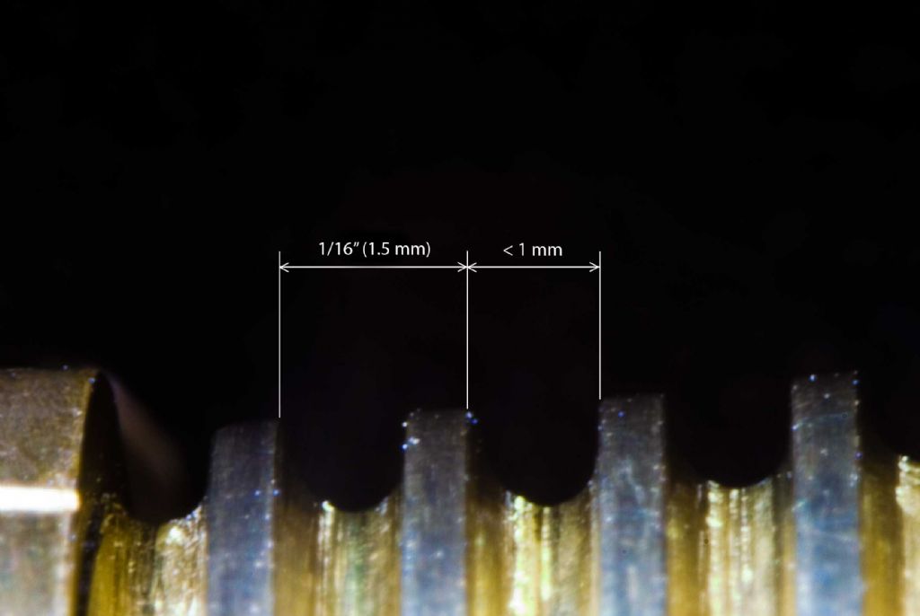

                This photograph taken at the small end, is a rather `fuzzy fusee’ profile of the spiral groove as it currently appears. A 1 mm drill doesn’t quite fit, so it looks like I was fairly close to drawing.

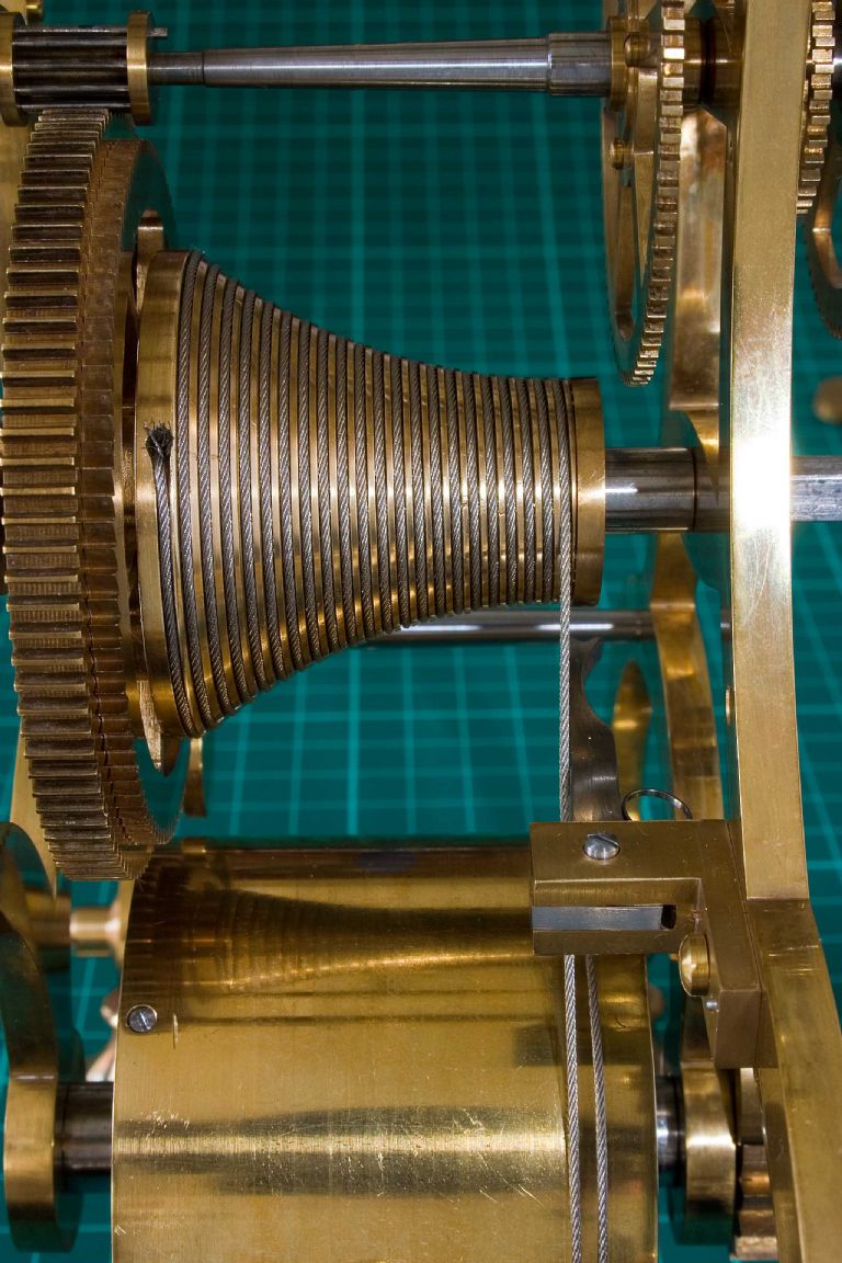

                In conclusion, despite a fixation on using a synthetic cord (fishing line), I eventually accepted the advice of a professional clock-maker and used multi strand steel.
                See this second picture.
                I’m not too impressed with the tail ends of the knots. My original method hid the line terminations.
                As if all this wasn’t enough, I suddenly noticed in the very top LH corner of this picture that one of the pins in the first lantern pinion had worked loose. Oh dear! Or words to that effect.

                    Although I had grown to like the yellow of the fishing line, I rather like the steel wire now.
                    By the way, I cleaned the clock and the chaps at the clock shop who supplied the wire, also pulled the main-spring out of the barrel for me. After I cleaned it, they put it back adding some special oil before they did. When I wound the clock, the extent of the swing of the balance wheel was most impressive.
                    I've not yet had a chance to adjust the beat, but overnight it had gained ten seconds, whereas before, it was all over the place.

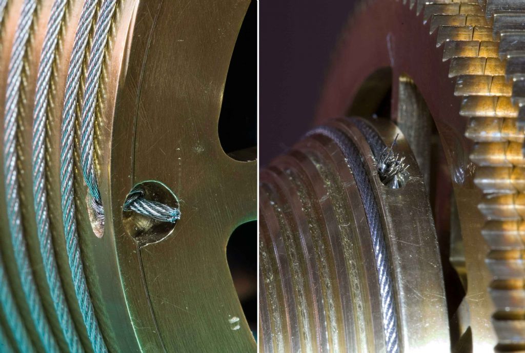

                              I also photographed the two wire terminations – `Thumb knots’ – for me the simplest way out to a less than ideal solution. Incidentally, this picture also captures (centre right), the stop-work iron and the associated `snail' hook.
                              It looks like my wire cutters missed a few loose ends.
