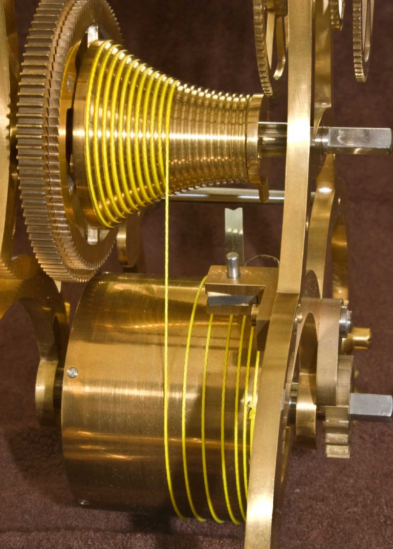

        Gentlemen,
        I would welcome comment about using fishing line for clocks.
        As some of you would remember, three years ago I finished building John Stevens’ skeleton clock and set it in motion. As an eight-day clock and being wound regularly, it has been running without a hiccough.
        Fusee and Barrel
        As you can see from my picture, I used braided fishing line to transfer the torque from the barrel to the fusee. The line is rated at 80lb, and my rough measurements suggest that the spring exerts a pull in the thread of about 10 to 12kg (22-26lb).
        About a week ago, the clock stopped. The fishing line had failed while there was at least 80% of the spring’s energy remaining, ie. at almost the highest tension. Although I was out at the time, it must have caused quite a racket, probably scaring the life out of our dog.
        While the clock has sat in the shade behind vertical blinds, I suspect that some UV has been getting to the fishing line. There are also limitation to thread/line diameter, and the method of attaching it to the barrel and the fusee.
        Also, I have rather limited workshop facilities, so any serious modifications would be difficult if not impossible.
        Before I buy more/better line, what are your thoughts?
        With regards,
        Sam

          I suspect the line is not absolutely garuanteed to be 80 lb and if it breaks for a fisherman he just tells his friends "It was so big it broke my 80lb line so it must have been at least 100lbs"face 20
          There may be different qualities as I bought a strimmer last year and the supplied line, just seems like thick fihsing line, broke every minute until it was all used up. I bought some from my local farmers' shop and I only have to feed more line a couple of times an hour,
          I'd use stainless wire for appearance or brass plated steel as used to be used for picture hanging.

              Braid is very strong, if you can connect it correctly.
              Lathe belting is also amazingly strong and goes down to 2-3 mm (the red stuff)
              you can hang an entire human from lathe belting(tested it) plus it has good shock and wear capabilities
              Mono weakens with exposure to light, it gets brittle

                  Try your local Tackle World or BCF store and look for multi strand stainless trace wire and you can get little crimps to form the loops you need .
                  The stuff in the photo is from memory 80- 100 LB breaking strain PVC coated and measures .65 mm diameter but I think you can get just bare wire also.
                  Have a look at those stores online and see if they sell what you want .
                  Braid is very strong for the diameter and has no stretch but does not like abrasion of any kind .

                    If you opt to use any type of braided material in this application you should ensure that it is preloaded before use by simply hanging a weight from it for a couple of days roughly equivalent to the tensile force that it will be subjected to in use. I have several fishing reels loaded with various braided and filament lines. All are UV resistant. this day and age you would probably have to look hard to find any fishing line that was not UV coated.
                    Bill

                      Thank you for your messages, they are greatly appreciated. I’d like to carry out a couple of tests before going any further.
                      Having said that, I’ve just arrived back from an interesting session with Tackle World in Cranbourne (Oz). They gave me a piece of fishing line to try which has a 90lb rating. I can only describe it as a multi-stranded steel core with a (tough to cut) reddish brown plastic coating. Its diameter fits in the fusee grooves perfectly.
                      Without too much thought when I was putting the finishing touches to the clock (over three years ago), I terminated both ends of the original (yellow) braided fishing line with (granny-knot) loops. These were threaded through holes in the barrel and the fusee. To prevent them pulling out, I inserted a tiny grooved peg into each loop. This worked well especially considering the limited space available. But that's what clocks can be like.
                      Knotting steel wire is not going to be so easy, and anchoring is where I need to concentrate.

                        How about a copper ferrule like this **LINK** loop the wire back through it and you can place a small peg in it.

                          I think You have been attacked by the creep gremlin, all materials creep plastics being some of the worst. The load under which a material creeps under compression or tension can be a lot lower than its ultimate breaking strain as tested when imposed by a short term load.
                          You can also get plastic coated very fine gauge stainless steel cables (trace) from a fishing shop, This may be a better alternative for your clock. In this case the plastic is only protection. Stainless steel creeps very little.

                                    Dyneema is a highly oriented Polyethylene. Though incredibly strong, it will still be subject to creep in this type of application. Though it may be UV stabilised, I would expect it to still suffer from UV attack in the long term if exposed.
                                    At room temperature, such polymers are not all that far away from their melting point – so creep is always an issue to consider.

                                            Sam et al, You need to consider the use to which you are subjecting the braided fishing line. I spoke to a friend of mane this morning who actually manufactures braided fishing line, as opposed to simply selling the stuff. When I told him the use to which it was being subjected he laughed, oh how he laughed. His view was that the 80lb rating of the line was somewhat irrelevant. You are subjecting the line to a constant loading of some 22-26lbf.
                                            The line is designed to withstand a occasional peak load of 80lbf. Your thoughts on a safety factor of 3 or 4 would only apply for occasional loads rather than a 3 year consistent loading and constant flexing as the line rolls on and off of the clock components……….I can only tell the time with a clock and so the component names are a mystery to me, please forgive my ignorance on this.
                                            In his opinion you are lucky that the line lasted for 3 years. If there is no purpose made line available then he suggests stainless steel or brass braided lines of suitable strength. Many others I note have made similar suggestions. HTH.
