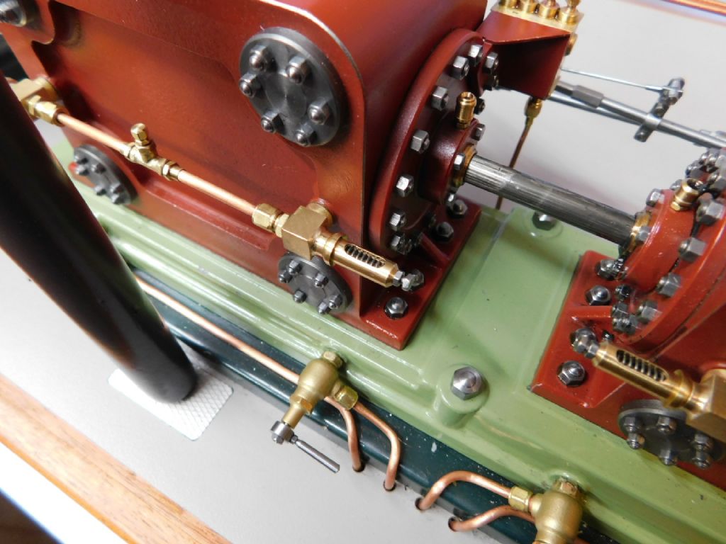

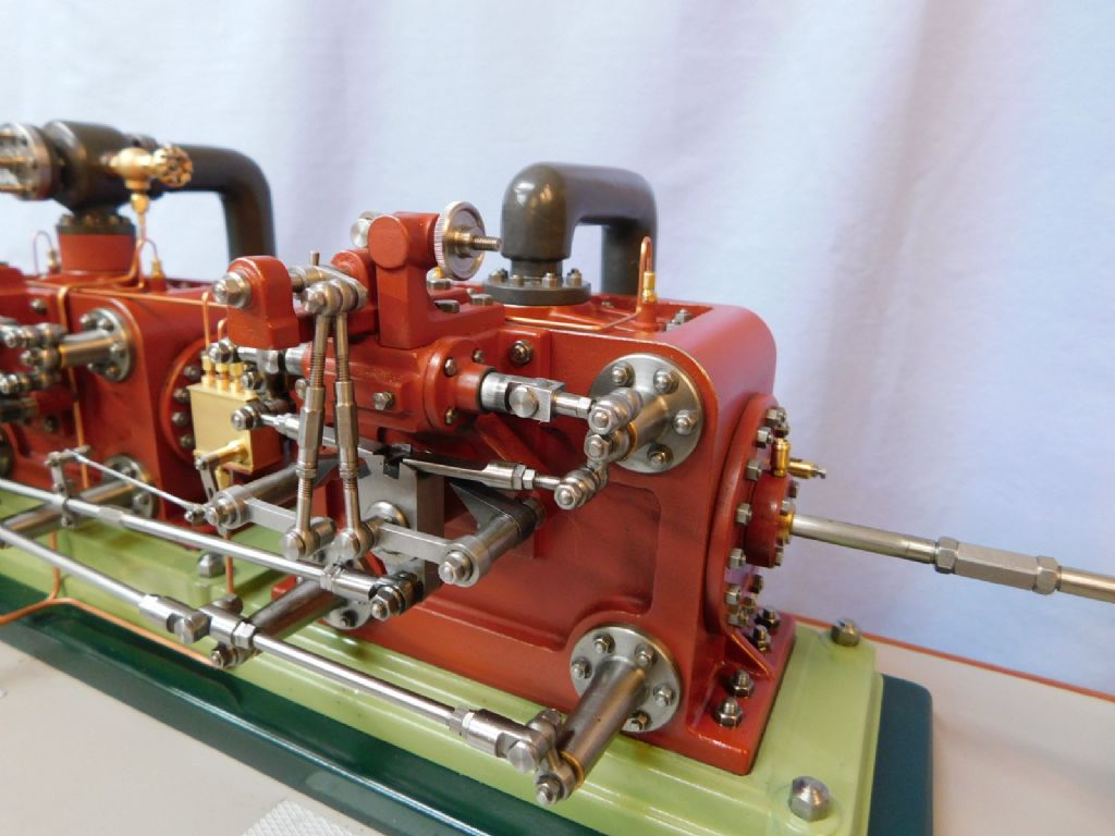

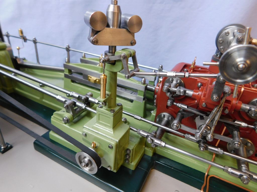

      Hi – I have just finished this engine after an elapsed time of three years – thought someone might be interested in seeing it.
      It's built to the Arnold Throp design first featured in Model Engineer in the eighties and the build is described on Model Engine Maker forum
      I guess it has taken about 18-20 months in total over that three years or so. There are some mods made to personalise it in areas – all described on MEM here should you want more info. There is also a video on there of it running on page 39 post #581. For some reason this computer will not post the video url.
      I've had the castings for many years and did come close to parting with them but a change of heart saw a tentative start on the machining and now I have a finished engine as a result. Just goes to show – never part with something on a whim.
      Regards to all – Ramon (Tug)
      Missed one – the overall view – the base is a little over a metre long btw

        A corliss valved tandem condensing compound

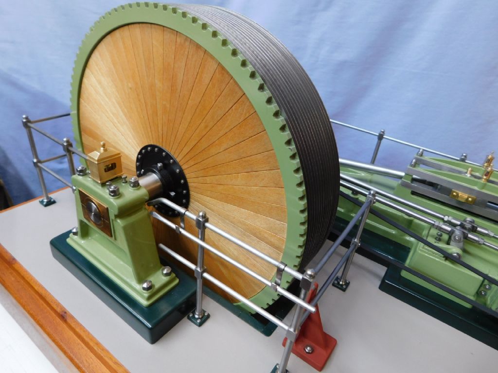

                    An unusual touch, too, the planking. We see most miniature mill-engines with open flywheels.
                    It was fitted to some full-size engines to reduce wind noise created by the faster engines. It may have reduced drag, too, but I don't know if the manufacturers had that in mind, and that effect was probably insignificant anyway.

                        That is one superb piece of work Tug. Love the close ups on the video. You can think you are watching a full size engine..

                          Wow! What a lovely model. All the studs poke out of the nuts by the same amount, piping very nicely executed, painting and brightwork excellent. Well done, really worth entry to MEX, if it happens, must be an award winner. Wish my efforts were half as good.

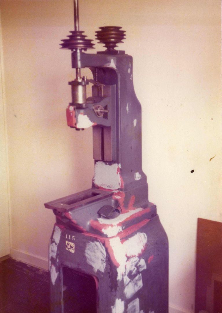

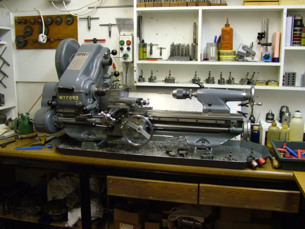

                                                Old Mart – I have three machines – my Super 7, a truly faithful servant bought circa 1980 and still in good condition today
                                                An old – possibly wartime – Linley 'Jig Borer' that I bought in 1978 or so. Mechanically sound on the ways and spindle it was in a bit of a state
                                                but after some considerable work – a new table made at work to increase the capacity, DRO and, the last improvement a VFD drive it too is a faithful ally.
                                                It's only drawback is the limited head room and the inability to move the head at an angle. Seventieth birthday pressy was an Amadeal mill. This has proved to be far better than anticipated but is used mainly for initial machining
                                                Apart from a Fobco drill which predates the lathe and bought from Reeves the rest is just basic accessories made or purchased over the years.
                                                Nigel Graham 2 – I don't think it was to reduce the noise per se but more the windage itself but of course it would have had a huge effect on noise too. We see our models gracefully ticking over but when these engines worked the speed was quite alarming to that perhaps expected.

                                                      What is the history of that oversize saddle hand wheel on the Myford, please?
