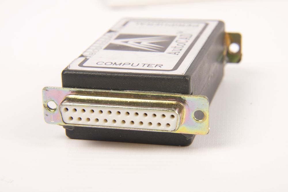

          Posted by Michael Gilligan on 18/12/2017 11:37:33:
          … unless of course, the specimen has been reassembled with the shell reversed dont know
          That is a bit of a puzzle Michael, I have in my hand a dongle for AutoCAD 12 and it is very definitely for the parallel port pins to computer and I distinctly remember that it was for the parallel port. it looks as though the picture comes from an Acad 9 release I wonder if they changed?
          Mike
          Mike
          Yes, I was seriously suggesting that the specimen might have the shell on wrong.
          There's another view on the linked page which suggests that someone has had it apart.
          I'm on seasonal domestic duties at the moment, but will try to dig-out my old AutoCAD installation manual later.

            Which demonstrates, I believe, that the AutoCAD dongle was RS232

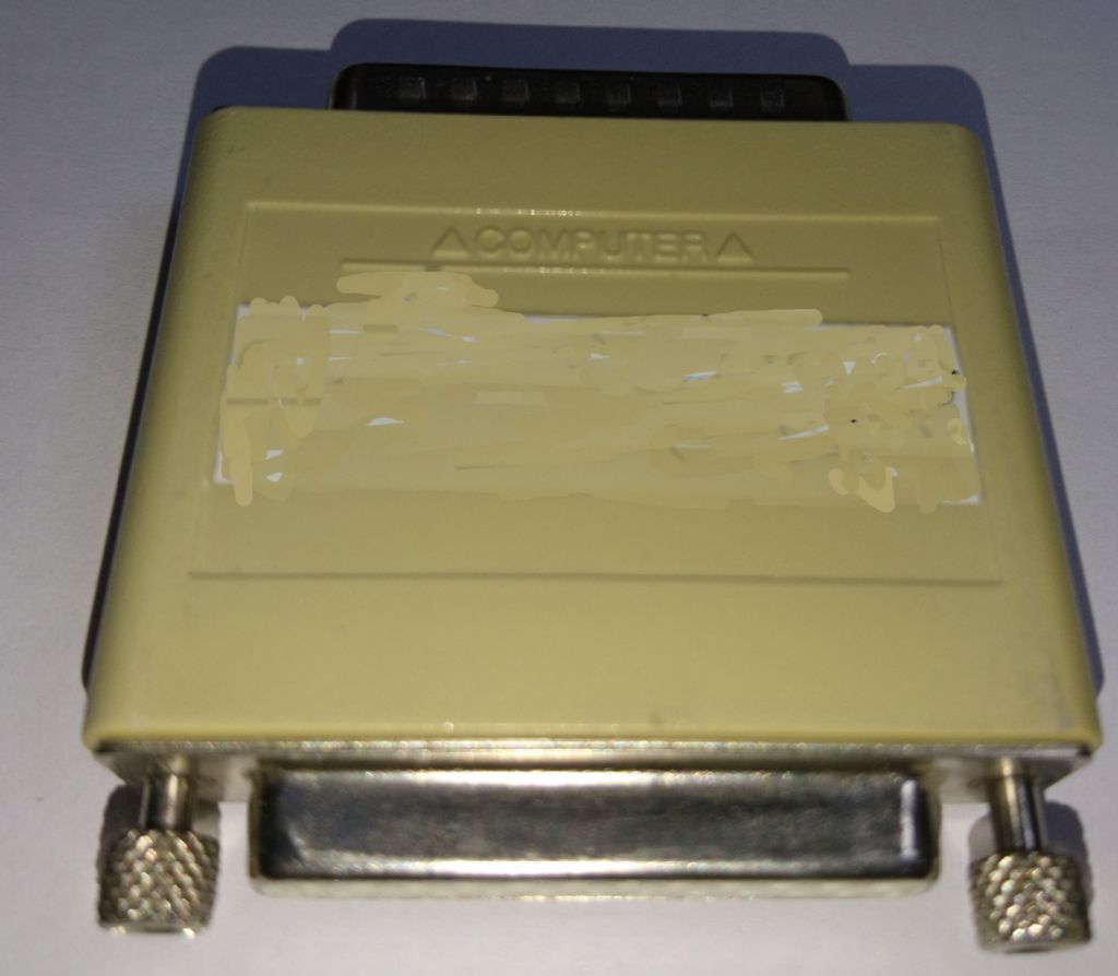

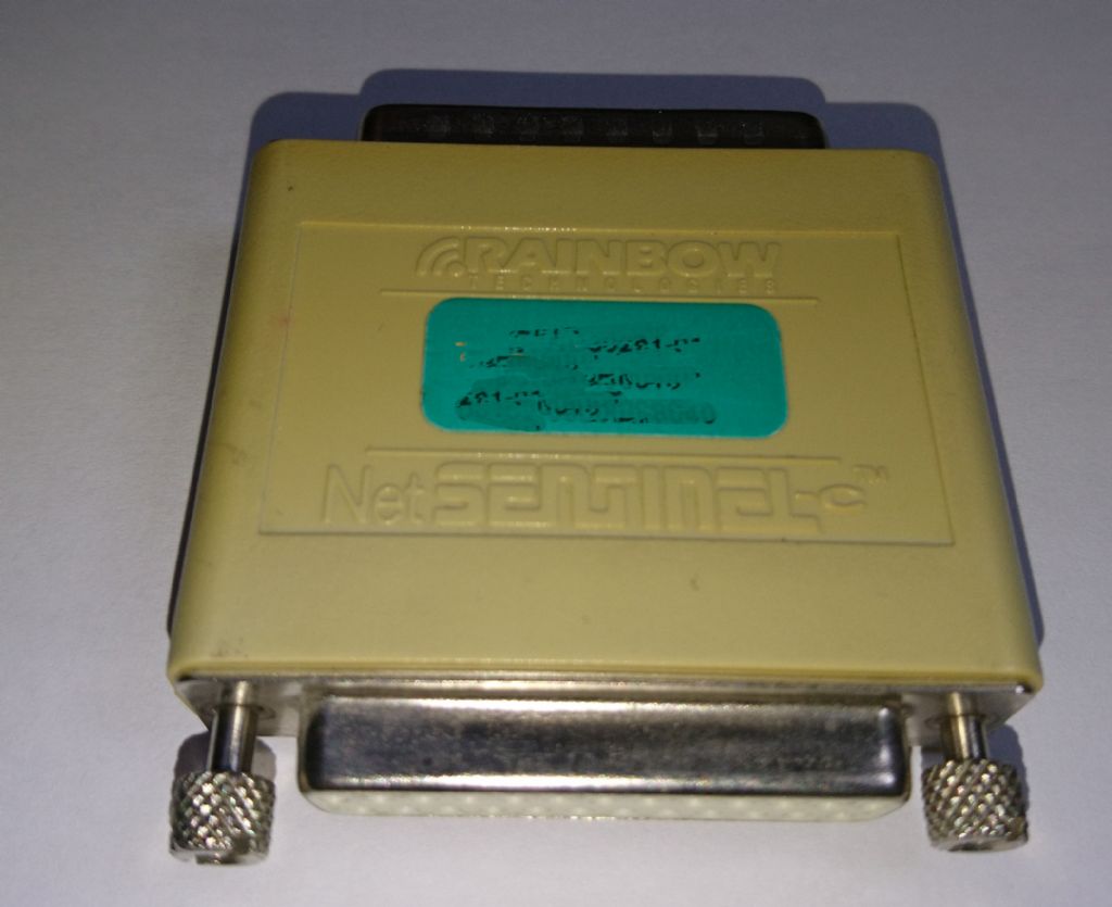

                                    After hours of searching, here is my AutoCAD R14 Dongle (edited to remove serial numbers). It is a NetSENTINEL manufactured by Rainbow Technologies, supplied to my former employers in 1998 and passed to me when they changed CAD suppliers so that I could maintain their older drawings.
                                    Although it has a parallel pass-through, only the computer end is labelled as such.
                                    Brian
                                    Edit: I could never get the software to run on Vista or later, and kept an old machine running Windows 2000 for AutoCAD until it was no longer needed.
                                    AutoCAD R14 Dongle
                                    Other side of dongle
                                    Edited By Brian G on 18/12/2017 21:24:38

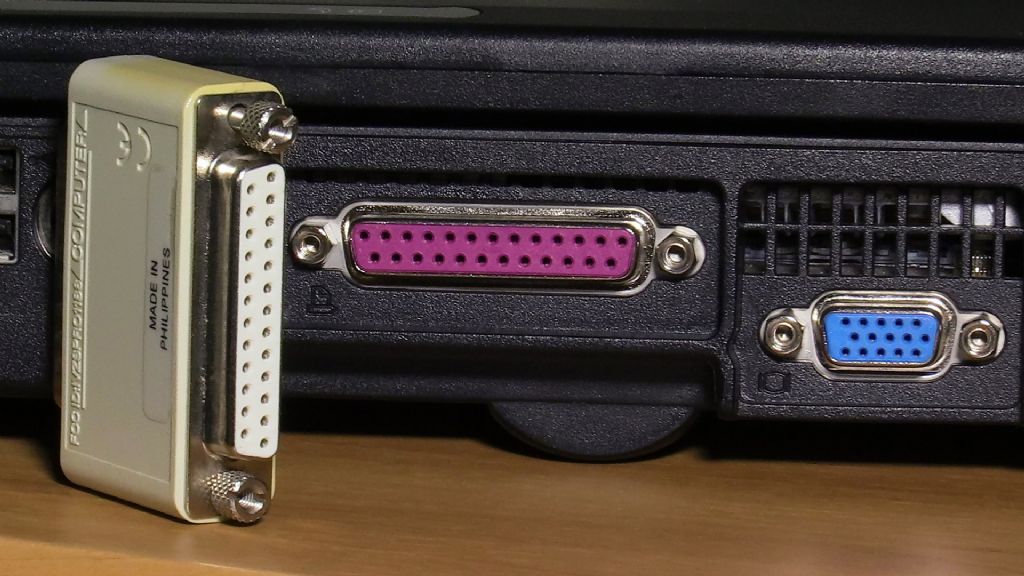

                                      Gentlemen,
                                      After such an overwhelmingly wonderful and generous response, it is pertinent at this stage, for me to reconcile the issue.
                                      Before I do, I thank everyone for contributing so much in such a short time. I must also apologise if calling the dongle/PC an RS232; that’s what I thought it was.
                                      Despite the inconvenience of jumping between machines, the amount of use the CAD package would get from me, the very unhelpful response from the software company, the probability that the dongle was potted, and being rather long in the tooth myself, I’ve decided to abandon the idea.
                                      Many thanks once again.
                                      Seasons Greetings to everyone, and make plenty of lovely swarf in 2018.
                                      Sam

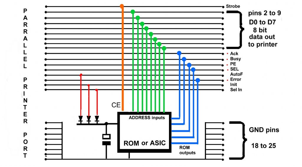

                                        john swift 1
                                          @johnswift1
                                          a long time ago I found a photo of a parallel printer port dongle on line
                                          it had 3 diodes , a capacitor and an IC
                                          ( not that I can find it now !!!)
                                            it will need plugging  into  a parallel printer port at 378 hex
                                          depending on how early a dongle it was
                                          it could of been a ROM powered by a few pins set High (5V)
                                          with the data lines set to one ROM address
                                          the resulting KEY data being sent to the printer ports status inputs
                                          (with an ASIC or PIC chip the key data can be encrypted)
                                          the dongle could of been like this to pass all lines through to a printer —
                                          serial versions that plugged into the RS232 ports have been made
                                          PS
                                          seeing the ground pins 18 to 25 being connected together could distinguish the dongle from a RS232 serial version
                                          Edited By john swift 1 on 19/12/2017 00:58:12
