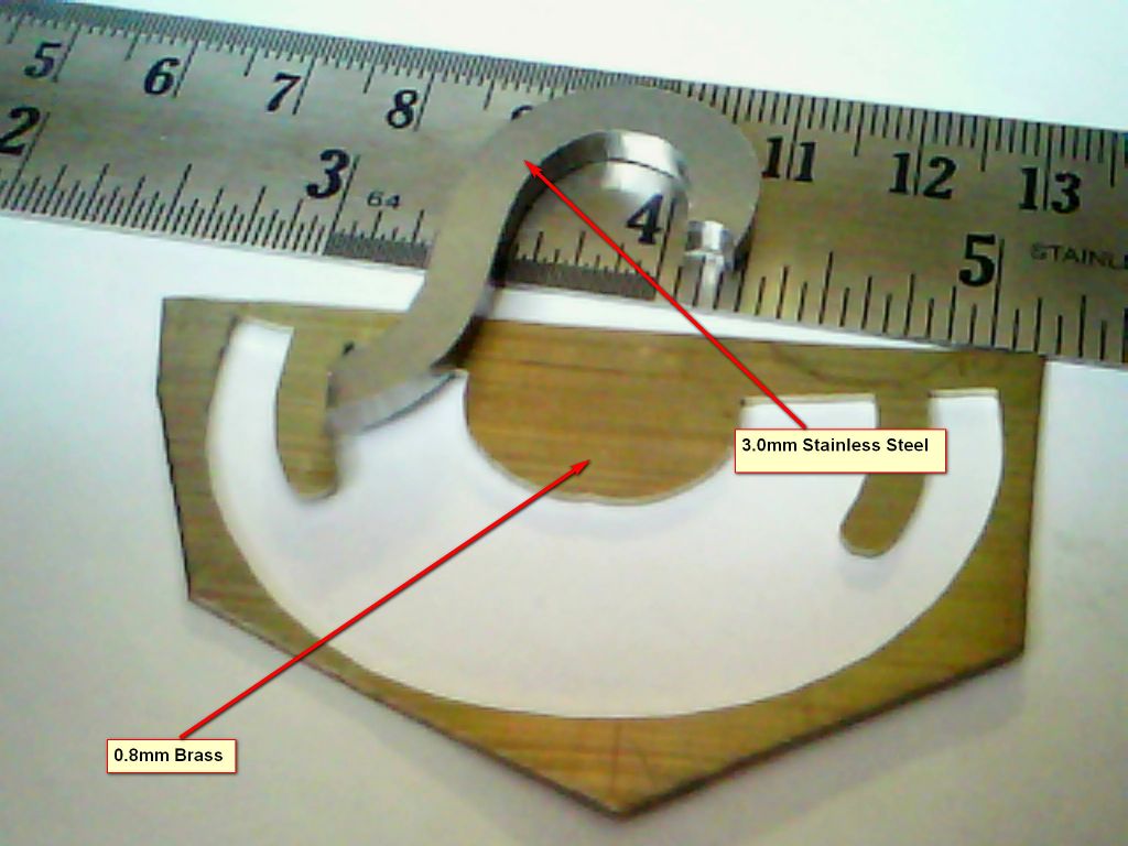

                                If you want to saw intricate shapes in metal, there is really no substitute for piercing.
                                The photo shows the offcuts from a job, one offcut is 0.8mm brass sheet and the other is 3.0mm stainless steel sheet, both were cut using a 6/0 piercing blade – that's .007" thick and .014" deep.
                                Sizes of piercing saw blades can be found HERE

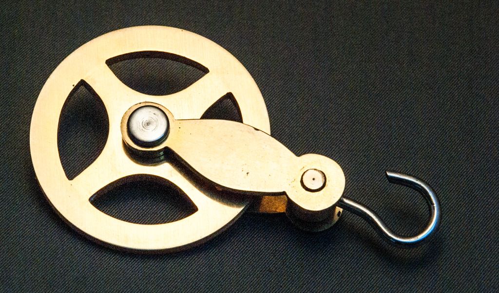

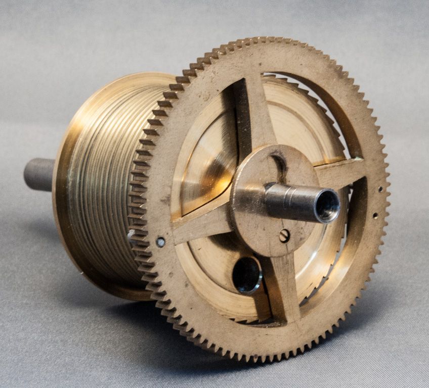

                                    Here are a couple of bits I made for a clock where I used the piercing saw
                                    It is very rewarding!
