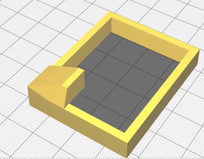

                I dreaded doing this from day one, so as our Chester lathe and Sieg mill both have the same rotary rev-off-fwd switches I printed a little stopper. It fits tightly to the sides of the square switch bezel, but can be slid up and down to prevent the switch being put into reverse without first moving the stopper. It has worked so far (touch wood). I haven't got access to the machines right now so cannot take a photo, so here is a render of the STL.
                Brian G
                (Edit: In case it is any use to others, I just posted it to Thingiverse as Reverse Lockout for Chinese Lathe )
