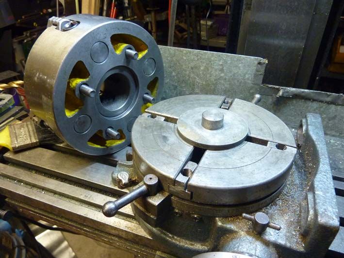

                    pauljames
                      @pauljanes79128
                      This is how I mounted a 6" 4-jaw chuck. Made a location spigot to centre the chuck and bolt directly to the rotary table. Centre location of the chuck on the table is not that critical as the job is centred with a DTI as long as it is secured soundly. A 4-jaw chuck is more accurate than using a self-centring 3 jaw and also allows the holding of odd shapes.rotary table.jpg
