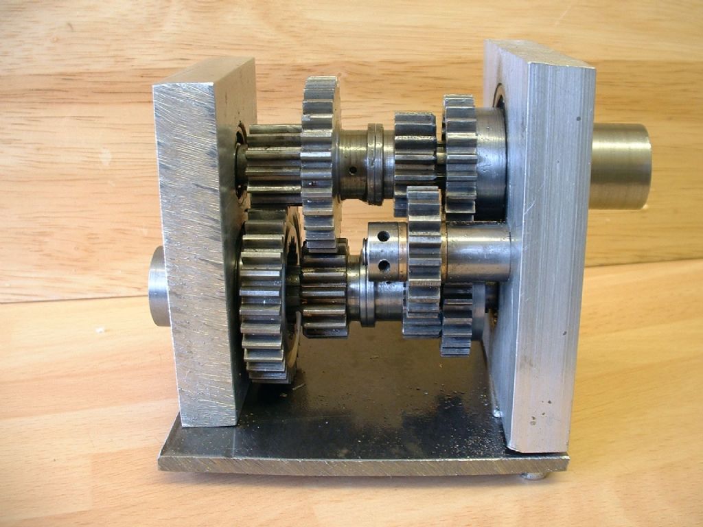

              I have usd Ivan Law’s book for all the gears below. I extrapolated the gear tables for cutters 7 and 8 with a 20-degree pressure angle. The 13 tooth pinion in the pictures was made using the values D=4.50, C=5.65 E=2.25 (as per table on page 114).
              You can only judge the form by the way the gears mesh! I have made a fair few now and only two were slightly tight and needed easing at the root of the spaces.
              Note that on page 106 the bevel gear calculations should use COSINE not SINE – this is a well known error that only shows up when the two gears are of different sizes. The tiny pair of bevel gears (80 DP if I recall correctly) were done this way.

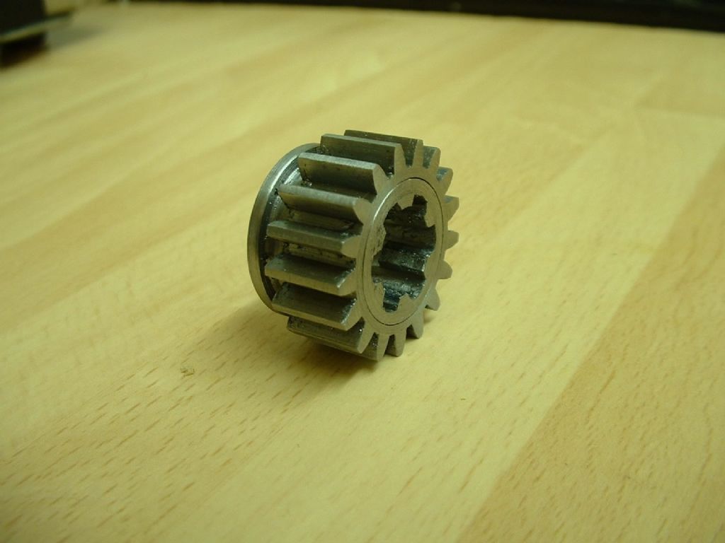

                        I have made a few gears by filling a bit of gauge plate to fit the gap between two teeth on a similar gear. Tubal Cain admitted this was his preferred approach.
                        I started off making cutters with two discs, but there is much more risk of chatter (especially as you are using them on 1″+ diameter silver steel) than with one disc, also I can easily move the topslide across with an accuracy of 1 thou for the second cut, try supergluing two cutters into drilled holes with that accuracy. You also avoid errors caused by the form cutter not being dead on 90 degreesand getting an assymetrical cutter.
                        Another tip – always take a tiny skim over the blank with the crosslide index set to zero. that way the infgeed of the form cutter will always be dead on.
                        I always, use single point cutters. I even bouight the stuff to make a eureka but cutting gears is so theraputic – gently turning the feed so it goes a thou or two for each tick of the cutter.
                        When making the gears, the cutter is DEAD on centre height of the blank, as close as you can get it, more critical than you might think, a small error gets doubled making teeth look wonky (though they will probably still work). Take care if cutting harder steels; I managed to blunt a cutter very quickly on medium carbon steel by going too fast.
                        If your gear blank is slightly undersize reduce infeed a little to maintain centre distances. Cut a little deep if you want extra backlash.
                        When cutting gears cut a whole ‘space’ in one go. Use gentle infeed to keep the cutting depth right.
                        Silver steel or gauge plate cutters work fine on brass or most steels.
                        Yes, it is possible to reset the blank and take another cut if the gear is too tight/you don’t feed in enough.

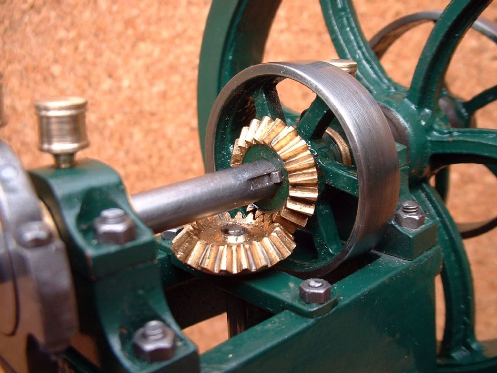

                            Just in case you or others are interested the balls were treated as described above and though still quite tough to drill softened sufficiently to drill a 2mm hole about 8mm deep – had to keep the speed well down though to prevent work hardening particularly when using the 1.5mm pilot drill. The balls oxidised quite a bit but after a soak in Hydrochloric soon ’emeried’ up to give a ‘turned finish’
                            No breakages however and as of tonight here’s how it looks so far

                                  Well guys after a few trials and tribulations and thanks to Neils valuable advice I was finally able to make sense of the info I had and after a couple or three mishaps eventually managed to produce a set of bevel gears.
                                  The information for the tooling to make the cutters was taken from an article by DAG Brown in the Sept 94 issue of ME and proved extremely easy to follow. They mesh and run well without binding or tight spots so I’m well pleased with the results asmaking gears is a first for me.
                                  The balls are still held by Loctite – the nuts are false ones, the washers beneath are concave to sit tight against the surface.
                                  Detail pics are on the HMEM site which I’m sure most visit so apologies to those who’ve already seen these.

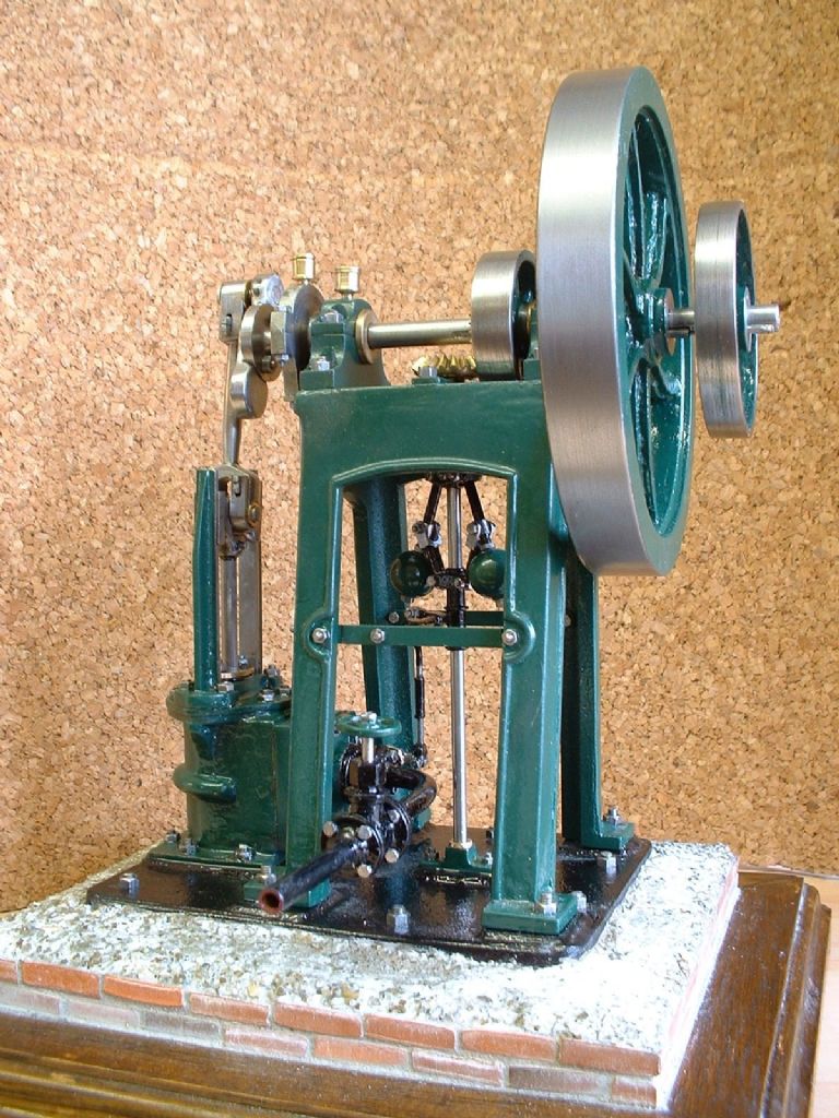

                                          Well its took a bit longer than anticipated but pleased to tell it is finally finished. There are several pics on here but for those who don't visit HMEM heres a couple taken as of today
                                          And now – garden permitting – it's time to get back to another I/C engine – diesel of coursewink 2
