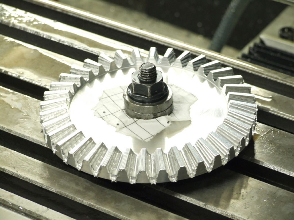

                  As Jason has said I do have some pictures of cutting helical gears, some are also on you tube.
                  This is an interesting one
                  Unfortunately not a good video as regards showing what it can do. The program Cut3D cuts in raster passes and you get a choice of doing a clean-up pass at 90 degrees to the first and that is what this is doing.
                  This is the reason it doesn’t look to be cutting, it is, but only small clean-up cuts in places.
                  I should have videoed it on the first pass but never thought to get the camera.
                  Another problem is the step over, because this was the first time and I had no idea who it was going to turn out I increased the step over between cuts to save time at the expense of quality.
                  However as a concept operation I thought it came out well, the gear in question is about 2 1/2″ diameter and cut with a 2mm ball nosed mill, cutting time was around two hours, programming time was about 20 minutes from a CAD model from SPI gears site on the web.
                  At the moment there is no way to cut one of these in the homeworkshop. The Shay gears cut by the Japanese guy are not true spiral bevels but offset bevels, a different animal. As I say just a concept to prove what can be done.
                  This is another one.
                  Just using a standard 3mm 3 flute end mill / slot drill, no special cutters.
                  Watch at about 2:00 into the video after it has blocked the tooth shape out. It then proceeds to move over in the Y and rotate the gear to do a shaving pass, basically mimicking a Sunderland gear planer that shave the involute shape on in a series of very small steps.
                  John S.

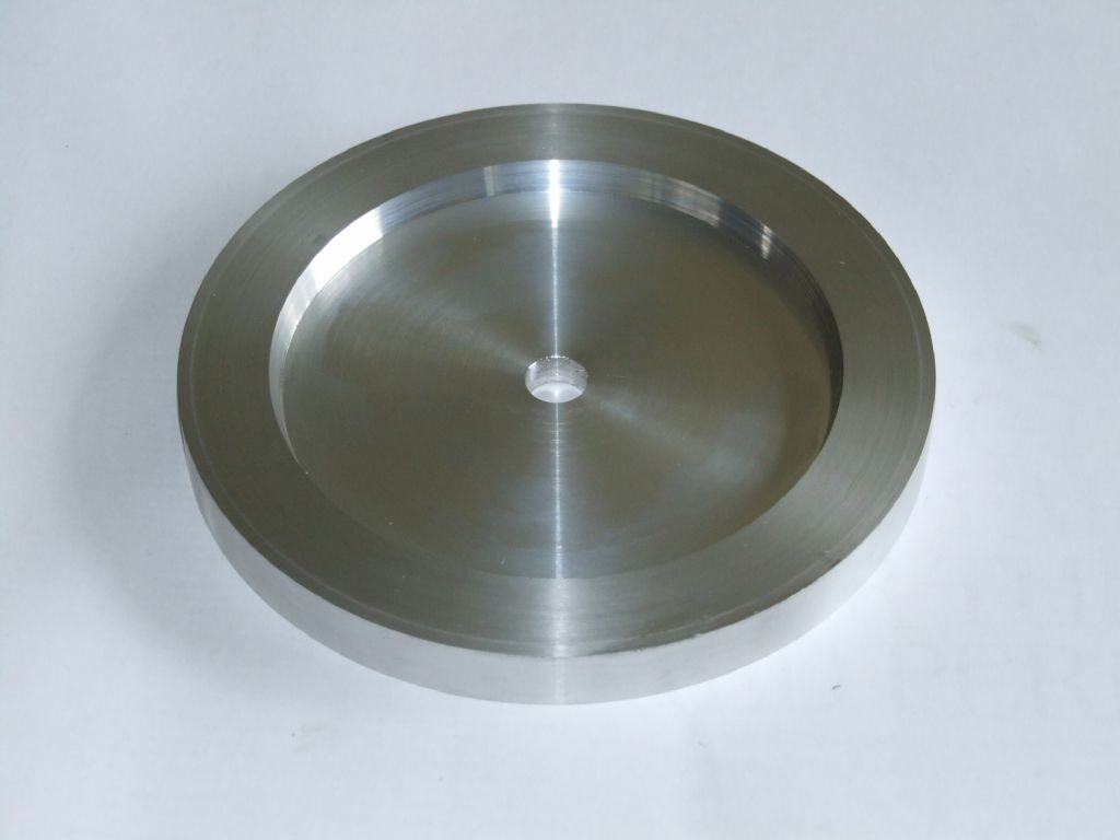

                      #70515
                      Anonymous
                        So, for my 400th post on this forum, I am proud to present another load of grossly over-engineered twaddle.
                        After a bit of a delay, partly due to work and partly due to toolpath issues, I’ve finally finished machining the prototype crown bevel gear. In one sense this is more complex than the pinion, in that the radius at the bottom of the tooth requires a 2mm cutter, but clearly it wouldn’t be sensible to use that for roughing out. In the end I roughed out with a 4mm cutter, did a quick clean-up pass with a 3mm cutter and finished with a 2mm cutter. On the other hand the crown wheel is simpler than the pinion, in that it does not require the use of the 4th axis.
                        The crown wheel blank:
                        After roughing out:
                        And the finished gears:
                        The gears mesh together extremely well; better than one might have thought looking at the finish. All I need to do now is make the real gears in cast iron.
                        Regards,
                        Andrew
                        PS: If you think this is over-engineered, you ain’t seen nuffink yet, wait till I get onto the steering gear.

                          Hi Andrew, how did you get rid of the machining marks on the crown wheel, that it was a graphic at first!
                          Since this is all done for pleasure and recreation, not sure why over-engineering is a problem Unless it causes it to be too heavy or too expensive of course. I’d have gone broke years ago if I needed to make a living off the models I make

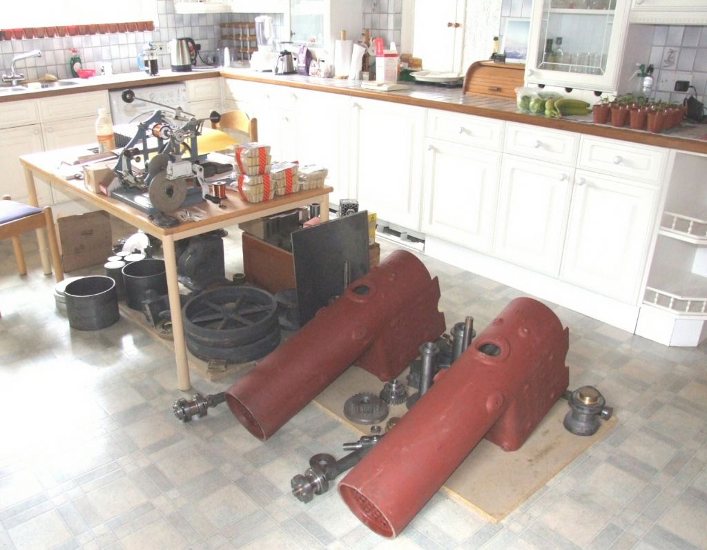

                                                A friend from Japan sent me this Email
                                                Legarding what you are looking at
                                                I can make thousands of these items velly cheaply and incluse a fully operatonal manual.
                                                toung in cheek
                                                smile it could get worse she indoors could ask you to do some work in the house………

                                                  #75431
                                                  Phil P
                                                    @philp
                                                    That is absolutely disgusting and not very hygenic at all.
                                                    I really cannot believe some people and the things they do.
                                                    Do you not realise that having plantpots on your worktop is not a good idea.
                                                    Phil
                                                    #75432
                                                    blowlamp
                                                      @blowlamp
                                                      Agreed Phil.
                                                      Look at the ridiculous way that food resides on the worktop, whilst precious metal has to make do with the floor.
                                                      A classic case of mistaken priorities – I’m genuinely shocked
                                                      Martin.
                                                      Edited By blowlamp on 26/09/2011 13:53:31
