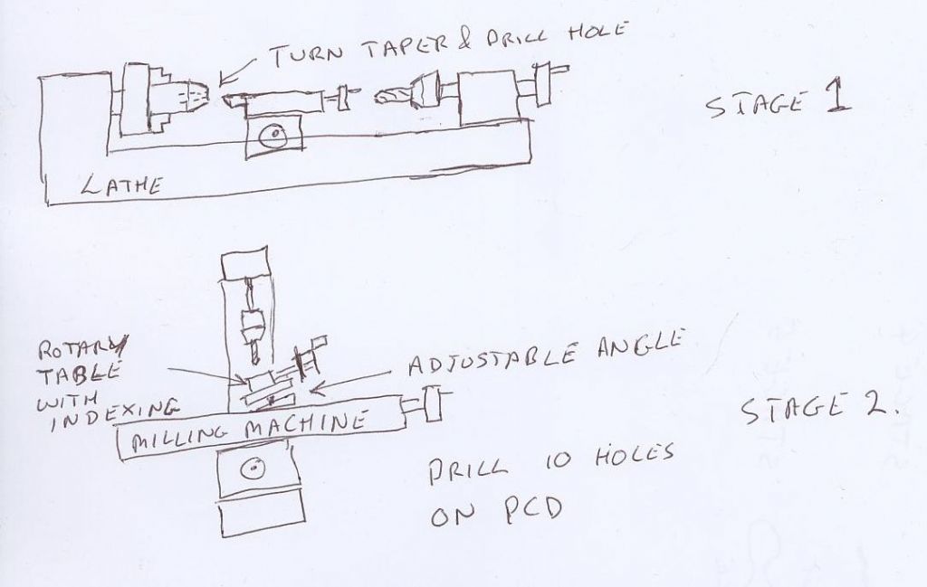

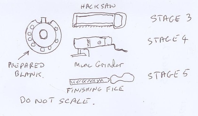

              I’d use my grandpa’s old hacksaw and finish the teeth off with a nice rat tailed file I bought in Woolworths about 30 years ago; I can work to about 2/10 of a thou with that file, who needs CNC
              Donald
              In Bonnie Scotland

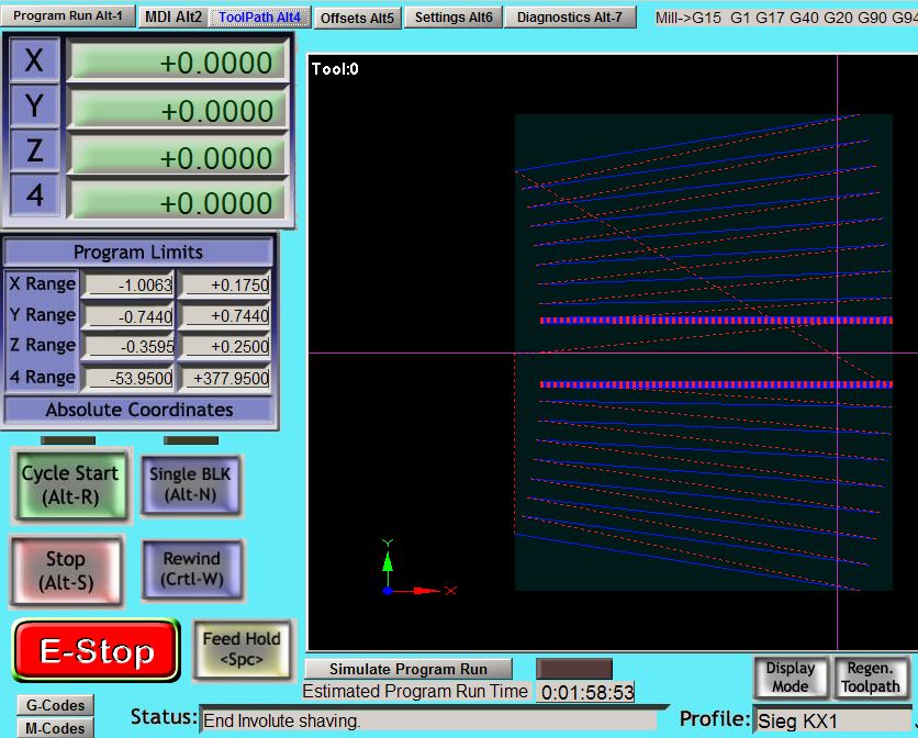

                                Then we get the CNC option, again needs tilting dividing head driven by stepper, now I have had to do a bit of guesswork here as Andrew hasn’t given any detail on the mating gear and this controls some of the parameters so I have taken a guess at a 10 tooth driving a 45 to get a pitch angle matching the photo.
                                Literally 10 minutes work filling boxes in gets me this.
                                This drawing now gives me all the information I need and 5 minutes later i have the code for this [ which i don’t need to look at, just load it and Mach3 tells me it will take 1 hour 58 minutes and 53 seconds to cut this.
                                And this on the little KX1 mill, run time just below the screen.

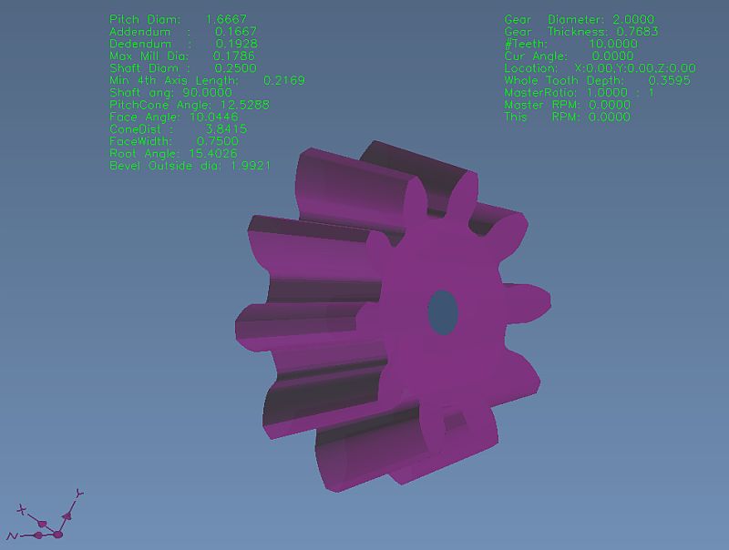

                                                      Having spent some time working through the design of bevel gears I concluded that the drawings are slightly wrong; 3 thou out, not much, but 3 thou is 3 thou! It is not possible to machine a true bevel gear on a horizontal mill; it needs some adjusting afterwards and needs a special cutter. So naturally I turned to the parallel depth method. I did in fact redesign the whole differential using parallel depth bevel gears. I did, of course, consider buying ready made gears from my supplier, but I wasn’t terribly happy about the quality, the gears were expensive, and being awkward I wanted to machine them myself. Eventually the little light bulb illuminated (dull of course as it’s an energy saving bulb) and it occurred to me I could CNC mill the gears.
                                                      Obviously to do this I needed a solid model. Easy enough to do in principle; I knocked up a basic gear in about 30 minutes. But as always the devil is in the detail. We all know that the tooth form is an involute curve, but how do you draw an involute curve in the CAD system. What part of the involute curve do you use, which of the infinite number of involute curves is correct, what about undercut clearances and root radii? It took me many hours of book buying, reading, drawing and internet searching to sort all this out. Plus the inevitable wobblies with the CAD software. In contrast the CAM program and G-code generation was fairly quick, apart from an annoying bug in the CAM software. For some specific operations the G-code generated didn’t agree with the toolpath shown.

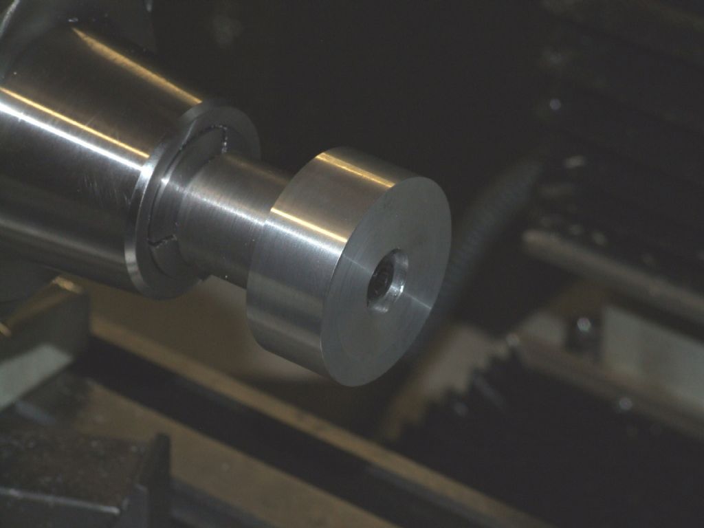

                                                      Here’s the sequence of machining, first the blank, it’s just a cylinder, diameter and length are easy to get from the CAD/CAM system.
