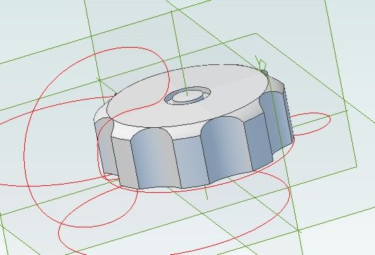

                        Just to a prove a point, I tried using the parametric editing to convert that into a different knob. I changed diameter and centre distance of the circle that generates the scallop, and increased the number of them. Took about two minutes, an expert would do it faster!
                        It did take a bit of effort to get the hang of it, but some advice from the chap who's writing the tutorials and I'm getting the hang of it now!

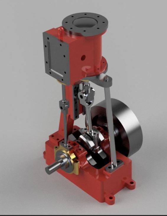

                            Neil, couple more evenings practice and you will be able to draw whole engines, this is where the parametrics come into their own as if you alter a 3D part it will automatically make the same alteration to any 2D drawings, assemblies or sub assemblies.

                              Wow, that's impressive Jason!
