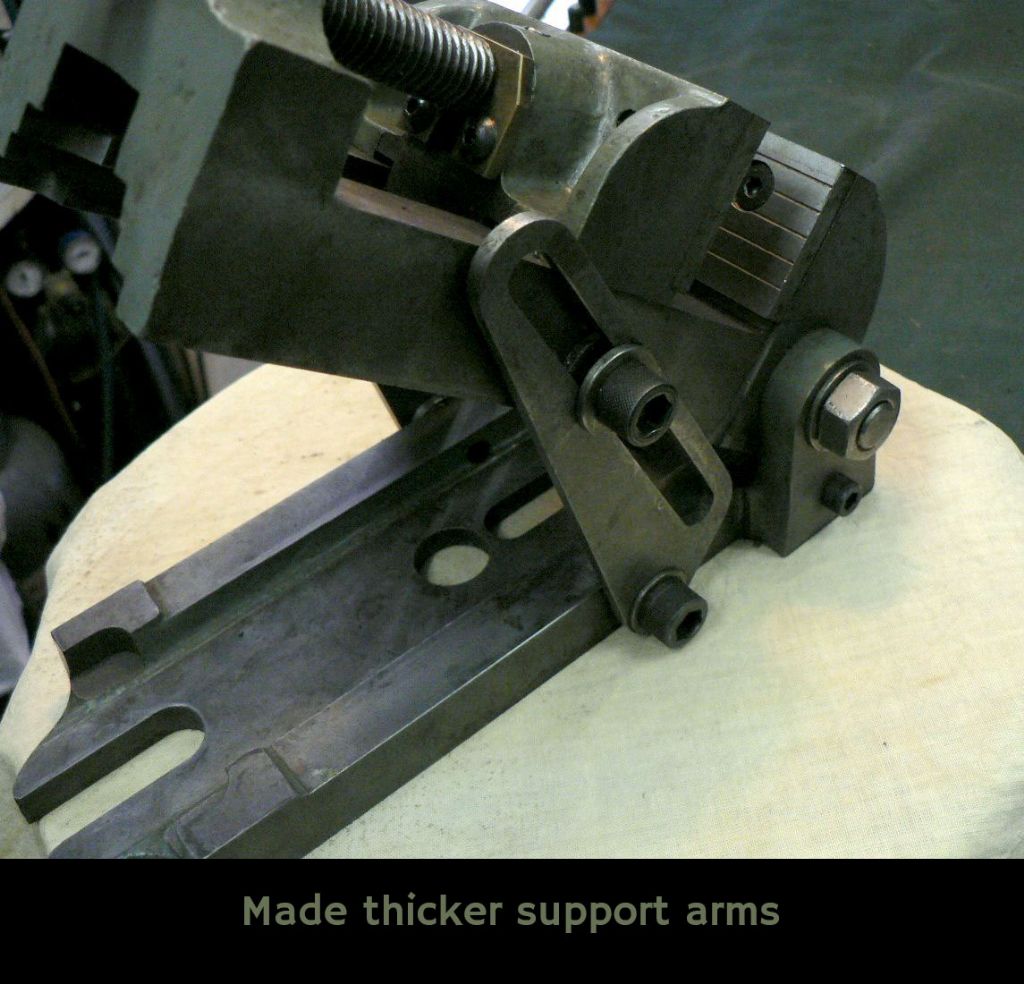

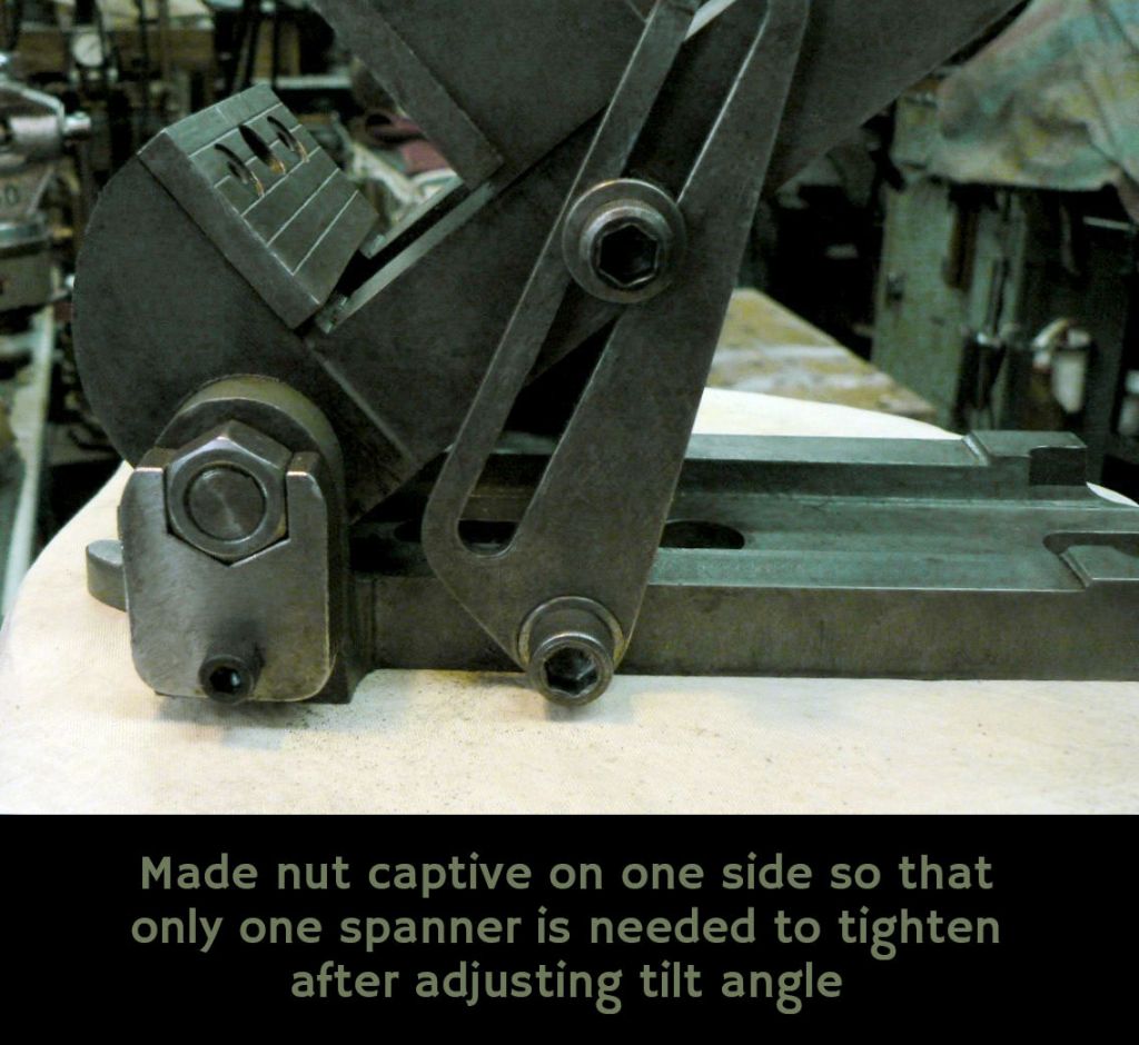

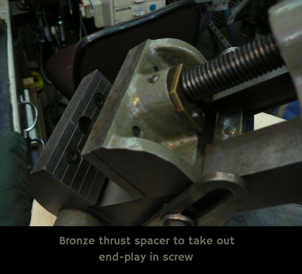

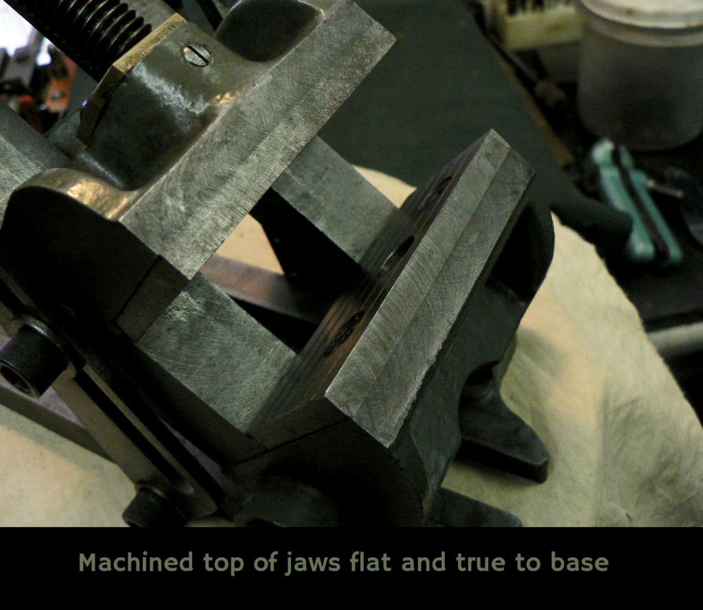

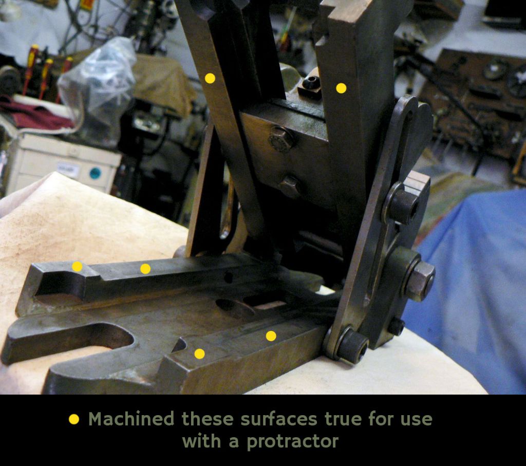

          Peter, I have some pics of what I did with mine. Quality was not bad. (Also about 30 yrs. ago). Will post pics if you're interested.

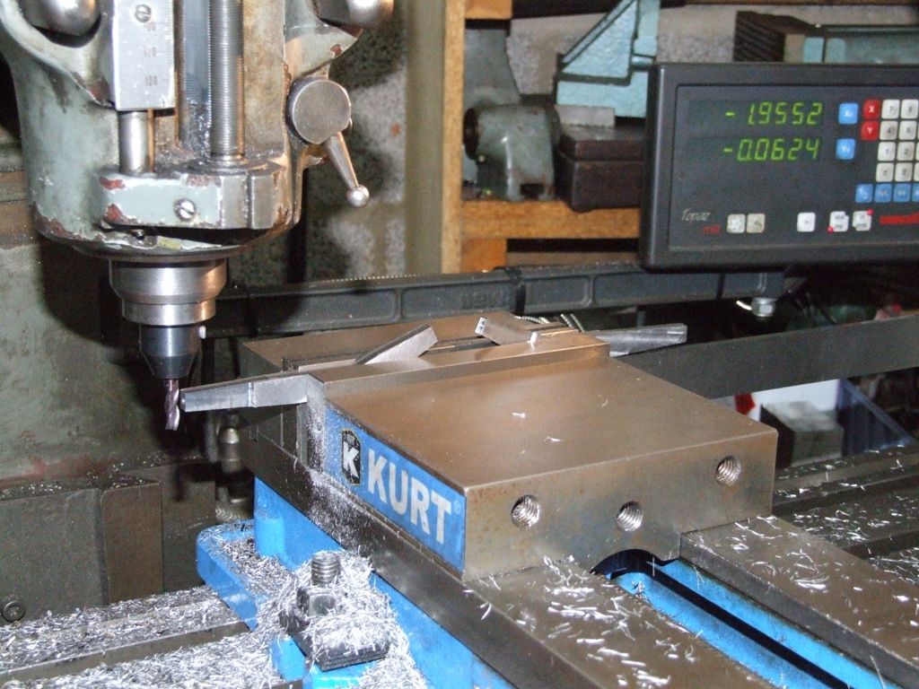

                    Posted by Peter Jones 20 on 28/12/2020 07:27:24:
                    …………. (in USA KURT is the one to get) …………
                    Same in the UK:
                    Apart from cost the main issue with Kurt vices is that they are too big for most hobby mills.
                    Andrew

                      Here we go Fatgadgi……..

                        Many thanks for showing your pictures of improvements. I have a similar vice and needing two spanners has really bugged me, will do that improvement tomorrow. Many thanks John

                          RobHK, interesting additions, particularly like the main screw thrust washer and Allen bolts plus machining surfaces for angle plates.
                          I was considering thicker side plates from a better material, definitely doing it now.
