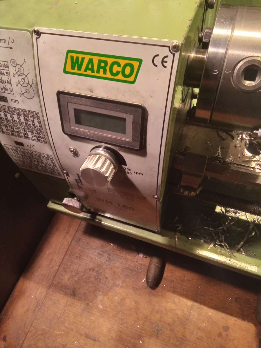

      The speed control potentiometer on my lathe is showing signs of failure once again. I’ve found these devices, regardless of the machine manufacturer/supplier, tend to have a tiresomely short life. Does anyone have any recommendations for a type or brand which might last a bit longer?

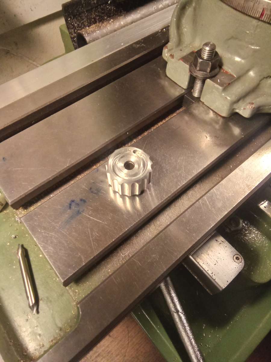

                            The new pot arrived this week – what I hadn’t realised/noticed was that there are no stops on it, i.e. if you keep winding it clockwise it goes to max and then drops immediately to minimum, and vice versa going the other way. Not really what you want for a lathe (in fact, why would you want this behaviour?).
                            I thought of sending it back, but the old one was failing rapidly, and I wanted to use the lathe this weekend, so I bodged up a knob with a groove and stop underneath, to engage a stop screwed through a backing plate. I didn’t spend an awful lot of time or trouble on it,but it works OK. The potentiometer has a smoother action than the rather gritty feel of the original, and the speed control is much finer, so worth doing, but if you go for it, make sure you don’t get one listed as ‘continuous’ or you’ll have to fool around making a stop arrangement too.

                                Nice neat modification to that knob, Andy
                                … I hope you will be happy together !
