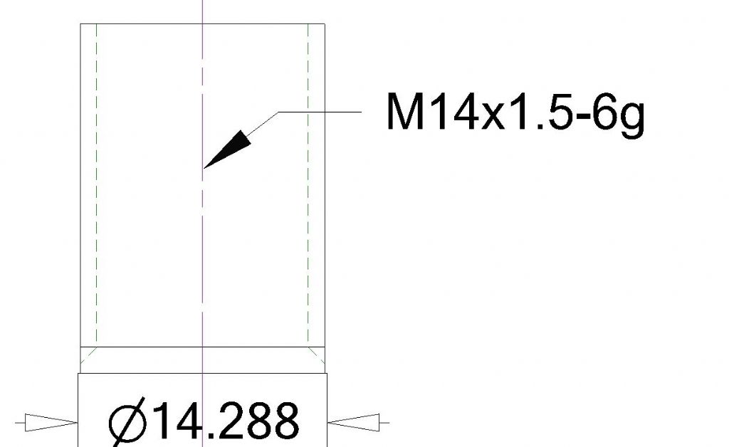

        The source of confusion, I think, Jason is this page, where the clearance diameter of D is given as 14mm and then qualified, in brackets, with the words "9/16" UNF stud" .

              Posted by Bill Phinn on 24/09/2023 15:28:39:
              Thanks for posting that link, Bill yes
              … I can feel my sanity slowly creeping back.

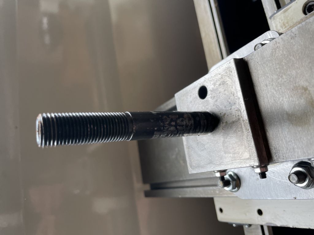

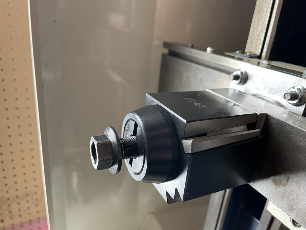

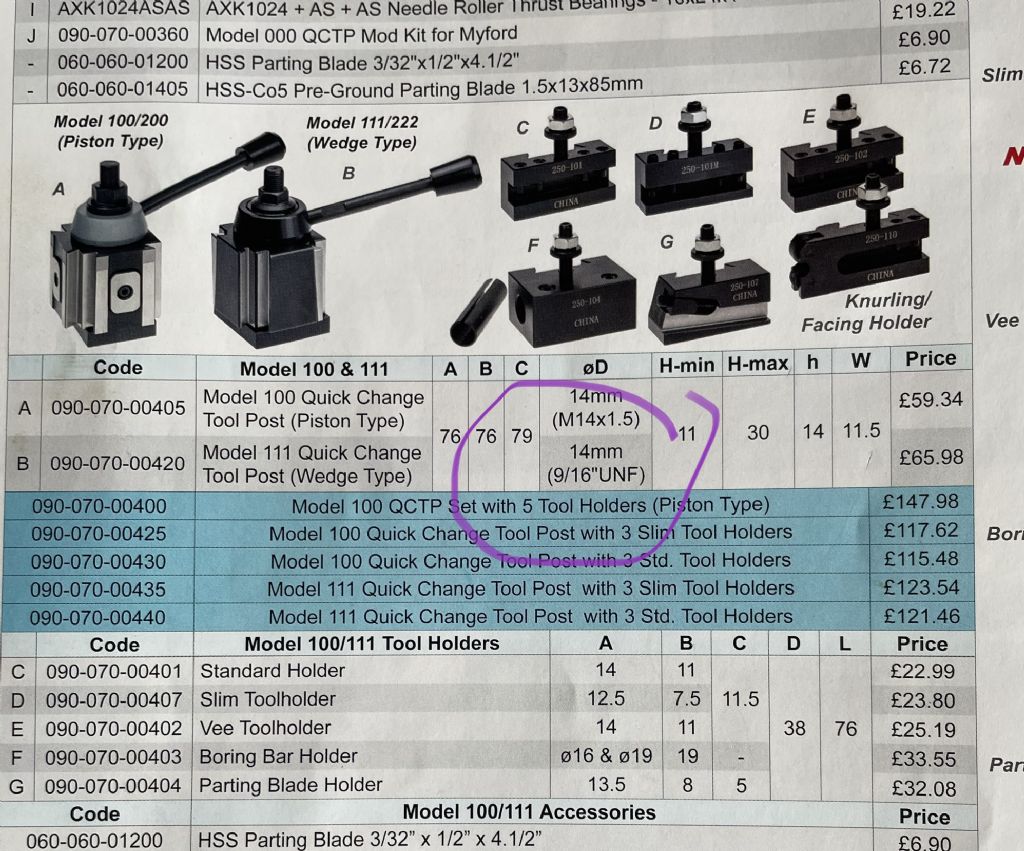

                  img_5768.jpegimg_5767.jpegimg_5766.jpegHi Bill and chaps,
                  ok, so the attached photos show the new ‘sleeve’ stud from LMS in place.
                  the second shot shows the nut sitting on top – it won’t turn anymore than this.
                  also shown are the arceuro catalogue page which gives the spec of the 111 QCTP and lastly, the LMS webpage spec for the ‘sleeve’ stud…

                    img_5765.jpegNo idea why the page doesn’t post the pics in sequence either!
                    here is the ‘sleeve’ toolpost in place….

                        Margaret, right, now I understand your confusion.
                        Where did the middle screenshot of the three in your second to last post come from?
                        It's misleading in its presentation.
                        Out of curiosity, where did you source your toolpost, we know the stud came from LMS?
                        I believe the 111 toolpost and the stud details you have circled, in column D, is likely to lead to a misunderstanding
                        That toolpost will take either a M14x1.5mm stud with the appropriate nut, **OR** a slightly larger diameter 9/16" UNF one.
                        The nuts are not interchangeable between studs.
                        The model 100 in row A above may **ONLY** take a 14mm stud as it likely has a smaller hole, so 9/16" won't fit.

                        Margaret Trelawny
                          @margarettrelawny34058
                          Hey Bill.
                          Lol – glad I am not going mad!
                          the middle pic is from the arceuro printed catalogue.

                                OK, I think I've got there folk (maybe )
                                For whatever reason related to Margaret's lathe, the studs supplied by Ketan don't fit.
                                She needed a stud where one end is internally threaded M8 and was able to obtain one from LMS
                                https://littlemachineshop.com/products/product_view.php?ProductID=3712&category=521186833
                                This has an external 9/16" UNF thread, and needs the appropriate nut.
                                The ArcEuro web site and paper catalogue differ slightly in their presentation, but the column which specifies the stud size/hole diameter is labelled as øD where the ø refers to the hole diameter's nominal size.
                                On the web site, The 101 toolpost says øD 14mm (M14x1.5mm Stud)
                                But for the 111 toolpost says øD 14mm (9/16" UNF Stud)
                                i.e. same hole diameter, but just mentions a different stud; likely either will fit.
                                Ketan supplies a stud suitable for an SC4 lathe, but that has an M12 lower thread and an M14x1.5mm top thread
                                https://www.arceurotrade.co.uk/Catalogue/Machines-Accessories/Lathe-Accessories/Tool-Posts/Model-100111-Tool-Post-Stud-and-Nut-for-SC4-Lathe
                                I'm guessing this was the source for the nut which doesn't fit Margaret's LMS stud from the US.
                                It looks like the ArcEuro stud wouldn't fit Margaret's lathe, hence ordering a suitable one, (threaded M8 internally), from abroad, which unfortunately didn't come complete with a suitable nut, though for a US buyer, they are readily available.
                                The end result is that Margaret just needs a 9/16" UNF nut and washer, which should be easily available.

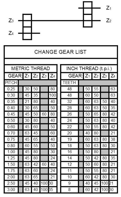

                                            I don't have an operational lathe at the moment otherwise I would have been in a position to make a special purpose nut for this job. What I can do though, which might be helpful to someone else willing to do so is provide the screw cutting parameters for a "mixed race" nut, based on Myford equipment.
                                            9/16 inch equates to 14.1 mm and 18 TPI equates to a metric pitch of 1.41 mm
                                            Gearing for Myford for that pitch will be a 25T driver coupled through 19 TPI for a gearbox lathe. Resulting pitch is 1.393 mm
                                            For non gearbox lathes [including ML10 and Super10] the gearing is 25 x 50 as drivers, with 45 x 63 as driven gears. The pitch in this set up will be 1.4 mm almost exactly
                                            So we finish up with an M14 sized nut threaded to 60 degree metric standards having a pitch of 1.4 mm.

                                                  Dear all,
                                                  thank you to each and every one of you for your offers of help and suggested solutions. Your kindness and support has overwhelmed me.
                                                  As mentioned above by Ketan, he and Ian at the wonderful arceuro have gone above and beyond to help solve the issue. Thank you both so much for your superb customer service – going the extra mile to help. I cannot thank you enough.
                                                  I take full responsibility for not checking the difference between US and European specs – had I had more experience I perhaps would have twigged there may be an issue. As Bill mentions above, it has been a valuable learning curve!
                                                  The 4-bolt plate from LMS for the saddle has fitted a treat with no issues and gives a real stiffness to the tool post mount – something lacking on the standard set up.
                                                  Again, I cannot thank you all enough for your help and offers to sort the issues. You really are a brilliant community.
                                                  Hopefully, with the purchased 9/16-18 nuts and the roller bearing solution – it will be job done. I will report back as soon as everything is installed and working with hopefully good news.
