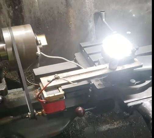

      Following the recent thread about the Stuart Dynamo I finally got round to testing a 775 motor to see if it would be worth using as the basis for a dynamo that could be driven off a typical model steam engine. Well the results are in and I can reveal  IT WILL.
      So the lash up consists of:
      My first steam model in the form of a Stuart 10V running on air at 30psi I’m sure I could build a better running one now.
      12V 3W LED cabinet light
      775 Motor with a bit of scrap ali bar and two O rings to pick up drive from the 10V flywheel.
      I’m not too worried about volts and amps as like most people I’ll be happy that the lamp lights up.
      So time to develop this a bit more and then make some swarf. There should be no need to extend the shafts as I’ll be cutting down the motor’s can so the brushes can be seen

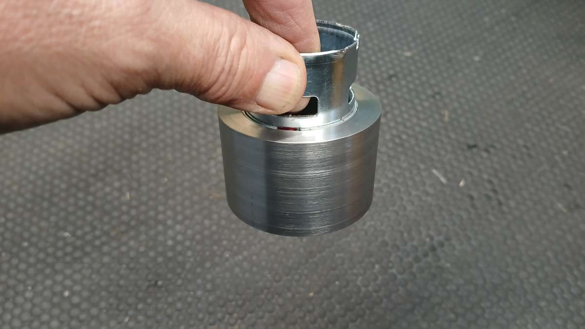

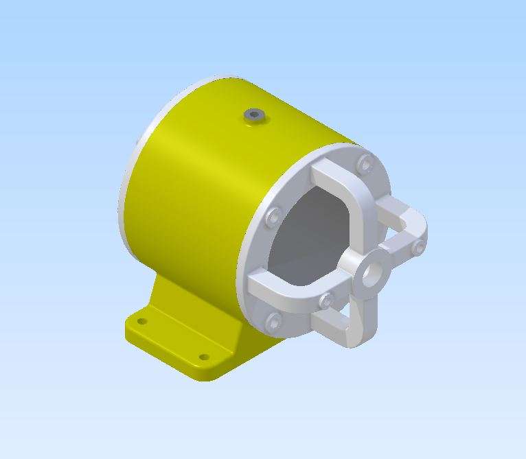

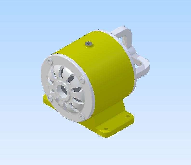

            Mine will likely come up a bit bigger. Currently thinking of 60mm steel bar as a 75mm length will do the “tube” and two ends although 2 1/2″ material is an option at a price and would allow for a bit of a barrel shape to be added. This will put it at about the same size as the Stuart and PM Research offerings.
            Boss on the top will just be a washer into a counterbore with the screw eye threaded into the ticker wall. The same thicker wall will allow as many fixings as I want into the ends rather than tie rods.
            Foot will more than likely be JBWeld and a couple of cap heads as it may help it appeal to those who don’t have silver soldering or brazing facilities. Like wise the 4 “L” shaped parts of the end cap, screws, dowels and JBW will do though they could also be soldered.
            I recon it could be done for £25 including the motor, not bad compared to the £300 of the Stuart kit.

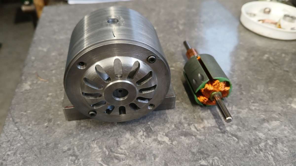

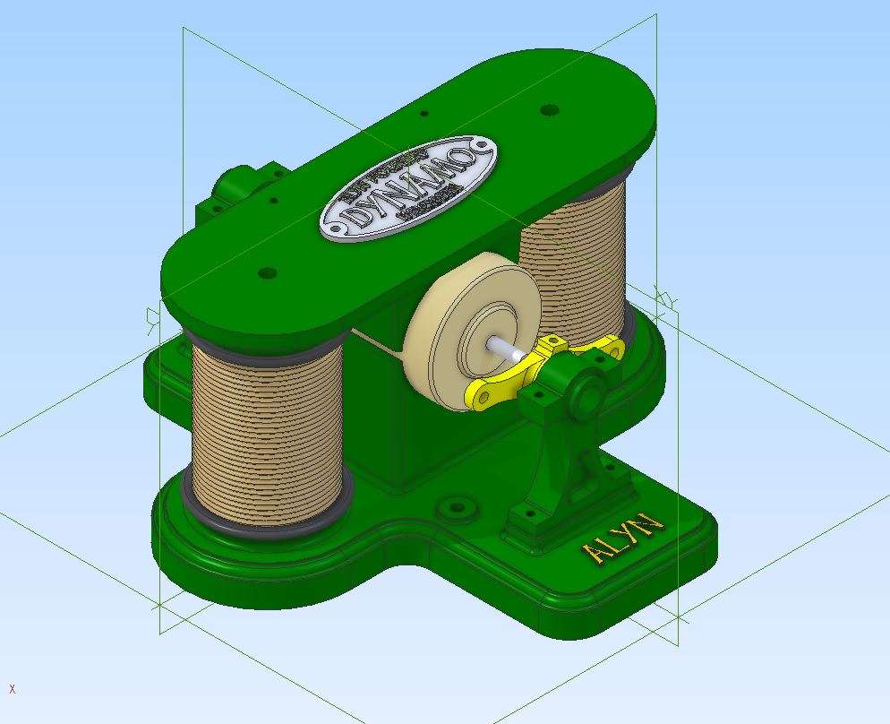

                  As mentioned in the Stuart Dyno thread. Been There and Done it. Well actually I did the CAD design and someone else printed it. Though it would be easy enough to use the prints as patterns to cast. Also just a couple of clicks and you can have it any size you want.
                  alyn dyno 2
                  alyn dyno 1

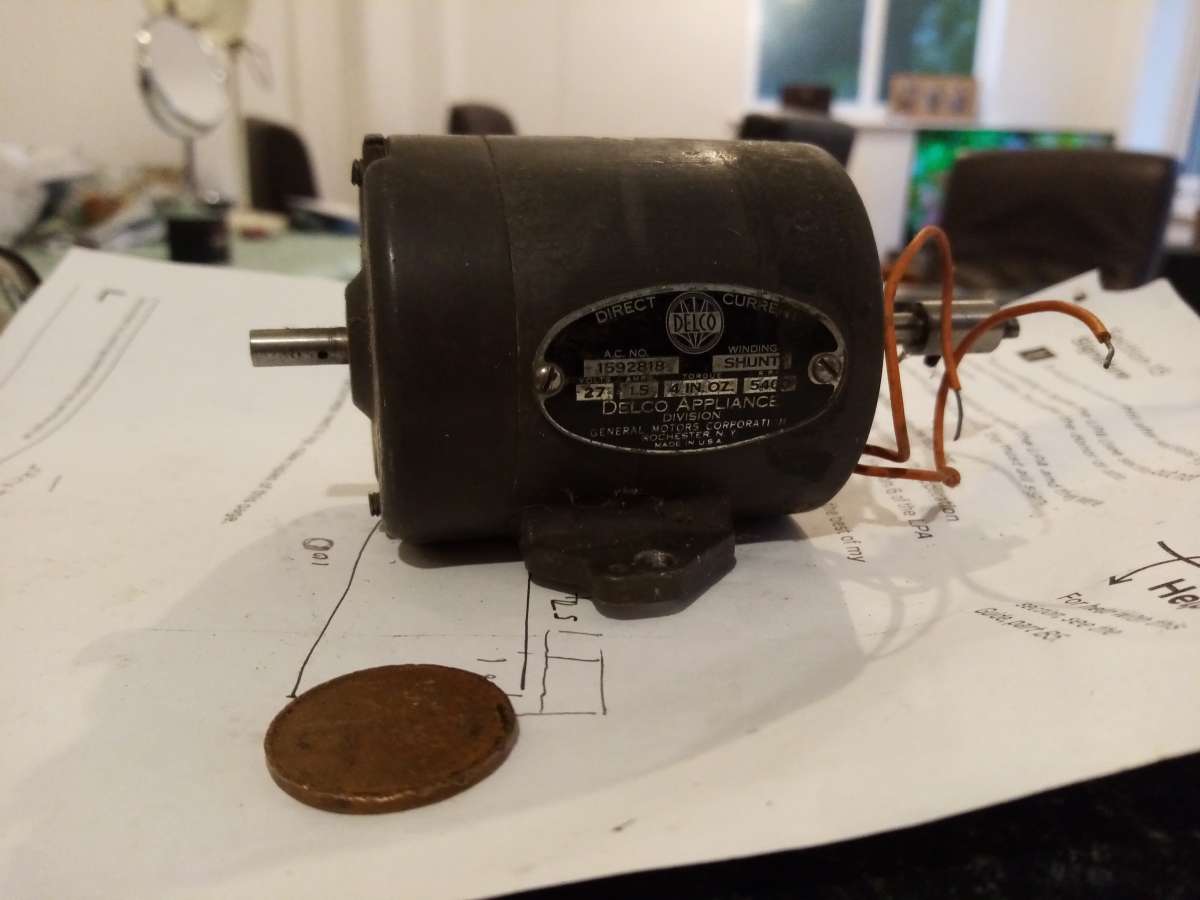

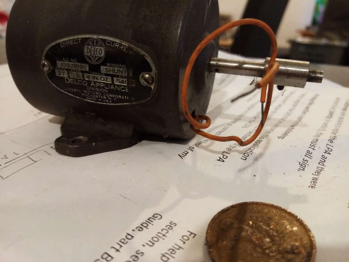

                      This isn’t a 775 motor, but it might have possibilities. The nameplate reads Delco 27v, 1.5 Amps, 4 in.oz, 5400 rpm, but it is shunt wound, which is unusual. I’ll never use it, if anyone wants it yours for the price of postageIMG_20241123_143704IMG_20241123_143718

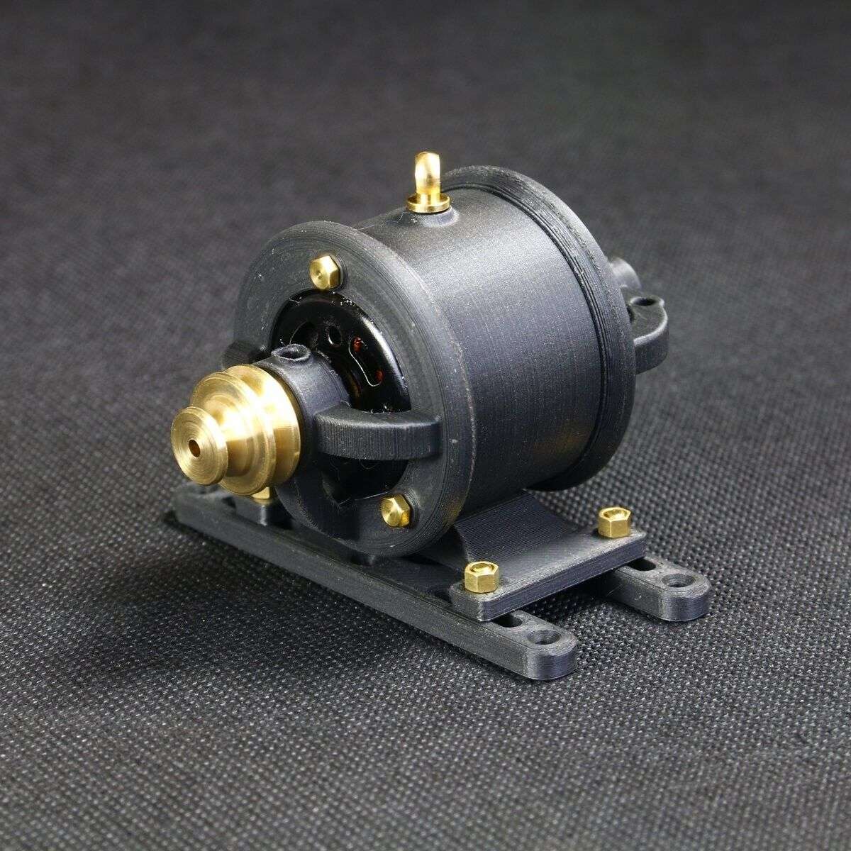

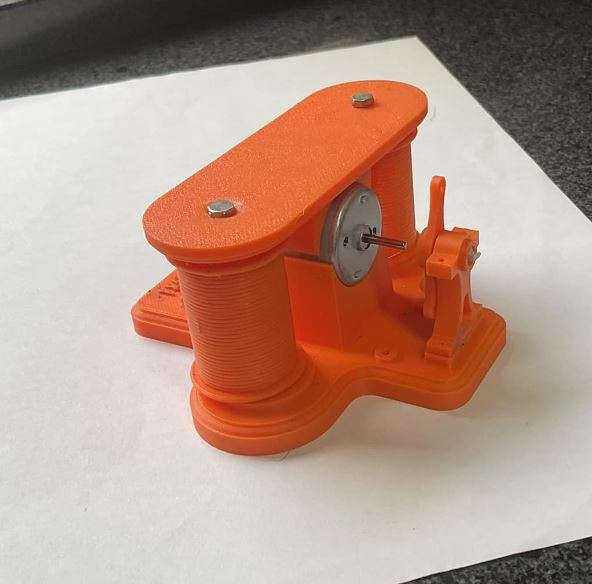

                        Further to Duncan’s comment about 3D printing, I spotted this on ebay while looking for something else, you can see it just fits around a standard motor.
                        3d dyno
                        Also available in metal from Bengs

                            #766684
                              Indeed, You could look at it a number of ways in relation to Martin’s thread.
                              Is it dumbing down things as I think Michael is suggesting by supplying plastic parts and metal hardware to put together.
                              Or is it simply moving with the times and using 3D printing to offer a reasonably priced model to the “toy engine” type collector who may not have machines.  Lets face it Stuarts, Bing, Wilesco etc have all been making ready to run or ready to assemble dynamos for years so the only real difference is the 3D printed plastic parts and making use of affordable motor parts. They have the metal option for those that need it and with all the milling work done will appeal to those with just a lathe.

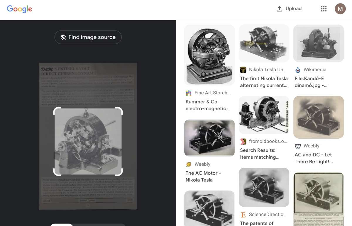

                              Another nice one posted today on MEM by someone who has the castings but no drawings, I’ve not heard of the make before.
                              GnM Dynamo
                              #766690
                                That looks more like it, Jason
                                … a well-presented project.
                                Edit: __ and although I drew a blank with the obvious text searches … Google Lens did quite well:
                                IMG_0325

                                    The forum did not come up as well as Google Lense, hopefully I will be able to see your specific image tomorrow.
                                    #766714
                                      Very frustrating !
                                      I will put a copy of the Google Lens screen-shot in my Gallery
                                      … it doesn’t get us much further, but I was reasonably impressed

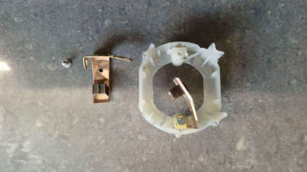

                                          A bit of progress for those interested. I’ll not show or say too much at the moment as it may go into ME.
                                          Snug fit of new “casting” around the can.
                                          20241123_104506

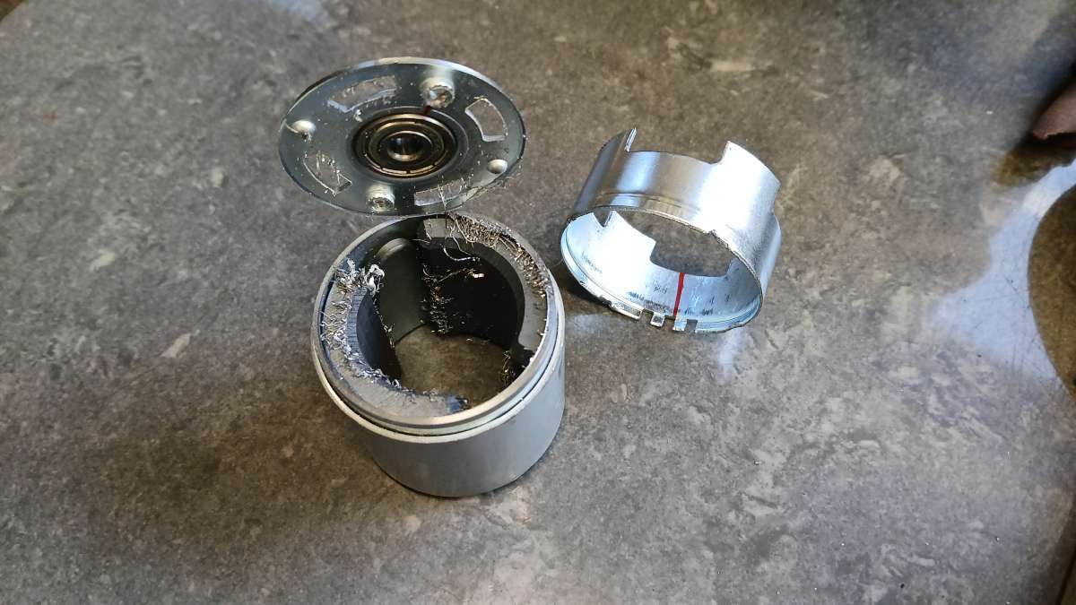

                                          A CCGT insert makes a good can opener
                                          20241128_144018
                                          May as well make use of the bearing, not sure about the spherical one at the other end as that used the can as one of the cups, bit of trial and hopefully not too much error needed before I decide.
                                          20241128_145806

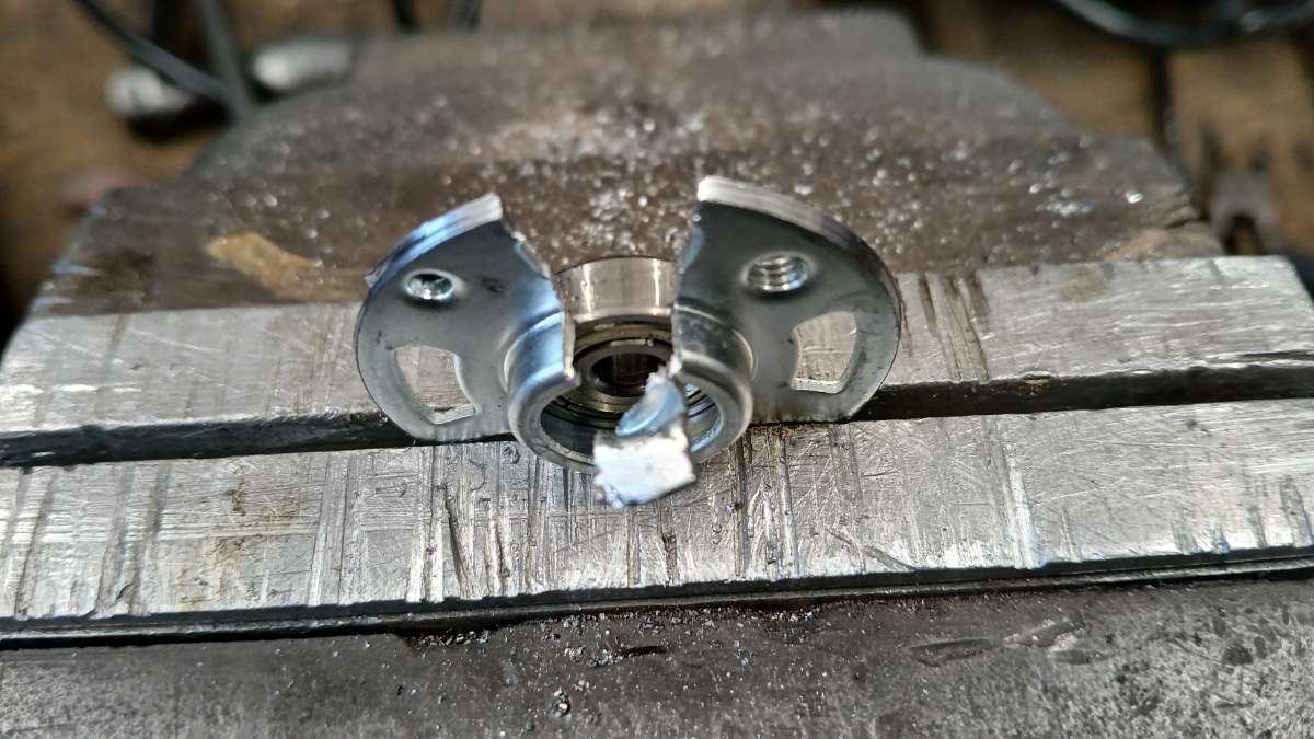

                                          Hope to use the existing brushes
                                          20241128_150144
                                          #767302
                                          noel shelley
                                            @noelshelley55608
                                            Ah, Yes ! You will undoubtedly beat me to finishing this, but you have  raised an interesting point Jason. I bought 2 x 775 motors, one £5 more than the other and having shafts at both ends all be it only about 3mm longer than the cheaper one, now I know how it is done !  The cheap one has a spherical solid bearing at the non drive end, the other has a ball race making it a bit shorter, they both have the same armature and shaft lengths. The bearing is a 625Z. I think Ketan keeps them.
                                            Re using the brushes if one can make them rotate about the commutator then one has some control of the commutation point and any arcing. Noel.
                                            PS tried using the CCGT insert as a can opener – beans everywhere !
                                            #767365
                                              I did not metion that I stopped short of cutting right through that end as I thought a snag could rip the remains out of the chuck as I did not want to grip it too tightly.
                                              Probably the easiest way to get adjustment would be to have short slots to hold the end cap on rather than just round holes. Though the remains of the motor and magnets could also be rotated in the new casing, pointed end on the lifting eye to lock it maybe?

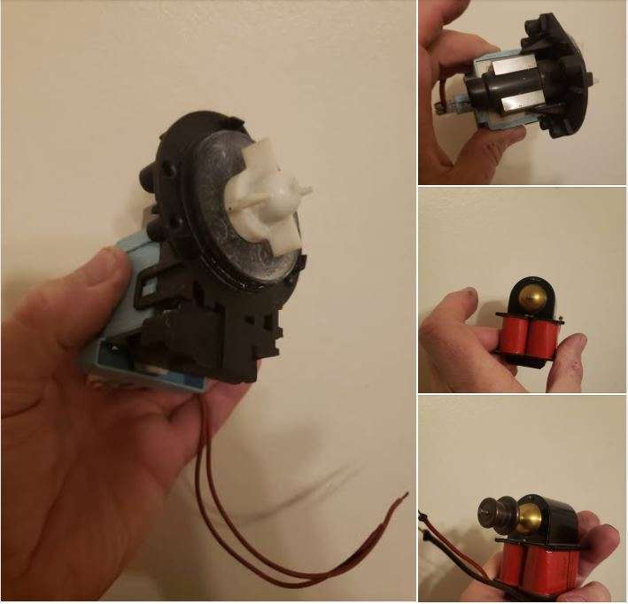

                                                      I’ve not done anything on the Dynamo this week as I wanted to finish a steam engine.
                                                      But to encourage others to have a go here is what has been going on on the Alyn Foundry FB group. Old washing machine pump converted to a more period look. Spun up on the lathe and lighting your common or garden 12V “Downlighter” lamp. Showing 5V AC at 2000rpm.
                                                      wm1
                                                      wm2
