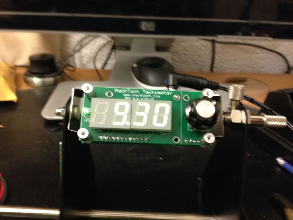

                    Muzzer
                      @muzzer
                      I looked at this fairly recently and although you can buy a simple tacho off ebay for pennies, I rather liked the machtach device. This can be set up for a variety of different pulses per rev, so you could trigger off a reflective sticker or a gear and it supports a variety of inputs including IR reflective, Hall and VR sensors.
                      To me, the most appealing feature was the ability to specify a cutter / workpiece diameter and then display the surface speed in feet or metres per minutes. This works for both lathes and milling (and drilling) machines. I bought the kit and built it up without any problem, although you can buy it ready made if you prefer. Nicely developed and very flexible. The postage was actually cheaper than advertised and the guy refunded the difference. I have a second kit to build up for the lathe when I get a round tuit.
                      Working on the bench!
                      Simple and easy to use – recommended. More pics in my album.
                      Murray
