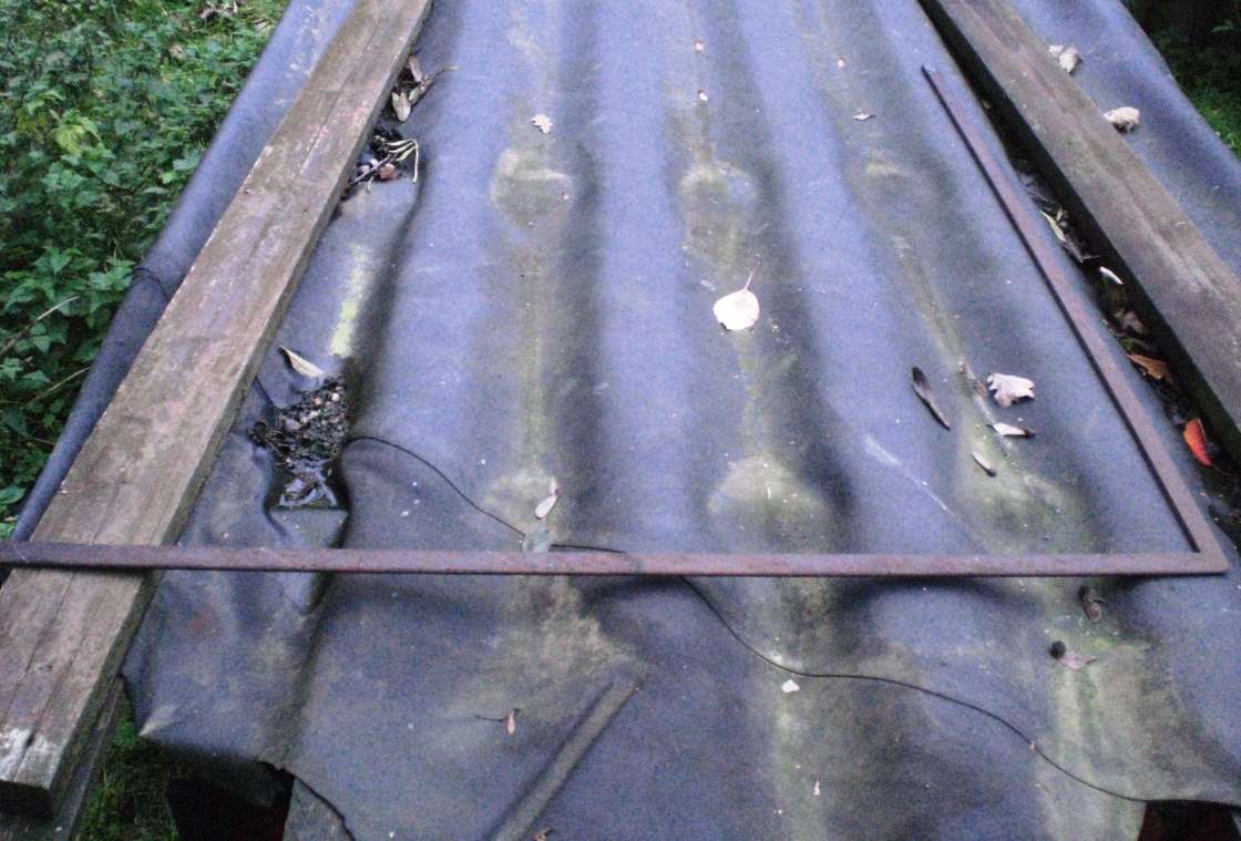

                              Hi, I made a square from an off cut of 6mm steel plate, just cut it in half and welded the two bits together, this was about 27 years ago when I was building my garage, and it’s just a little bit over 1 meter long on each leg, and it is still just as square as it was then, measuring it and by using Pythagoras, makes it no greater than 0.2mm under square.
                              Fabricated Square

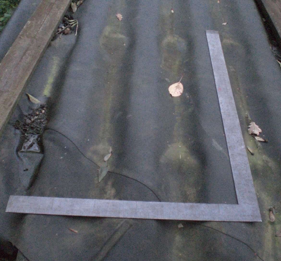

                              My Frame square is 910mm by 610mm approximately, and is over fifty years old, used to use it in my old day job, when doing large fabrications, bit rusty now and the measurement marks are a bit hard to see, it has inch measurements on the other side, but is still reasonably square.
                              Frame Square

                                        On Nicholas Farr Said:
                                        …no greater than 0.2mm under square.
                                        For one piece squares, I guess you know the trick of peening the vertex to adjust the squareness. Rapping on the outside will close the angle; rapping on the inside will open it.
                                        Also, as you know, a square is self-checking so long as you have a straight edge – sit it on the edge and draw a line, flip it over and draw another line. The difference between the lines is twice the error.
