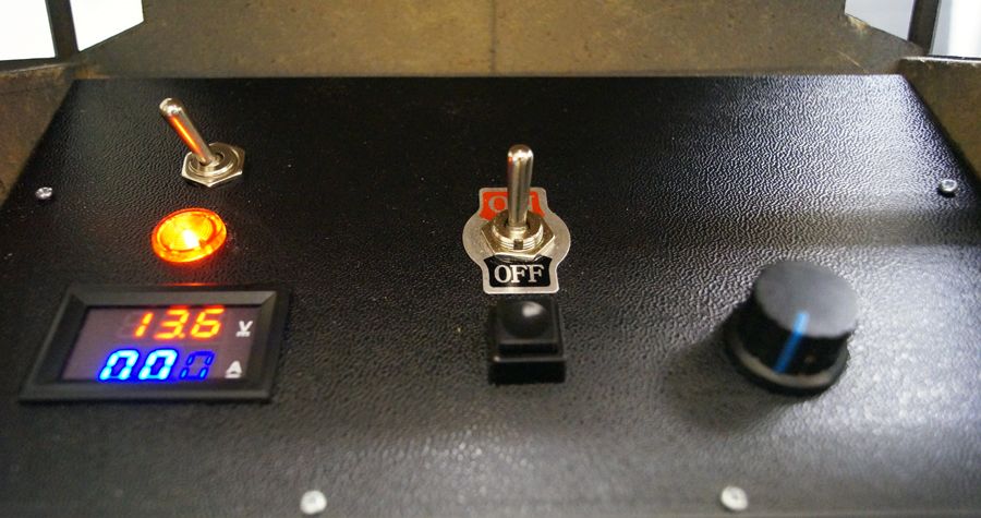

            Just finishing a few jobs including finalising the wiring to get the loco ready for its first outing/test on the club track..smiley
            I am going with mobility scooter batteries as they are a popular choice for powering electric locos/vehicles plus they are said to be true deep cycle batteries..?
            Using 2 x 12 volt – 22 amp hour wired in parallel should give me 12 volt 44 amp hour. I have read that for charging it is advised to connect via the negative of one battery and the positive of the other and not via the terminals of just one of the batteries. This should give a balanced charge across the pair where as charging via one of the batteries will not..?
            The loco has 4 x 12 volt motors, a pair driving each axle, I have gone with all 4 motors wired in parallel. I did consider the batteries in series (24V) with each pair of motors in series seeing 12 volts each. What put me off was reading on a motor controller manufacturers website that even with identical motors they can have differences in brush timing which can pull down the performance of both motors when in series..?
            I know a lot of you guys are very knowledgeable in matters electric and would appreciate your thoughts on the above.
            Thanks
            Ron

                  Ron, may I suggest that you fit an additional speed control pot inside set by a screwdriver through a hole to limit the max speed. When children are allowed to drive they only know one setting – full speed. Oh and full reverse instantly so make sure your controller doesn't mind that.
                  An ddo you have a breakaway chain? and perhaps the power connection through a jack plug that fits a socket in the driving car so power is cut on breakaway.
                      Edited By Bazyle on 14/04/2019 21:21:34
                      Hi Bazyle,
                      When it comes to the grand children driving I will be able to reduce the travel on the throttle lever, I hadnt thought of them switching straight into reverse though so will have to lock that plus I dont have a breakaway chain.
                      Ron

                          Posted by Ron Laden on 11/04/2019 08:00:04:
                          All sounds sensible to me, but I think the charging issue could only apply if the connections between the batteries had significant resistance.
                          #405276
                            There must be truth in that, but depending on the application it may not matter much, maybe! For best performance, the commutators of both motors should be synchronised. If they're not, then both motors will be 'managed' by the commutator position of the other. When the motors are up to speed the effect of misalignment would be a small reduction in power, probably trivial.
                            Unfortunately starting might be much more troublesome. If the commutators happen to be worst case misaligned and stay that way as the engine tries to pull away the reduced torque when it's most needed could be embarrassing. So I wouldn't wire 2 DC motors in series on a locomotive, or anything else asked to start under load.
                            How brave are you? With a PWM controller, I'd be tempted to put 24V on 12V motors and manage the duty cycle to avoid overheating the motors. It's risky – matching the motor and battery voltages is safer, and simple solutions are often the best.

                              I think you could be spot on there Dave, when I read the manufacturers website they gave an example of the possible problem. They took an identical pair of Graupner 12 volt 900 series motors which when wired in parallel to a 12 volt supply they performed as expected with no faults. However the same two motors wired in series from a 24 volt supply did not perform well and lost most of their torque, that is why I have gone with the 4 motors all in parallel but we will see.
                              Anyway the little loco is ready for the track, still some bits to do but nothing stopping a test run. I have given it some light weathering to dirty it up a bit and take away the just finished look.
                              Quite looking forward to taking it to the track and giving it a try.
                              p.s. Forgot to say 25 kgs AUW which I am hoping will be ok for traction though I am wondering if the suspension springs are a bit on the light side.

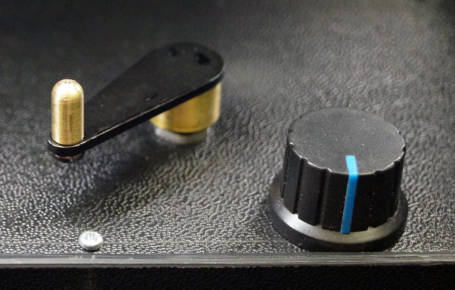

                                                    #409197
                                                    Ron Laden
                                                      @ronladen17547
                                                      Made up a simple throttle lever, looks a bit more in keeping than a plastic knob.
