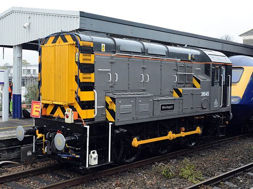

                  I am about to start building the loco body and as mentioned I am going with a Class 08..ish style body. The 08 is of course a 0-6-0 loco but there was a prototype built as a 0-4-0….wink….well thats my story and I,m sticking to it.
                  I was going with a typical green BR body but I found a few other colours for the 08 and I rather like the grey version in the picture below it is a bit different. I may well go for it when it comes to the painting and finishing stage.

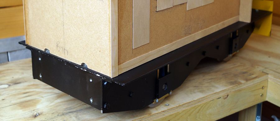

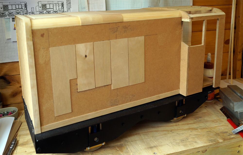

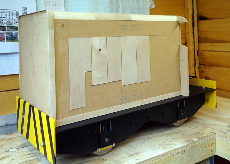

                    Well I,ve made a start on the body, built the basics of the front section. It will be based on a 08 (ish) shunter, I know it looks like a box on wheels, but if you take the detail off an 08 thats what your left with (see picture in previous post).
                    So lots of detail to add, well when I say lots, enough to make it at least look like something realistic.
                    The next stage is to add the rear section/cab, the body so far is a combination of 6mm MDF, pine quarter quadrant and 0.8 mm modelling ply. I,ve added the engine access door panels to each side and also fixed the cab front.
                    Ron
                    p.s. Although its not intended as a scale loco I think I will lose the buffer plates, they just dont look right.

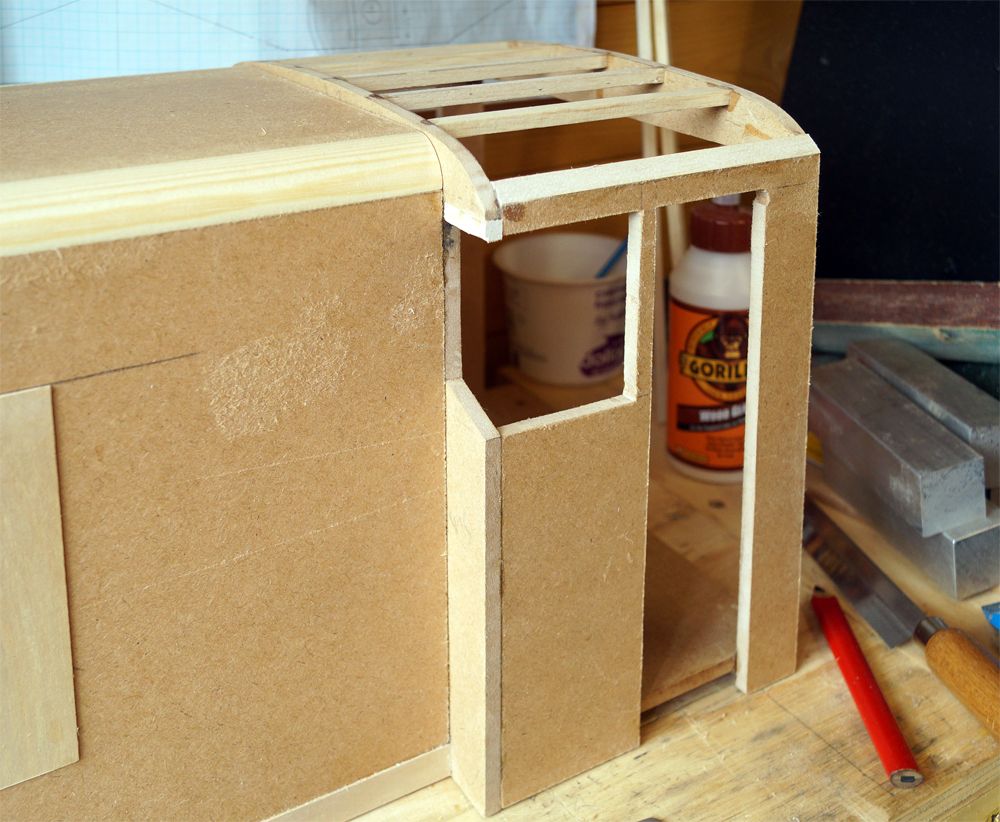

                          I am part way through building the cab, will add a picture later.

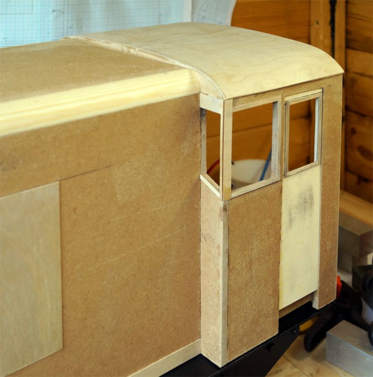

                            I,ve managed to get the bare bones of the cab area together, doors still to make, window frames and trims to do plus make and fit the roof. Still a lot of detail to do but its coming together and most importantly its fun.
                            Ron

                              Placed the body on the chassis, starting to look a bit more shunter like…I think..?

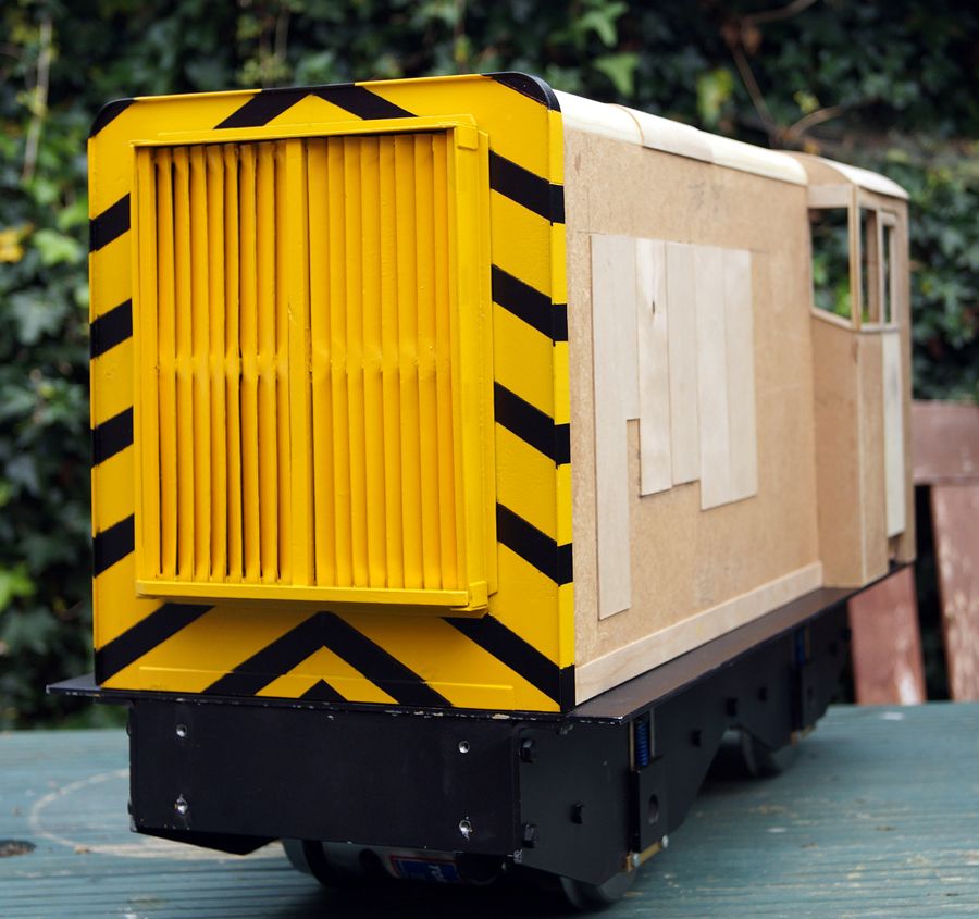

                                  I,ve not had too much workshop time this week but managed to add the radiator front assy, decided to add the wasp stripes at the same time.

                                      Fuel tanks, side boxes and vent panels next, its completely make believe of course but if I can get it looking something like a shunter that could have been it will be fine.
                                      It started out as a fun loco to carry our two great grand daughters and there is good news on that front. They were suggesting it had to be pink with a Thomas face..surprise but they have both seen the two tone grey version and it gets their approval. I think I got away with it with the wasp stripes, they thought the yellow and black was "cool"..lol. I cant get away with not having Thomas though but that can now be a clip on for when they visit the track, well thats a small blessing at least.

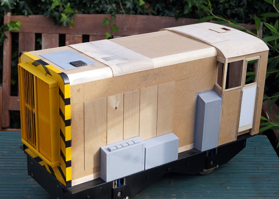

                                        Some more added, fuel tanks and side boxes, cab door panel and handrails, cab roof vent. The vent panels which sit in front of the fuel tanks are next, once these are done thats pretty much the main build of the body finished. Its then surface detail and the chassis needs buffers which I aim to turn from aluminium plus the clevis couplings which I will either buy or make.
                                        Found some 12 volt – 5mm white led,s which come in a small lens housing so I may get those for the front lights, will just need to make the lamp bodies. Also seen a 12 volt classic motorcycle horn (low tone) which I,m thinking could sound about right for a shunter.

                                              Still plugging away, fitted the engine door hinges, handrails and the vent panels. Used 1.5mm ali welding rod for the handrails and cable tie ends for the hinges, they are about right size wise and I think they look ok. I think the vent panels on the full size is a grid of small mesh but I havnt found anything yet that fits the bill…any suggestions welcome..? I have slipped in a couple of pieces of 3mm plastazote for now to give some idea.

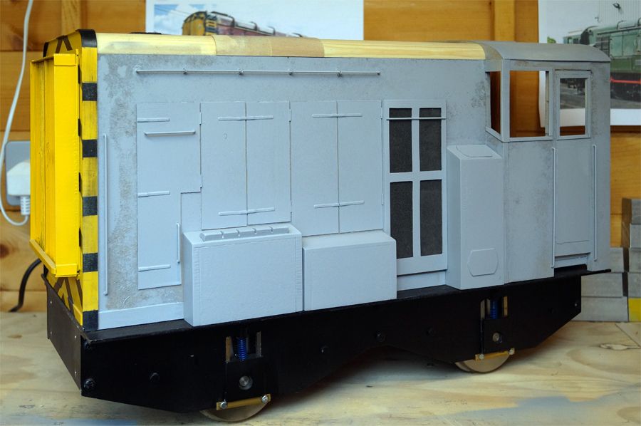

                                                Again, not too much workshop time this week but I have added some pipe work to the front plus I have also weathered the front a tad to lose that new look.
                                                Painting is next and I plan to use the method I have used on numerous scratch built R/C aircraft over the years as it works really well.
                                                I have started with a primer coat which will be cut back with 800 paper (dry) then a coat of filler primer, filler primer is excellent for losing small imperfections and can hide a multitude of sins and again it is cut back with 800. Then the first layer of top coat, cut back with 1200 paper (dry) then the final top coat. Finally a coat of acrylic clear satin varnish, I dont use matt for anything that is regularly handled and gloss to me just looks over the top. All the painting is with aerosols (auto paint) and when it comes to top coat colours there is a massive range.

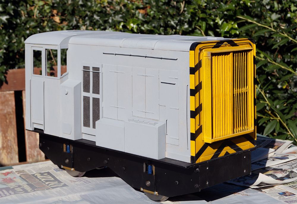

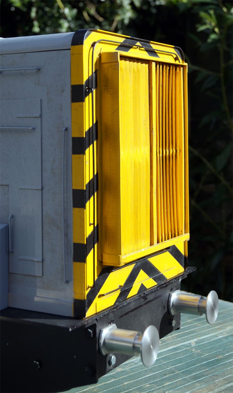

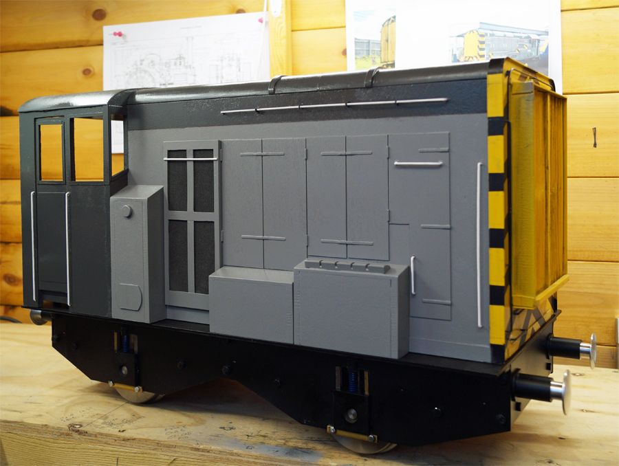

                                                      Not fifty shades of grey just two, the main painting is finished. A few bits of surface detail to add, weathering and a final top coat of clear satin. Cab to glaze plus correct a wonky window frame, build and fit the cab control panel and finalise the wiring.
                                                      Chassis needs front and rear foot ladders, some areas of detail plus a pair of clevis couplings, with my first mill arriving next week smiley I will be able to produce my own.
