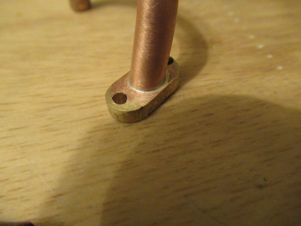

  • #392813
    David K
      @davidk77137

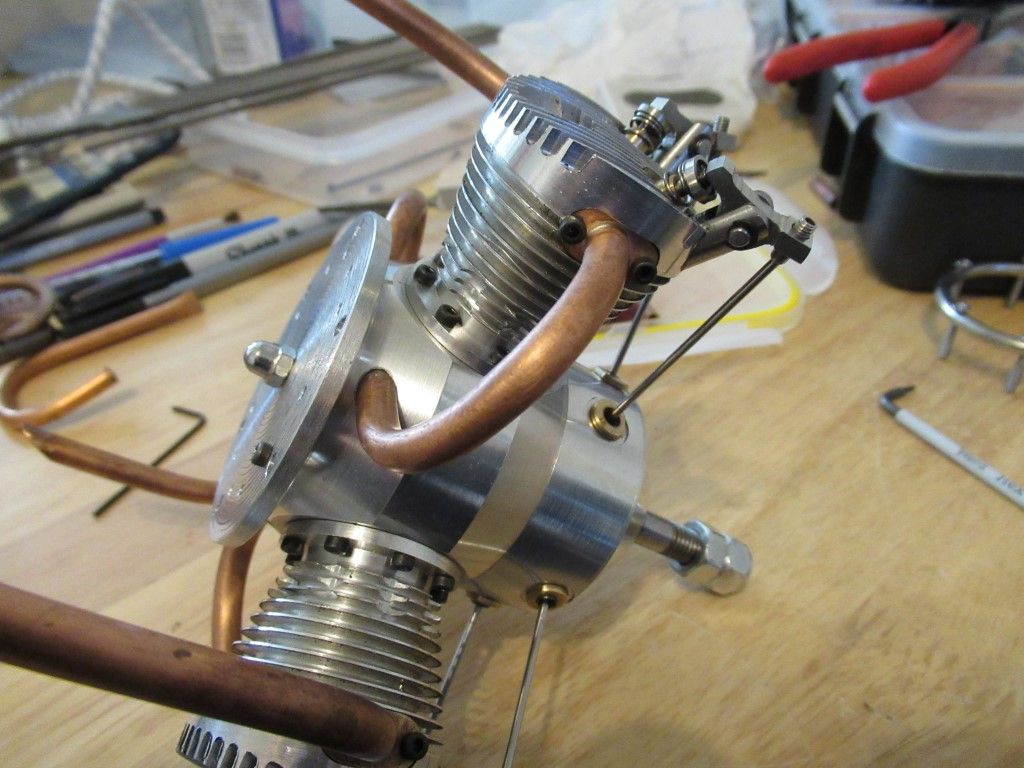

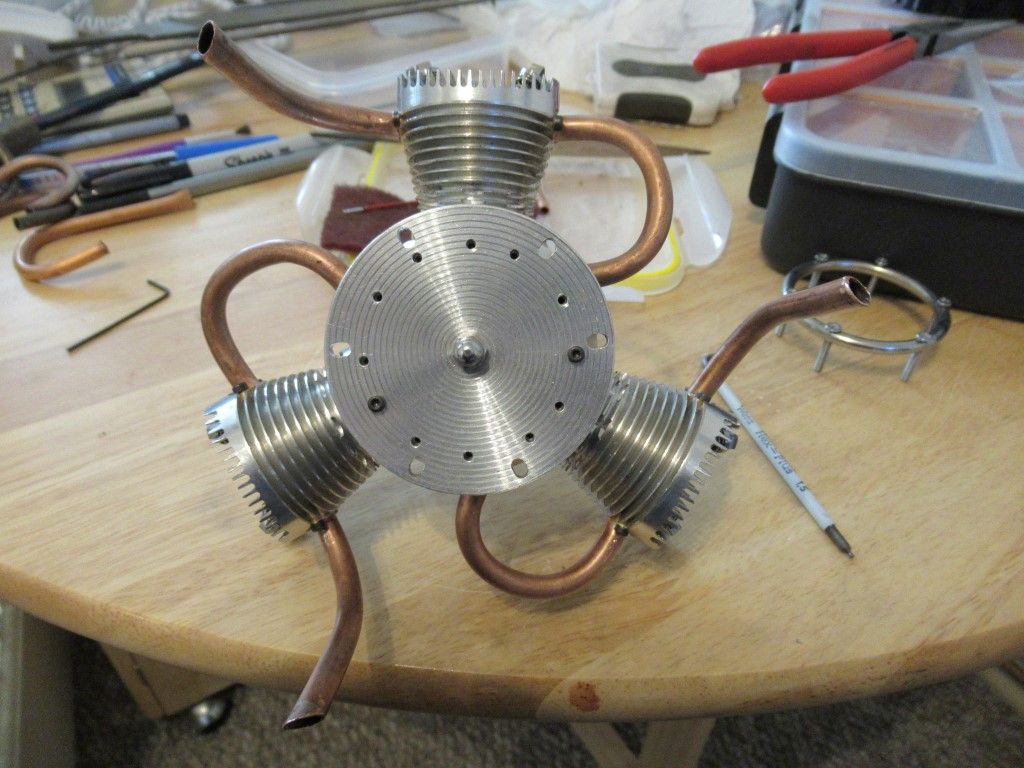

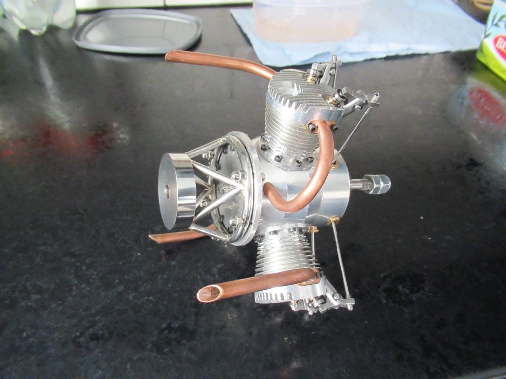

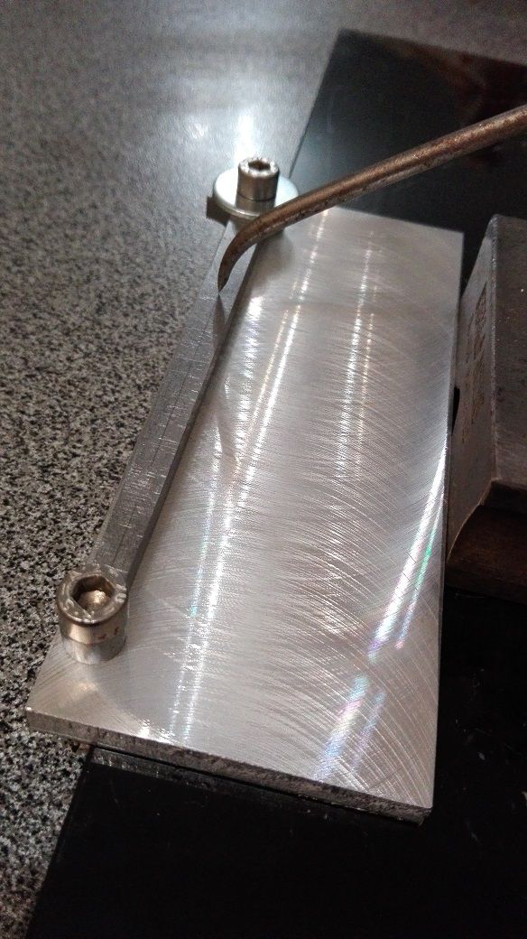

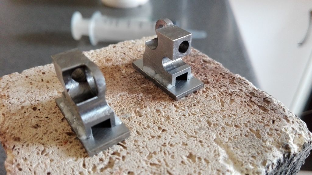

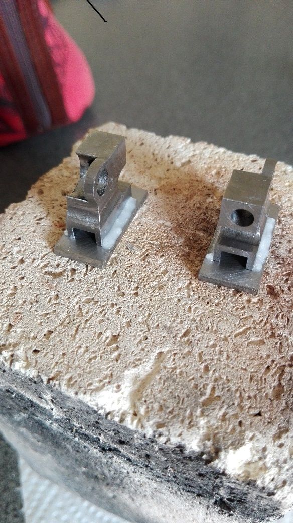

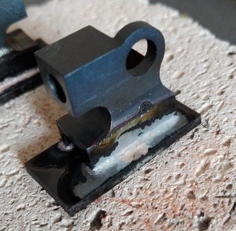

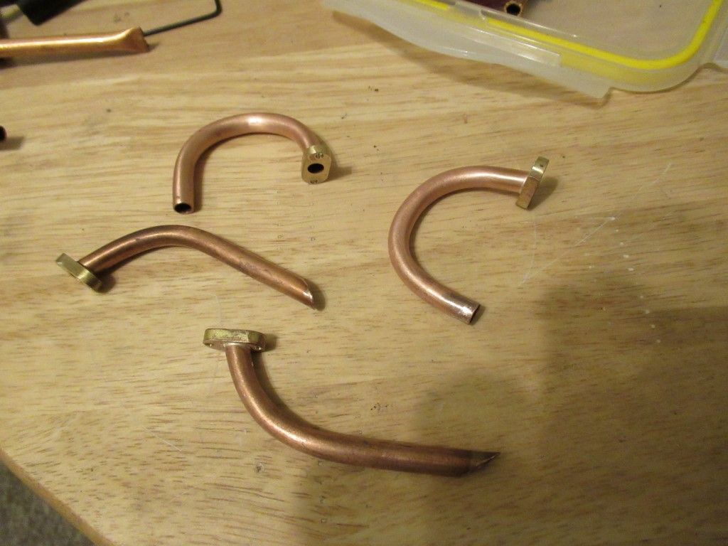

      #392814
      David K
        @davidk77137

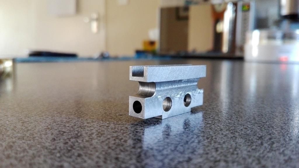

        #392815
        David K
          @davidk77137
          #392817
          David K
            @davidk77137
            #392818
            David K
              @davidk77137

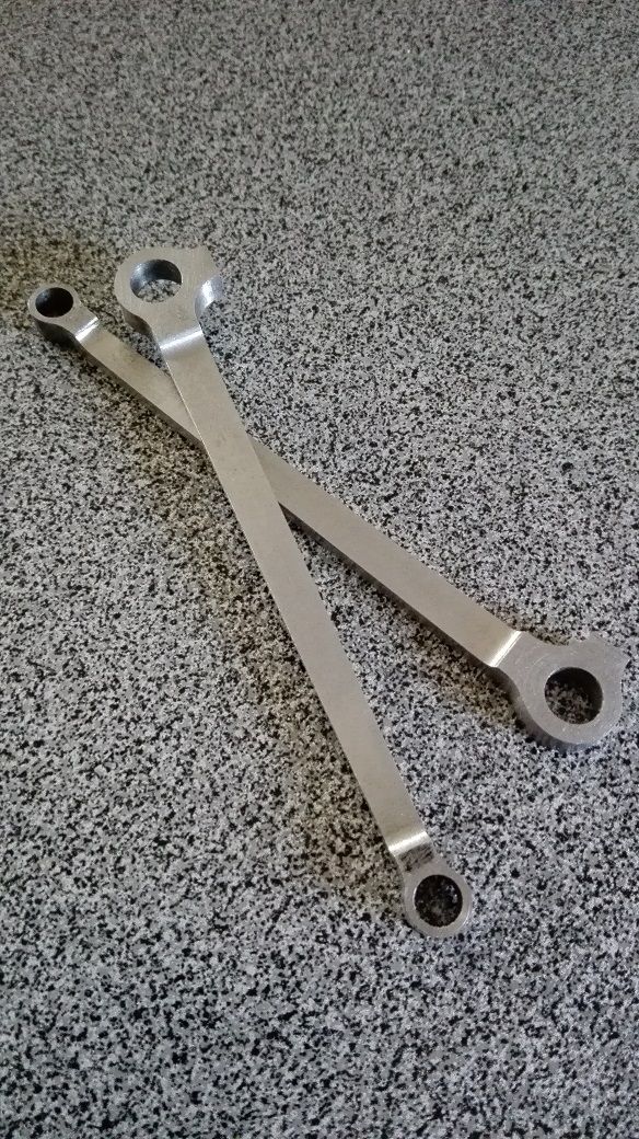

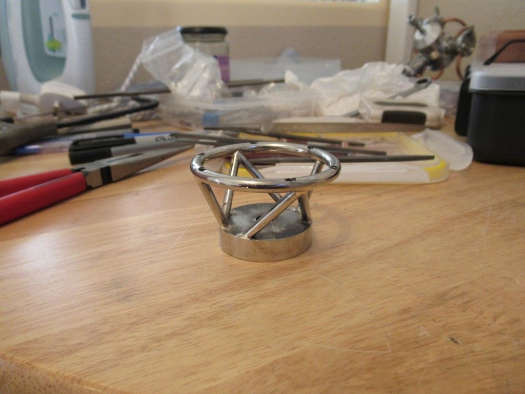

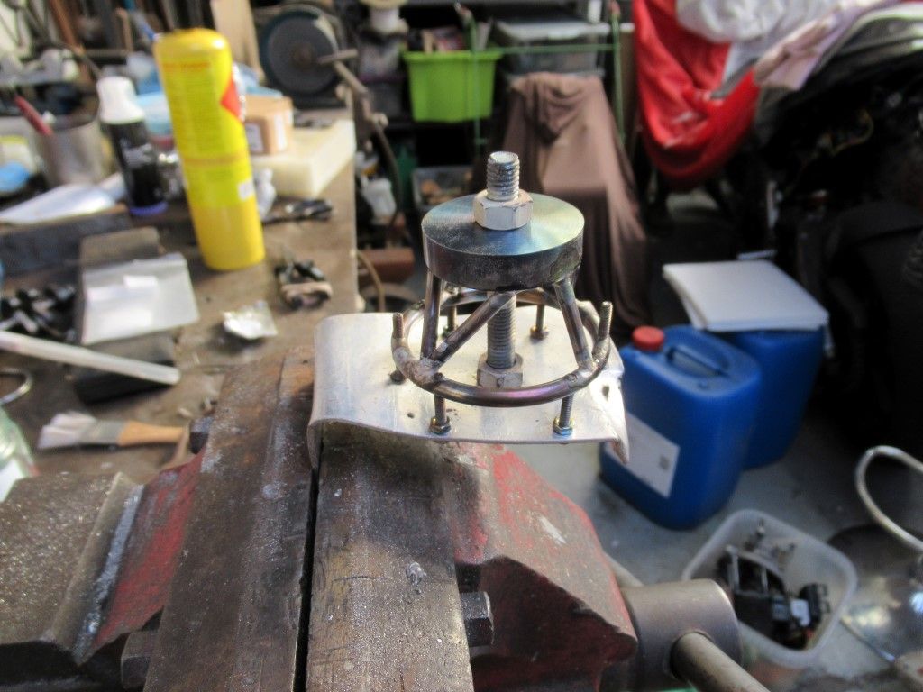

              #392958
              David K
                @davidk77137

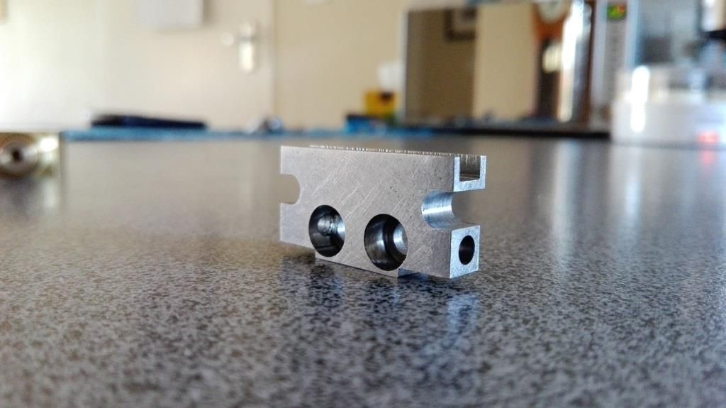

                Time to make a stand for the engine.
                I wanted to make a carrier similar to the one used on full size engines so I
                thought I would put my new silver solder skills to use and solder some stainless
                pieces together.
                I made a simple jig to hold the pieces while I soldered.img_0035 (medium).jpg
                #392959
                David K
                  @davidk77137
                  After soldering the cradle it was put into a Citric acid bath for a few minutes then polished img_0036 (medium).jpg

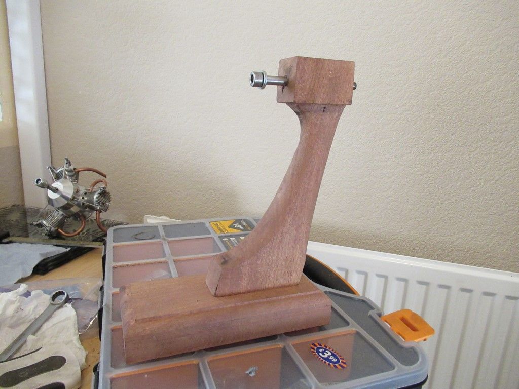

                    Next I cut a couple of pieces of hard wood from some old door frame I saved.
                    The first piece I cleaned up into a rectangle and routed around the top , the second
                    piece I drew a rough outline of the shape I wanted and attacked it with a flap disc
                    on my grinder. It carved up much easier than I thought and just needed a quick sand

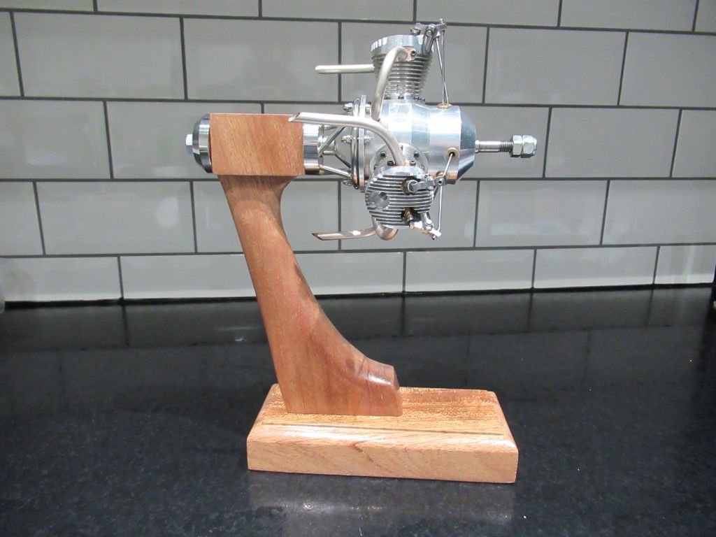

                      #392963
                      David K
                        @davidk77137

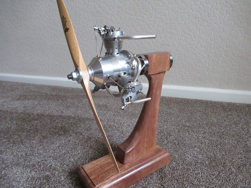

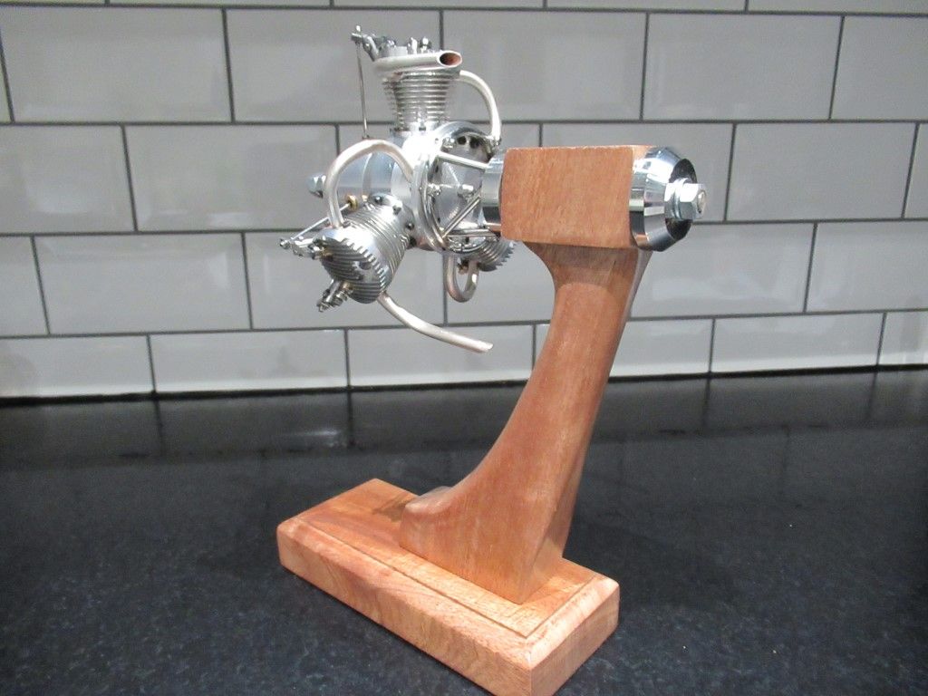

                        I have given the stand a sanding and varnish , then mounted the engine.
                        You may notice the manifolds are now silver ,had some silvering powder
                        left over from a clock build so decided to use some on the copper manifolds.img_0044 (medium).jpg
                        #392964
                        David K
                          @davidk77137

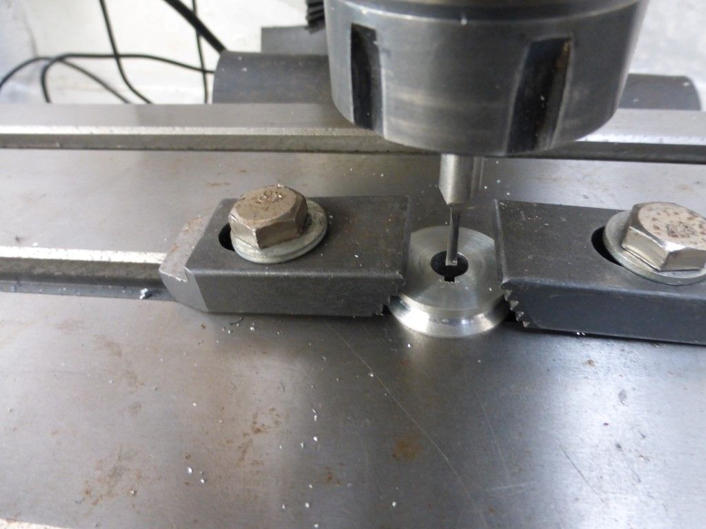

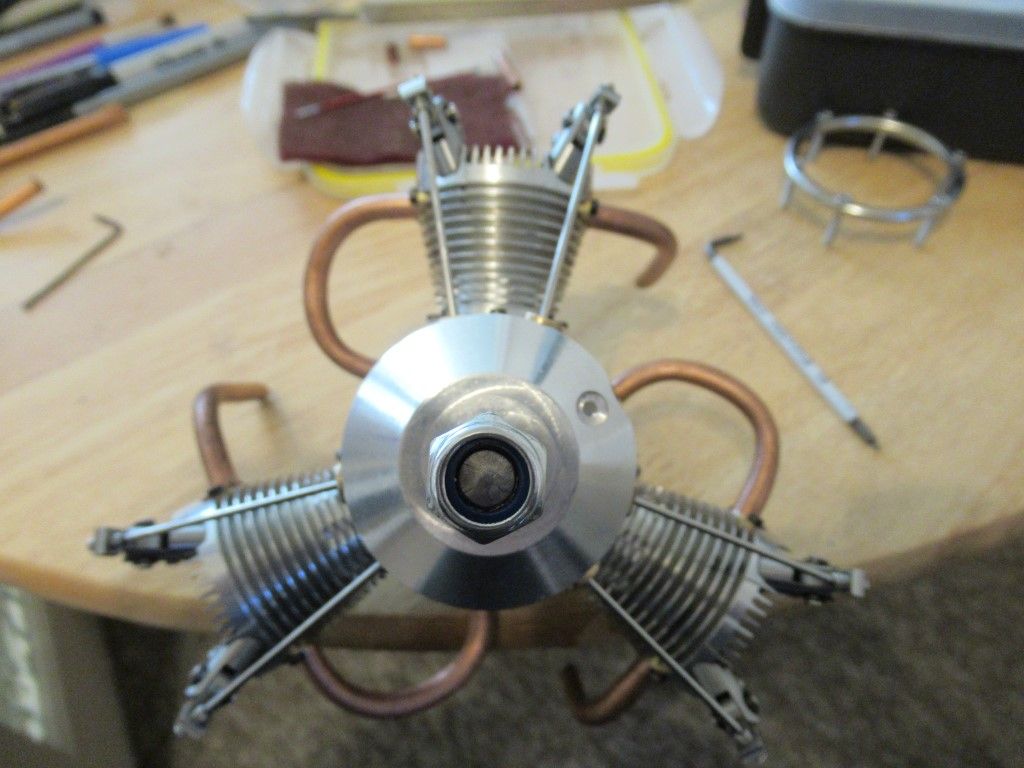

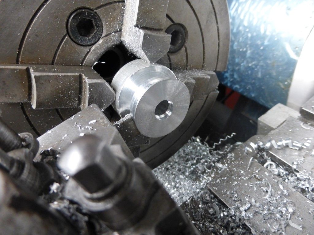

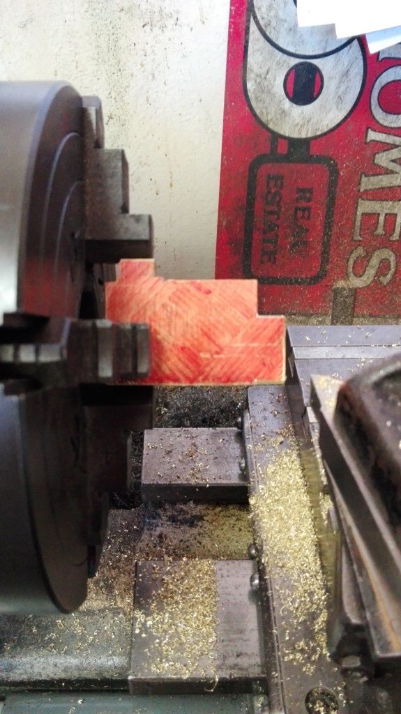

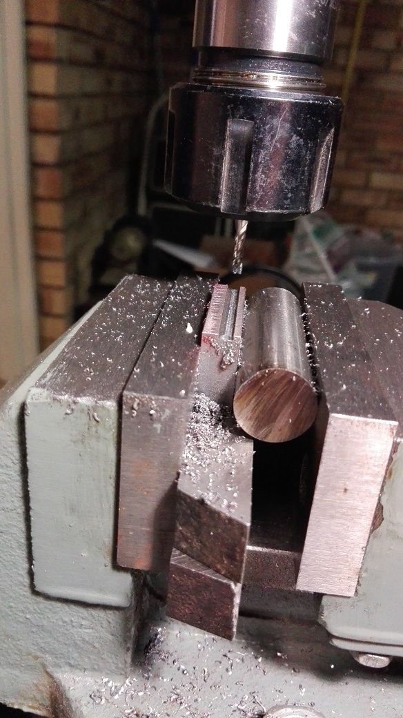

                            Got a small propeller of EBay so had to make a prop washer for the crankshaft end.
                            #392966
                            David K
                              @davidk77137
                              Using a piece of tool steel ground with a chisel edge I cut the slot for the woodruff key p1040910 (medium).jpg

                                So the engine is now complete , unfortunately the carb I bought is not suitable so I need
                                to find a replacement. The carb I bought is a 'slide' carb and will not fit properly between

                                    Excellent build log David, have just read all the way through with great interest and learned a lot from the work holding set-ups and the design, especially of the epicyclic geared cam drive and internal fan to stir the air in the crankcase.
                                    Many of the work holding set-up were especially interesting, this being an area where I have little experience – that proved invaluable.
                                    The standard of machining is excellent too, resulting in a lovely engine to be very justifiably proud of.
                                    Well done that man,
                                    Chris
