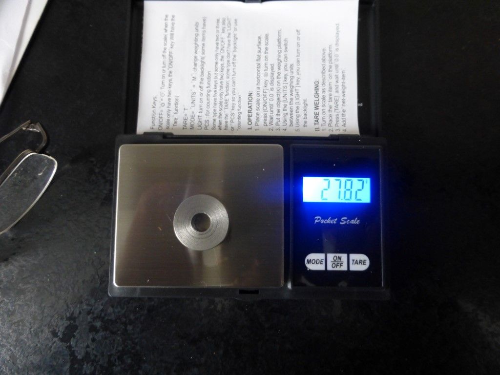

          @davidk77137
          Master rod total weight 100% 6.86g
          Master rod upper half 43% 2.95g
          Master rod lower half 57% 3.91g
          2 Slave rods total 100% 4.49g
          2 Slave rods upper half 50% 2.245g
          2 Slave rods lower half 50% 2.245g
          Reciprocating parts
          3 Pistons 12.42g
          6 Piston rings 1.17g
          3 Wrist pins 6.22g
          3 Small end bearing 1.97g
          1 Master rod upper half 2.95g
          2 Slave rods upper half 2.245g
          Total Reciprocating parts [ 26.975 ]
          Rotating parts
          1 Big end bearing 4.08g
          2 Knuckle pins 2.59g
          2 Small end bearings 1.51g
          1 Master rod lower half 3.91g
          2 Slave rods lower half 2.245g
          Total Rotating parts [ 14.335 ]
          #392290
          David K
            @davidk77137
            Weight to be balanced
            1/2 x reciprocating parts 13.378g
            1 x rotating parts 14.335g
            Total to be balanced 27.822g
            #392291
            David K
              @davidk77137

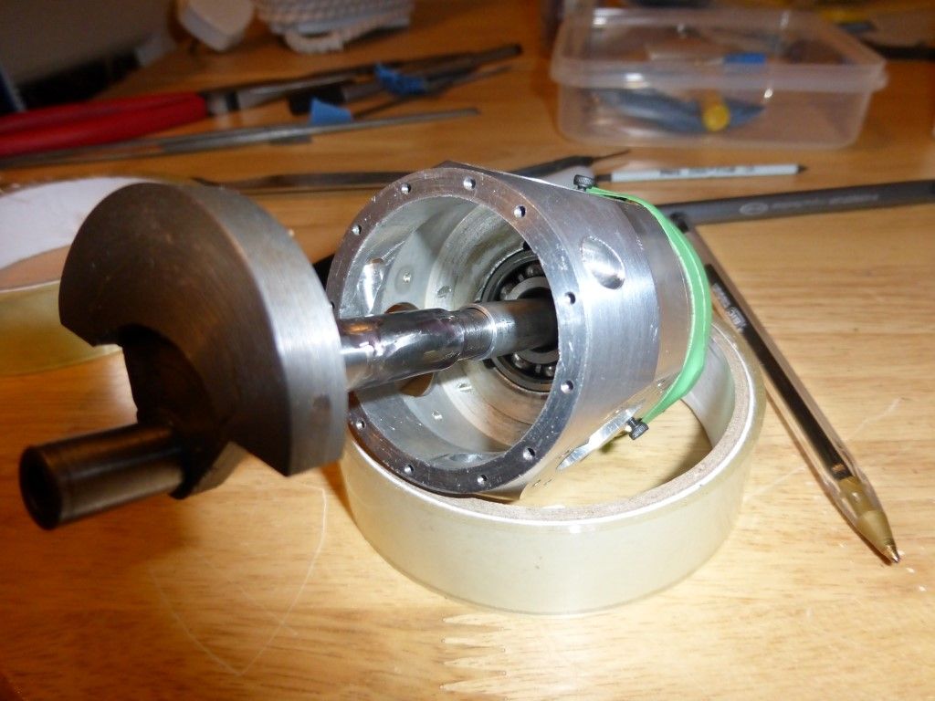

              #392292
              David K
                @davidk77137
                With the bob weight placed on the crank pin the counterweight falls to the bottom
                as it is heavier
                I then slowly turned down the counterweight testing between cuts until the crank
                can be placed in any position balanced.

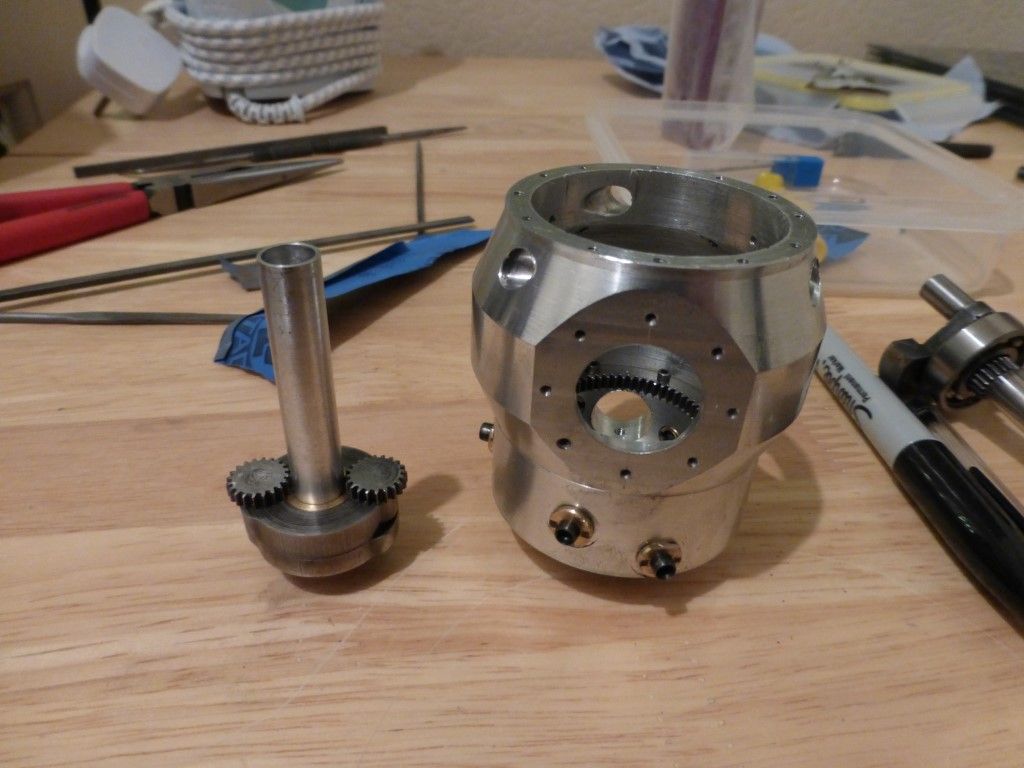

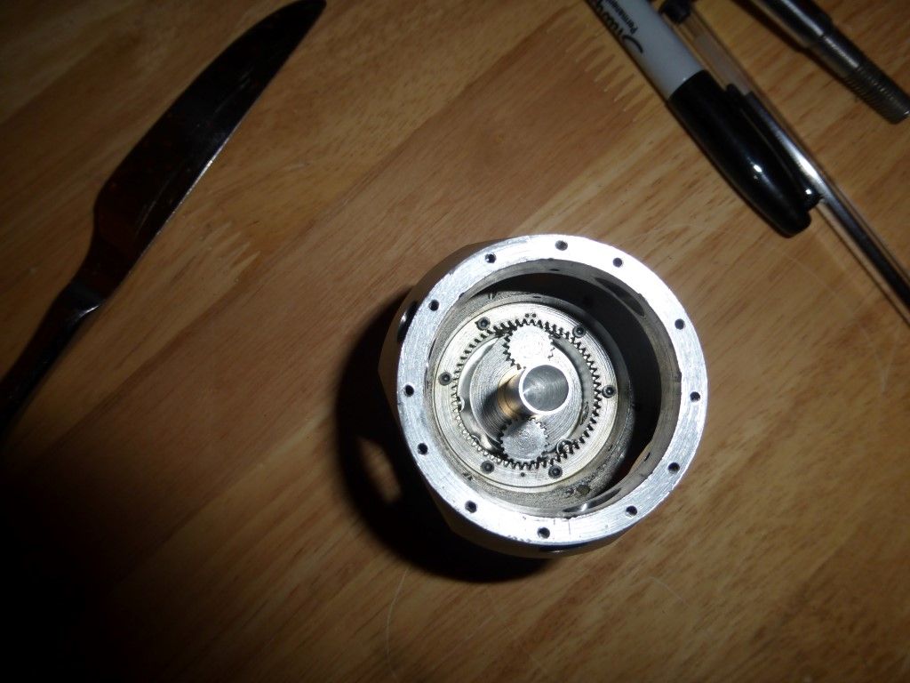

                  I am now ready to build up the engine.
                  #392669
                  David K
                    @davidk77137
                    #392670
                    David K
                      @davidk77137
                      This tube is pushed up through the bottom bearing and the cam is dropped in lining
                      up the gears with the centre punch marks which are top / bottom dead centrep1040902 (medium).jpg

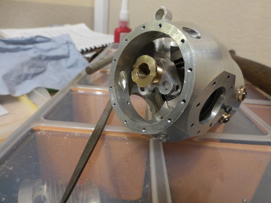

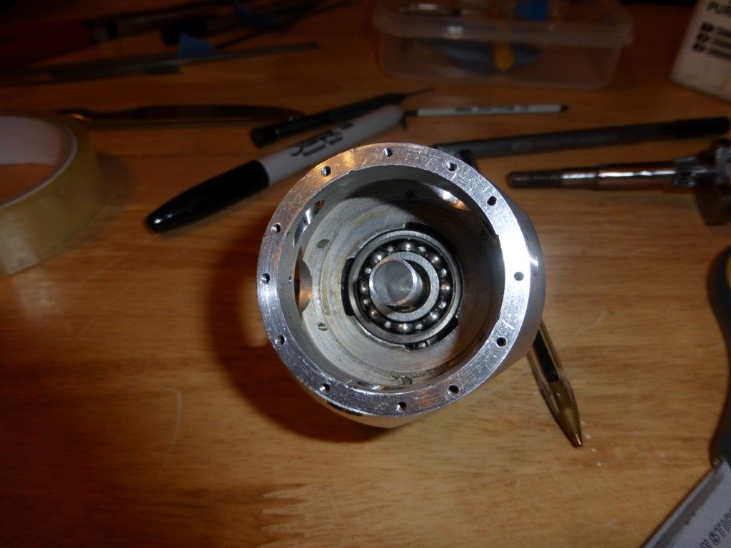

                          The second main bearing plus its carrier is then pressed into place, this will
                          be held in place by three of the cylinder mounting bolts.
                          I cannot now see the camshaft so I have run some sticky tape around the outside
                          of the cam followers so they press against the cam and hold it steady. p1040903 (medium).jpg
                          #392675
                          David K
                            @davidk77137
                            The crankshaft can now be placed into the end of the alloy tube and slowly pushed
                            through so the tube is replaced by the crank. The crank pin is held at TDC and hopefully
                            it will engage with the cam still held at TDC by the taped followers. p1040904 (medium).jpg

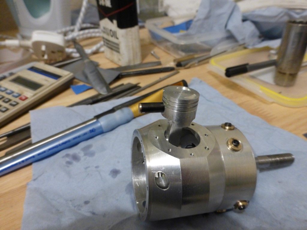

                              Master con rod is placed onto the crank pin and the big end bearing screwed into place. p1040930 (medium).jpg
                              #392677
                              David K
                                @davidk77137
                                Piston is then fixed by the gudgeon pin and the rings carefully fitted

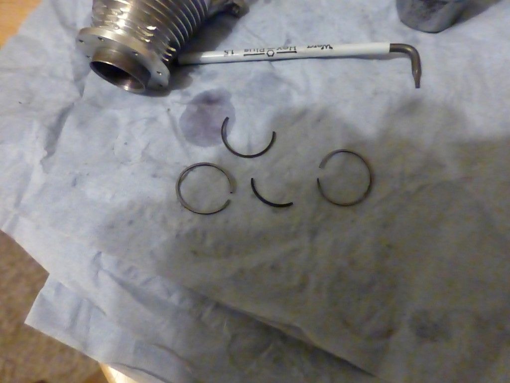

                                #392678
                                David K
                                  @davidk77137

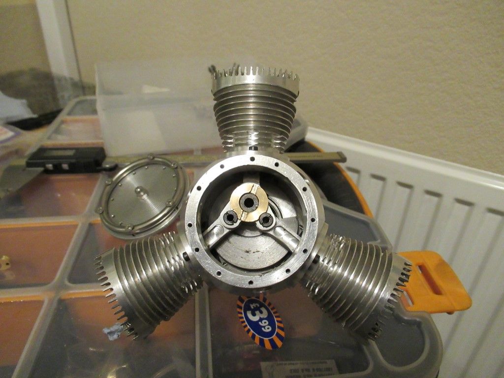

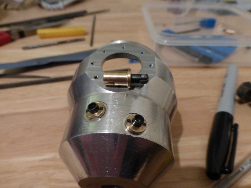

                                          A cylinder can now be slid over the piston and held by a 8 M2 screws,
                                          The slave rods are now connected to the master rod. You can see the slave
                                          pins line up with cut outs in the main bearing so the bearing cannot undo.

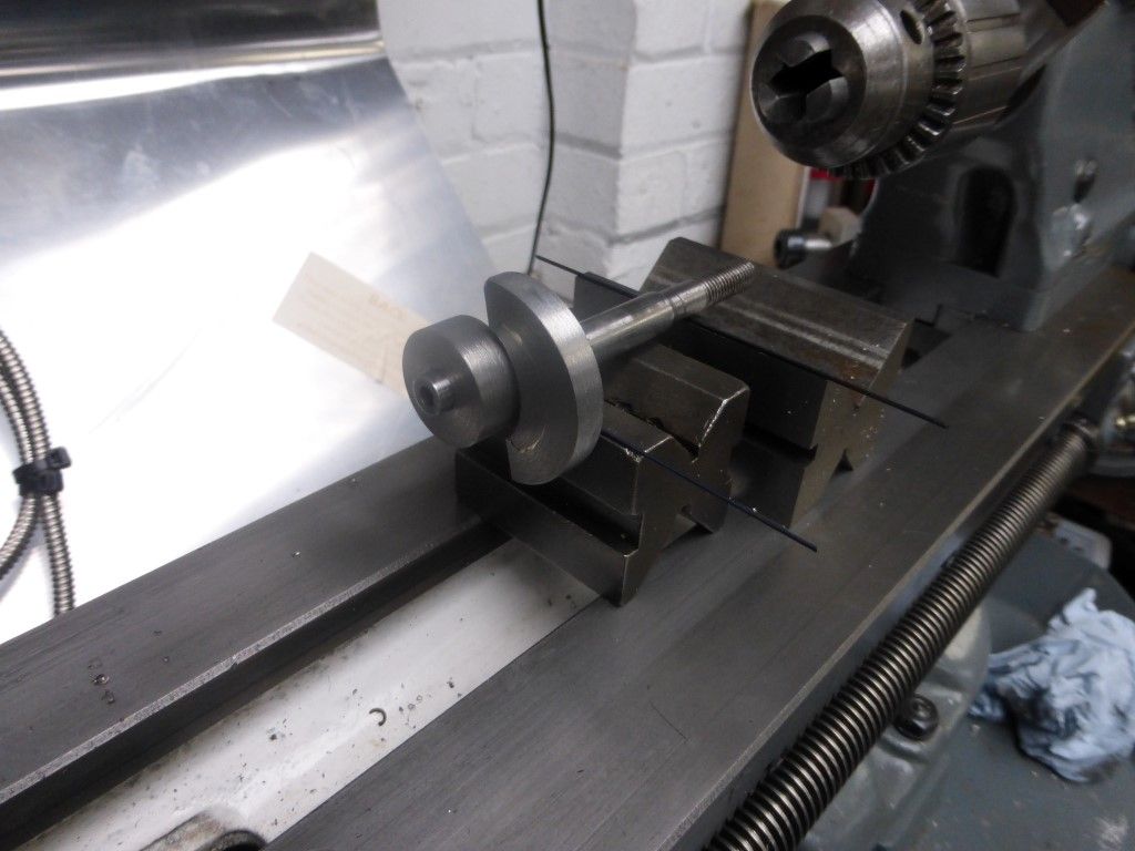

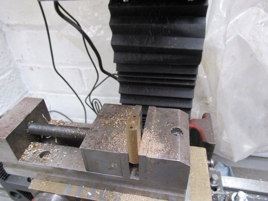

                                              Inlet / Exhaust manifolds.
                                              A piece of brass bar is milled to the shape needed then two m2 mounting holes
                                              #392808
                                              David K
                                                @davidk77137
                                                Next a slitting saw is used to cut each manifold mounting off at 1/8'' thickness.img_0003 (medium).jpg

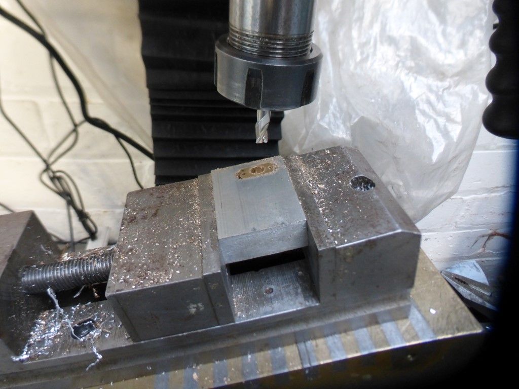

                                                David K
                                                  @davidk77137
                                                  I milled a slot into a piece of scrap alloy to hold each mount while I milled
                                                  a m6 hole through the centre at 15 degrees to match the cylinder head ports.p1040997 (medium).jpg

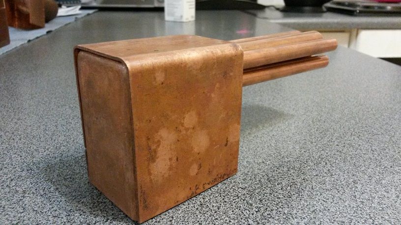

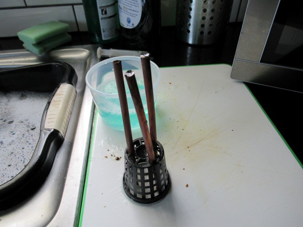

                                                    Some lengths of 6mm copper pipe are cut and one end crimped shut.
                                                    The pipes are then filled with water and placed into the freezer for a

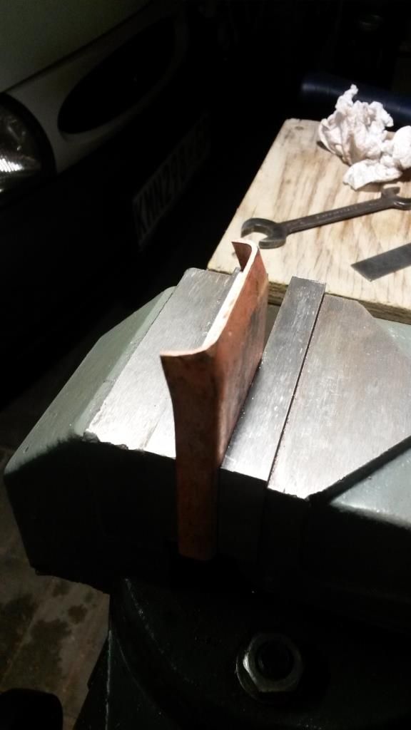

                                                    David K
                                                      @davidk77137

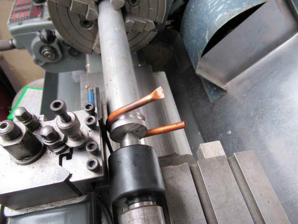

                                                      Once frozen the pipes are bent to shape over a former held in a chuck.
                                                      The exhausts bent ok but the tighter inlet bends were a problem so instead
                                                      of frozen water I filled them using a glue gun and let the glue harden.
