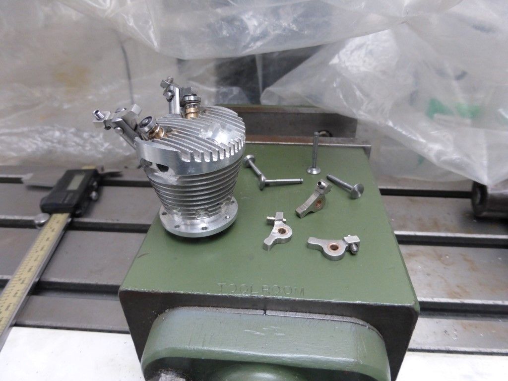

      #390205
      David K
        @davidk77137
        Valves first start off with a length of silver steel
        Reduce the shaft to just over the valve shaft diameter then cut the groove for the collet.
        #390206
        David K
          @davidk77137
          Now reduce the shaft for the whole length of the valve until a nice fit into the guide
          #390207
          David K
            @davidk77137
            Next turn the top slide to 45 degrees and cut the valve face
            #390209
            David K
              @davidk77137
              Part of the valve
              Flip the valve in the collet and using a grinding stone finish the valve face
              #390210
              David K
                @davidk77137
                Then repeat to make six plus two spare

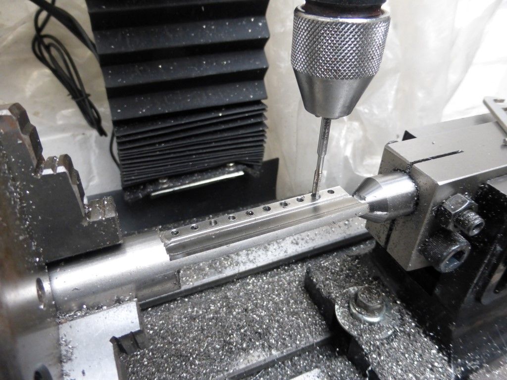

                      Rather than make each rocker individually I machined the rocker profile along a piece
                      of bar and then parted off each rocker from the bar.
                      Starting off with a 22mm round piece of Stainless mounted in the lathe , faced off and centre drilled
                      both ends then a 5mm hole is drilled then reamed through the centre.
                      The piece is then mounted on the mill using the rotary table and start milling the shape.p1040768 (medium).jpg

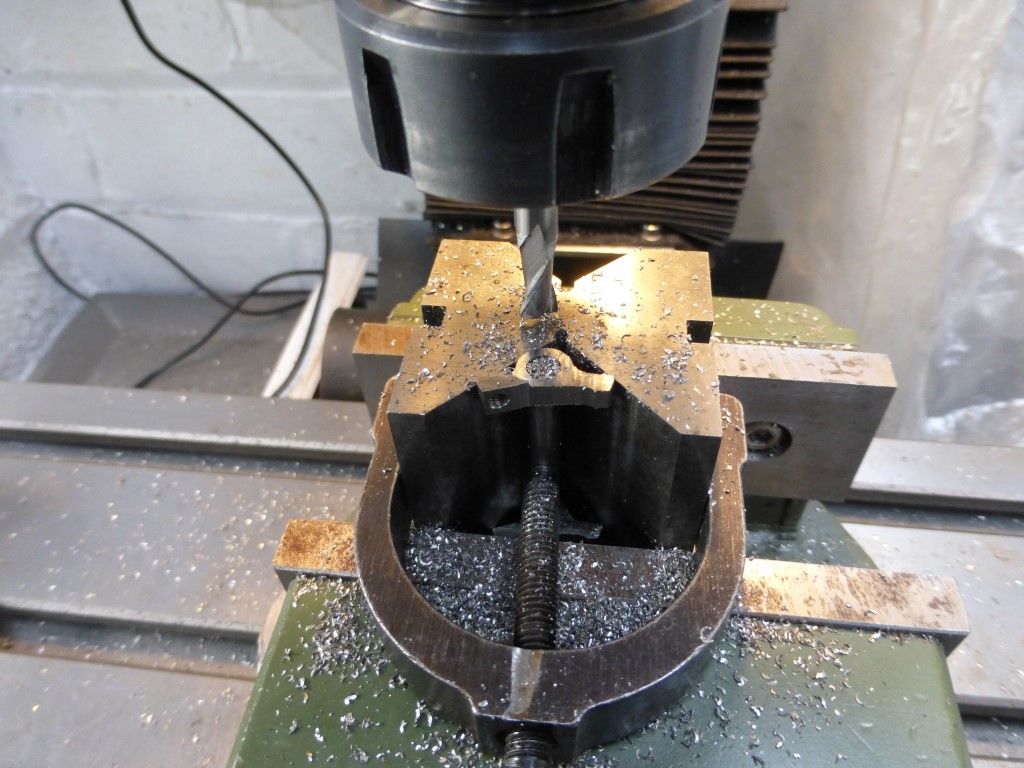

                      #391770
                      David K
                        @davidk77137
                        #391771
                        David K
                          @davidk77137

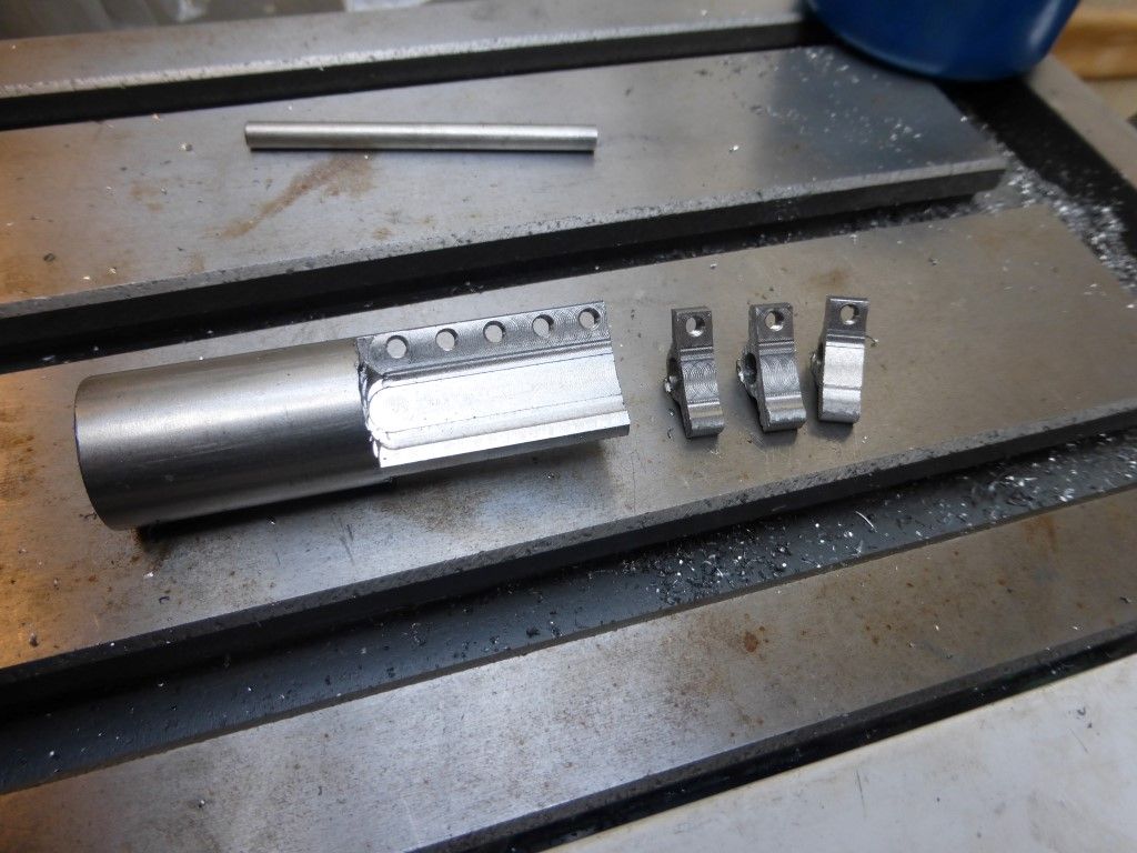

                          David K
                            @davidk77137
                            The profile can be seen here
                            #391773
                            David K
                              @davidk77137
                              Each rocker is then parted off
                              #391774
                              David K
                                @davidk77137
                                To finish the rockers I then carefully milled the sides down to size p1040776 (medium).jpg
                                #391776
                                David K
                                  @davidk77137
                                  Then after a de burr and clean I pressed in a bronze bush , fitted an adjusting screw
                                  and then fitted them to the cyl head.
                                  You can also see the valve caps I made but forgot to take pics. p1040795 (medium).jpg

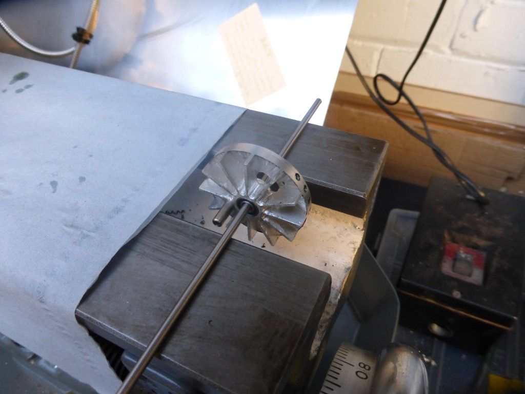

                                    Diffuser.
                                    The engine works similar to a 2 stroke in that the fuel is fed into the crankcase and then
                                    transferred to the inlet ports.
                                    The diffuser is basically a fan designed to push the fuel mixture around the crankcase.

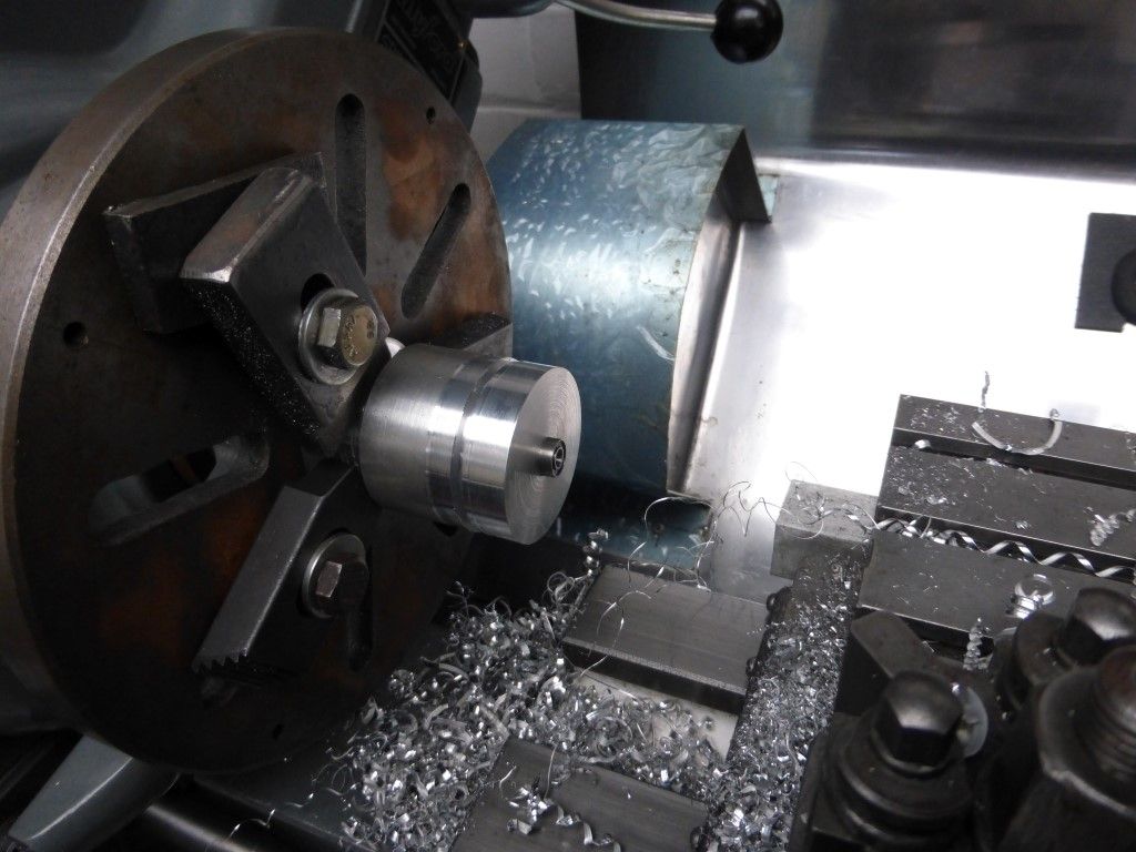

                                    #391780
                                    David K
                                      @davidk77137
                                      Starting of with some Alloy bar in the lathe the piece is turned to correct diameter
                                      and a groove is turned to mark the depth of the fan.
                                      A 5mm hole is drilled through the centre and this is then opened out to accept two
                                      press fitted bearings 9x4x4
                                      Edited By David Kenyon 2 on 18/01/2019 20:22:52

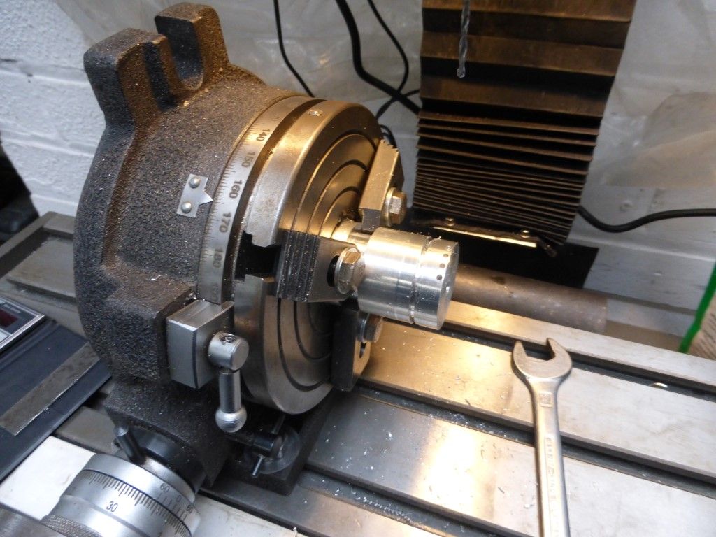

                                      #391782

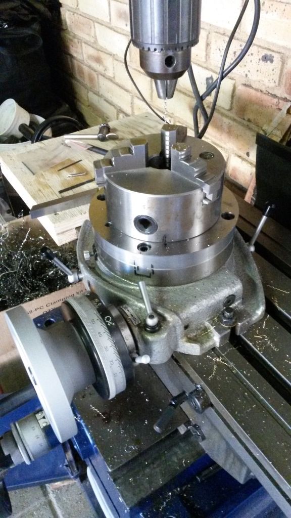

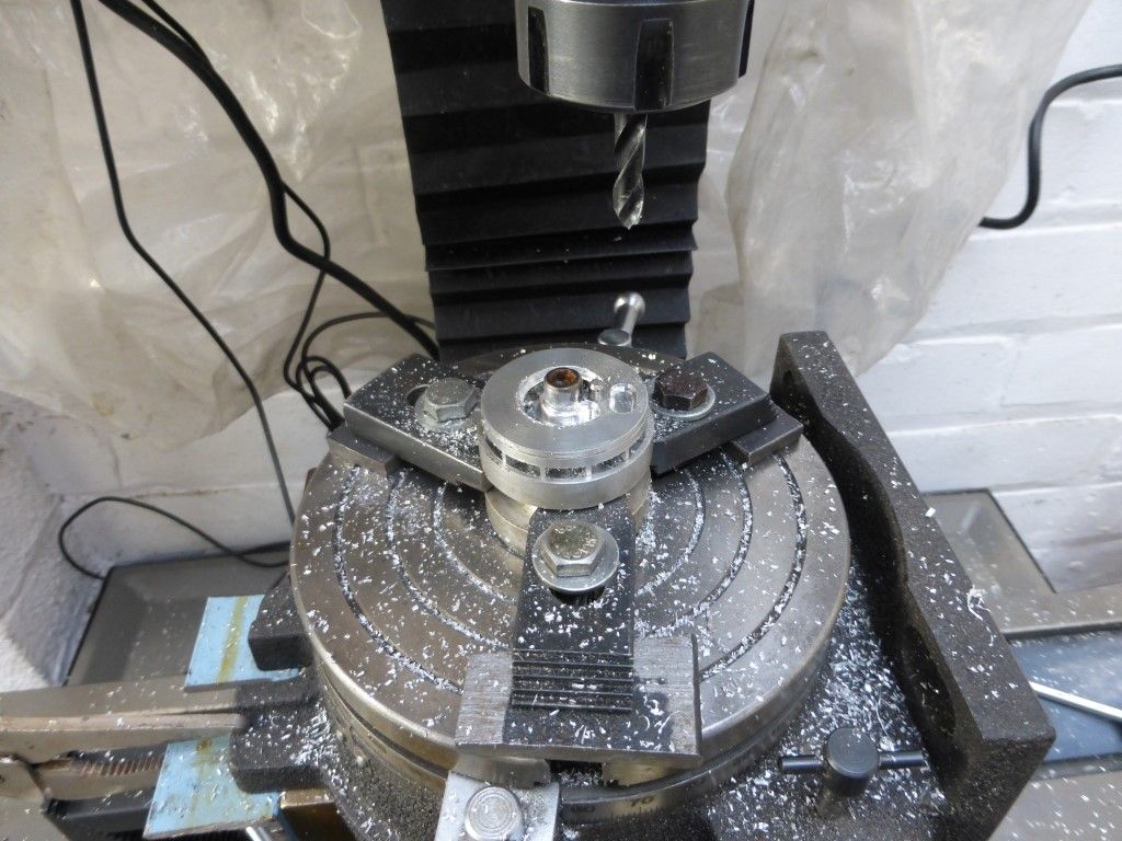

                                      David K
                                        @davidk77137
                                        The piece is then transferred to a rotary table placed on the mill table vertically.
                                        A series of holes are drilled 15 degrees apart either side of the 180 degree mark.
                                        These holes will have small pieces of steel inserted in them later to enable balancing
                                        #391783
                                          Good stuff David – please keep the updates coming. Don't get discouraged if not many people comment directly – build threads tend to be enjoyed quietly.

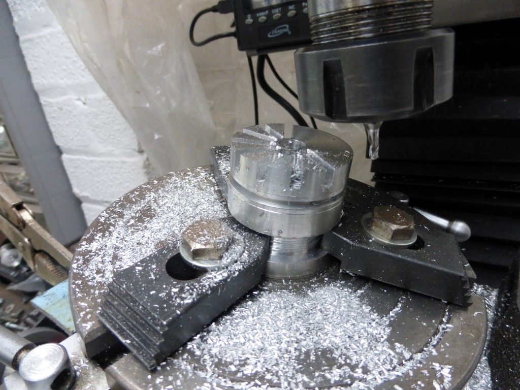

                                          #391784

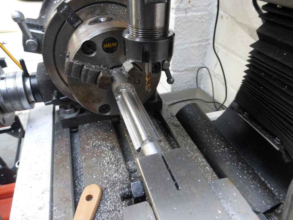

                                          David K
                                            @davidk77137
                                            The rotary table is then placed horizontally and a 4mm hole is drilled .312 inches off centre,
                                            this is the same measurement as the stroke of the engine as the fan is driven from a pin
                                            inserted into the big end . You will see this in a later picture.
                                            The table is then tilted 15 degrees and a 3mm end mill is used to start cutting the fins at
                                            30 degree intervals.

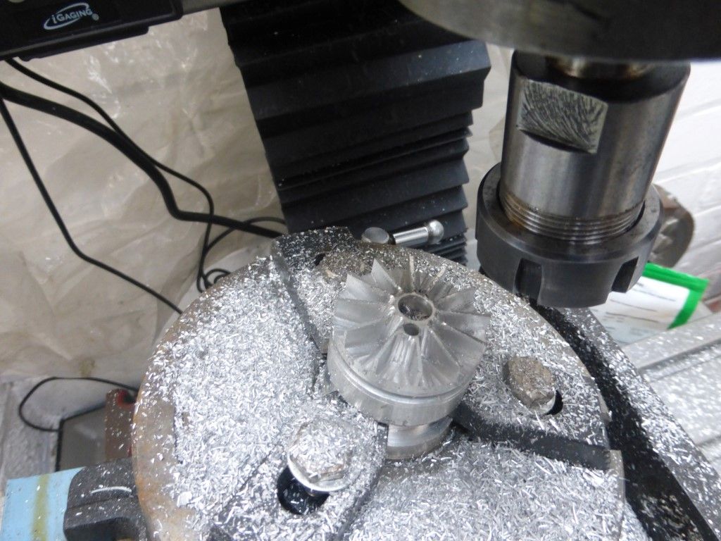

                                            #391787
                                            David K
                                              @davidk77137
                                              The mill is moved along the 'y' axis and a second set of cuts make up the rear of the blades
                                              Then its just a matter of removing the waste between the fins

                                              David K
                                                @davidk77137
                                                Back to the lathe the fan is parted off then I had to make a fixture to hold it
                                                onto the rotary table.
                                                Now I can mill out the back of the fan to create the passage for the air/fuel to pass through.

                                                David K
                                                  @davidk77137
                                                  With the drive pin and bearings fitted I can then balance the fan by putting small
                                                  off cuts of steel rod into the holes drilled opposite. These will be fixed into place
                                                  with Loctite.

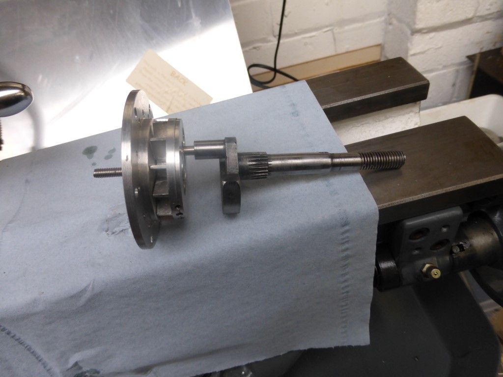

                                                  #392070
                                                  David K
                                                    @davidk77137
                                                    Picture showing how the diffuser is driven from the crankshaft big end. p1040860 (medium).jpg
