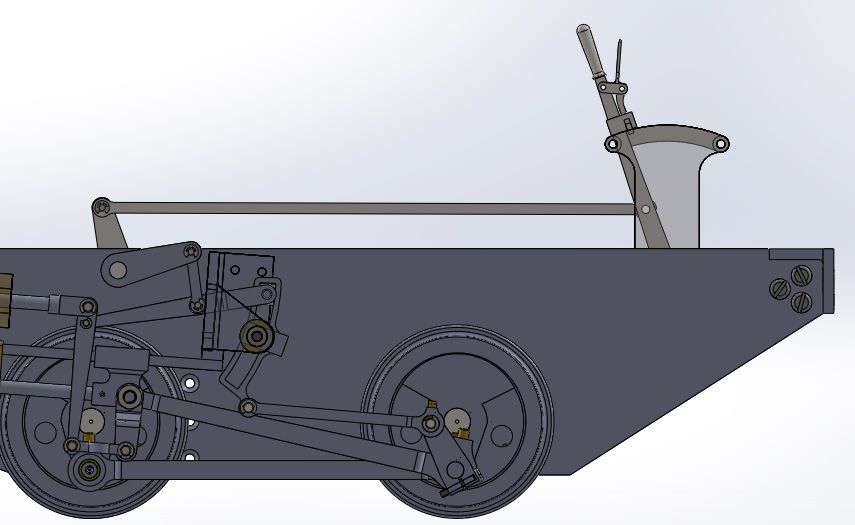

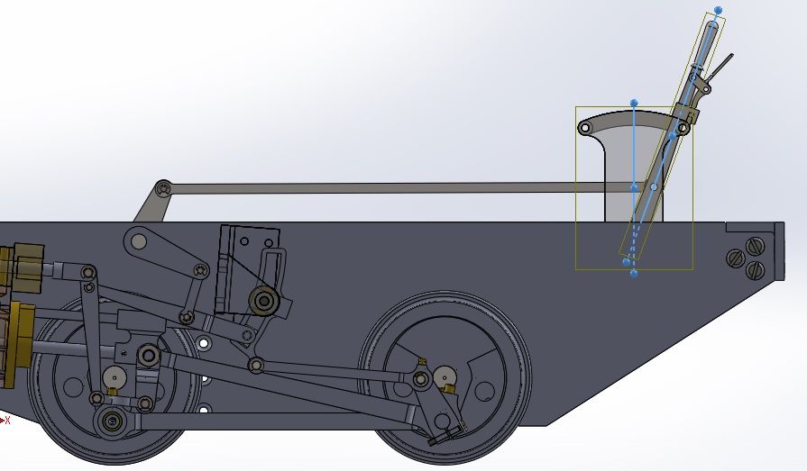

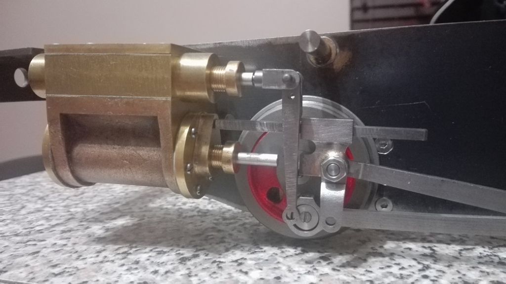

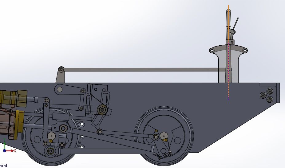

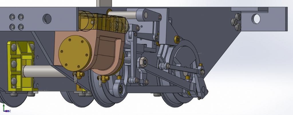

      I have had a question poised by a member regarding the full forward and reverse gear of Tich and the related movement of the die block in the expansion link. Following our chat I have had a look at my Solidworks model and found a similar concern.
      See below:
      I have had a look at my CAD drawings and the originals in the book and I have kept the dimensions of the reach rod the same. So between centres the holes are 160.337mm apart (6 5/16&quot. I have taken some screen shots to show you. It seems that I have the same problem…
      Here is the model in mid-gear, middle of expansion link.
      Here is 15 degrees backwards (limit of sector plate)
      Here is the die block at the bottom of the expansion link (20 degrees).
      Full forward gear (limit of sector plate)
      Die block at top of expansion link
      The amount of overrun on the sector plate seems like a lot but the difference between the obtainable full gear and the movement of the die block in the expansion link does not. I am almost sure that LBSC just made the expansion over-sized.
      I think that it would make sense for the full forward and reverse gear to have correlated movements of the die block to the extremes of the expansion link, but it does not seem so here.
      Can anyone shed some light on the above?
      Regards
      Ryan
      #268894
      julian atkins
        @julianatkins58923
        Hi Ryan,
        You have approached the problem from the wrong way.
        You need to work out the correct valve events in fullgear, then work back from this.
        I always make the reverser to suit the gear.
        You need to be avoid overrun of the valves in fullgear.
        You really ought to run the Tich valve gear on a computer simulator for valve gears, though I am not aware of any particular errors in LBSC's gear as designed. Some fine tuning has been done to LBSC's Juliet, but I am not aware this has been done for Tich.
        Cheers,
        Julian
        #268904
        Ryan Norton
          @ryannorton40317
          Hi Julian
          You are right, I never thought of it that way, after all, correct valve events are what count ultimately.
          I have dabbled with some simulation software in the past but never really got it working properly, I suppose now Ill have to…
          I do however think that the Tich valve gear is fine for normal operation as there have not been many complaints. Maybe if one were to optimise it further, there may be some changes to be made.
          Thanks again Julian

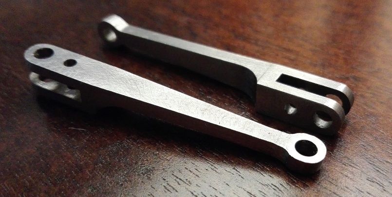

          #269867
          Ryan Norton
            @ryannorton40317

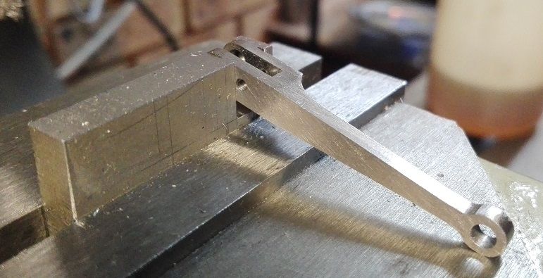

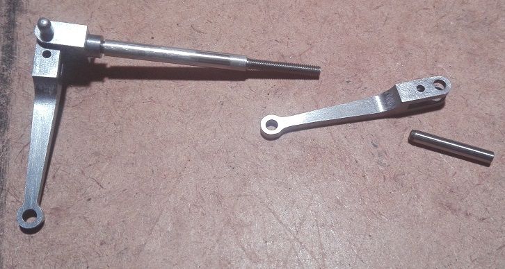

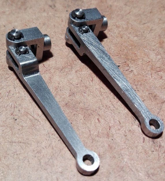

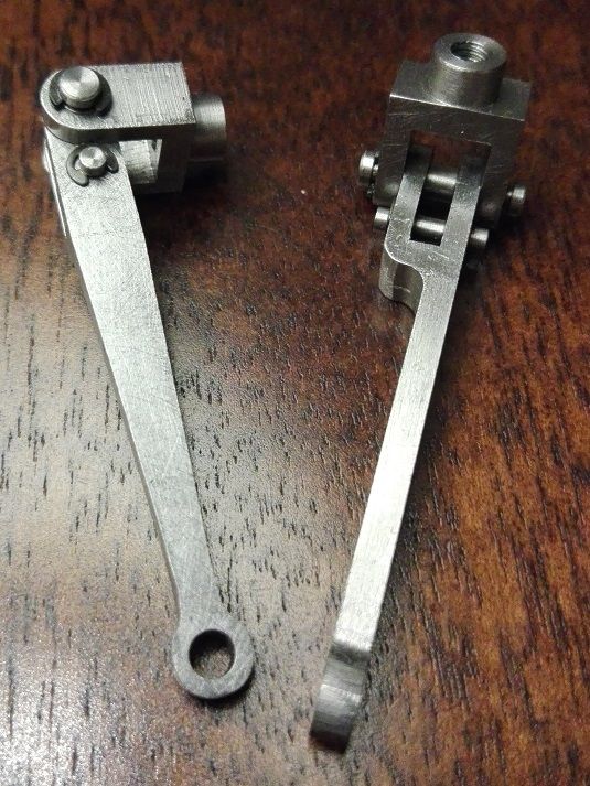

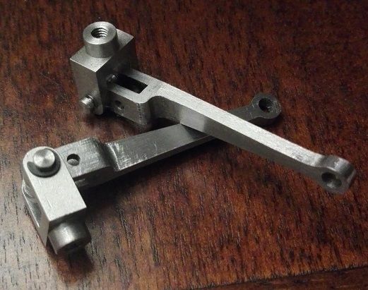

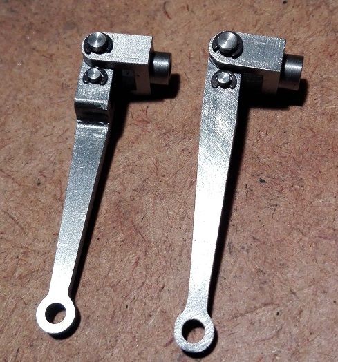

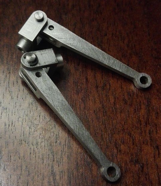

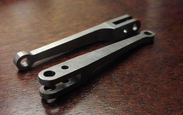

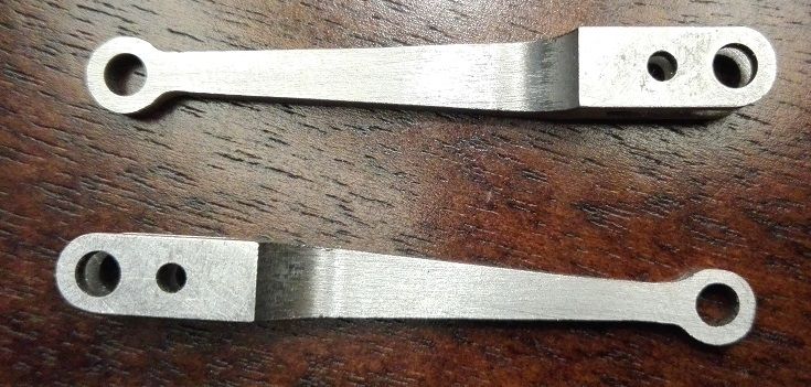

            I have almost completed the combination levers. all that is to be done now is to convert the nice clean sharp edge into a radius.
            I am fairly happy with my filing, possibly a couple of bits here and there to clean up.

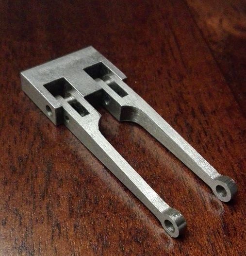

            #270430
            Ryan Norton
              @ryannorton40317

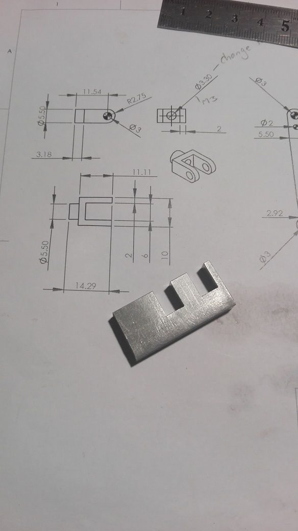

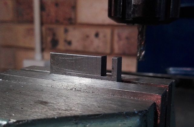

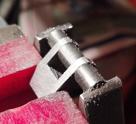

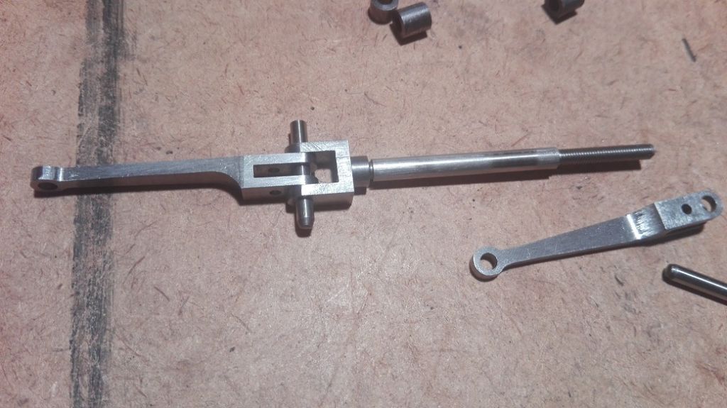

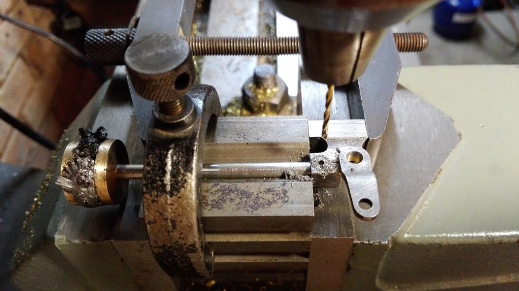

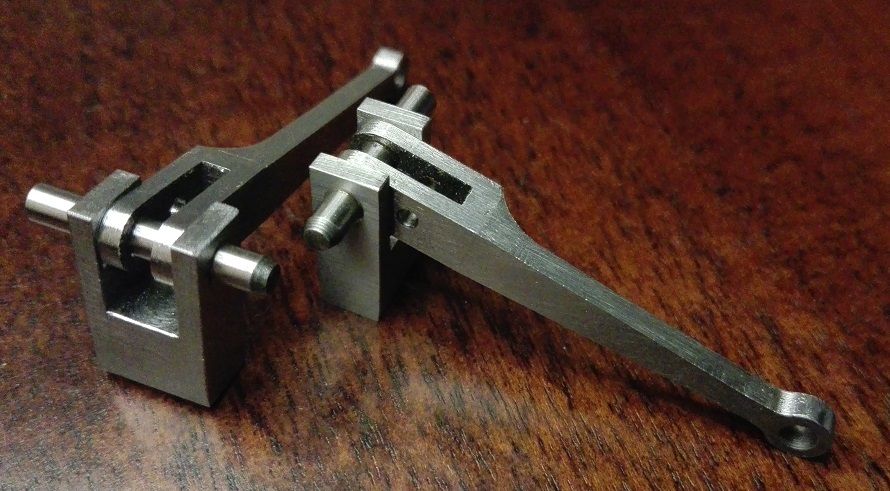

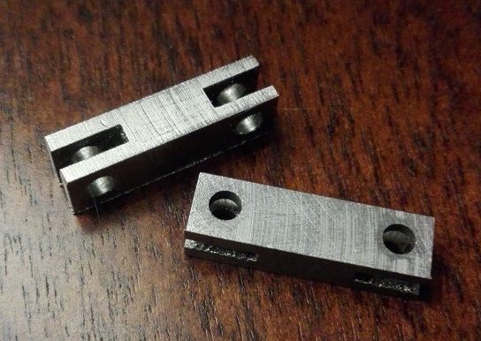

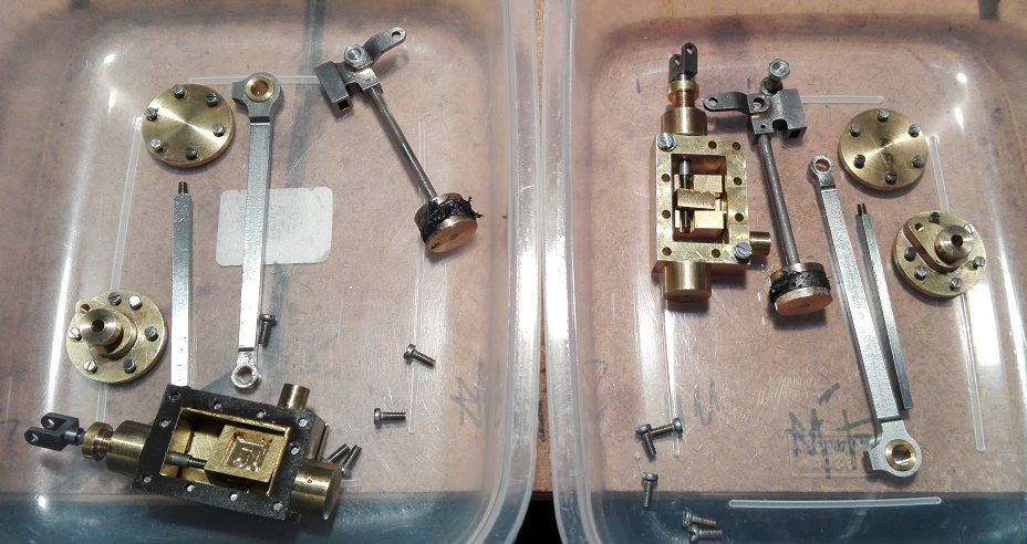

              Now for the valve spindle forks.
              These are machined from 6 mm steel plate.

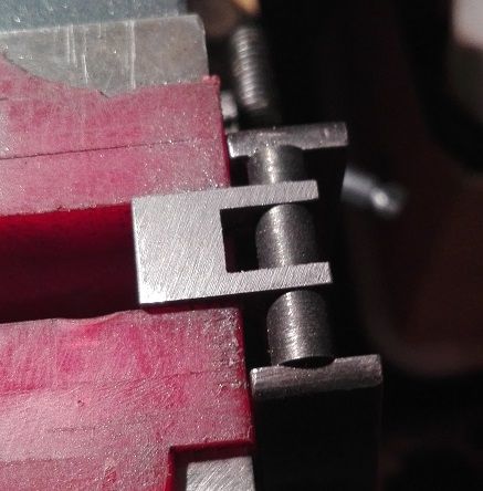

              Test fitting the combination levers.
              Above, the levers are tested in the forks with some 3 mm dowel pins.
              Next, file the radii on the fork ends and turn the spigot on the front of the fork and thread M3 for the valve spindle.
              #270768
              Ryan Norton
                @ryannorton40317

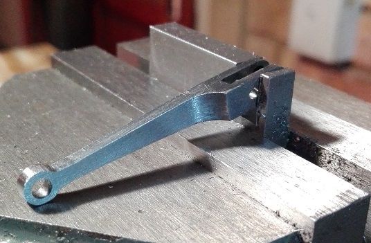

                The radii were filed using filing buttons held in place with the 3 mm dowel pin and a small engineers clamp.
                (The final thickness of the valve fork was also filed using the buttons as a guide- a bit off both sides)

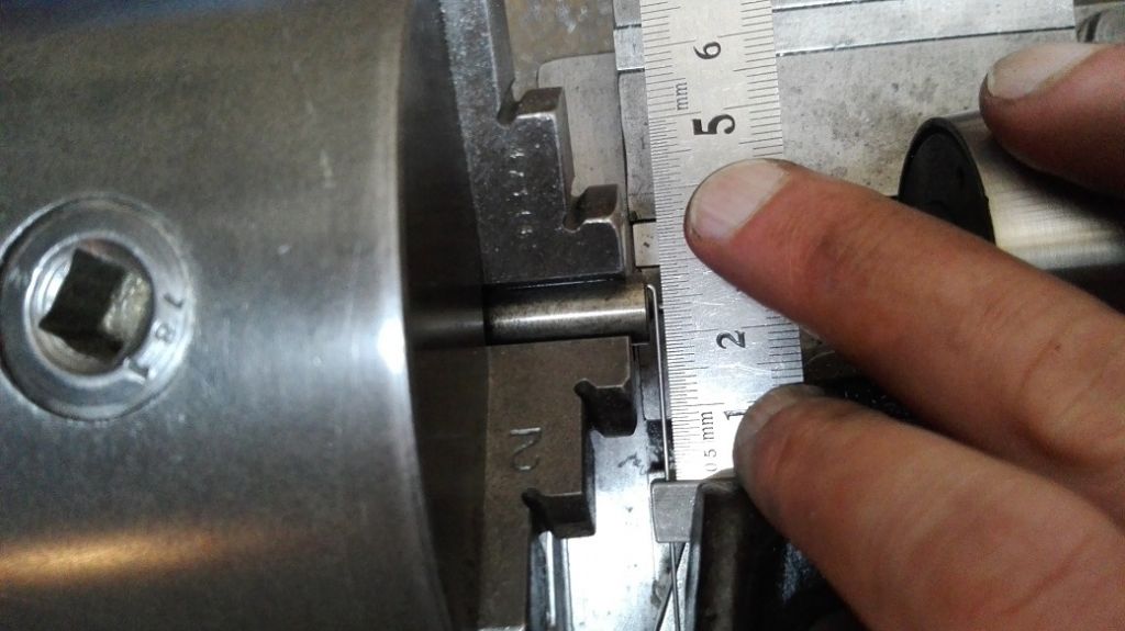

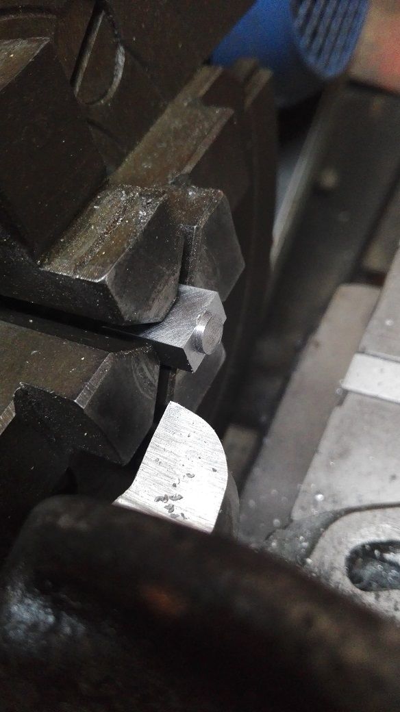

                The forks were then set-up in the four-jaw and faced to final length and then the spigot turned, drilled and tapped to M3 to suite the valve spindle.
                I used the excess to first do a test run on the sizes etc. then faced it off completely and turned the final spigot.
                Finally, test fit on the loco.

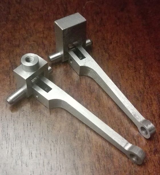

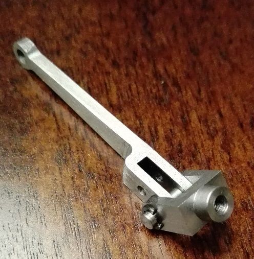

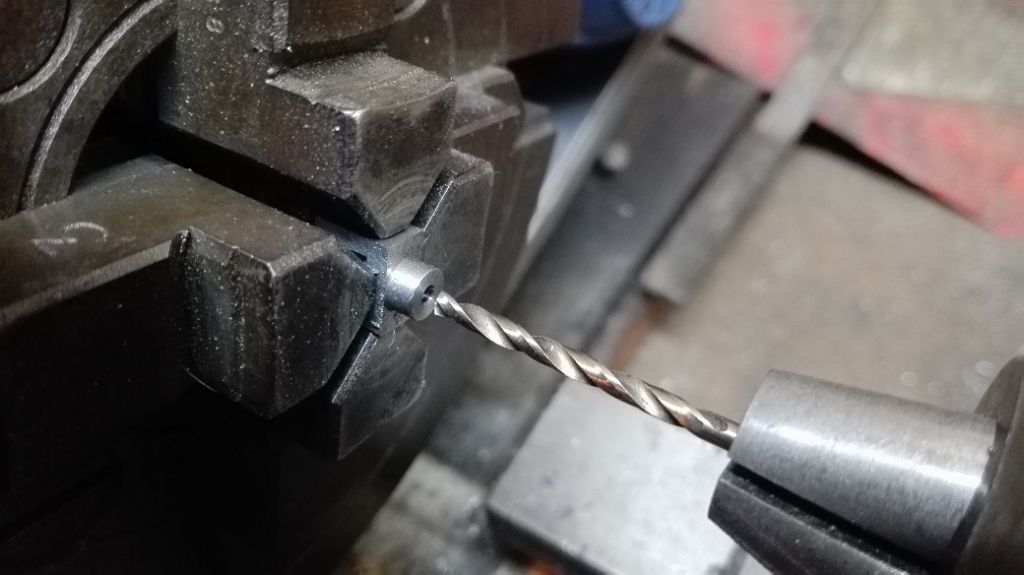

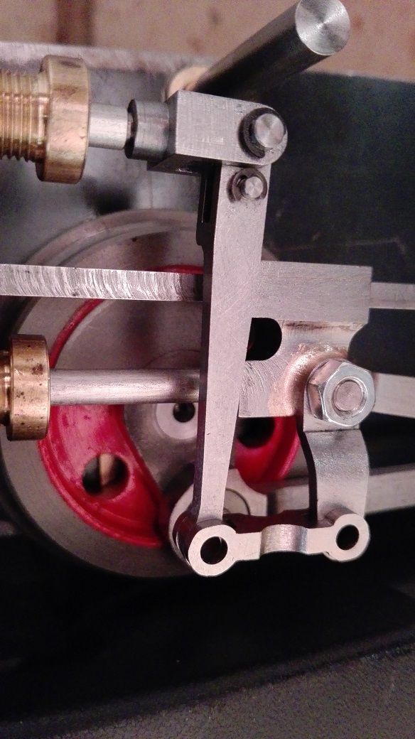

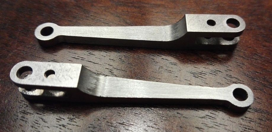

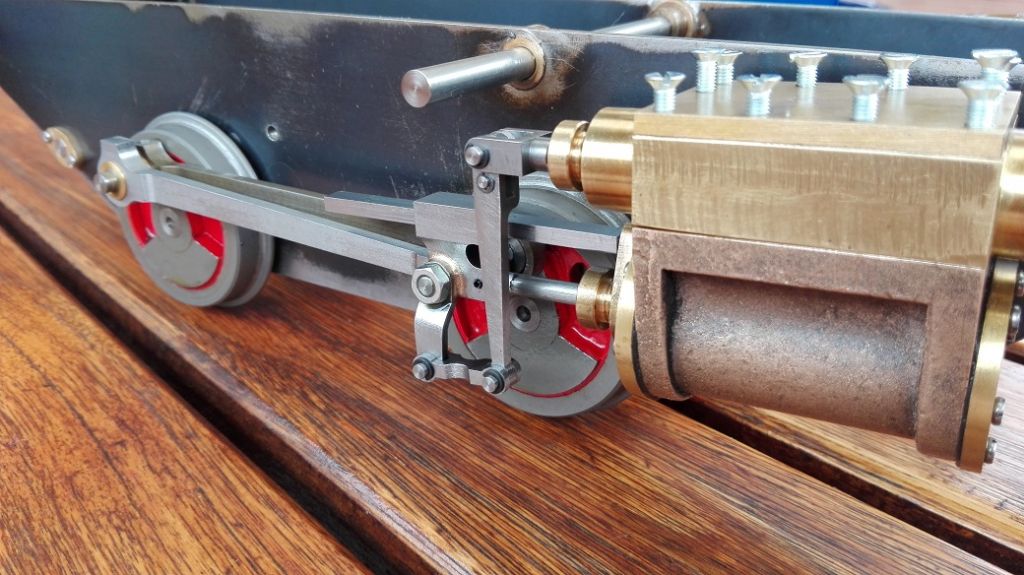

                        I have completed both valve forks now, but after fitting to the loco, there was a bit of a clearance issue with the cross head. It turns out, the radius I milled was too big so I had to file it slightly smaller. I also did the convex radius on each lever.
                        The pivot rods were also machined to size and the grooves for the e-clips cut.
                        Here are the final levers, forks and pivots.

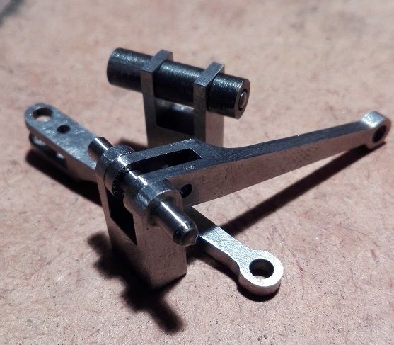

                        #273222
                        Ryan Norton
                          @ryannorton40317

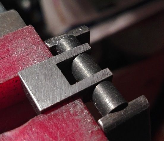

                          I have now completed the pivot pins for the combination lever-radius rod interface. These are 2 mm with 1.2 mm e-clips, tiny turning I tell you!

                            Posted by Ryan Norton on 04/12/2016 17:57:20:
                            You might be 'fairly happy' Ryan, I'd be over the moon if my filing was that good. Obviously I need a lot more practice!
                            Never mind, keep the pictures coming – they inspire me to try harder.

                            #275598
                            Ryan Norton
                              @ryannorton40317
                              Thanks Dave!

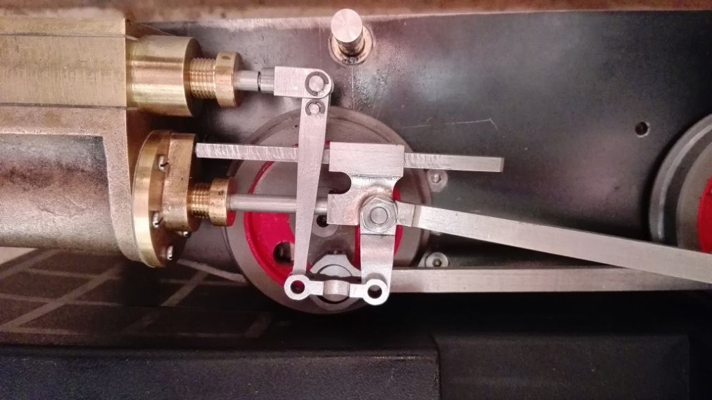

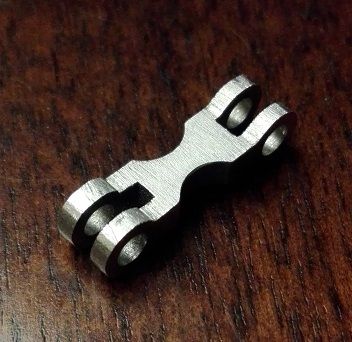

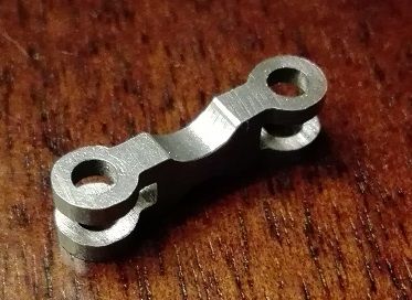

                              Here are some photos of some of my productivity towards the end of last year.
                              Embryo Union links
                              Almost finished union links
                              My TICH
                              #276074
                              Ryan Norton
                                @ryannorton40317

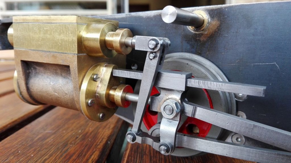

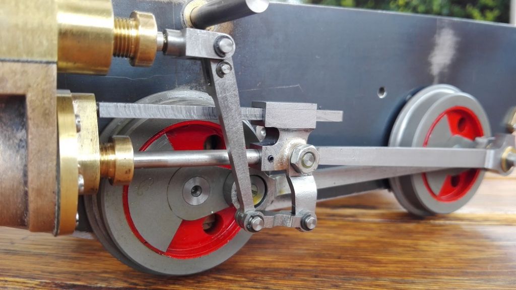

                                Here is another photograph with the union links and finished pins in situ.

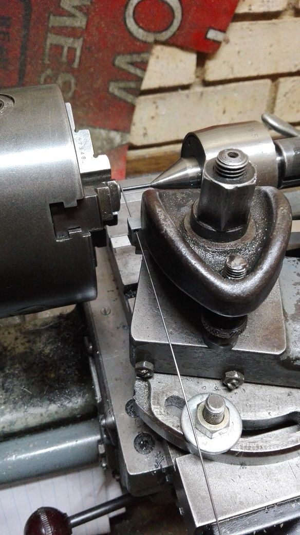

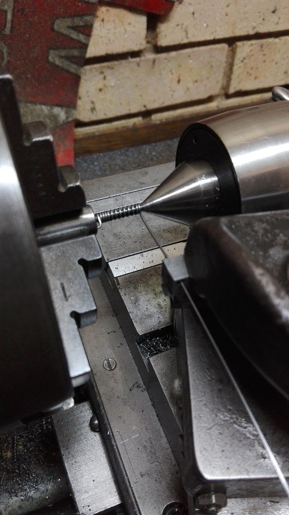

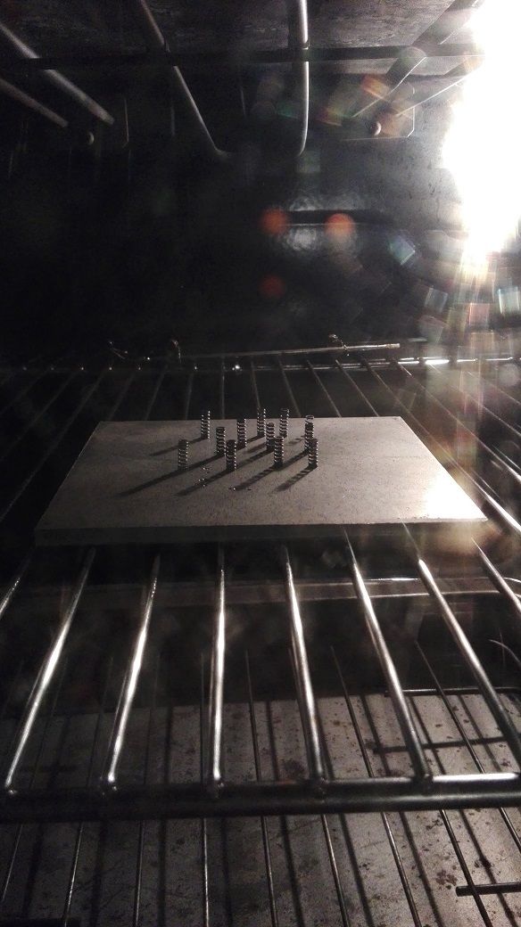

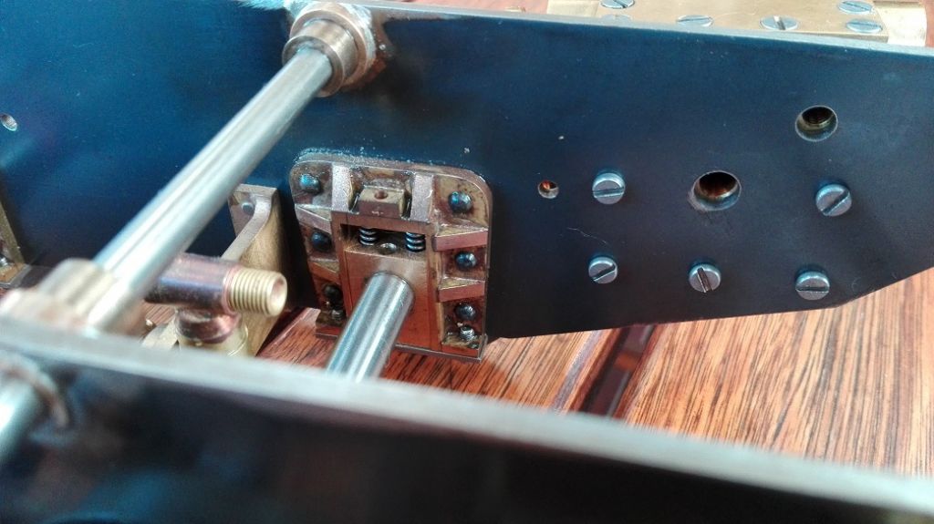

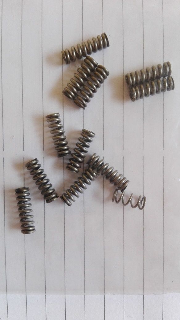

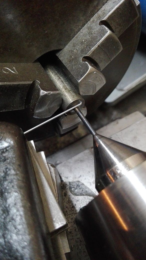

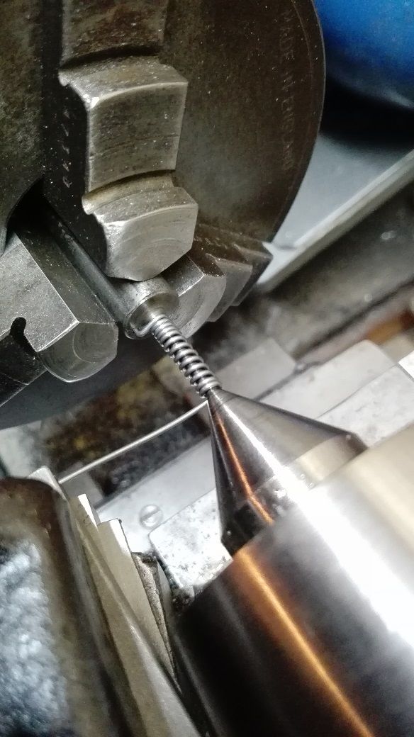

                                    I have been busy with a few small odd jobs recently on Tich. Finally I have done the RHS steam chest. All that is required is for me to complete the steam chest cover and drill the holes into the cylinder blocks, then both sides will be at the same stage.
                                    I also mentioned a while ago that I was not very happy with the current suspension springs that I had previously made, so with a couple of very difficult calculations and a bit of guess work, wink I have made some new springs.
                                    The method I had used previously was not as clean and repeatable as I would have liked and so I made some changes.
                                    Firstly I made a 2 mm mandrel from 10 mm silver steel onto which the wire would be wound. A 1 mm hole was drilled into the 10 mm rod, parallel with the thin part of the mandrel.
                                    This hole would allow for the wire to be kept in place when winding and would also allow for the finished spring to be slid off once finished.
                                    The wire had a small 90 degree bend in it to go in the hole.
                                    The setup is pretty standard for spring winding as far as I know. In order for the process to be repeatable I noted the settings of the top slide, cross slide and lead screw dials as well as the orientation of the chuck jaws in relation to the starting point. The screw cutting gear train for 18 TPI was set up and 0.8 mm music wire was used.

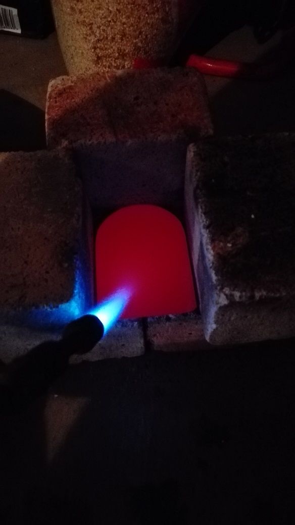

                                    The silver steel mandrel was hardened and tempered as per standard practice for silver steel and the end was drilled for a running center to support the end.
                                    Once the springs were wound, they were ground to size with a couple of the redundant starting coils removed as well.
                                    I then placed the completed springs into the oven at 180 degrees Celsius for 30 minutes to remove any internal stresses caused by the bending process.
                                    Finally here is a look at the new springs versus one of my original springs which is clearly not correct for the job.

                                          Anyway, here are some photos of Tich with a new "spring in her step", as it were, as well as some others.

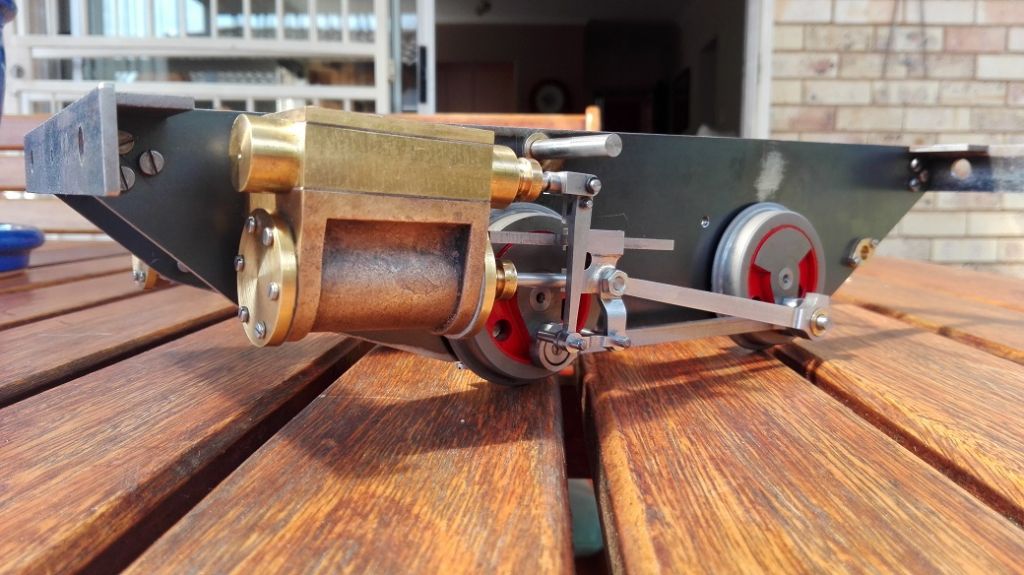

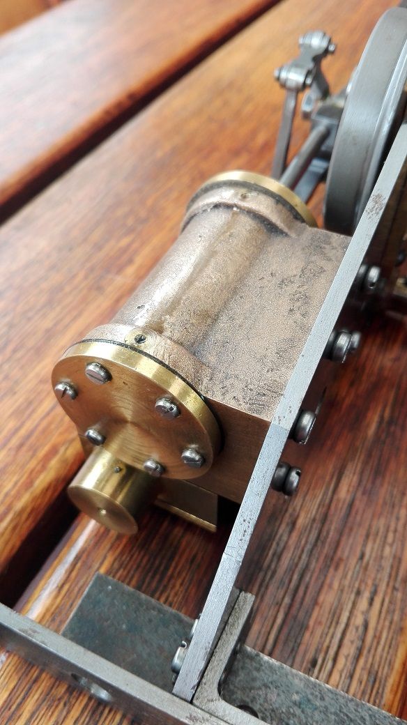

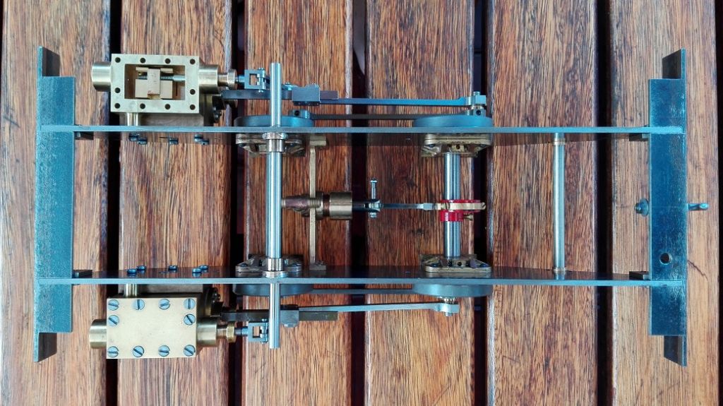

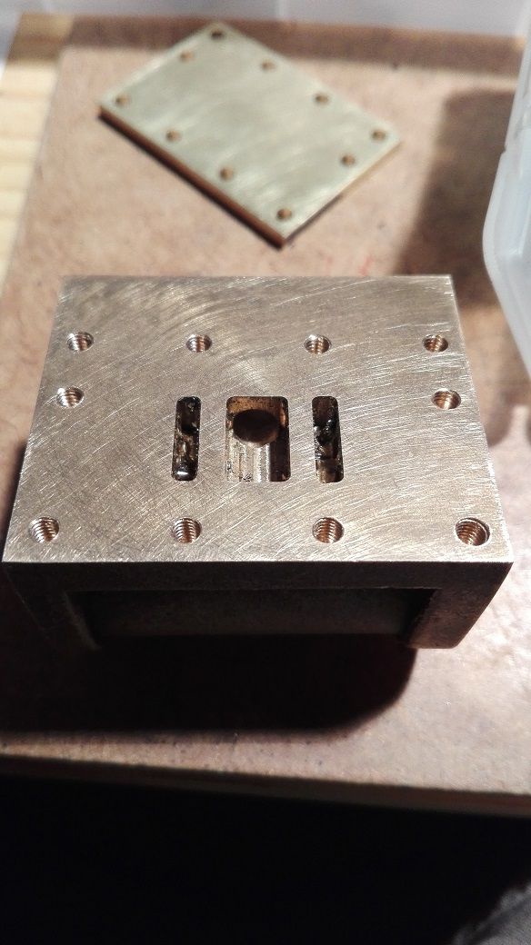

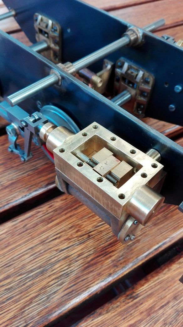

                                            I have been busy completing the RHS of TICH.
                                            I have also drilled and tapped holes for drain cocks.

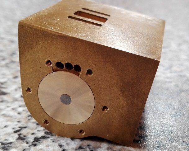

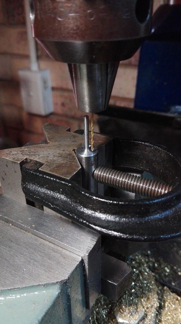

                                            The piston rods and cross heads were drilled as per the "Words and Music" but instead of a piece of spoke wire hammered in and filed flush, I have used spring pins.

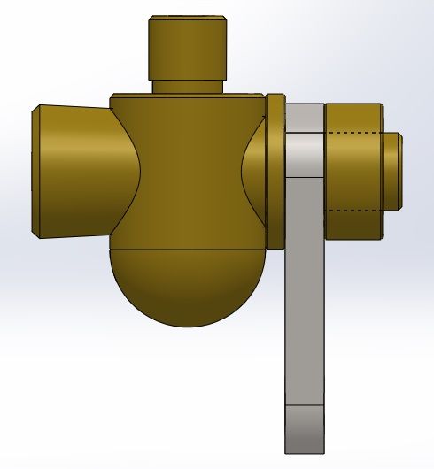

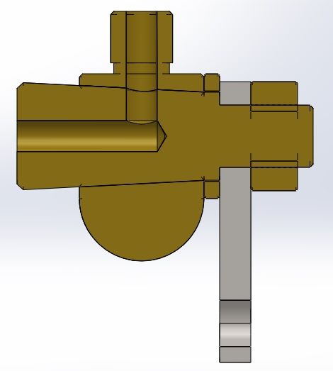

                                              I have done a quick design of a manual drain cock, based on some research and along the lines of what I like.
                                              I have come up with the following, keeping in mind I do not want something bulky:
                                              The threaded parts are M2 and the steam hole is 1mm. There are minimal moving parts and only the need for one washer and nut. The cocks will be lever operated from the cab by means of levers or bicycle cable in a brass tube. Does anyone have any better ideas before I go ahead? I do not want auto drain cocks as I feel the manual ones are more "Romantic" if that makes sense…?

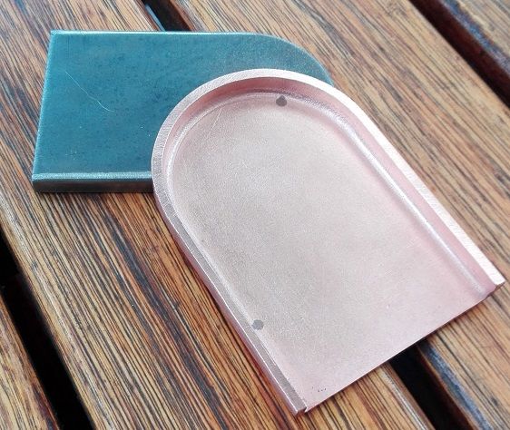

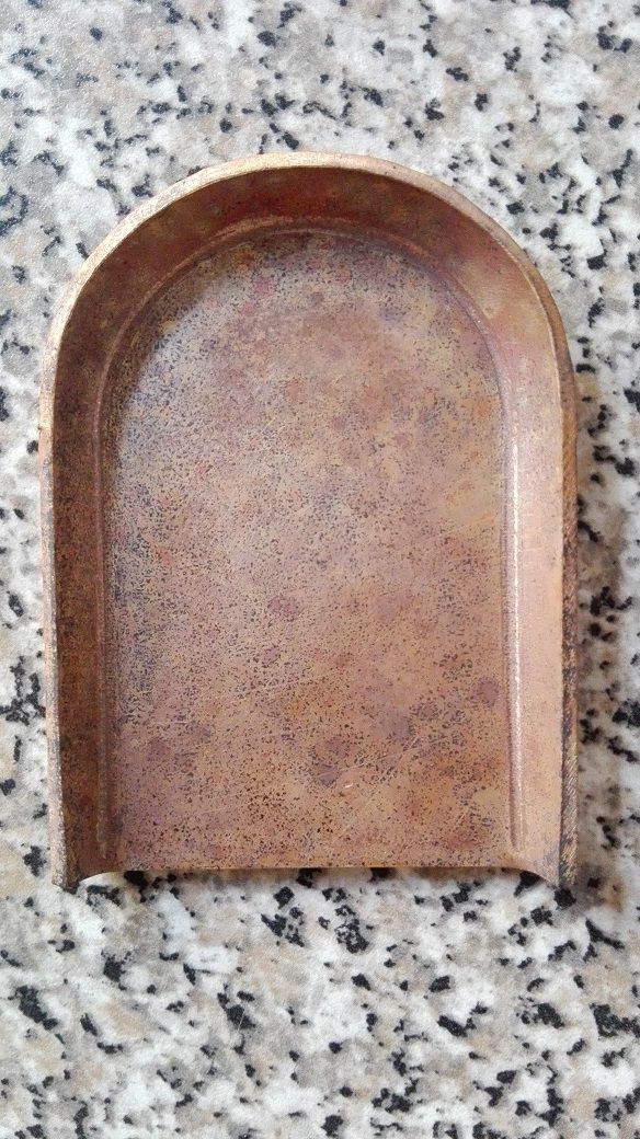

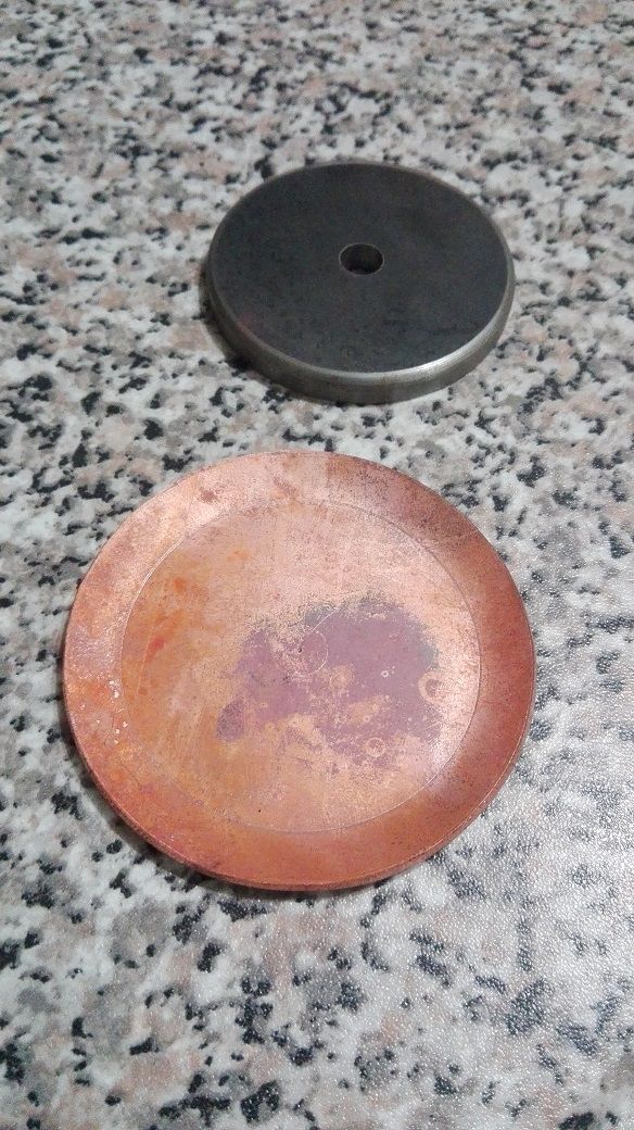

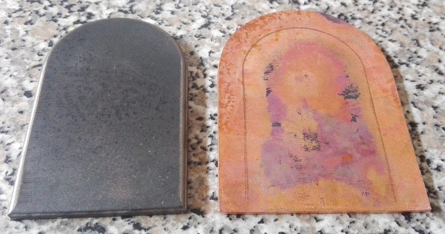

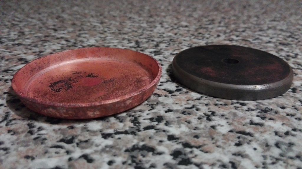

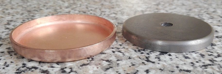

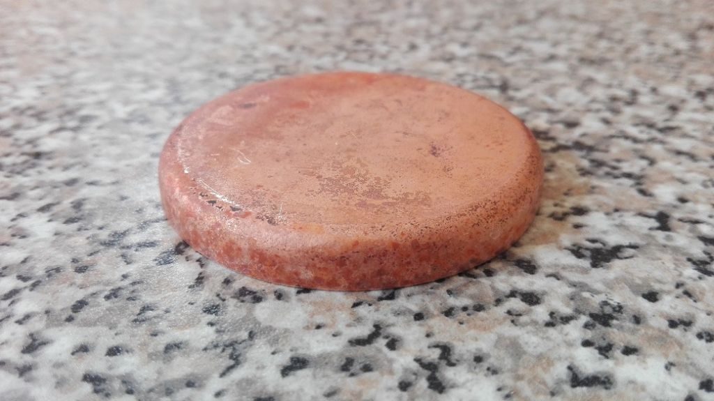

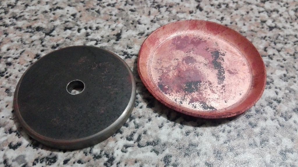

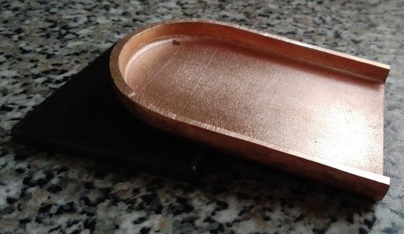

                                              #285540
                                              Ryan Norton
                                                @ryannorton40317

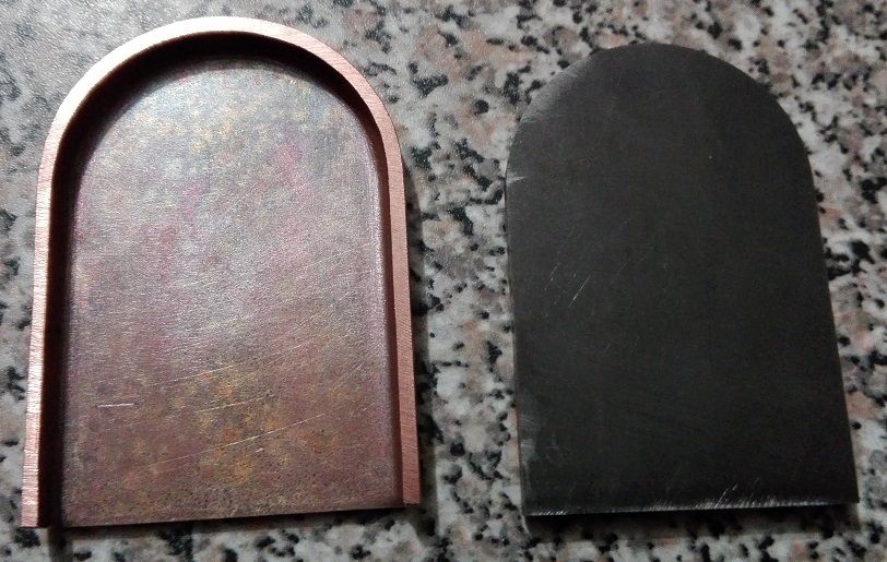

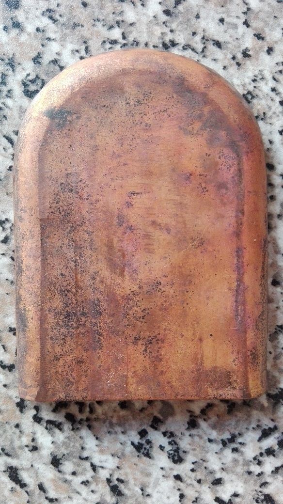

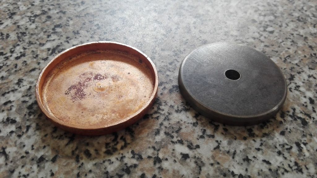

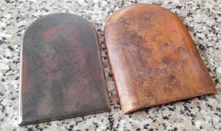

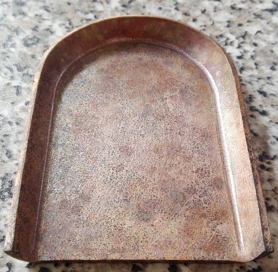

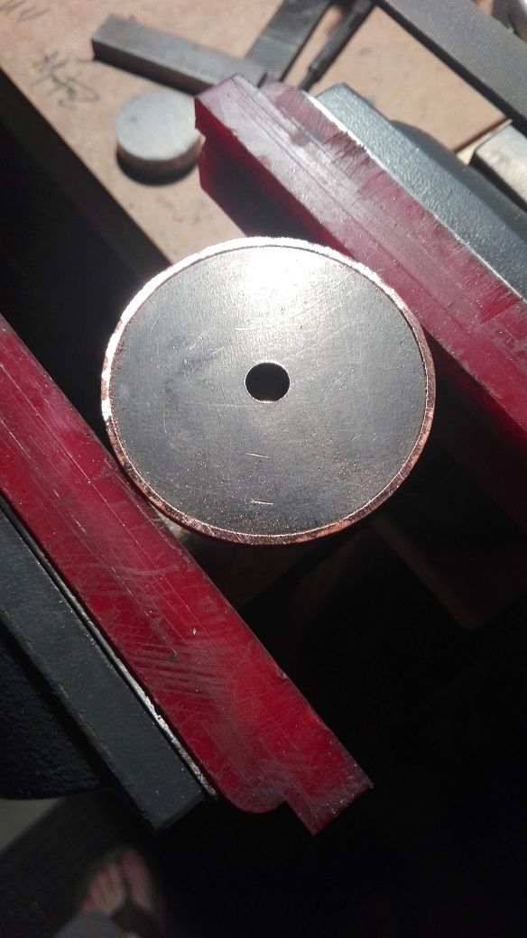

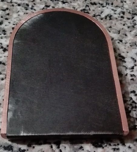

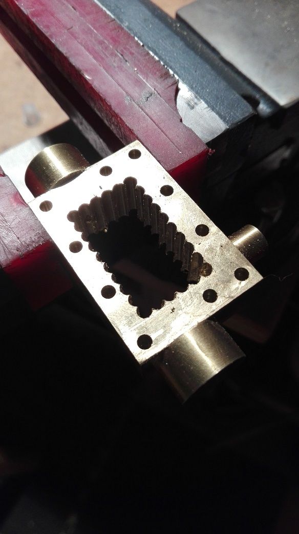

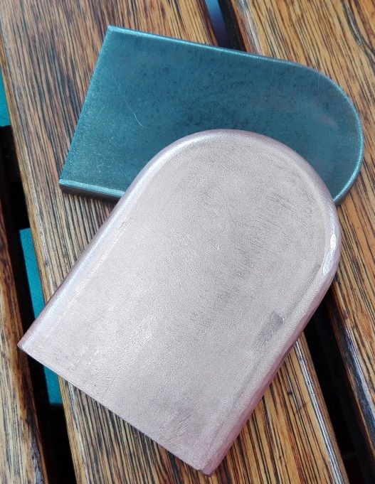

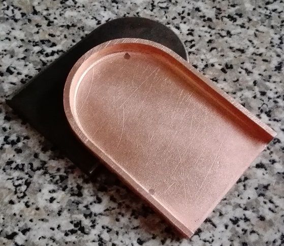

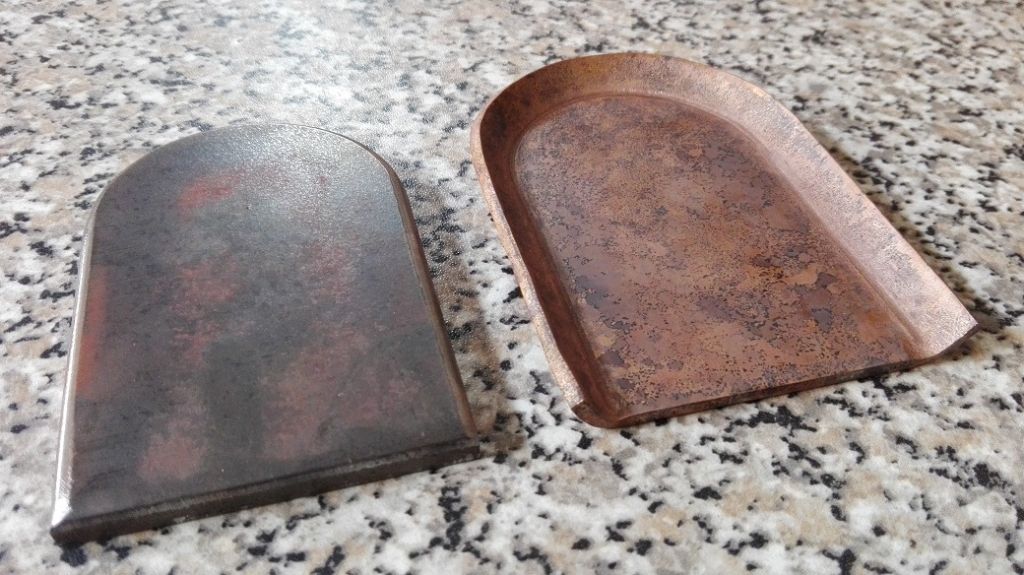

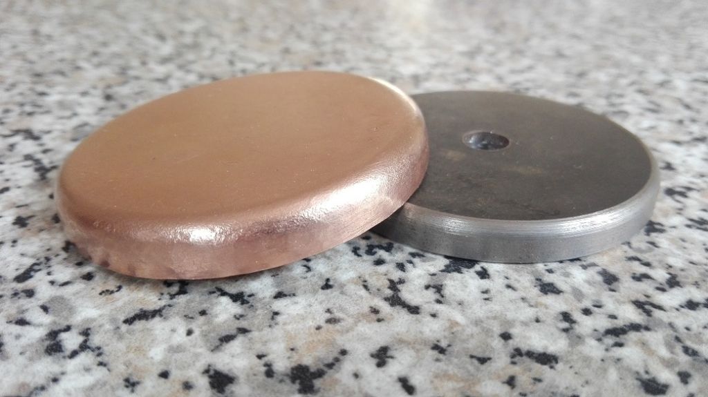

                                                I have been doing some more copper smithing. The smokebox tube plate and backhead are flanged and cleaned up.
                                                Here are some photos covering the process on both.
                                                and here is the backhead.
                                                #285554
                                                Another JohnS
                                                  @anotherjohns
                                                  Ryan, once again, beautiful work. I do like the spring making, like you, a "little packet from Reeves" is a large expense, due to international shipping.
                                                  My Tich is sitting on a bookshelf close by, waiting for the winter snows to melt – maybe 3 months from now it'll be out steaming again.
                                                  FWIW, when I made the pistons, I only had an old pre-1897 worn out lathe that worked at 1 speed, so the fit and finish was not great. One day, wheezing up hill at our track, I decided enough was enough, and took cylinders off and pistons out.
                                                  One piston had a whiff of graphite packing, the other was bare! Viton O rings fitted, and it has not looked back since. Something to keep in mind, but your workmanship far surpasses mine when I made those parts.
                                                  #285683
                                                  Ryan Norton
                                                    @ryannorton40317
                                                    Hi John, thanks!
                                                    Will keep what you have said in mind. Many people have commented on the use of graphite packing and the issues thereof. I am aware of the modern alternatives which have been pointed out and will see how she fairs with the graphite packing first, before i make any changes. I am using this whole build as a learning experience for myself.

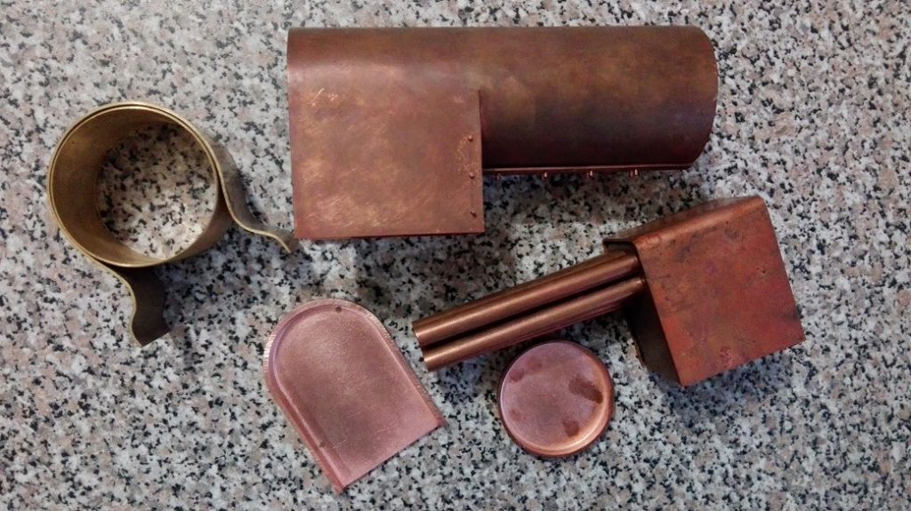

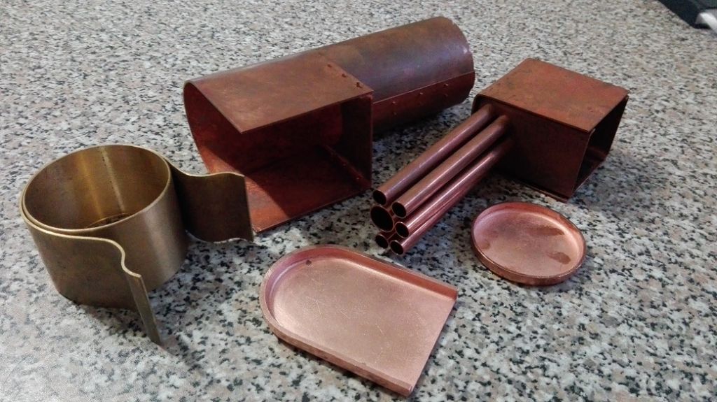

                                                    See pics below of the boiler bits thus far.
                                                    #285775
