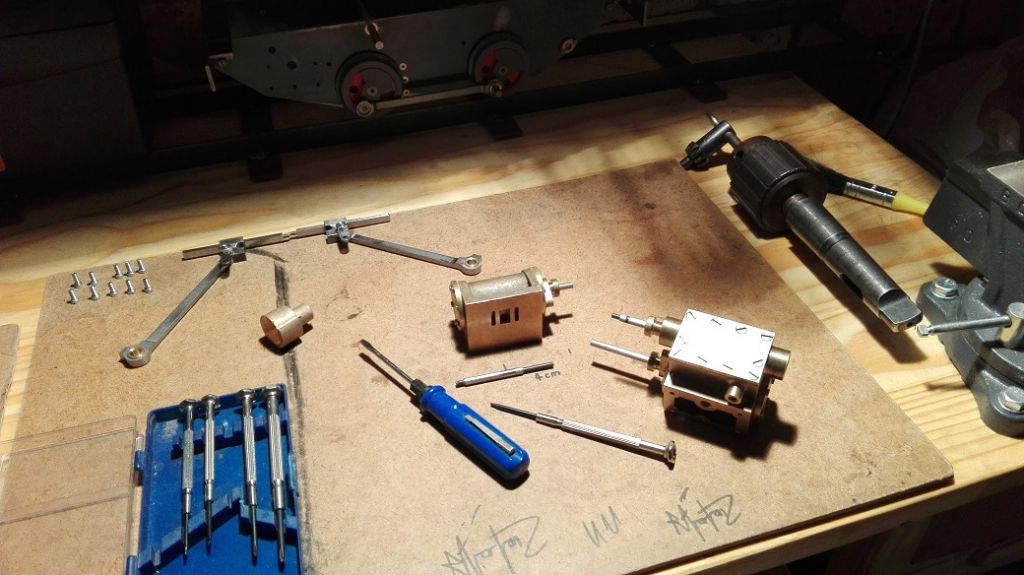

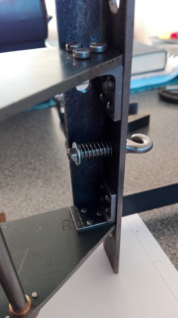

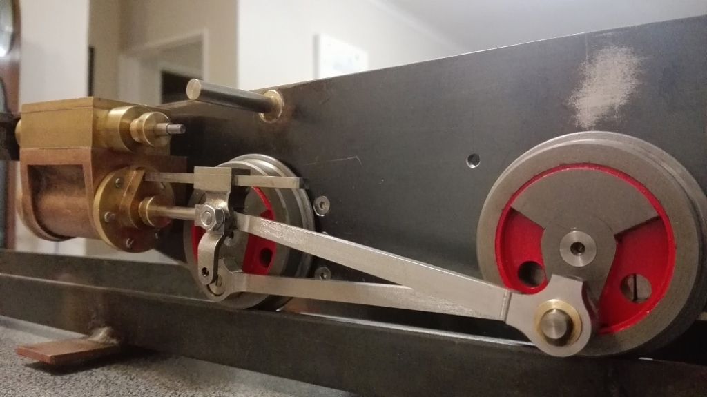

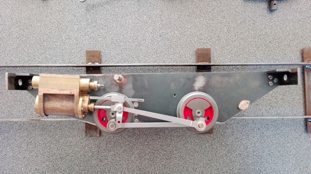

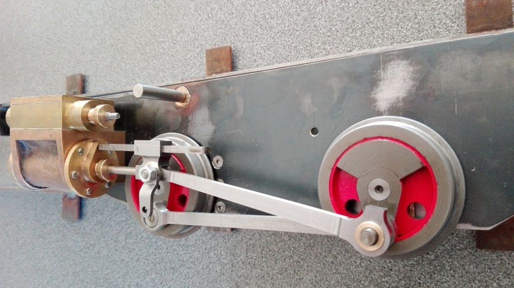

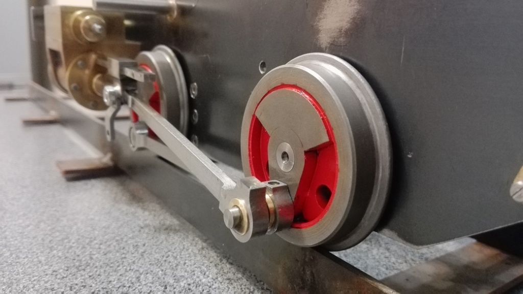

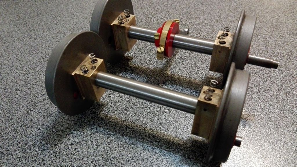

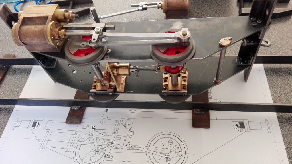

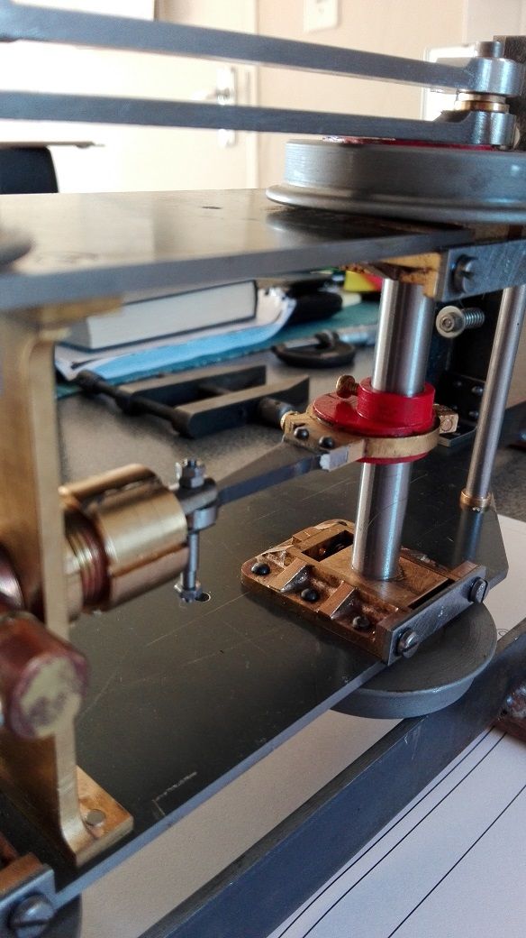

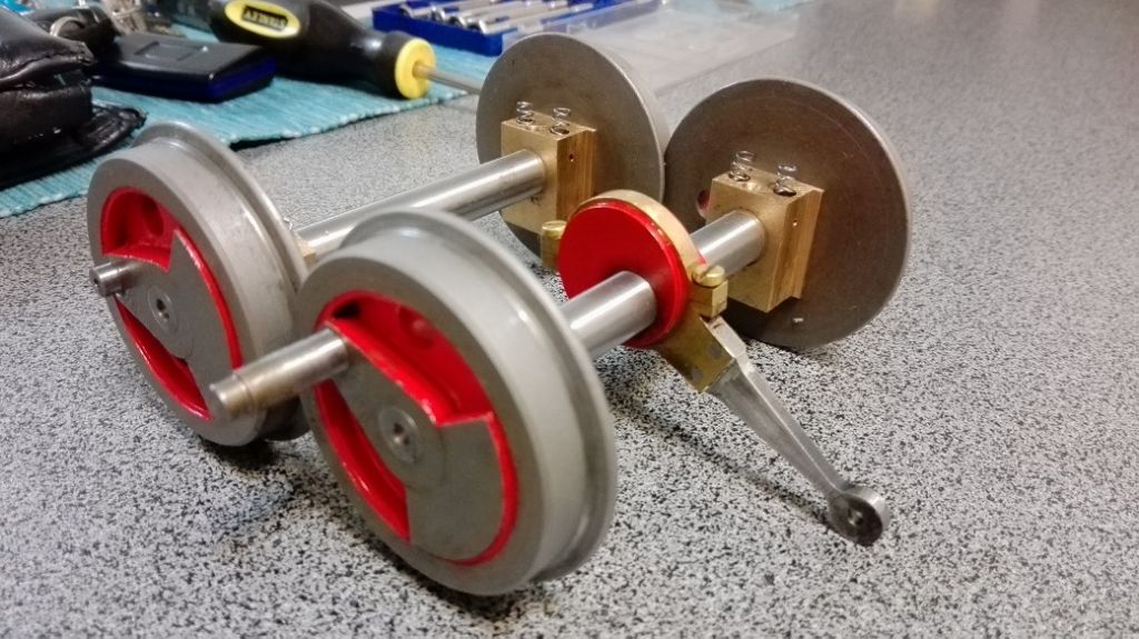

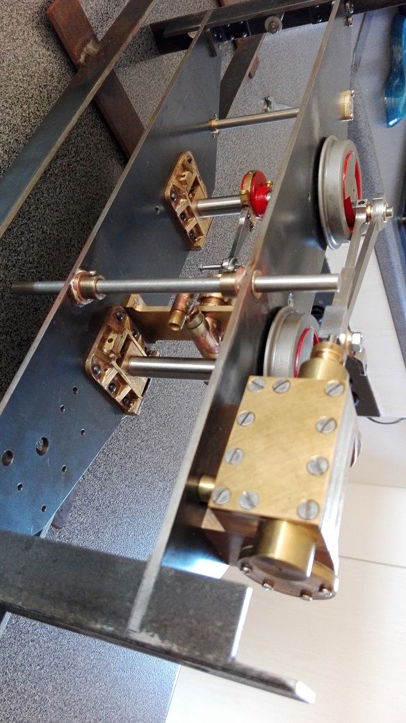

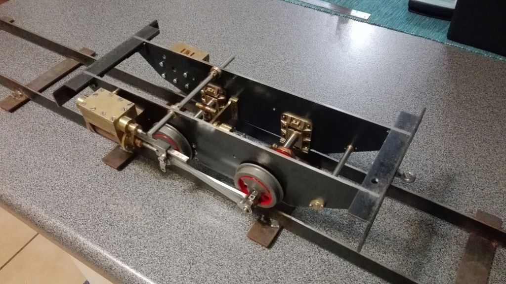

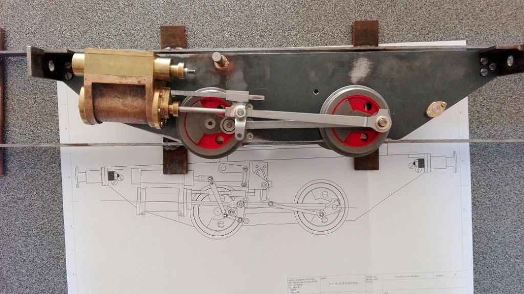

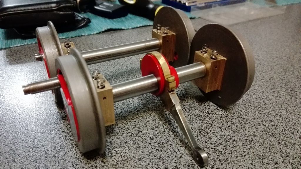

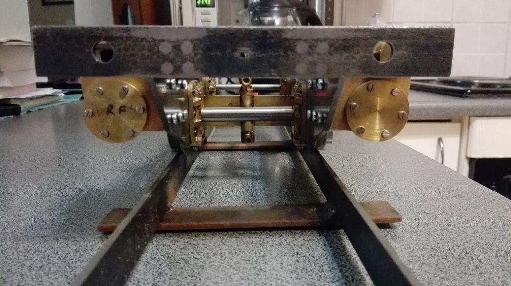

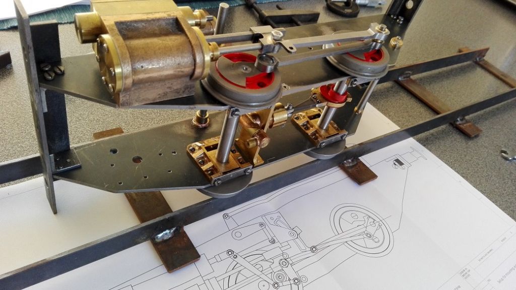

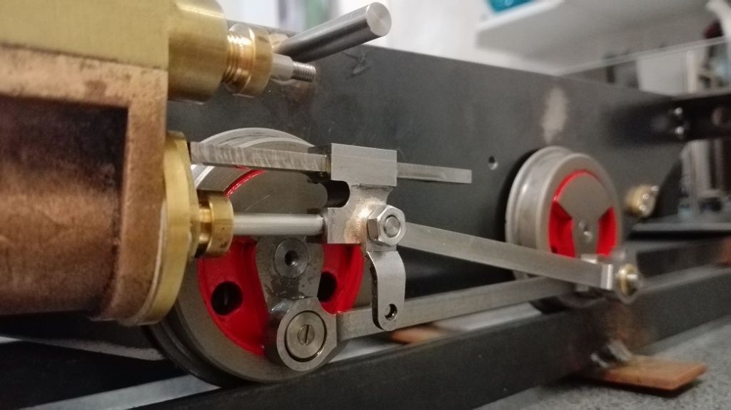

        Right, so I have finally had some time to upload all my photos of the rest of my work in June.
        Whilst I was mounting the cylinders, I took some photos of the loco and her bits, so here they are for interest sake.
        I am still not happy with the springs I have made as seen above and will probably make some heavier springs with a smaller pitch giving more coils.

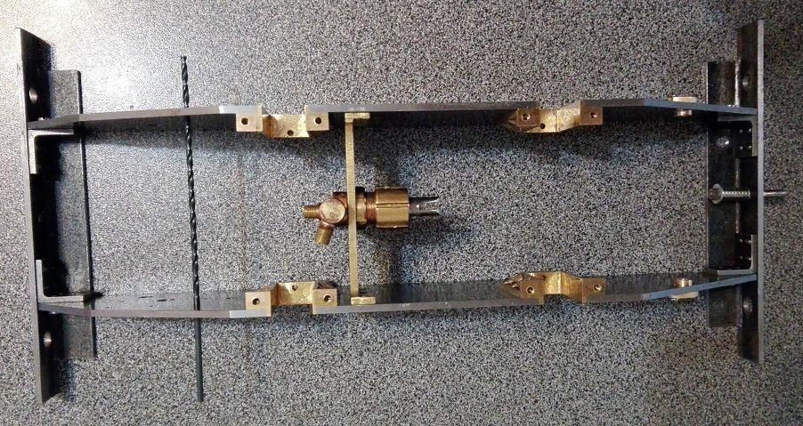

        #263335
        Ryan Norton
          @ryannorton40317

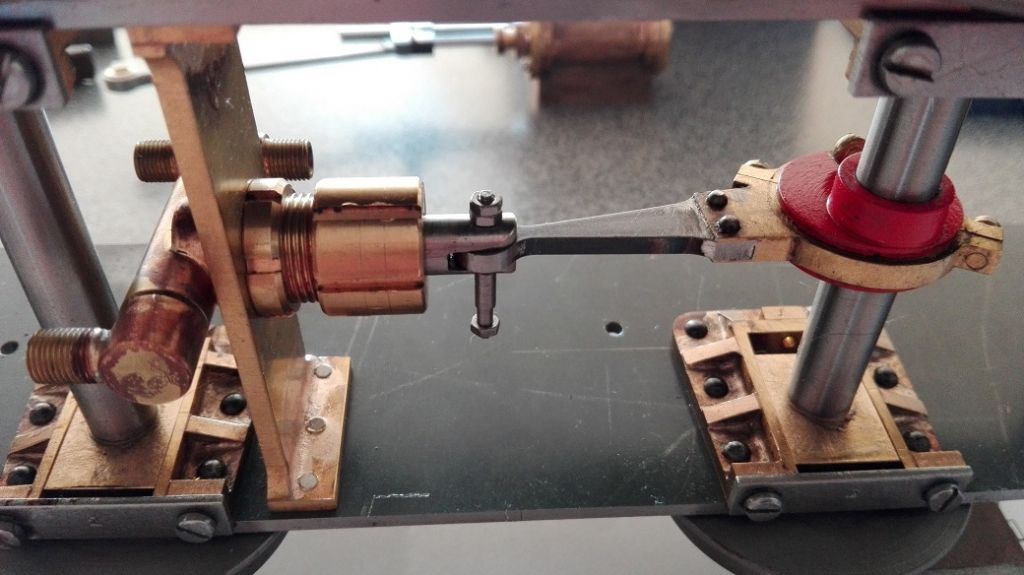

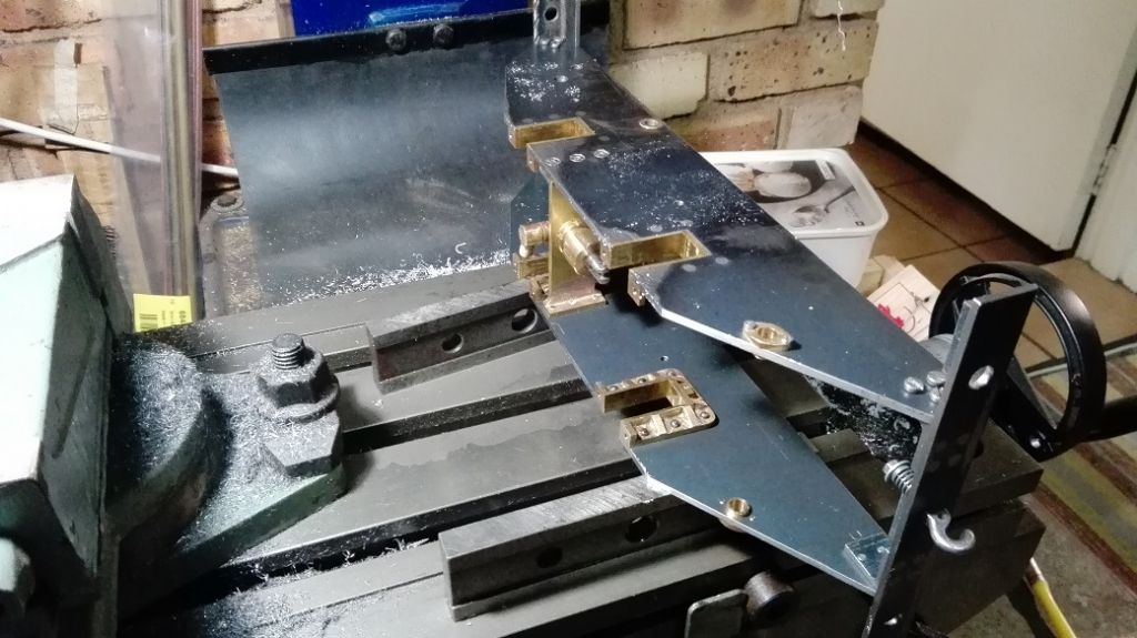

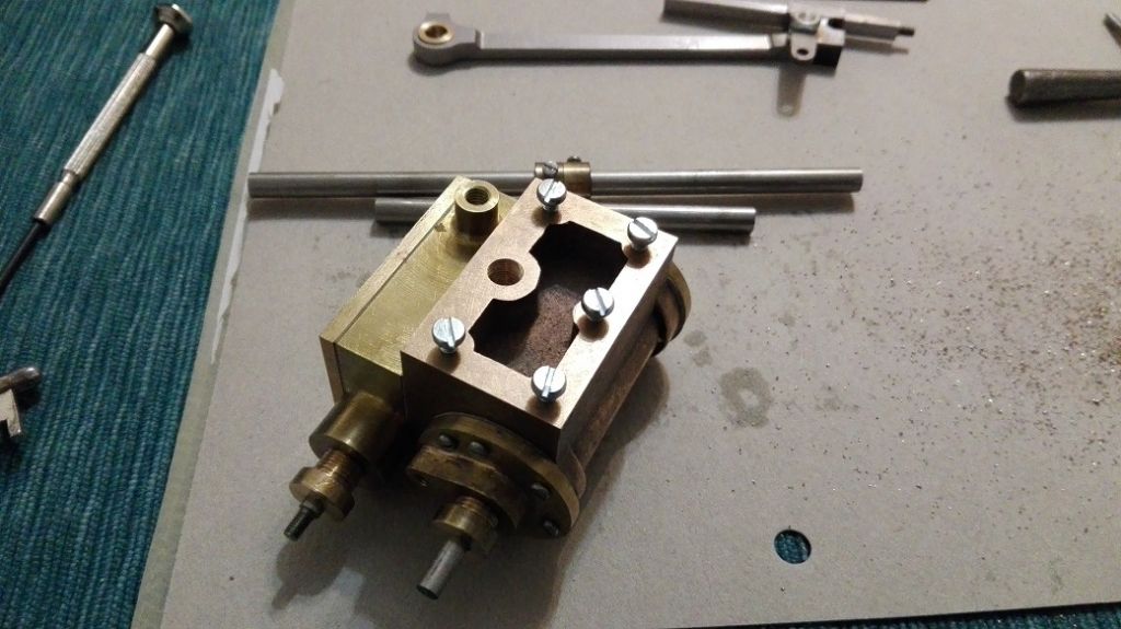

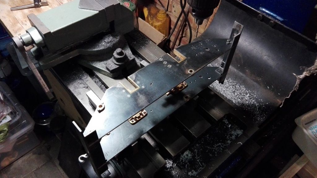

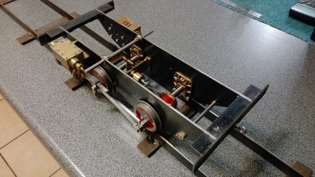

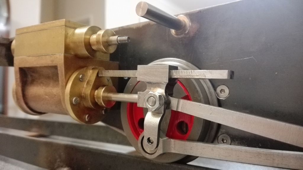

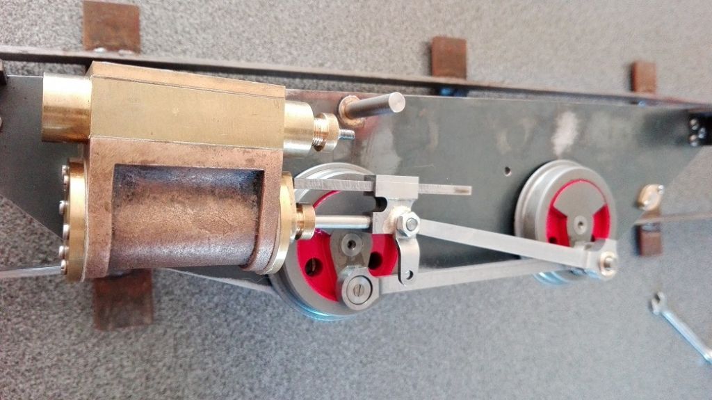

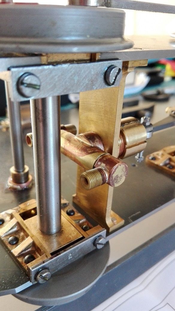

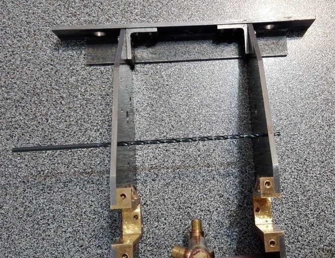

          So on to the cylinder mounting…
          I first had to open out the holes in the frames to the correct size. This was not done originally as I was unsure how I was going to mount the cylinders.
          The frames were placed onto parallels on the mill bed and the holes opened out.
          A long drill was then used to poke between the frames and make a small countersink on the cylinder mounting face.

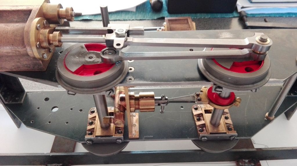

          The cylinder was mounted on the frame with the left crank at back dead center and the connecting rod directly in line with the piston rod. LBSC describes this procedure fairly well so it turned out O.K.
          I used a hand held power drill at a slow speed to create the countersinks on the cylinder mounting face (not shown).
          The countersinks were drilled out and tapped M3. Following this, both cylinders were mounted onto the frames.
          I am happy with the result!
          #263337
            Posted by Ryan Norton on 28/10/2016 08:35:41:
            Me too Ryan! And many thanks for taking the time to document the build for us. Great stuff.

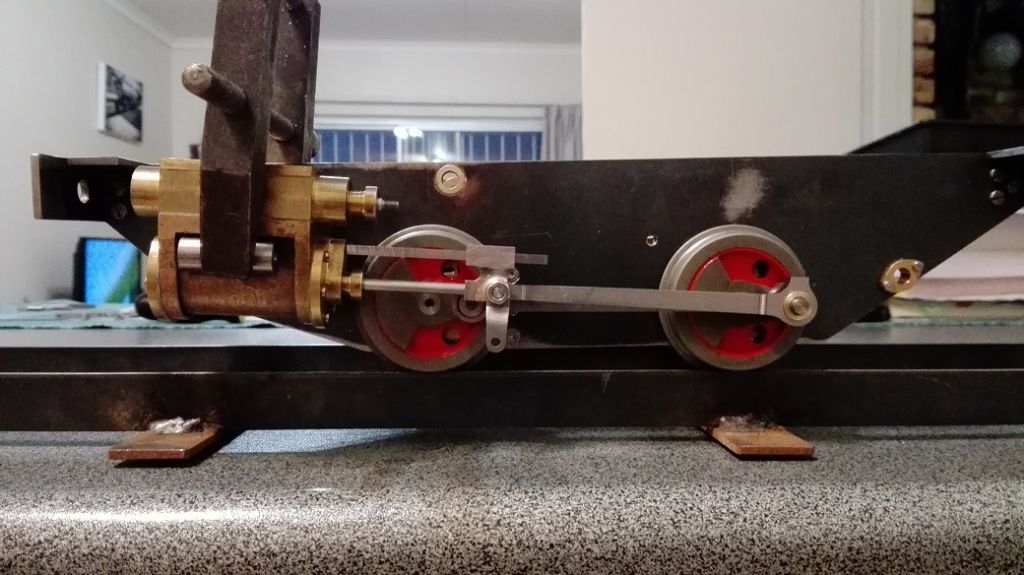

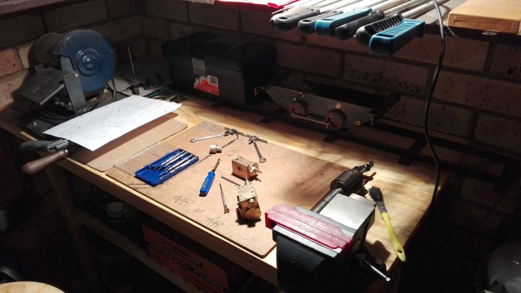

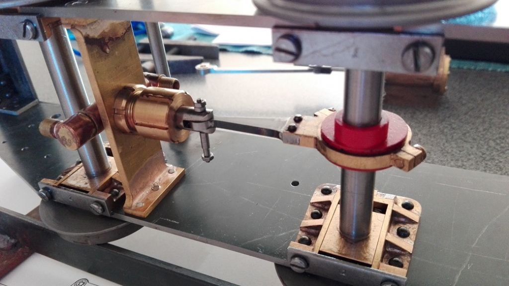

              I have also just moved house so here is my new work space. I still need to move things around and organise all my tools, but I could not wait to get started again on TICH.

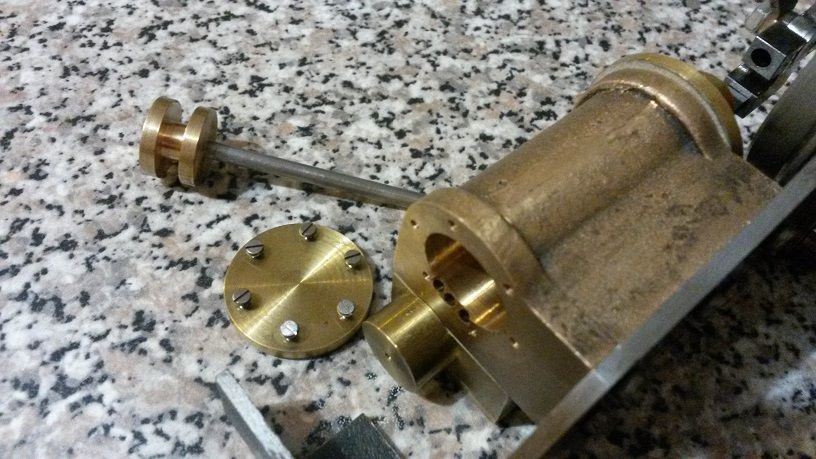

              This last weekend a turned the LHS piston and the fit is great. If I blow into the steam chest and actuate the valve, the piston moves accordingly which is very cool.
              I will post some photos of the piston and piston rods etc. (You can see the RHS piston blank in the pic above).

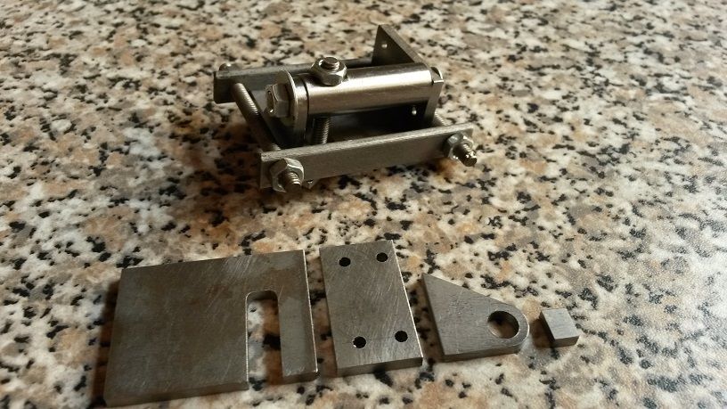

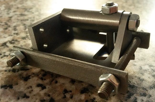

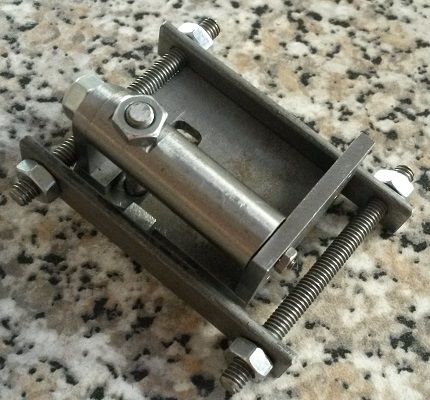

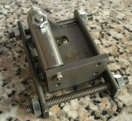

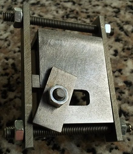

                  I have made a start on the gear link frame fabrication. The jig works a charm.
                  Here are the pics thus far.
                  I still need to cut and file the small square block for the attachment to the guide bar. This will then be held in place by two steel bars and two pieces of threaded rod as can be seen in my previous post of the 3D model.
                  #264654
                  Ryan Norton
                    @ryannorton40317
                    I have completed the jig, I just need a 4mm washer for the larger side and then I can braze the whole lot together.
                    I have used the rectangular washer as a stop for the small block to ensure that it is lined up properly. The pic above shows it moved out of the way for brazing purposes.
                    I will obviously shift the threaded rod portion to the left to keep it clear of the silver solder. This was just a quick mock up.
                    Hopefully I will have some nicely brazed photos for Monday!

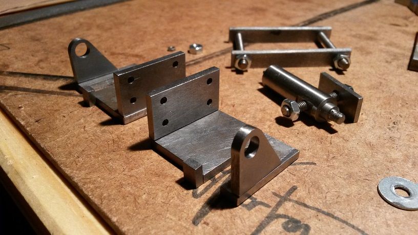

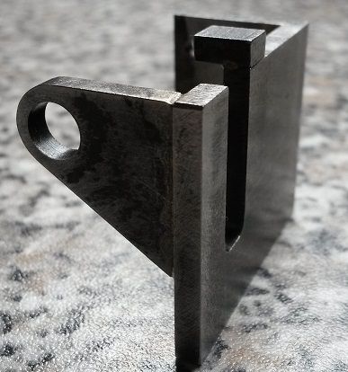

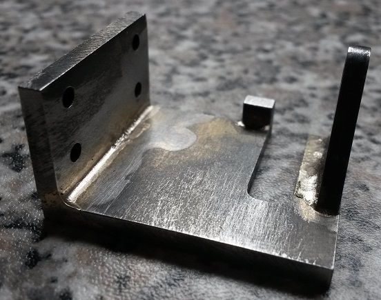

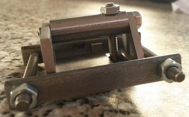

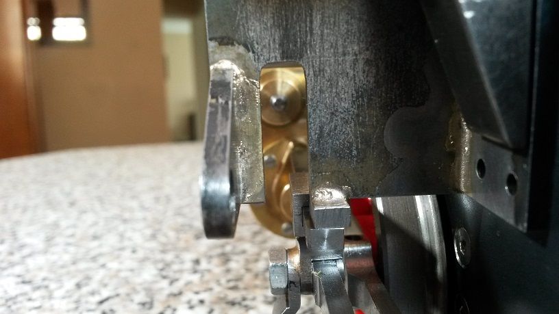

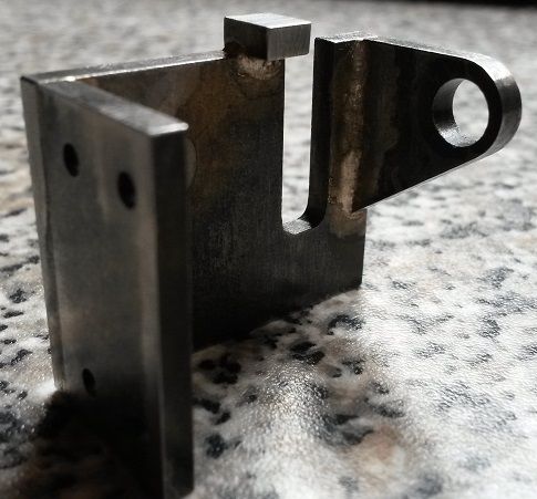

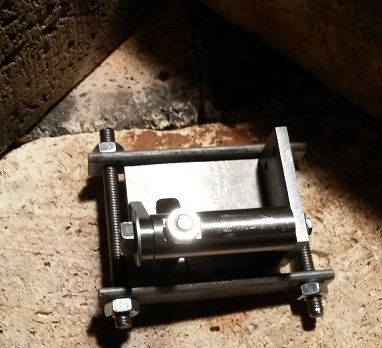

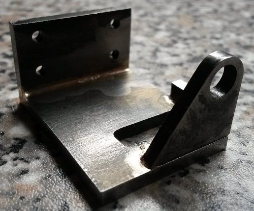

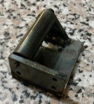

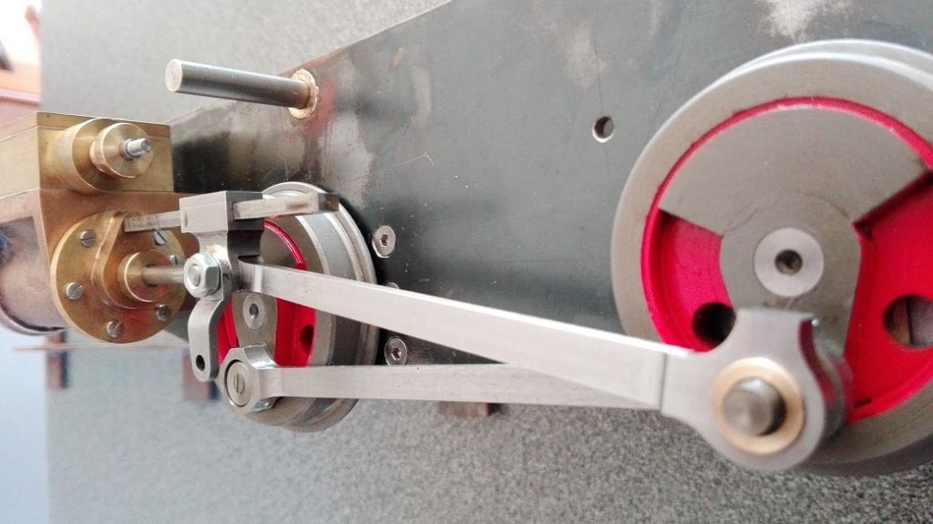

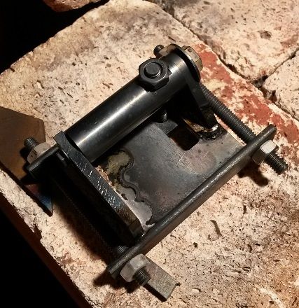

                            Yesterday I made some progress with one of the gear link frames and the outcome was successfully unsuccessful…
                            frown
                            Firstly it took a long time to get everything in the jig to fit correctly, square and lined up, especially the little block for the guide rod.
                            Eventually I managed to get it all together and correctly positioned for brazing. I also made the RHS parts as seen below.
                            Here is the final brazed assembly.
                            Now, here is where the unsuccessful part comes in…
                            (Neil, this was the part I never thought about…)
                            A portion of the jig was brazed to the top of the frame but with a small hammer blow, was rectified.
                            Once the nuts and parts of the jig were removed, I was left with this…
                            I may have missed the minor detail that the beam needs to be removed from the frame, once the brazing operation was completed…
                            Nevertheless, I removed the beam with a hacksaw and will need to re-think this jig.
                            I am also not convinced that the frame is correct. It seems to be slightly out of square and the distance from the frame bolting face to the cut-out at the edge of the small block is smaller than required and therefore the block does not line up properly with the guide bar. (I will do a set up of this and post the photos later).
                            Anyway, overall the jig did work and here are some pics of the final fabricated gear link frame.

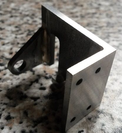

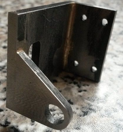

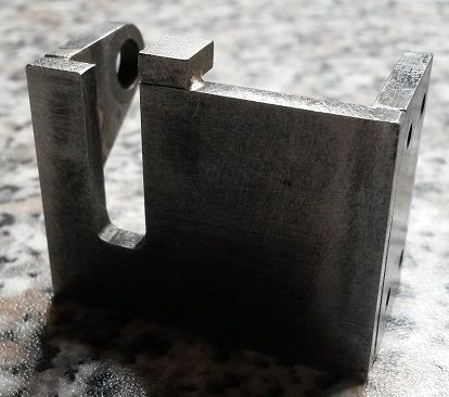

                            #265087
                            Ryan Norton
                              @ryannorton40317
                              Here are the pictures of the gear link frame clamped to the frame.

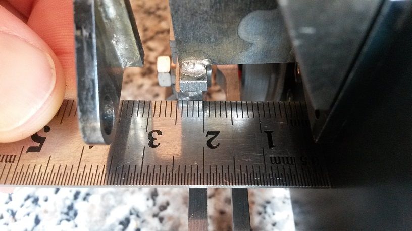

                              According to LBSC's words and music, the distance indicated as 25.35 mm above should be 24.6 mm and according to my slight redesign, 24.7 mm.
                              It is clear that the as-built dimension is 0.65 mm longer than drawn and hence the deviation of the guide bar mounting block from the guide bar.
                              The method of fabrication I have used does not allow for any surplus material to be removed from the mounting surfaces or any of the other faces. I think I am going to re-look at this component again and produce a more refined methodology for the fabrication and machining of the frame.
                              Any constructive wisdom would be useful…
                              wink
                              #265311
                              Ryan Norton
                                @ryannorton40317

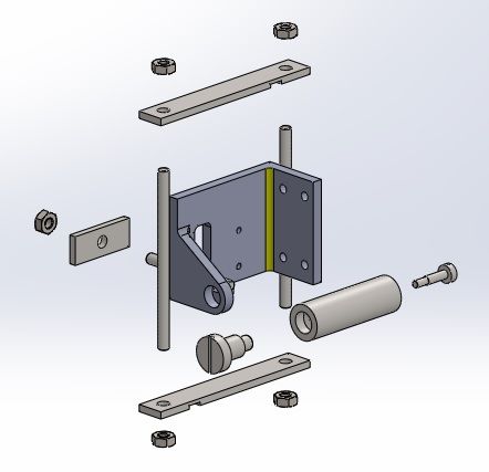

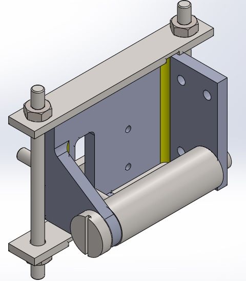

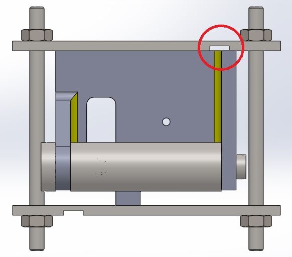

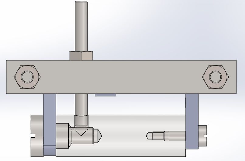

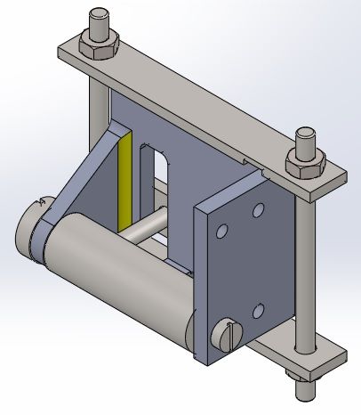

                                Right, I have been thinking of ideas and have come up with the following fix for my jig.
                                Firstly, a channel will be milled into the top clamping plate to prevent the jig from being brazed to the link frame (I have highlighted this with a red circle).
                                I have also changed the fastening method, now with two separate bespoke screws that will be inserted from the outside and locate in holes in the beam. The larger of the two screws is in the way of the cross fastening threaded rod so I have had to come up with a different strategy here. I have simply drilled and tapped a lateral hole as can be seen in the transparent top view.
                                Above is an exploded view of the new jig.
                                #265313
                                Ryan Norton
                                  @ryannorton40317
                                  I will also be using 4 mm plate for the sides and the small block. An allowance of 0.5 mm on each face will be made for machining. All the sizes have been adjusted accordingly.
                                  The brazed frames will then be machined in the mill to final sizes and hopefully turn out better than their predecessor…
                                  #265314
                                    Cripes Ryan, that's dedication!
                                    #265334
                                      You can also give any parts of your jig that are at risk of getting soldered a coat of solvent based Tippex correction fluid as that stops the solder sticking.
                                      I usually don't put the holes into fabricated parts until after they are soldered just incase anything should move slightly, in effect you are fabricating a casting that can then be machined.
                                      J
                                      #265400
                                      Ian S C
                                        @iansc
                                        If you let the jig get a bit rusty the silver solder will be less likely to take to it, or as Jason says Tippex painted on areas next to the joints will do thesame.
                                        Ian S C
                                        #265525
                                        julian atkins
                                          @julianatkins58923
                                          Hi Ryan,
                                          I have some 4mm BMS angle that is very accurate. If you can get same, it saves one silver soldering joint. Or else mill dead square some black angle iron.
                                          As for the other…
                                          I would bolt onto the motion plate the outer trunnion for the expansion link – after all the other inner one is also bolted on!
                                          Cheers,
                                          Julian

                                            Thanks for the advice JasonB and Ian S C!
                                            Julian I did not think of bolting on the outer trunnion….
                                            Thank you for confusing me even more… now my mind is torn..wink
                                            I think I am going to ponder a little longer on this one and probably try out my new jig idea first as am committed to it.
                                            However, should it not work, I think two bolted on trunnions would be a good alternative.

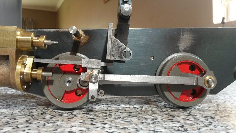

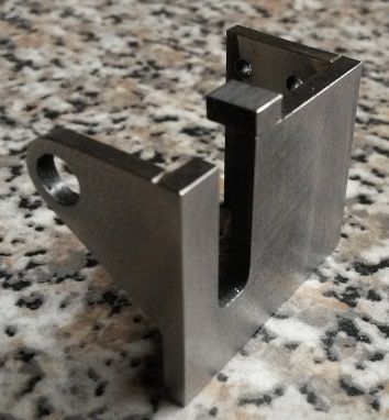

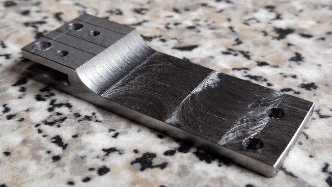

                                              I have used the brazed gear link frame as a test piece for machining. Here is the machined piece.
                                              There was some chattering when doing the outer trunnion. I will have to insert a distance piece for support when I do the final motion frames.

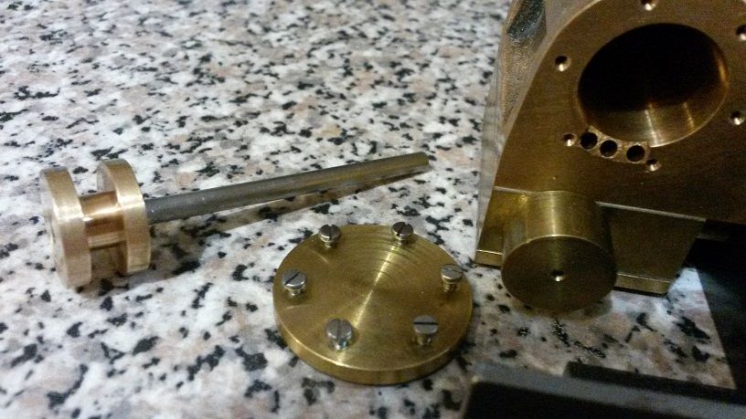

                                              Ryan Norton
                                                @ryannorton40317

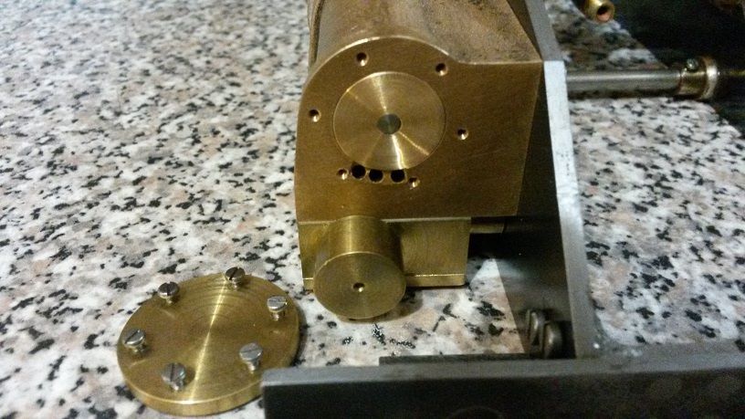

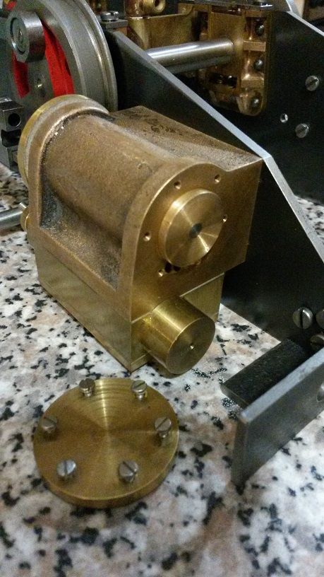

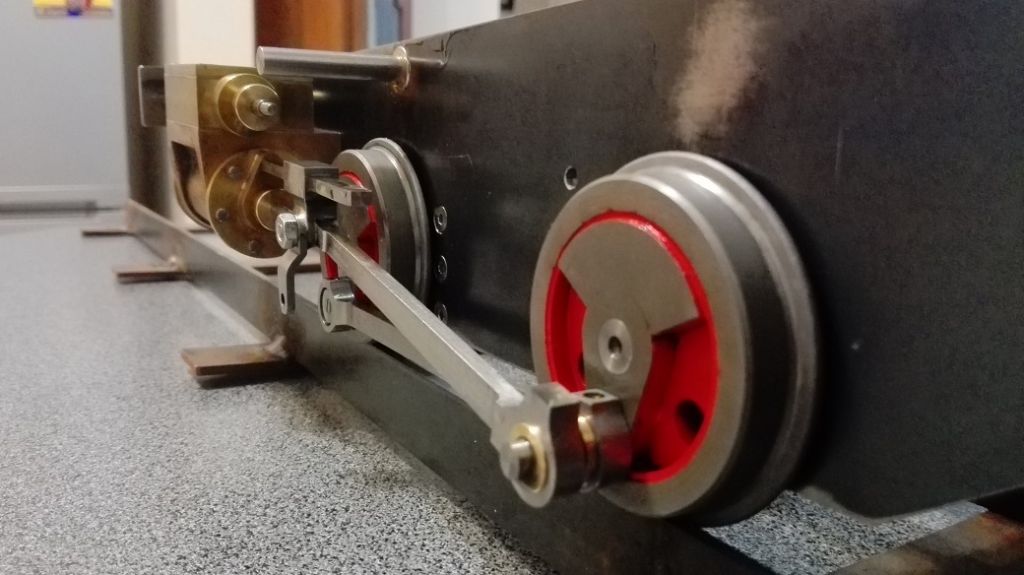

                                                I also took off the left hand side front cylinder cover to get at the piston for all to see.
                                                Now I just need the correct size packing and I can fit the pistons for keeps.

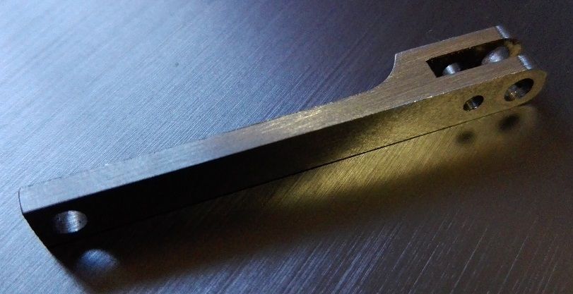

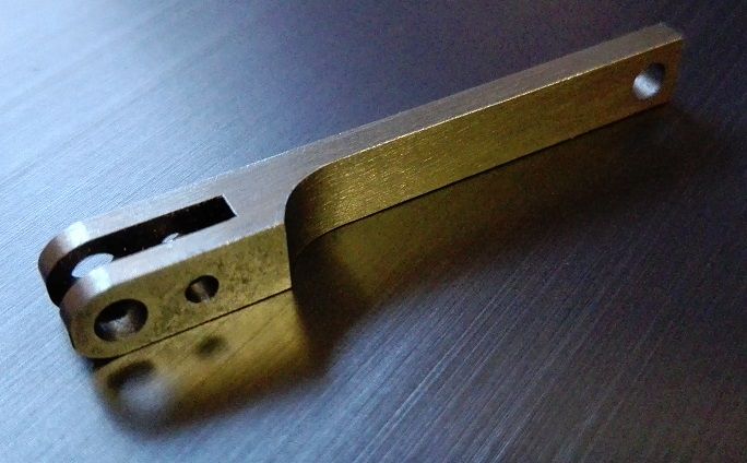

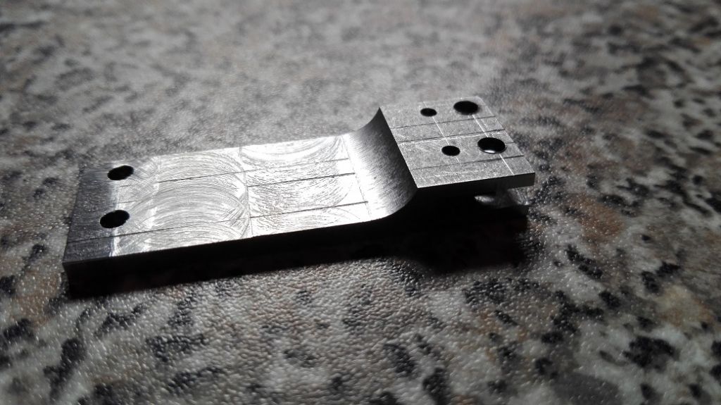

                                                #266319
                                                Ryan Norton
                                                  @ryannorton40317

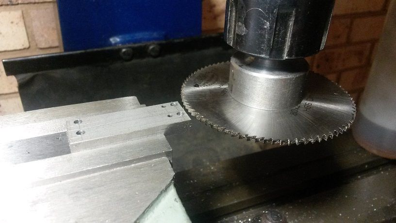

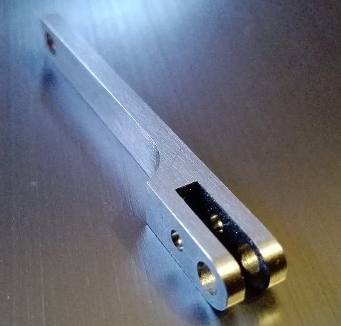

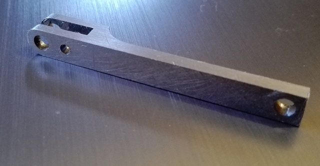

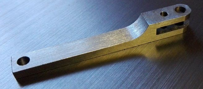

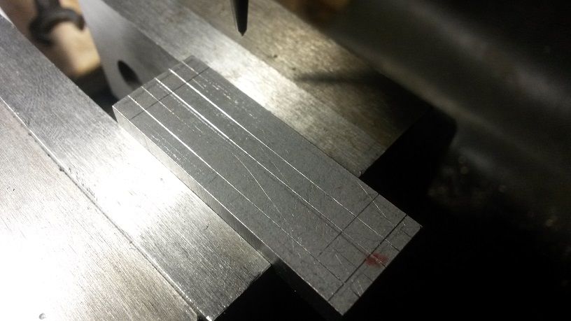

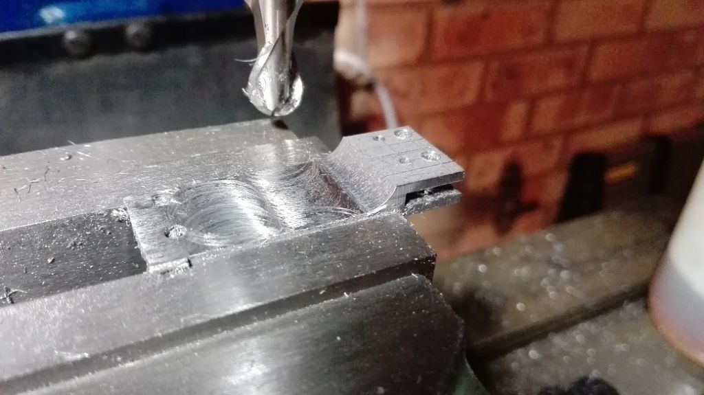

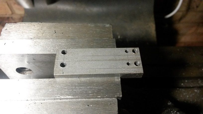

                                                  I have set aside the gear link frames for now, to work on something new to keep the interest flowing.

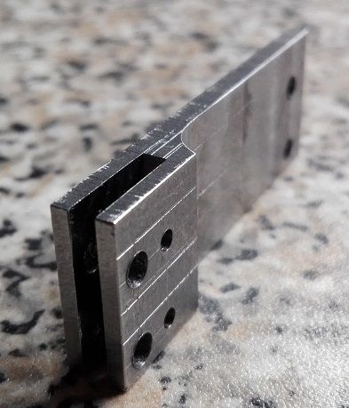

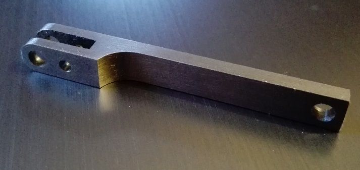

                                                  I have started on the combination levers.

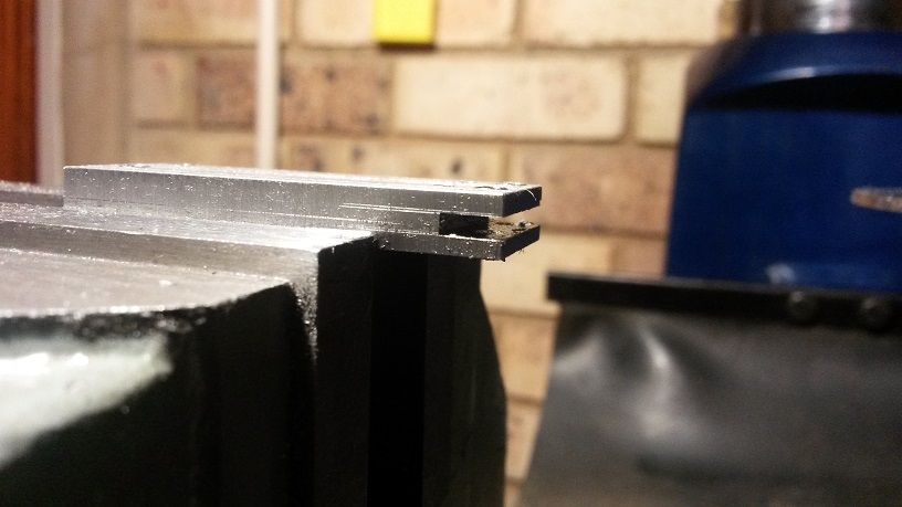

                                                  The levers are going to be machined from one piece, together and then split into separate levers and the final profiles then filed.
                                                  I first marked off the relevant sizes and hole positions with a scriber in the collet chuck.
                                                  The 2 and 3mm holes were then drilled and reamed.
                                                  A slit was then cut using a slitting saw.
                                                  The saw was used at the lowest speed on the mill (80 rpm), with a cutting fluid of paraffin and oil, judiciously applied. The embryo lever was fed onto the saw in the direction of the rotation (climb milling) carefully.
                                                  The slit was cut to 6 mm deep on the first cut and then to the final depth of 11 mm on the second cut.
                                                  Cutting the slot took about 2 hours but the result is perfect.
                                                  Here is a photo after the first cut
                                                  The bulk of the lower portion of the embryo lever was then milled away to the final thickness and the radius milled using a ball end mill.
                                                  Here are some pics after the milling procedures.
                                                  Now I need to cut the individual levers out, draw file the milling marks away and finally file the profile of the combination lever. I will be making filing buttons for the ends out of hardened silver steel.
                                                  (All of the milling procedures were performed with the material in the same position in the vice. So I had to place the material in the vice ensuring that there was clearance for all of the operations.)
                                                  Edited By Ryan Norton on 13/11/2016 10:39:52
                                                  Edited By Ryan Norton on 13/11/2016 10:42:32

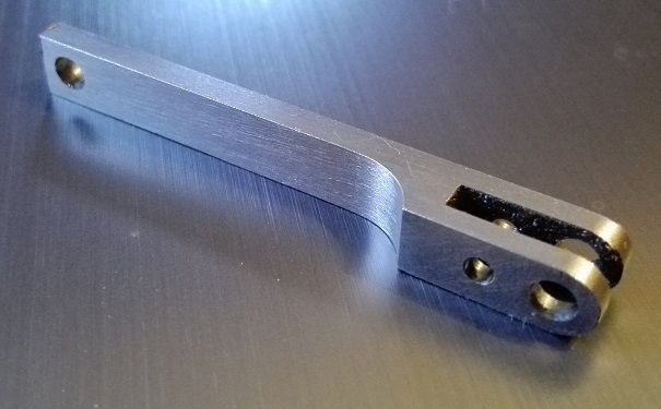

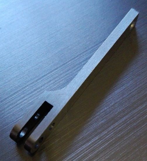

                                                  #266401
                                                  Ryan Norton
                                                    @ryannorton40317

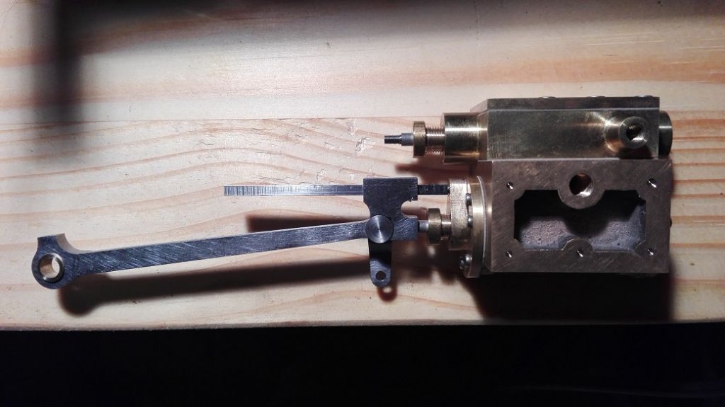

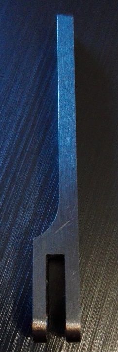

                                                    Here are some pics of the partly finished combination lever
                                                    I just need to file the final profile of the lever and then it is complete.
