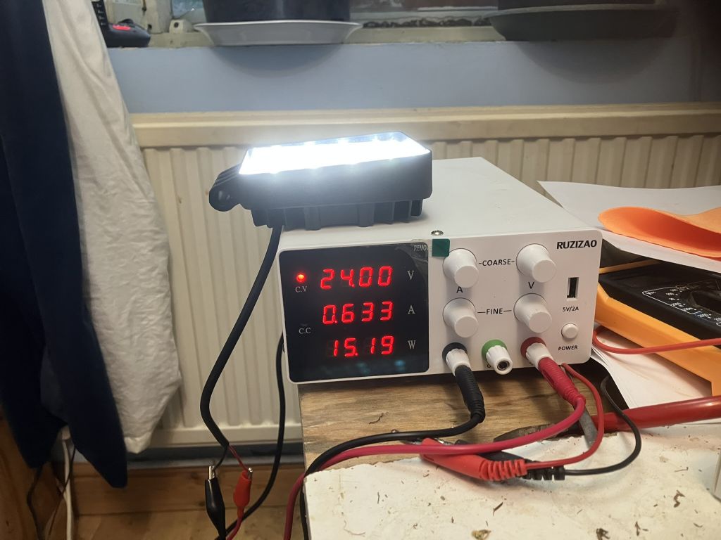

                      Thanks for further comments. In a moment of madness (as it turned out) I pressed 'buy now' on a pair of 12-30V spotlights – the sort of things people mount on their SUV's to dazzle oncoming drivers help with off-road activities – £16 the pair. Taking on board comments about damp environments (I sometimes use suds) the IP68 rating sounded good too. They are advertised as 48W 4800 lm so I was a bit worried they might be a bit too bright. However:
                      The regulation is actually pretty good in that power consumption is 15-15,3 W from 12 to 30V , but obviously not as advertised. So they'll go back and I'll order the Sealey.

                                  Well the "27W" Sealey unit has arrived and it consumes about 18W over the advertised 12-30V range. Probably bright enough for my needs though.
                                  I made a simple full wave rectifier with a 1000μF capacitor across the output and there is negligible ripple according to my manky old oscilloscope. 34V as expected, but that can be taken down – I remembered that I have some buck convertors left over from a previous project, might be more efficient than a resistor. It's getting a bit complicated for a lathe lamp I know, but I would like to use the lathe's power supply rather than a free-standing mains lamp if I can.
                                  I did wonder if the 34V output would be enough to run one of the nominally 40V Plessey modules which MichaelG tipped us onto a while back albeit with a reduced output (they are eye-blisteringly bright at 40V). Sadly not, they don't turn on until about 38V.

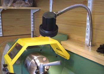

                                      How about a microphone gooseneck. Fairly standard and available in different lengths. Fittings are available for the threaded ends. From electrical suppliers (CPC, Farnell or Amazon).
                                      Home made job for lathe using a cheap pond lamp housing. Made years ago so possibly not available now. Construction details *** HERE ***
