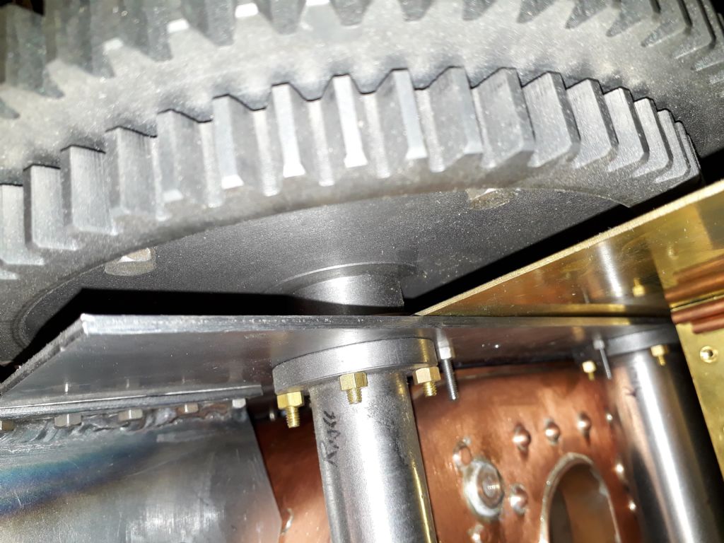

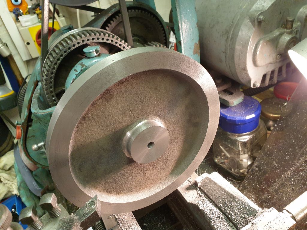

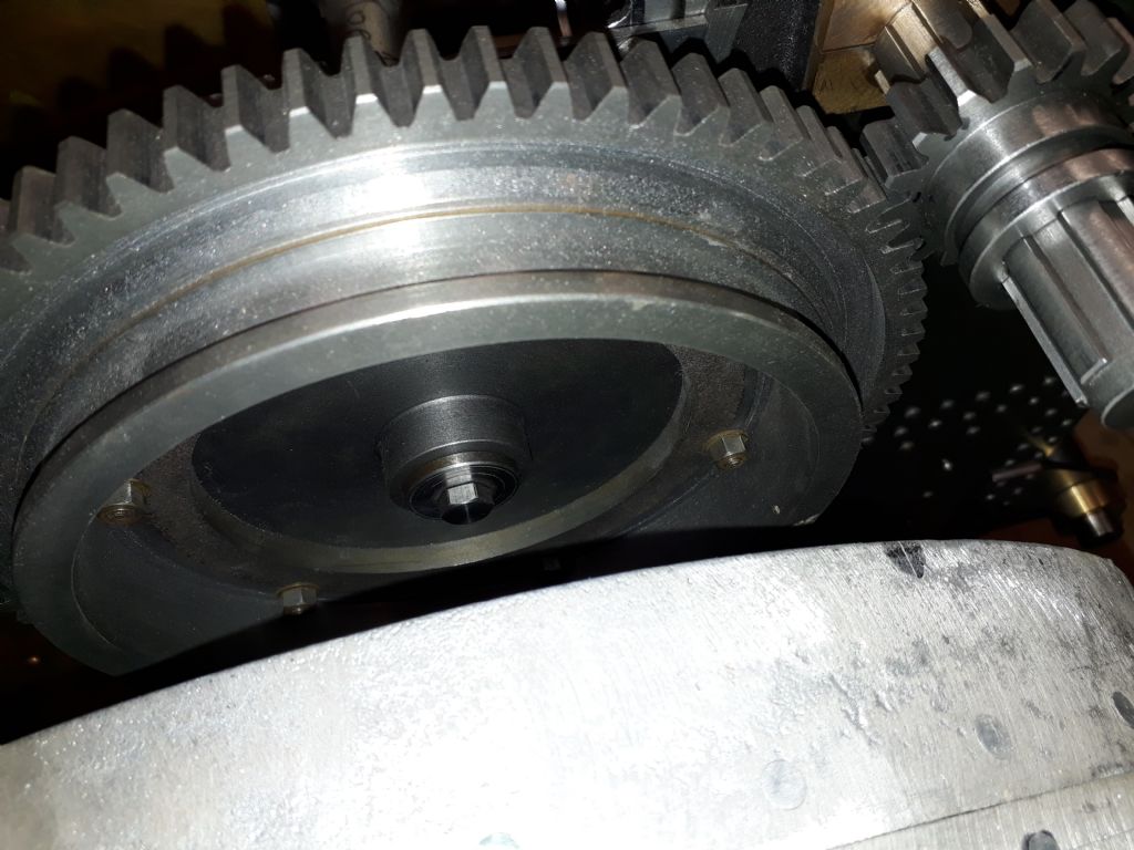

              Stephen, I'm not sure if this will help now as it's been best part of a month, but when I made the gears, I pretty much just followed the drawings. There's plenty of space for the large boss (you can just about make it out in the photos below).
              The only thing I remember not being quite right on the drawings was that the dimension for the shoulder on the small gear didn't match up with the bore of the large gear, so I just ensured that they matched so that when the larger gear was bolted to the smaller one, it would fit on the shoulder and ensure that the gears are concentric.

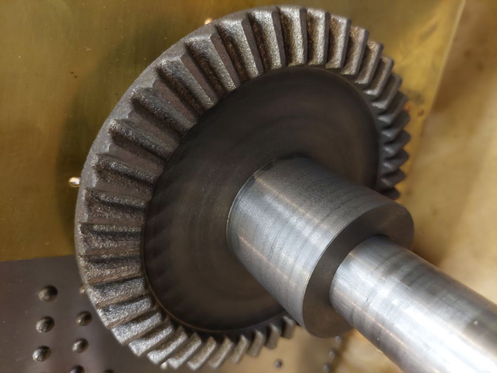

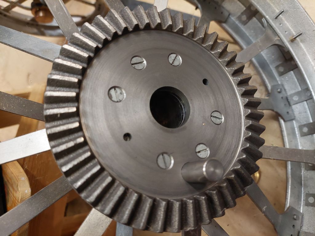

                        The bevel gears in the my traction engine from https://www.plastowtractionengines.co.uk/ are as-cast. I believe you can buy a fully machined set, but the cast gears work adequately well.
                        The main gear Pinion are machined cast iron blanks.

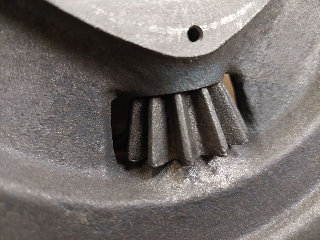

                          These are the 3 gears that are part of the differential (OK, there are 2 pinions). They all have as-cast teath, and then the bosses/holes are machined as appropriate.20221213_162109.jpg20221213_162038.jpg20221213_162134.jpg
