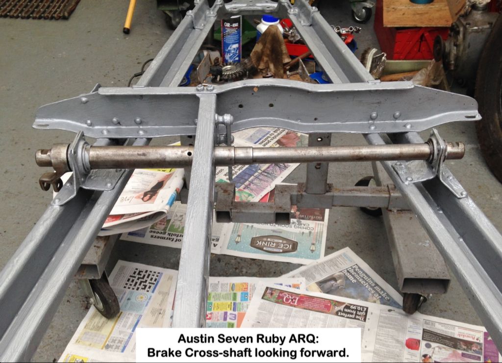

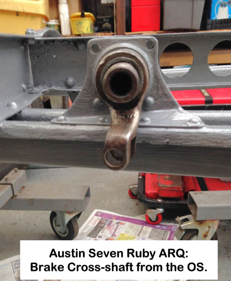

      Need ideas please.
      All three double cone bearings where solid with road gunk and rust, the shaft hanging down from the chassis under the car thus open to the elements.
      Also need to think of a way to protect said bearings by some sort of covering.
      1935 Austin Seven Ruby ARQ
      The chassis is upside down, just having given it a coat of Jotamastic 87 Aluminium DTM epoxy paint to be followed by a coat of bitumous black.
      The centre bearing is the same as the other two.
      The shaft is hollow, being 24in long, thin end 1"Ø, thick end 1.1/4"Ø with the bearings at 1.1/4" centre height to the chassis, the body of the car being 4ft 4in wide, so not easy to get at.
      Video of centre bearings
      More photos in the Austin Seven Album.

        How to provide lubrication to the brake Cross-shaft.
        #210766
        OuBallie
          @ouballie
          Progress on the car can be viewed.
          The centre bearing and the Centre Member where added late in the Seven's production run.
          The original 1" shaft was found to be bending, so the OS section from outer bearing to just past the inner one, was increased in diameter by the addition of two extra tubes over the original, thus the difference in bearing sizes.
          The bearings have zinc inserts pressed into them.
          Brakes are cable operated.

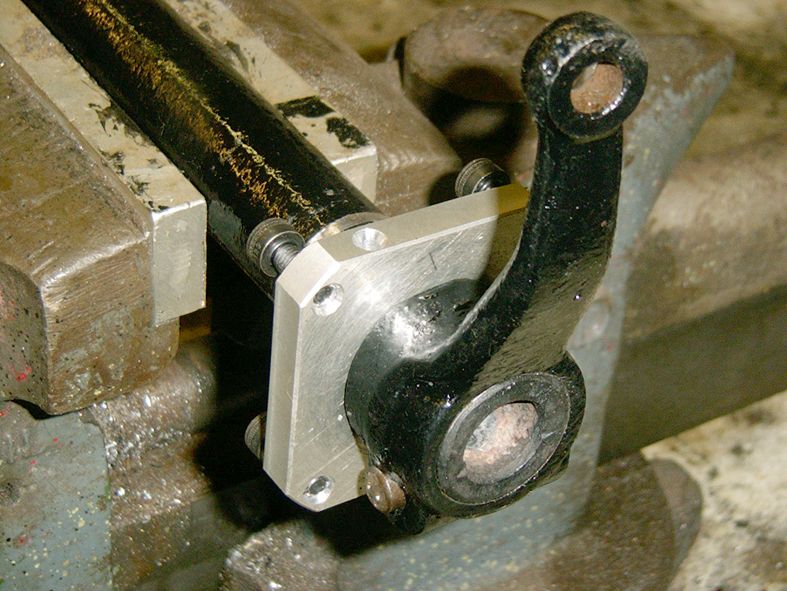

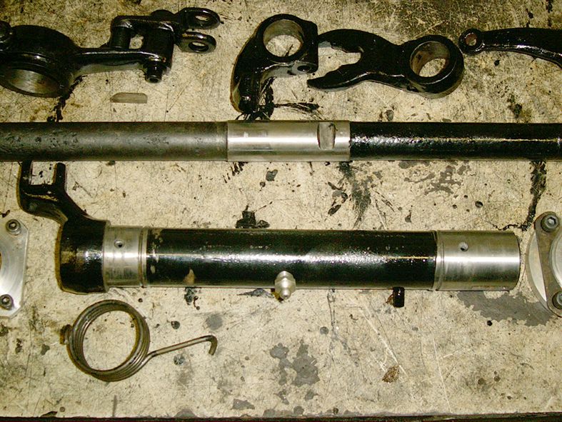

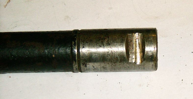

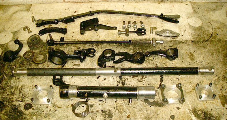

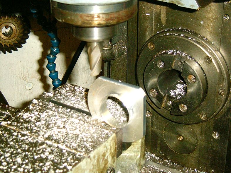

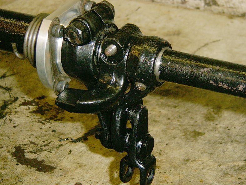

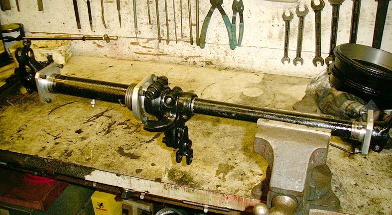

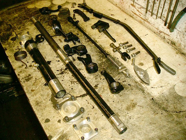

                          Been there, got the tee shirt so to speak.

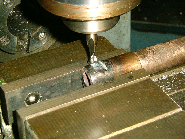

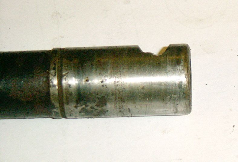

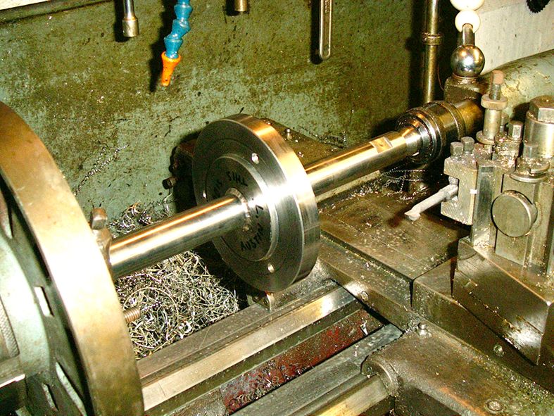

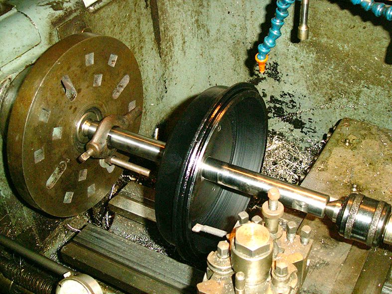

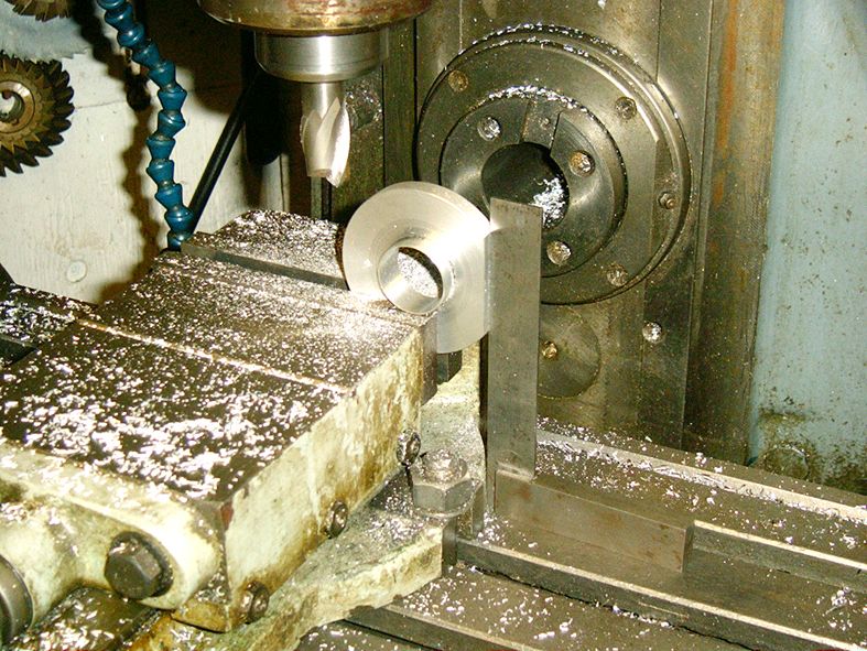

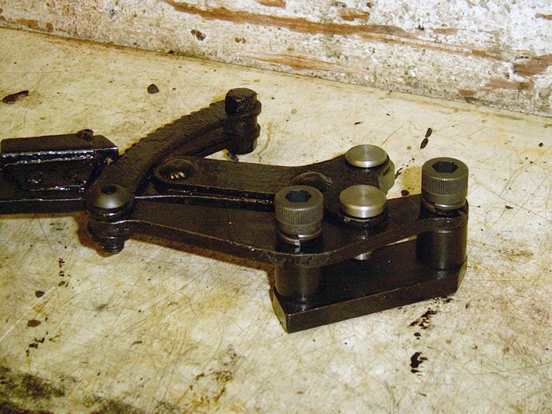

                          I could not bring myself to carry on using those bits of pressed tin as bearings, so I made some radical changes which give the shaft a much better chance of operating correctly, this has been in place for nearly 20 years now and has given no further trouble.
                          I will let the photo's do the talking and answer any questions if any crop up, sorry the photo's are a bit poor, but digital camera's were not as good back then.
                          p0001582.jpgp0001583.jpgp0001584.jpgp0001586.jpgp0001585.jpgp0001587.jpgp0001588.jpgp0001589.jpgp0001590.jpgp0001591.jpgp0001593.jpgp0001594.jpg
                          Note the addition of a grease nipple to fill the gap between the shafts so water stays out.
                          I also took great care to get the brake drums trued up as well.
                          Phil

                            The big diameter OS tube on my shaft will not come off as yours has.
                            It appears to be pinned to the long inner one.
                            Have read everything I can find on these shafts and there is conflicting info as some say the shafts are welded to form one solid ones, then some saying the outer tube is free to rotate slightly, so I am totally confused.
                            Nice mod to the shaft, but are you still using the double cone bearings?
                            I do like the way you have set-up the drums for skimming, so something to copy.

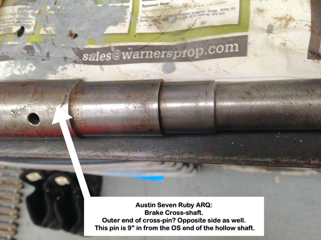

                            Photo of the tubes that make up my Ruby's Cross-shaft, there being a pin spanning the tube/s and possible outer ends visible on the outside, so mine appears to be locked solid.
                            As can be seen, the OS tube has been turned down to slide over the middle one, itself being turned down as well.
                            Confused as I said, so nothing new then.

                              If your outer tube is solid with the main shaft, you will not be getting any compensation effect to balance the front and rear brakes, I would investigate further to see if you can part them, or get some replacements.
                              Everything on mine needed re-bushing and new pivot pins etc to get the brakes as they should be.

                                          A few people have converted from cable to hydraulic brakes, but without exception have complained that they are too vicious and lock the wheels too often, some have been converted back to cable again.
                                          If the cable brakes are in tip top condition, and more importantly been set up correctly, then they are fine for most people who drive an Austin 7 on todays roads, if you are wanting to enter competitions then it might be a different story.
                                          The foot brake pedal operates the cross shaft which has a front to rear compensation toggle, if you find that the foot brake is not slowing you down enough, then simply pulling on the hand brake gives you exactly the the same four wheel braking but with around twice the leverage.

                                                  Have decided to fit plugs, with grease nipples, into the ends of the tube and drill holes where the bearings are, as per the way Robert did.
                                                  Once that's done I will drill right through both tubes, block the outer hole so that grease gets between the two as I pump grease in. With luck that is.
                                                  Bracing has been added to the bearing housings by owners of early models, to prevent them from flexing under load, but they where just bits of tube stuck onto the chassis, as in a photo posted on the Thread, and they most certainly need bracing.
                                                  Not sure if the bearing housings on mine will flex, they being totally different, but who knows how much pressure is applied when one stamps on the pedal.
                                                  Once all fitted up, will cover the shaft as best I can using suggestions posted here – thanks everyone.

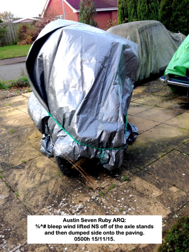

                                                    Photos say it all!
                                                    I have no intention of checking to see what has been dented!
                                                    Geoff – Can wait until the body comes back into the Carport.
                                                    #212368
                                                      Posted by OuBallie on 15/11/2015 07:15:19:
                                                      Geoff – %#^* wind!
                                                      Geoff,
                                                      I wasn't sure if you were complaining about the weather or your digestion:
                                                      But, now I've seen the photos … You have my sympathy !!
