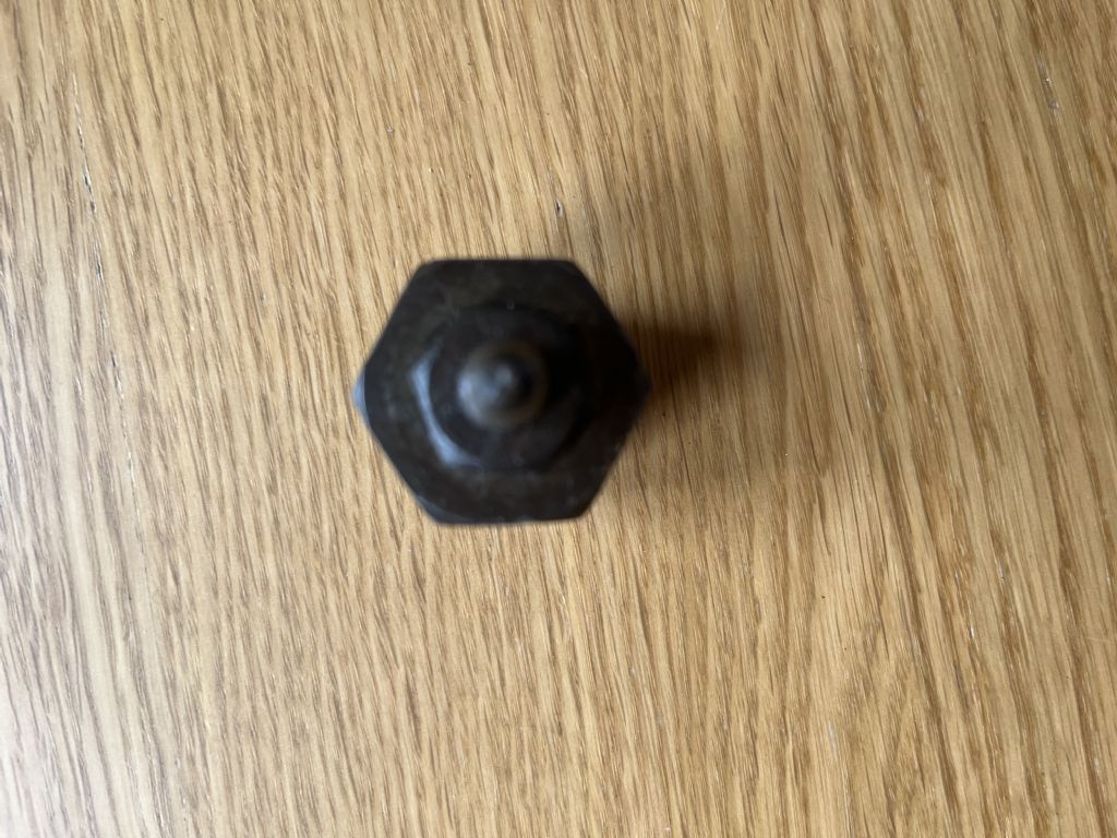

      I can see a long bolt sticking out of the headstock casting and the only other screw in your last picture looks to be a coarse threaded grubscrew partly unscrewed from the small sheave on the pulley.
      All three pulley sheaves and the (middle) gear in your picture should be mechanically joined to each other and be capable of rotating freely in the spindle (to drive the backgear).
      Is the bull wheel the only thing solidly keyed/joined/fixed to the headstock spindle?
      The smallest gear in your picture I assume drives the screwcutting gearing so somehow that must be part of or fixed/keyed to the spindle.
      What kind of bearings does the spindle run in?
      Can you show a picture of the end view of the headstock that shows that end of the spindle

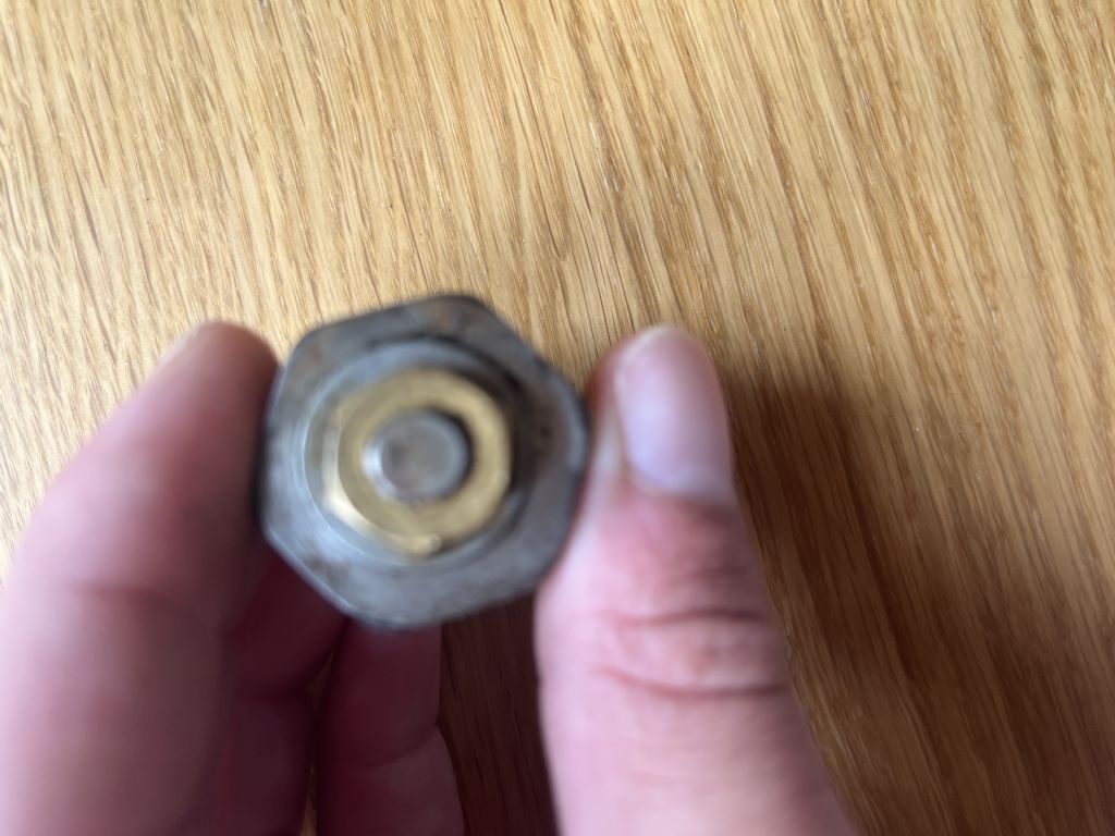

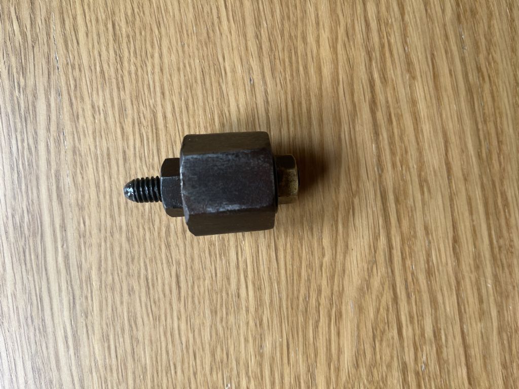

        I don’t know what this screw is for 8bf8ab0f-1780-4dc7-98de-6aed499b9ea7.jpeg

                Something odd here.
                If the two gears near the small end of the pulley cone are keyed or fixed to the spindle then when the backgear is engaged the whole thing will lock up.
                Ian P
                PS I have no idea either what the screw is for, yes its a screw but it is in, or part of something.

                  The small gear is keyed to the shaft, the larger gear is connected to the 3 pulleys which move freely on the spindle until they are engaged with the pin on the bull wheel. I made a mistake on my previous comment

                      That was screwed in the hole in the bull gear

                              On re-reading I think you need to measure accurately the depth of the grub screw hole in the bull wheel bush. The purpose is to determine if the 'bottom' of the hole is exactly the side of the spindle, or deeper ie into a keyway, or less deep indicating there is a key in place.
                              I suspect the big screw thing is a bodge that was going down into the keyway or into a dimple if there is no keyway and has created a gouge and burr that is now jamming the bull wheel onto the spindle.
