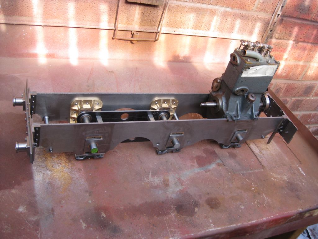

        I have started to build this loco which was designed 1941/3 and described in the model engineer at the time . I inherited the part built (75%) petrol engine which I have since almost completed , so I have now started on the loco itself . With the help of friends both old and new I have managed to source most of the drawings . I have started a photo album and will try to remember to update it now and then . I have attached here a photo of the current progress .img_0037.jpg

                          Jeff I have 2 part builds (not by my self) and other bits and some information you may find useful
                          LMS Journal No2 pub wild swan has a 20 page article on the prototype including drawings and photos
                          Model engineers laser do a body kit (Ivan Laws design)
                          Ian Bradly did some mods ME 2 nov 1944 larger flywheel 24 sept 1942 pressure relief for the oil pump and eccentric idler gear in valve train
                          I had A friend NC some coupling rods for me in steel, I do not like the look of the original ones in aluminium (wrong colour)
                          #349609
                          Jeff Chilver
                            @jeffchilver13861
                            The original was an experimental diesel shunter . It started life as an 0-6-0 steam loco circa 1890 . The L.M.S removed the boiler , cylinders and other bits , they then fitted a diesel engine and a Heath Robinson drive mechanism . It wasn't a great success but they carried on with follow ups . The drive system in the model is a friction system which I intend to build as drawn . Many people had trouble with it . Ian Bradley made a three speed and reverse gearbox for his and others did similar things . Thank you Paul I am aware of the laser bits but I'm old fashioned and like to produce my own bits and pieces . incidentally I have seen Ivan's example a long time ago .I am currently machining cast iron blanks for the wheels which I'm chewing out of the solid ( more swarf than job ) That's it for now I will post the odd pic now and then .

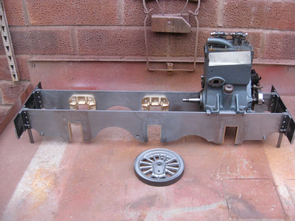

                              Jeff Chilver
                                @jeffchilver13861
                                Thanks Paul for posting the pictures , very helpful , can you leave them there for about 10 years !!!

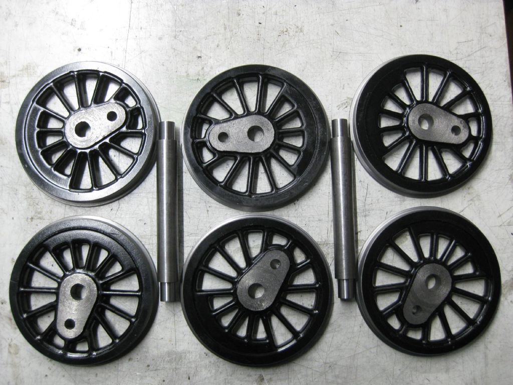

                                                    Hi . I promised to post an occasional update on this project as time went by , been busy with jobs of all descriptions , had a red letter day last week got the engine to run for the first time . Runs like a lame dog but I will have to build a test rig to load it before I try to fix it . I have completed the wheels which are chewed out of a 4" cast iron bar I had laid about , I'll try and attach a picture of them . Progress is not quick but more will follow in time .img_0072.jpg
