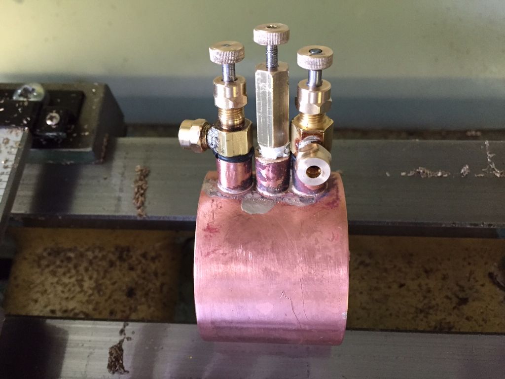

      They have all soft soldered rather well. Joints are more than strong enough.
      I made the side arms. Turned a 1mm nipple to 4.5mm. Drilled the body 4.5 and soldered them before drilling through to the middle with the .0625 hole.
      Gas Valves are complete.
      However I can't get all 3 into the tank (something you warned me about)
      I will have to re think the discharge valve…… ​

        The Gas Tank is complete.
        The Valves all seal and it holds gas. (Only put a bit in)
        Need to get some 1/4" sealing washers.
        The Valve needles are sealed at the top with Teflon Pipe.

            Hi Martin
            CSME are going to Pressure test it for me tomorrow. What do you suggest ? 100 PSI ?
            The fit is very tight for the valves. I made the Discharge valve from 7mm hex. The other 2 are made to the drawings.
            The longer Bush had to be shortened.
            How does it fit with the Burner ?
            I am equally unable to answer this one.
            You have more information than I do so I guess I will have an issue here.
            I may have to cut the Top Off and make a new flat Bush Plate. It'll be fun soldering that on the inside.
            I may have to start again. We shall see as things progress.

              For butane I would test at least 300psi and at least 400psi for butane/propane mix.
              Roundhouse test their 16mm loco's gas tanks at 490psi for a working pressure of 245psi

                  100 psi would be woefully low, below the operating pressure.
                  The Model Power Boat Association test to 1.9 times the vapour pressure so it varies according to the gas mix used.
                  mpba.org.uk/PDF/Corrected%20Steam%20Rules%20Leaflet.pdf
                  These appear to be based on the same 50-centigrade vapour pressure as the aerosols you get in the supermarket (although they are only tested to 1.5 times, presumably as they are single use only so no risk of mis-filling).

                    I'll take it to 377.5 PSI​ so I can run Blowlamp Gas. It comes in nice large cans.
                    It was only soldered last week so I may well leave it another week as the stay tube will still be soft.

                        Took the tank down to be pressure tested today.
                        The advice was: Tube is not suitable for the Stay.
                        Soft Solder is not suitable for the Valve Arms.
                        The tester suggested that if we were to test the tank that the tube would more than likely fail.
                        Overall they were happy with the Soldering and construction. "Could have been tidier in places but it's soldered well"
                        3/16 Copper rod is on order. I have no idea how I will get the old tube out…..

                          Just drill it out in stages, but thread something through it from the other end so it doesn't just fall and you can line it up with the hole.

                            Didn't work but could have. The tube ends expanded and I ended up losing the tube inside.
