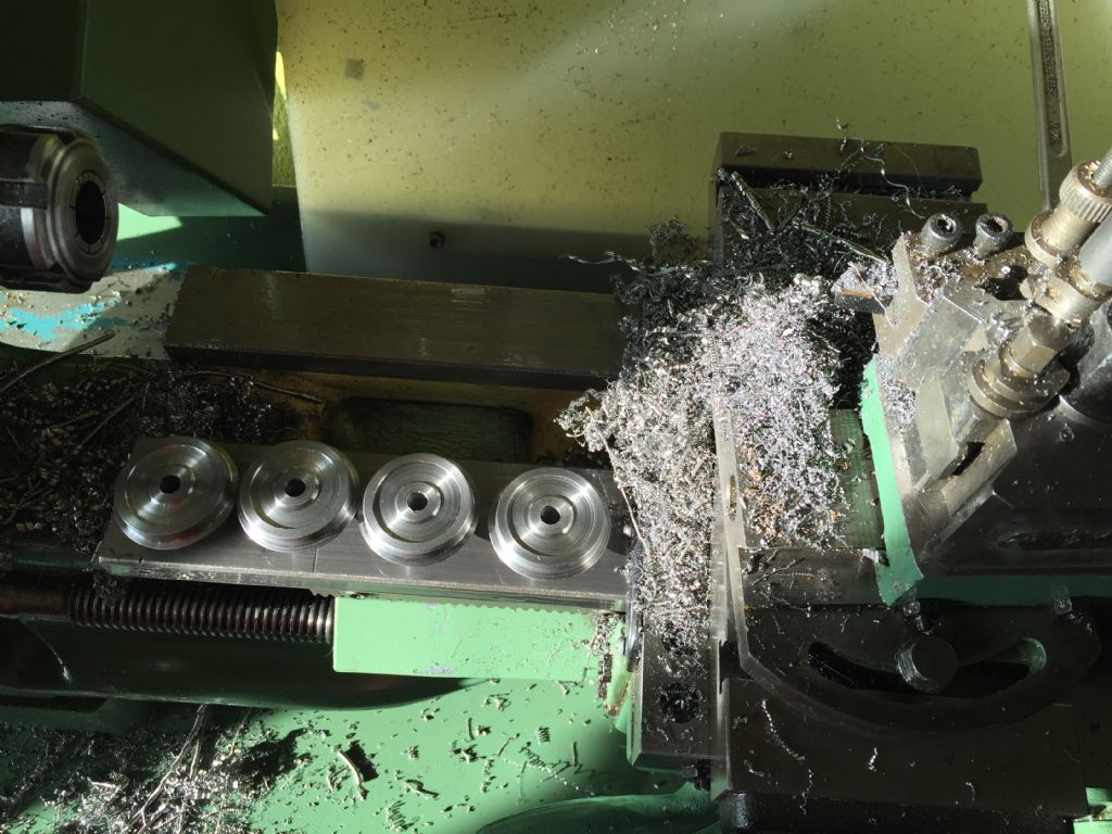

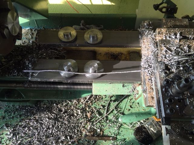

            #193772
            Alex Collins
              @alexcollins55045
              I'm wondering where the text went that was with the photo….
              4 wheels started.
              Boss is 16mm dia X 11mm long. may well reduce this later. It's 16mm cos I have a 16mm Collet.
              I turned the boss taking ~ 2mm cuts down to 17mm dia then cleaned it all up. The myford was quite happy with this.
              Parted them off at 7mm with a 2mm wide tool. It really didn't like that much.
              The tool dug in several times during each cut. The clutch I fitted has proven most valuable.
              Tried everything including regrinding the tool.
              I'll put the boss into the Collet chuck to drill the hole and turn the tread. That should keep it all concentric.
              What sort of angles do I need on the flange and tread ?

                  #193891
                  Alex Collins
                    @alexcollins55045
                    Hi Martin.
                    I cut off 100 mm of bar. That gave me enough for 4 wheels + the option of a 5th.
                    For the first 2 I used a steady + the centre. The 2nd pair I ditched the centre.
                    Cleaned the lathe tonight. The parting issues were probably caused by the lash in the cross slide getting sucked in.
                    I'll add in a bit of friction on the slide locks next time….

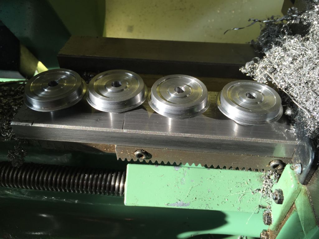

                      #194357
                      Alex Collins
                        @alexcollins55045
                        105.jpgWheels complete. Just need to drill and tap for the grub screws.
