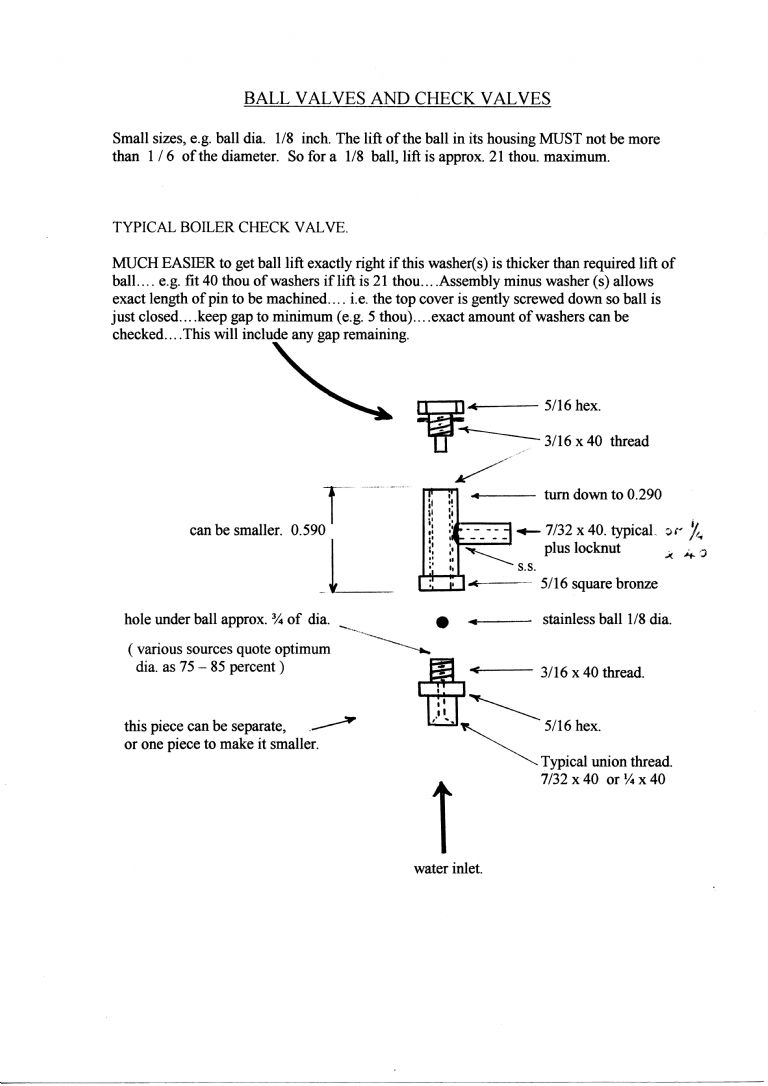

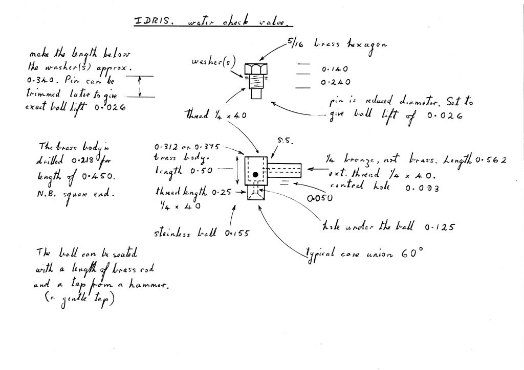

        idris check valve.jpgAlex ( and Neil ) … SWMBO has assisted by prising the sledgehammer out of my hand and can understand what is required … hopefully there are now 2 sketches included that you can see … one is a typical drawing of a check valve and one is the actual valve fitted to IDRIS … I made this one and did not measure anything … I just got stuck on automatic mode and built it … shows what an old dinosaur I am … anyway back to the 21st century, these should be of some use to you … let me know if anything else is needed.
        #189997
        Alex Collins
          @alexcollins55045
          Hi Martin.
          Just what I needed.
          I have also now worked out what the "Check Valve" does. It's to inject water into the boiler. I was a tad Puzzled.
          The Ball – stainless steel That I don't have. I do however have Glass Balls that are 3mm dia used in Bearings.

                  Alex … reference GLASS BALLS … I am never derogatory to anyones ideas … anything better than my random brain firing I will use … if it is a good idea then spread the knowledge … so what can I say about using GLASS balls in a check valve or a water pump … erm, erm … did you know our recycling bin for glass is collected on a Thursday ??
                  KENNIONS or BLACKGATES or REEVES or POLLY sell stainless balls … as an example, KENNIONS price is only £ 1. 75 for a packet of 5.
                  It is also possible to use nitrile rubber balls, but they are a bit more expensive.
                  IDRIS ARTICLE, part 3 in the M.E. magazine … look at page 745 at the top left of fig. 10 … there are two dimensions shown of 0. 312 and 0. 165 … somehow these have been swapped over … 0. 312 is the larger distance of the two.

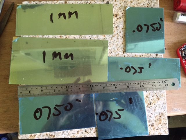

                      This is what I got in a £5.00 1 kg pack of Brass. They sent 2 X 1kg packs. Both are similar. Got a bit of 1.6 mm 1/16" in the 2nd pack, otherwise very similar content.
                      The slab ( bit of Granite worktop I use for marking out) is about 13" X 13"
                      Only 1 bit has a mark through the film.

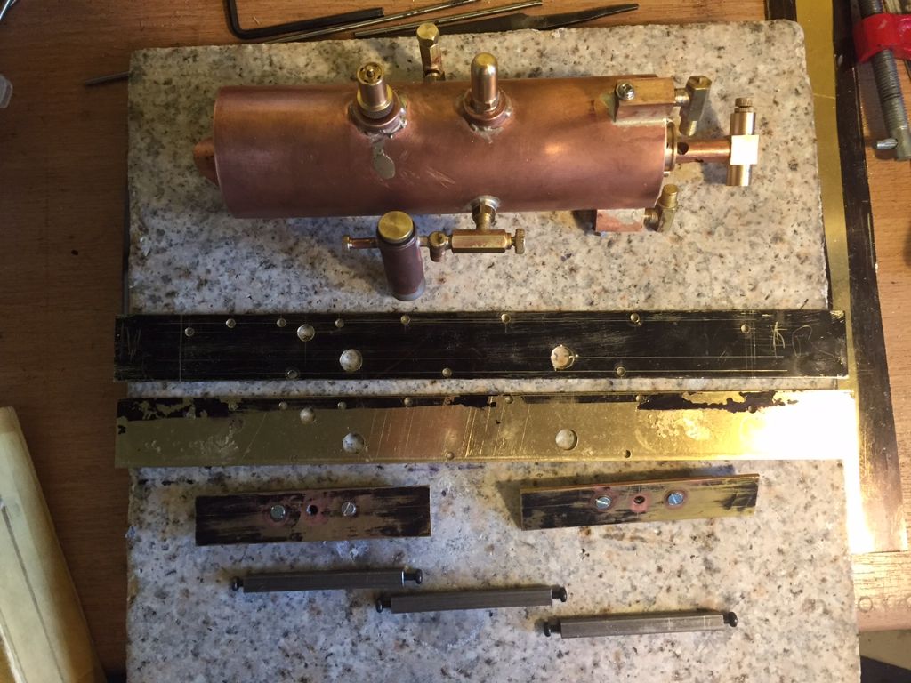

                          Had a bit of time over the weekend and a couple of hours the past few evenings.
                          Boiler is complete apart from the Glass tube for the water gauge and pressure Gauge elbow.
                          Drilled the side frames today.
                          It's all going rather well

                              Alex … looking at your photo above … you seem to have fitted the lubricator on the left of the boiler, not the right hand side … you seem to have used the rear boiler bush to collect the steam from the boiler … if it can all be squeezed in this would give you a shorter run of steam pipe to the cylinder … probably better than mine … if it does all fit, are you going to take the steam pipe into the rear of the cylinder block instead of the inside edge ??
                              If it does not fit, were you going to swap the cylinder onto the right hand side of the frames ?? if this is what you were planning make sure the 2 mounting plates are swapped … the gear train with various bushes would need to be reversed. The check valve would need to be crossed over as well to make it all line up.
                              #190669
                                Well spotted Martin, you got me looking again and the angled cut on the fire tube also looks to be up the wrong waysad
                                Could probably get away with just cutting that vertical.

                                  This is one of those "Oh Bother" moments….. – I'm trying Desperately to work out what I have done here.
                                  It looks like the End Caps and Fire tube has gone in the wrong way around.
                                  There were 2 of us who checked the Drawing when I assembled and soldered the Boiler.
                                  I have carried on and assembled the rest of the boiler without noticing the error. I must have looked at that Drawing 20 Times since I put the boiler together.
                                  The Angle has the point at the Top of the Fire Tube. I spent about 10 Mins aligning it !
                                  Just checked the drawing again and yes, it's upside down as well as Back to front.
                                  If re-making the Boiler is what is needed then I do still have material to do so.
                                  I like to think of my engineering as Unconventional and Unique. This project ( as you can see) is certainly challenging me and my skills.
                                  I'll see how things fit as we progress and I'm sure I can make it all work.
