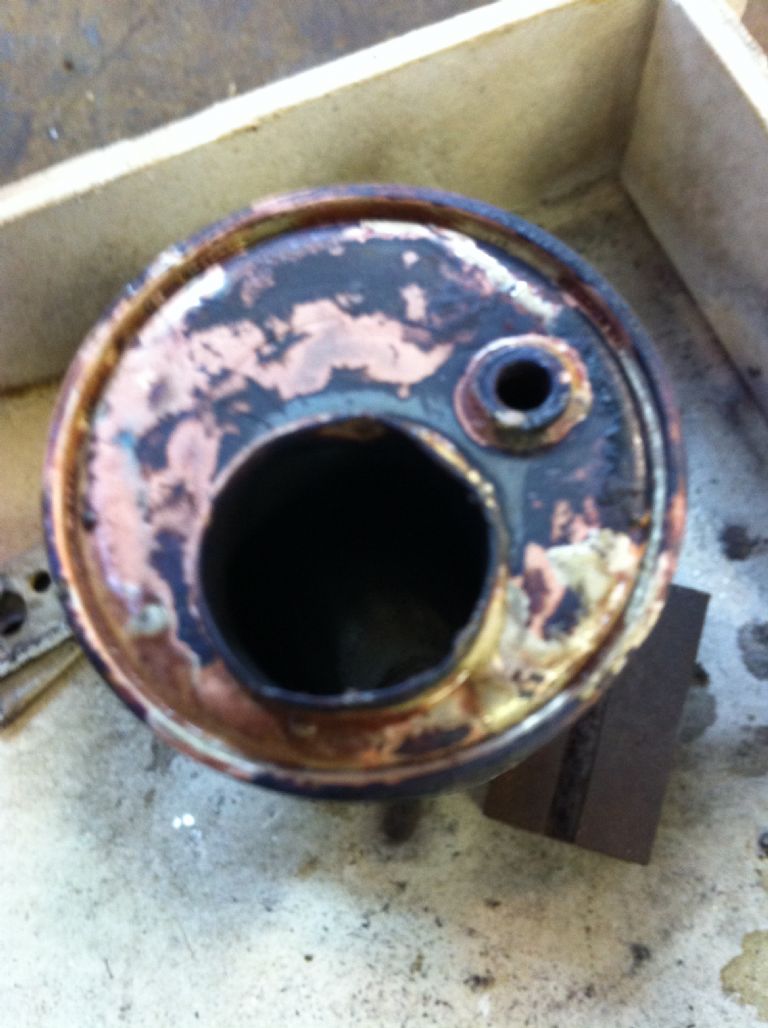

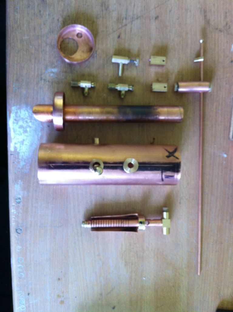

      Today I hope is soldering day for the boiler where this lot could become one…..
      (Sorry for the rather poor image)
      The Oiler will be soldered as one bit with easyflo 2 rather than the 2 stage setup Martin suggested.
      The steam Union is also slightly modified from Martin's design.
      I still need to drill the temporary holes in the boiler tube for the Water Gauge bushes.
      I'm wondering if I want to put a radius on the inside of the bushes ?
      Also wondering how I can accomplish this…….
      I have made a Masterboard Hearth.
      A Friends Large Propane torch will provide the energy and keep it all warm.
      I now have a MAP Gas torch to run the solder.

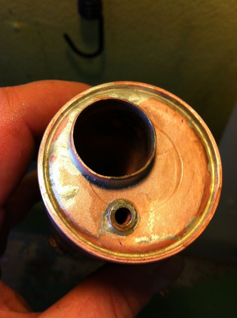

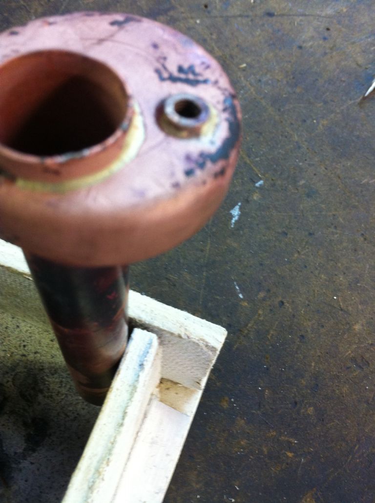

          It's been a long and busy afternoon.
          Soldered the end cap and Oiler with the MAP gas torch.
          A Sand Blaster made clean up super easy.
          A brush with the wire wool and we setup to do the 4 Boiler Bushes.
          A MAP Gas torch, as I suspected may be hot enough but does not have the guts on it's own to solder the boiler.
          Propane torch was required to provide the coverage for both Silver flow 24 and Easyflo 2 operations.
          1 Bush is a bit untidy on the outside but has a nice filet on the inside.
          The rest of the joints are really nice.
          The final assembly after cleanup went well. Again the propane torch was called for.
          I'm rather pleased. Its all gone very well.
          You will note the lack of Water Gauge bushes. We ran out of time so will add them separately.
          #188612
          Alex Collins
            @alexcollins55045
            I have just had one of those "Oh Bother" Moments……
            On the 1st page I asked about Tapping the Bushes.
            They are all Part tapped so they are square and the Silver Soldering doesn't damage the thread crests.
            So how do I tap the Steam dome bush ? ………..
            #188615
              Probably should have soldered in the top bushes and then finished tapping them before soldering on the side bush with its pipe.
              Either have to unsolder the side bush or have a go at making a 3/8" tap from silversteel with a hole drilled up the middle to clear the small pipe.
              Also take it easy with the sand blaster, each use will take away a bit of the coppers thickness.
              #188624
              Alex Collins
                @alexcollins55045
                Boiler is out of the pickle.
                A rub with the scotch brite and fibre glass pencil and I'm very pleased.
                The end caps and fire tube have an unbroken filet of solder all the way around.
                1 Bush is not tidy on the outside. May pull that one out. I think I may have killed the flux…..
                The other bushes are good. May add some easyflo2 to them when I warm it up again to make them tidier.
                ****** The Steam bush is going to have to come out *****
                If this blog helps someone else not to make the same (Rather silly I admit) mistake it will be worth it !
                Unsoldering seems like rather hard work It's in with easyflo24 and will probably wreck the end cap joints.
                I was looking more towards a drill. The inside is smaller than the Bush So I can brake it off inside the boiler then file the outside of the Bush flush. The fishing will be fun……
                If the hole is still central I can drill out the remaining bush. If not I can mill it out.
                Agree with the Sand Blaster. It's rather aggressive and was used with due care.
                It was all going so well, or so I thought……

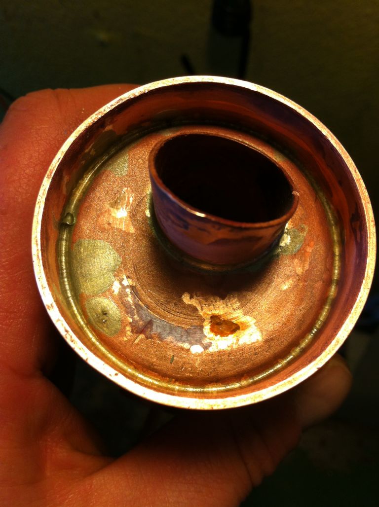

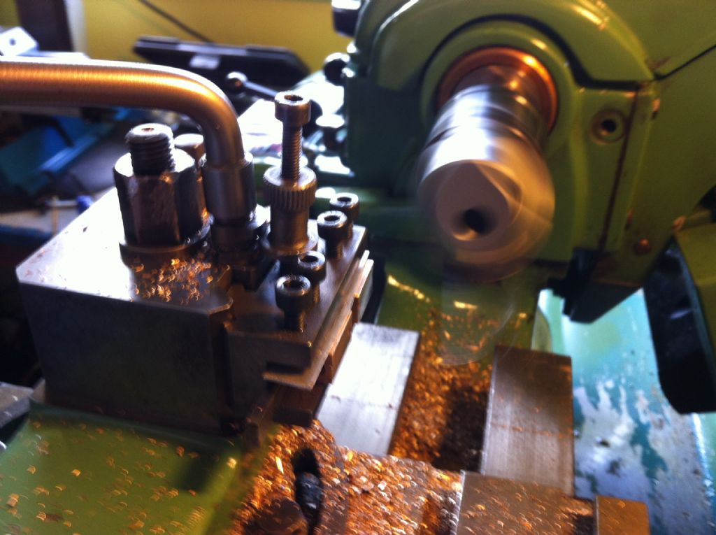

                    Alex Collins
                      @alexcollins55045
                      I have radiused the inside of the water gauge bushes on the lathe.
                      Boring head set at 25 mm radius. Well close enough to…. Very fine feed.
                      1st pass the bushes were not quite square in the tool holder. Fixed for the 2nd pass.
                      I have 1/2 mm flat on each side. of the bushes.
                      Thinking – may well trap some fine (0.2mm) copper wire under the bushes to provide some soldering clearance. A trick I have used before.
                      As for the boiler ends. I call them close to perfic. Your comments and thoughts would be welcome.

                      Steven Greenhough
                        @stevengreenhough56335
                        Nice work Alex.
                        #188786
                          Looking good, a couple of punch marks throw up enough of a burr to give a nice gap for the solder.

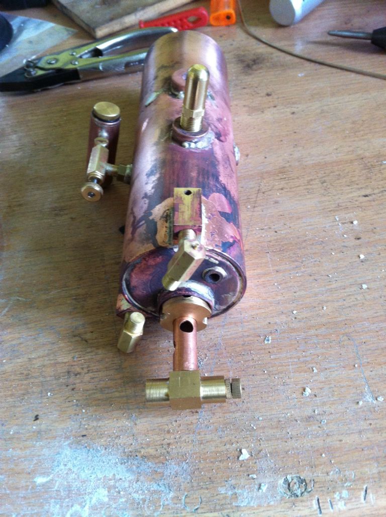

                            #189239

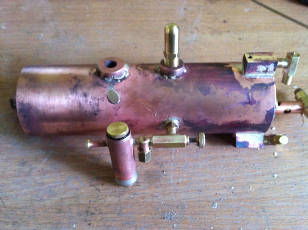

                            Alex Collins
                              @alexcollins55045
                              Soldered the 2 new side bushes in today. Much happier with the joints this time.
                              Water gauge bushes tomorrow.
                              I note there is no angle on the drawing for the bottom bush. I guess it at least needs to clear the fire tube.
                              I just hope it clears the frames wherever I put it.
                              #189365
                              Alex Collins
                                @alexcollins55045
                                boiler 004.jpgCompleted the Boiler Fittings today.
                                It's all reasonably good, not perfect…..
                                Need to clean it properly still. Another day !
                                #189366
                                  Comming along well, just watch those two top bushes have sealed all round looks like you could have done with a little more heat on them as the solder has not quite flowed out.
                                  J
                                  #189380
                                  Alex Collins
                                    @alexcollins55045
                                    Hi Jason.
                                    Yer – looks a tad bad but they are soldered and soldered well with Silver Flow24.
                                    I tried to fill the gap with EasyFlo2, that made a load of mess !
                                    Fair bit of cleaning to do now….
