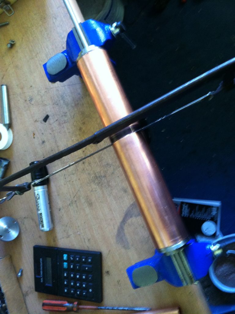

                        Took the plunge and cut the Boiler tube tonight.
                        Drawing says 6.400"
                        My cut is at 6.470" less than 1/2mm to big. That'll do.
                        I mounted the tube on 2 cones on a bit of 8mm rod between 2 vices.
                        That way I could spin the tube to scribe square lines. I then did up the grub screws to stop thing rotating as I made the cut.
                        Overkill ?
                        Well I got a nice square cut very close to the correct length. I say it worked just fine.

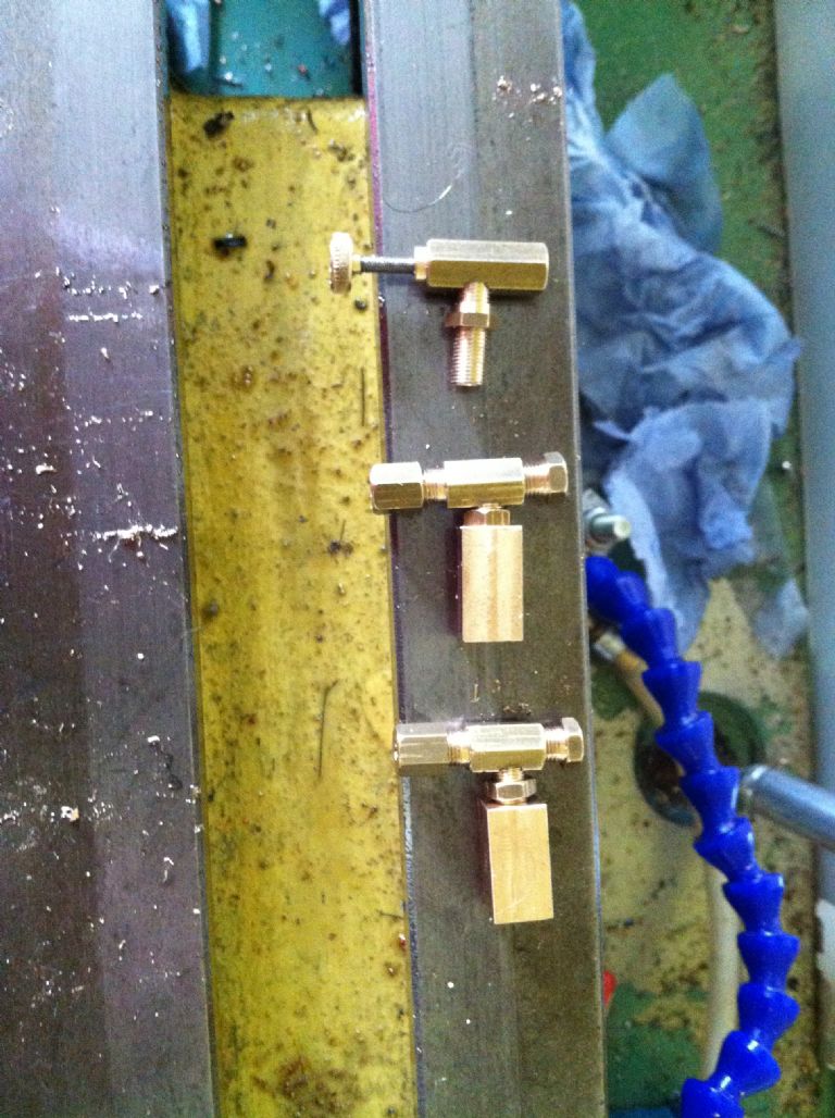

                                                Been getting on with the Boiler fittings.
                                                Tomorrow I clean up and hope to silver solder this lot together.
                                                One of the most valuable things I bought a while back is a set of Slow Spiral drills. They make drilling Brass and Bronze really easy. No Grabbing, even when you are breaking through on other holes.

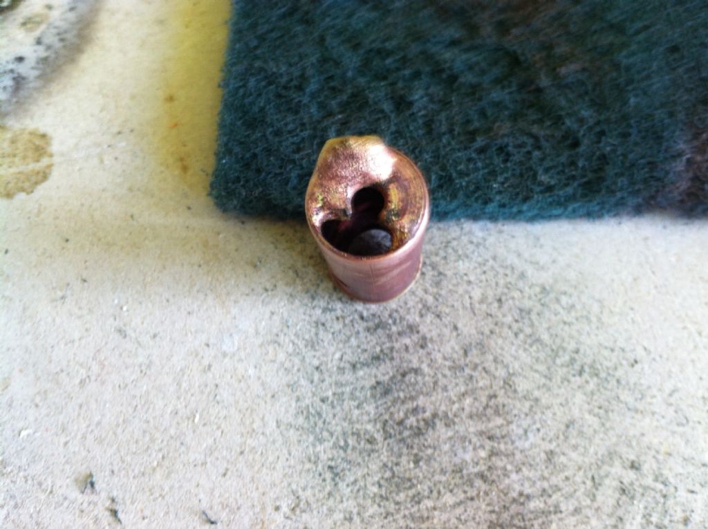

                                                  MAP gas torch borrowed.
                                                  MAP gas bought.
                                                  Fluxed up the Oiler and away we went….
                                                  Or not as the case may be!

                                                    The rest of the Boiler fittings are in Pickle at the moment and soldered as expected with Easyflo2.
