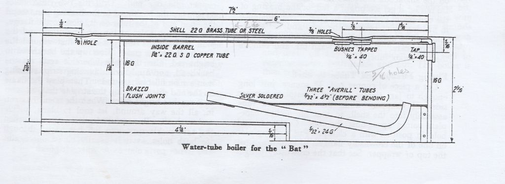

    This is the boiler Brian, fortunately I added a steam dome about halfway along inner barrel when I made it.
    He is referring to a pipe running between the inner and outer barrels so I assume external would be ok. Normally it would go through the boiler from back to front but the boiler is made and as it was a nightmare to make I at not altering it.bat-boiler.jpg
