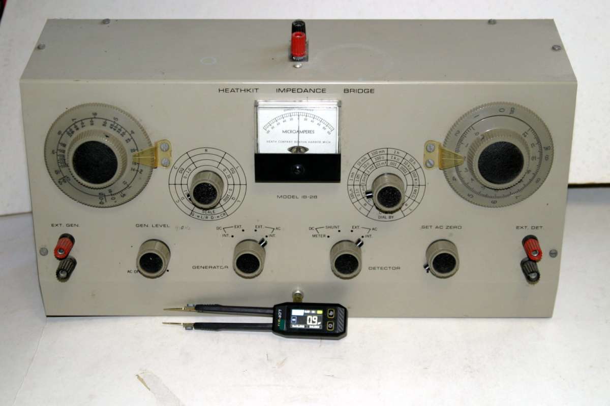

      I just treated myself to a new FNIRST LCR-ST1 LCR bridge to replace/augment my old Heathkit IB-28 impedance bridge and though a comparison of the two might be interesting.
      Q Bridge
      Q Bridge 2
      IB-28                                                         LCR-ST1
      Cost                  $131.15 1974 CAN$                                 $41.39 2025 CAN$
      Test Freq.          1000Hz (Ext. input available)                      100/1000/10,000 Hz Selectable
      Range
      Resistance         100 mohm – 1M ohm                                10 mohm – 10M ohm
      Capacitance       100 pF – 100 uF                                       1pF – 22mF
      Inductance        .1 mH – 100H                                           1uH – 10H
      D                     .002 – 1                                                   Not Specified
      Q                     .1 -1000                                                  Not Specified
      Accuracy
      Resistance        +- 3%                                                     .5% – 5% Range and test freq. dependent
      Capacitance      +- 3%                                                     .5% – 5% Range and test freq. dependent
      Inductance       +- 10%                                                   .5% – 5% Range and test freq. dependent
      D                    +-20%                                                     Not Specified
      Q                    +-20%                                                     Not Specified
      Additional Parameters
      ESR                N/A                                                          Yes
      X                    N/A                                                          Yes
      Z                    N/A                                                          Yes
      Pwr. Supply
      120 VAC 10W                                            250 mAh lithium batt.
      Recharged via USB cable
      Data Logging
      N/A                                                          All parameters for any measurement on Excel
      spread sheet downloaded via USB cable
      Some Other Comparisons
      Size            9″H x16.5″W x 6.5″D                                     1.75″H X 2.325″W x .75″D (less probes)
      Weight        11 lbs (4990 gm)                                           43.5 gm (with probes)
      Active Components
      2 x 1U4 2 x 1L4 tubes (valves)                       1000s of transistors
      1 x 1N191 germanium diode                           10,000s LEDS
      1N2071, 4 x 1N4002
      Display        2.5″sq 100-0-100 uA                                    1.025″ x .625 LED matrix display
      D’Arsonval meter
      How technology changes in a few (well 50 I guess), years.

        Amazing! It’ll be very interesting to hear how you get on with it John.
        #780032
          I do love a boat anchor!  (Heavy valve based electronics in a giant steel box!)  Waiting for the valves to warm up was part of the fun.
          Heathkit made a lot of useful hobby equipment, mostly sold in kit form, so the buyer had to assemble it himself.  Designed down to a price for the hobby market compared with much more expensive lab equipment, but usually performed well.
          Kits are double edged!  Great if you like building things, very annoying if you only it needed to measure stuff.   The ‘March of Technology’ killed Heathkit because the cost of commercial electronics kept dropping whilst complexity shot up.   My pudgy fingers can handle valve sized components but I struggle with subminiature equivalents.  Resistors so small I need a loupe to see them and if one pings out of the tweezers it will never be found.
          Another double edged feature is boat anchors require a skilled operator.  Their controls often have to be adjusted skilfully, which can be fun,  but is time-wasting compared with an automatic modern instrument.   Automatic is great until it fails on an edge case, which an old school manual might resolve with careful twiddling.
          All my boat anchors are long gone, sob.   Sad reason:  no room for them in a house full of kids and a wife with a knitting machine!
          Boat-anchor designers were remarkably clever at getting lots of functionality out of a small number of simple expensive components.  Now designers have a wide choice of dirt cheap complex components that can do much much more, but the results aren’t necessarily better!
          A tiny box kept in a drawer that just measures whatever is plugged is more convenient than a 16x9x6″ 11lb instrument that needs a skilled driver.
          If I had room, I’d collect boat-anchors, they are lovely!
          PS Sorry the forum mangled John’s comparison table.  Not his fault.  Apart from screen-shooting tables and posting the image, I’ve failed to find a way of just copying tables or programs in as text.   The forum editor deletes spaces it considers unnecessary.

            Surprised with the plethora of ridiculously cheap mini sub circuits there is a need (for Joe public) to determine LCR measurements today with the “Use and chuck” society we are now encrusted in.
            Regards  Ian.

                  Surprised … there is a need (for Joe public) to determine LCR measurements today with the “Use and chuck” society we are now encrusted in.
                  Shouldn’t be!  Electronics, embedded, computer, maker and ham radio are enormous.
                  Although traditional metalwork might be fading it’s clear other technical interests are growing.  Not clear to me where it’s going though, hobby engineering is evolving.  Don’t dismiss anything!

                                I have quite a few Heathkit units I have built over the years while they were still around, including their AR1500A HiFi receiver that I built during evenings (kept me out of the mess) in my barrack room in CFB Wainwright while flying on exercise with the army summer of 1974. It’s still going strong. My only complaint with their kits was their propensity to use house numbered semiconductors. The AR1500 has many and if one of them fails it will be a guessing game to find a replacement.
                                As far as the formatting goes I have run into this before with the old forum and hoped it would be sorted out with the new one but obviously not. When I first submitted this post I got a full screen msg. “Page Requested Not Found”, but when I checked in the topic my title was there with the addition of (awaiting moderation) added. Clicking on the topic brought up the same error msg.  About three hours later I decide to try again. But this time when I went to the topic the “awaiting moderation” was missing and clicking on it brought up my complete original post, but the option to edit it was gone!
                                So far I have used it to sort through some unmarked chip caps. Sure beats trying to use two normal probes on the multimeter.  I have checked it against some .1% resistors and capacitors I have and the readings are well withing the stated tolerances. One thing I haven’t figured out yet is if there is a way to delete items from the Excel spread sheet. It just keeps adding them, could get a little unwieldy after a while.
