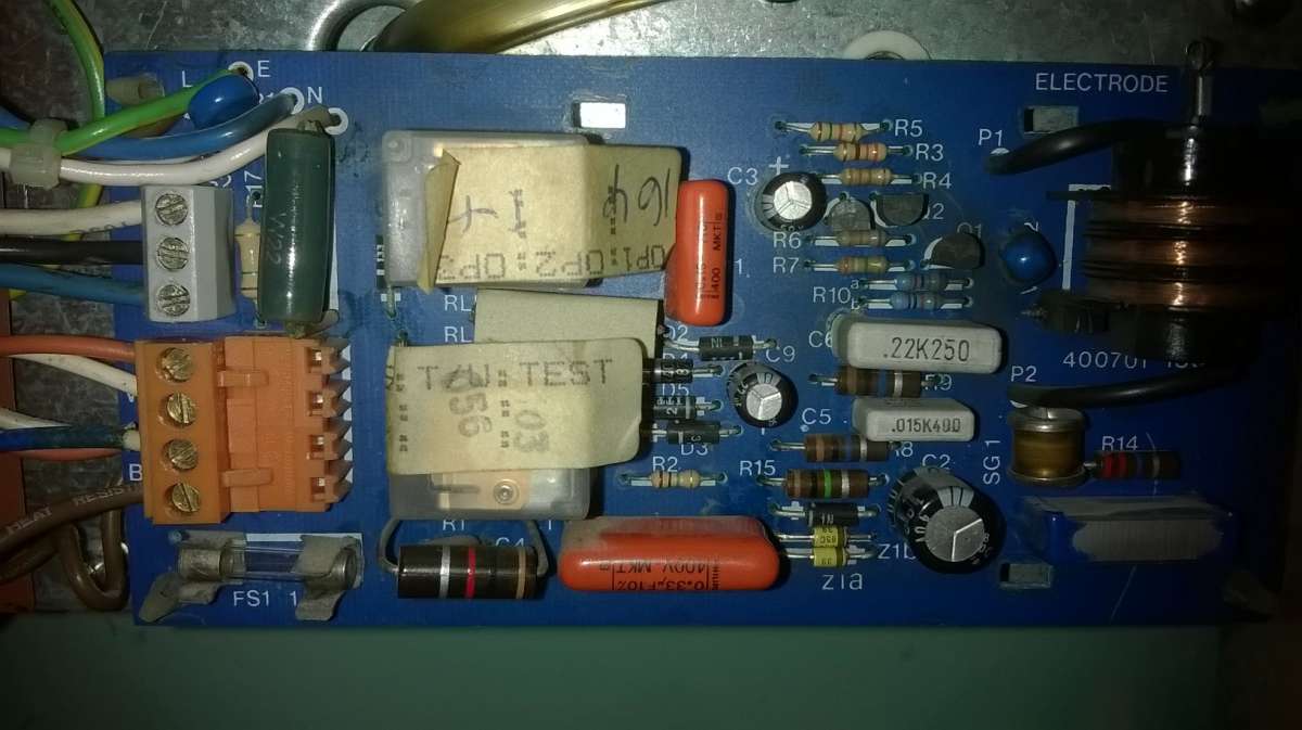

        I recovered this from the bin in the garage, a left over from boiler servicing. It is a mystery to me as to how it works. The two white electrodes are the spark igniters, but the blue one which detects the flame has only one electrical connection._igp3136.jpg
        #640512
        Robert Atkinson 2
          @robertatkinson2
          A flame is ionized and thus electrically conductive. The circuit connected to the probe detects the conductivity.

            The detector could use one of the spark electrodes as common ground. Or more likely use the burner as the other electrode. The difference in temperature could in theory form a crude diode, this would make it possible to detect short circuits and leak currents.

                  Our boiler has just a single electrode which provides the ignition spark and detects the pilot flame. Advances in electronics, I suppose – but our boiler is over 15 years old.smiley

                    I have just repaired the central heating system I recently "inherited", (and which had 6 separate faults),
                    During my investigations and fault finding; I learned that a flame is conductive and can be used to detect the presence or absence of a flame.
                    In the case of my old Potterton Netaheat 80E, nobody would give out any information, so I traced through the PCB and found that the flame sense circuit uses the ignitor probe itself to detect the flame and hold a relay over, which enables the gas valve. The ignitor is literally just a metal probe, not a thermocouple in this model.
                    I tried to find the fault on the board, but could not obtain a circuit diagram and ran out of time during the coldest part of the year so far, (isn't it always when the heating fails?), and bought a new PCB. Cost me £82.

                      Having designed gas boiler ignition controllers the flame failure detector uses the ionisation effect of a flame which acts like a diode. So an AC voltage is applied to the flame probe and the resultant DC voltage operates a transistor to allow the main burner gas valve to open. The controllers have to be designed so that a single circuit component failure will either shut down or prevent start up of a boiler.
                      Most modern domestic boilers are fan assisted so the controller first runs the fan for a time in order to clear any combustion products or gas from a previous start attempt and then tests for a change of state of the microswitch on a diaphragm air pressure sensor. If this proves OK the controller opens the pilot flame valve and begins spark ignition whilst detecting for pilot flame presence. If this is proved the controller opens the main burner gas valve and the main burner is ignited by the pilot flame. If pilot flame ignition isn't proved within something like 5 seconds the controller may immediately go to lockout and display a warning, usually a red LED, or repeat the sequence, usually no more than two times before going to lockout.
                      Older boiler designs used a continuous pilot flame which used a thermocouple to detect flame and hold the pilot gas valve open. Since this type of boiler contained no electronics the thermocouple although only producing a few millivolts could generate a reasonable amount of current. The coil of the pilot valve was just a few turns of thick wire and the valve would be opened manually to close the magnetic circuit. So the current from the thermocouple was insufficient to pull the valve in but sufficient to hold the valve open so providing fail safe control. If the thermocouple went open circuit, which was the most common failure mode, the pilot gas valve would close. An interlock within the valve block would prevent the main burner valve being opened if the pilot wasn't operated.

                          I have a Potterton Netaheat that I have been "nurturing" for three decades, and I can confidently say that the boiler control lasts for fifteen years before it needs fixing. I conducted the fix twice in the same way, and it worked both times. I do now have a spare controller which I swap in when it fails so I have time to fix the old one and keep the newer one at "low hours".
                          Like John I reverse engineered the controller, and made all those discoveries. I've included the schematic I extracted below. I never thought anyone else might benefit from it, so I never posted it.
                          The main problem is that C2, which is an electrolytic capacitor, dries out. The flame sensor circuit is very sensitive, and it depends on a smooth DC rail from the mains to work properly. When the capacitor dries out, the supply has too much ripple and the circuit can't see the tiny (around 1nA) flame current.
                          The world is going to the wall, unfortunately, as we all know. I've been looked at getting my trusty boiler working from a battery and an inverter. As we know security of power provision is looking a little feeble over the coming few years.
                          With this boiler control the flame sensor depends on an earth connection and it needs significant capacity. If you run the boiler from an inverter you will find that the flame sensor fails even though the pilot is alight. To resolve this issue when using a battery inverter you will need to do two things.
                          1) Ensure that the boiler earth is connected to the physical earth for your property.
                          2) Connect the inverter neutral output to the earth that goes to the boiler.
                          If you do these two things, then a Potterton Netaheat can operate from a battery inverter, even when there is no electrical supply to your home. In these circumstances, the law may not need to get in the way of your probable need for basic hygiene.

                            Andy, that is a brilliant and very nicely drawn circuit diagram ! Much better than my spidery and confused efforts !
                            I could have done with yours about 6 weeks ago to fix my own system, but nobody will allow that information, even though it is just electronics, and not touching the gas side at all.
                            I don't quite understand where Q1, Q2, Q3, get their other supply rail from? The mains neutral feed is one side and presumably 39V is created across C2 by Z1, but the circuit seems one legged to me ? Where is the current return path from the collector's side ? I think that is where I got confused with the circuit and was forced to give up.
                            I think your inductor, labelled (?), in series with the spark transformer primary is actually a spark gap. I think C8 charges up until it can jump the spark gap which sends a pulse through the transformer.

                              The supply to the transistors is is via diode D1. They are running from a negative supply with respect to ground. The mains neutral (connected to PNP transistor emitters) is connected to earth at the mains supply.

                                          I know this thread is over a year old but just wanted to convey my thanks to Andy Ash for the diagrams.
                                          I also have a 30+ year old Netaheat that has had occasional controller problems.
                                          Apart from the dry joints that were reflowed many years ago, one infrequent issue is with the pilot ignition.
                                          The fan starts, pressure is detected and the pilot valve operates but no spark.
                                          You can see this from the fact that the gas discharge device on the controller does not spark.
                                          The cure for me is to brush all the collected dust etc from both sides of the board around R14 and C8.
                                          I think either the gas discharge component is ageing or the dust build up is slightly conductive meaning that C8 never gets charged to the breakdown voltage. You don’t need much conductivity around a 22M resistor to make a difference.
                                          This boiler has out lived one fan, two pumps and three main controllers (one of which was a recent Wiser which went pop (literally) one morning).

                                                I agree with you, Clive, and it’s not always understood that working on boiler controls should be considered as working on the gas appliance.
                                                To your point about “fail safe” and in relation to this particular thread, I note that the design has considered two particular instances of single point of failure.
                                                Resistor R10 is presented as two parallel components as is Zener Z1.
                                                My board is version 3 and it would be interesting to know if earlier versions incorporated this.
                                                My assessment is that failure of R10 could lead to detection of a flame when there isn’t one resulting in the main burner being engaged.
                                                In my case, the fault is with the spark ignition resulting in the pilot valve being open but the pilot not ignited.
                                                There is no designed protection against this case (timeout, duplicate circuit etc).
                                                I assume that the resultant gas escape is not considered unsafe because the fan is running and forcing the limited unburnt fuel out of the boiler.
                                                By extension, it can therefore be assumed that the ignition circuit is not a safely critical area and thus can be worked on by DIY ‘specialists’.
                                                WP_20160720_004
                                                  That’s two ‘assumes’ both of which could be wrong!   Years ago I did a full course on the danger of assumptions,  where the point was rammed home by telling us to always render ‘assume’ as ‘Ass of You and Me’.   Anyone stating an assumption was sent away to clarify it, either by confirming the assumption was a fact, or, if that was impossible, by recognising it as risk.   Risks are managed, whereas the failure of an assumption comes as a surprise.  Also told to be suspicious of ‘facts’, because humans often confuse them with opinions, beliefs, misunderstandings, folklore, fake news, and lazy jumping to conclusions.  Many things claimed to be facts are assumptions.
                                                  Here’s another likely assumption.  When eeeps boiler was designed, it was for a given service life, after which it was expected to be replaced.   The service life is governed by wear and tear on the mechanicals,  corrosion, ageing of the electronics, condition of the burner, cost-cutting compromises and other characteristics of the system.    Likely a commercial boiler is safe only on the likelihood that  it will be replaced as soon as the cost of a commercial repair is uneconomic.   All bets are off in the very unusual event that an increasing risky boiler will be kept going well beyond it’s service life with patch repairs.
                                                  Another consideration is efficiency.  Old boilers weren’t particularly efficient when new, and efficiency tends to decline with age.   Given the ever rising cost of gas, it’s likely that eeep would have saved money by fitting a modern boiler 15 years ago…
                                                  Keeping stuff going by repair and restoration is great,  but keep an eye on the big picture.    As a whole, is the device being mended still safe?  Is the work worthwhile.   With something like a Myford lathe the answer is almost certainly yes. A 30 year old gas boiler is in a different league: Carbon Monoxide is extremely poisonous;  there’s a serious gas leak and explosion risk;   the control system is moderately complex, and includes safety critical factors.  This is all in addition to the usual plumbing and electrical hazards.
                                                  #739783
                                                  Clive Steer
                                                    @clivesteer55943
                                                    eeeps assessment that the ignition circuit is not part of the “safety” circuit is correct. So replacing the gas discharge device in the ignition circuit is low risk. If the wrong device is fitted the spark rate may become faster or slower resulting in less reliable ignition but shouldn’t affect safety.
                                                    At the time, 1985, when I designed a boiler controller a British Gas technician, working for their approvals section would take our product, unsolder every component and reconnect it using tinned copper wire “stalks”. They would then open or short every component in turn and note the circuit reaction whilst it was operational and also when starting from cold. The reaction they were looking for was that the boiler would shut down and restart would not be possible. This only applied to the “safety” section of the overall design.
                                                    All electronic and electro-mechanical components had various failure mode classifications. For instance a metal film resistor could fail O/C but regarded as not able to fail S/C. However a wire wound or solid carbon resistor could fail O/C or S/C. This failure mode also applied to capacitors, inductors or semi-conductors such as diodes and transistors. Relays were largely regarded as fail safe provided any possibility of welded contacts or arc over were addressed by using an appropriate safety margin. In one design I saw a special feature of a relay was used to provide safety. In the circuit the relay, which controlled the main gas valve could be held by the flame sensing circuit but the circuit couldn’t provide sufficient current to pull the relay in. Basically the relay, which looked like many others, had a larger gap than normal between the moving pole-piece that operates the contacts and the main coil pole-piece. A subtle but critical difference and I’m sure other controllers used similar tricks or novel arrangements to achieve a safe but cheap and reliable product.
                                                    CS
                                                    #739785
                                                    Robert Atkinson 2
                                                      @robertatkinson2
                                                      A lot of points covered in this revival
                                                      1/ it is interesting that unlike certain electrical work (part P), gas work does not require any notification. This means there is no record of the work.
                                                      2/ One ssue not mentioned if you DIY and something goes wrong is that your insurance may be invalidated.
                                                      3/ The spark gap breakdown voltage may increase with age due to a number of mechanisims. These include electrode erosion and decay of any radioactive material that is sometimes added to stabilise the the breakdown.
                                                      4/ I agree with Clive on parts subsitution. You don’t know the full reasons for component selection especially safety components. As an example I once designed a controller for a set of 3 halogen lamps (used for a non-lighting application). The mains power was switchd by a relay. As many will know filament lamps have a high initial (inrush) current. Having 3 halogen lamps in parallel does not help. I selected a particular version of a standard size relay. This had siver cadmium contacts specifically designed for lamp loads (today I’d use a solid state relay) and cost about three times a standard model. The only difference was one letter in the part number and a amber rather than clear cover. It was a standard part of many of the products the company made. The PCBs where assembled in house. As there was a relay and software (PIC) control I included a thermal switch on the lamp housing to prevent overheating in the case of failure. After a couple of years we got a few failures on new machines. The first were fixed by the field service technicians but when they failed again I was asked to look. As soon as I saw the PCB the problem was revealed, the relay had a clear cover. Production had decided to do a component cost review and decided to fit the “identical” cheaper relay.  The subsequent rework and replacement programme, we had machines all over the world, cost a lot more than the saving on relays.
                                                      The use of two components when one would give the same nominal “headline” value can be for a number of reasons including increasing a secondary parameter such s power or voltage or for reliability / safety / regulatory reasons. For the latter three you can’t tell by looking at the component datasheet. Only the designer knows for sure. Even fitting a “better” component can affect them.
                                                      Again a practical example. Forty years ago I designed a conditioning circuit for an aircraft fuel gauging system. As it had a connection inside the fuel tank it had to meet fuel tank non-ignition / intrinsic safety requirements. Normally compliance would be shown by testing but test house availblity and first flight dates did not align. So I suggested showing compliance by design and analysis to a (non-aviation) intrinsic safety standard. Much to the surprise of the “old hands” the regulator acceped this approach. The circuit ran off 28VDC and the input circuit was a small fuse followed by a 33 Ohm power resistor and a 36V 10W zener diode (spike supression). At a nominal supply voltage of 28V even a short circuit of the diode would only result in 0.85 amps flowing. However the fuse was rated at 3.15A. The circuit also had two resistors in series with the connection to the fuel tank each would limit the current to less than the minimun ignition current. Two were required to meet the requirement that no two failures could cause excess current to flow (there is a lot more detail to this). All went well and the aircraft was certified. A few years later, after I’d left the company (it had changed ownership) they contacted me to ask for a change to the fuel gauge calibration as they had changed the wing structure. I said OK but needed a spare conditioner and the test box to validate the change. When I opened the conditioner I noticed that it had a 0.5A glass fuse fitted. On questioning they said their sub-contract assembly house for the conditioner had noticed that the 3.15A fuse would not open even on a short circuit and the unit only drew 0.25A they suggested a change to 0.5A. They obviously had not been given the safety analysis. The only reason for the fuse was to meet a requirement in the intrinsic safety standard for a “sand filled ceramic bodied” fuse approved to a specific standard. The lowest rating allowed by that standard was 3.15A so I had to use that. By changing it they had technically broken the safety of the system. In reality the system was safe, the specific fuse was required becuase the non-aircraft standard considered that the DC supply might be accidentally connected to the high energy 240V mains supply. Obviously this does not exist on the aircraft. The aircraft in question was the NAC-6 FieldMaster / FireMaster.
                                                      Robert.
