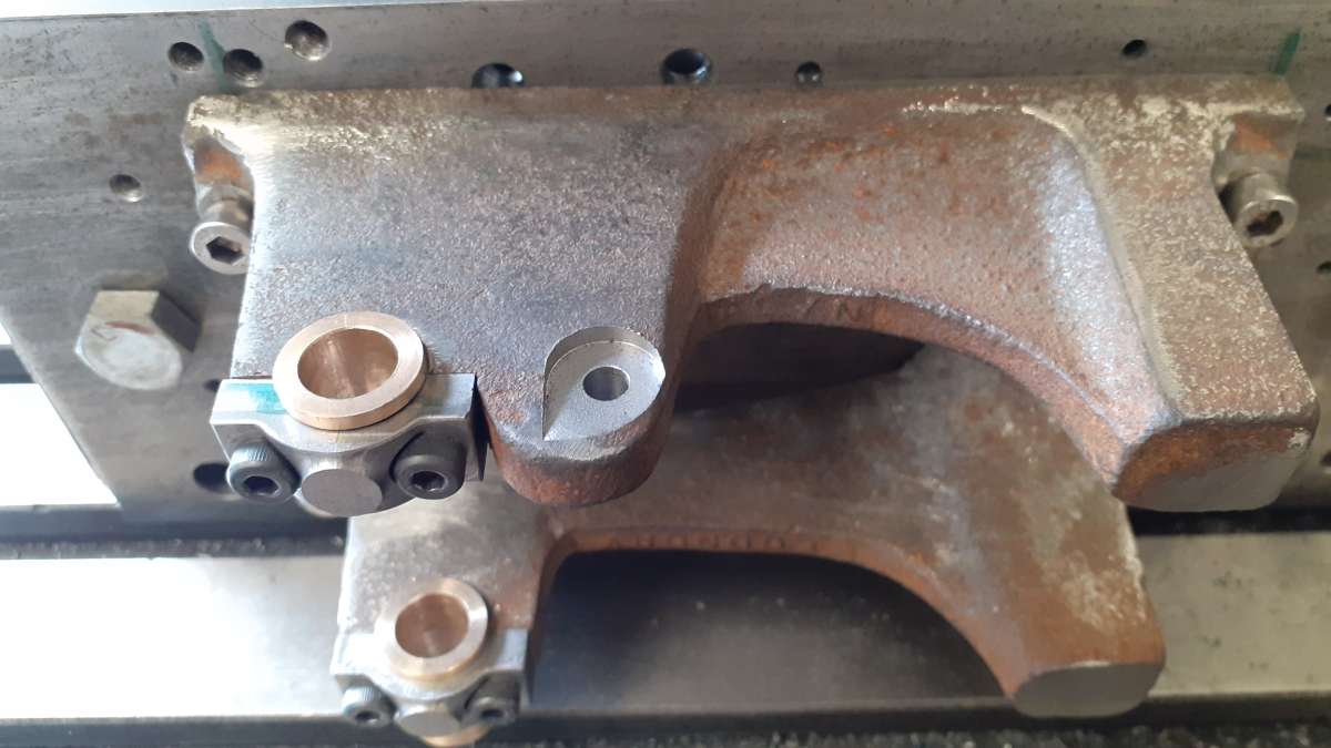

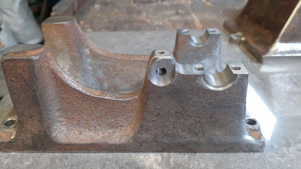

                                      Before machining the main crankcase casting of the RLE it is worth getting the bearing caps ready. These are supplied as one so after a skim cut to flatten the bottom and then the ends with the now flat bottom against the vice fixed jaw the casting can be cut in two. Well actually you can cut it into three as there is plenty of length and it's quicker to saw away a waste piece than turn it into chips.
                                      I can see how Graham made the pattern many moons ago simply by gluing a piece of half round timber moulding onto a flat piece and adding a bit of draft around the edges. This gives the profile shown top right in the following photo and if we assume the radius of the "hump" is where the green sharpie mark is then most of the material needs to come off the bottom which combined with a bit of flattening of the hump results in the section shown top left. I went a bit further and used the excess height of the hump to provide enough material to form a boss that can later be drilled and tapped for an oil pot – middle bottom. Clearance hole scan be drilled and spot faced so the caps are ready for when they are needed.
                                      The crankcase was shimmed up on the mill table to get it to sit nice and level and not be distorted by clamping pressure and the facemill used to flatten it's bottom. Now that I had a solid surface it could be set up on the table with some parallel packing below and set to get the best centre line of the casting in line with the mill's X-axis. I started out buy locating the four hold down bolt holes so they sat reasonably central to the cast bosses noting their positions on the DRO before spot facing to give the nuts a good surface to tighten down onto.
                                      Next the vertical face that the cylinder flange mates to was squared up, just taking off the bare minimum at the top and down low enough that the flange clears the step left by machining away the draft angle. I later blended that small step in to leave a smooth fillet where the vertical meets the horizontal as I'm fussy like that..
                                      Moving to the other end of the casting the bearing split line was milled down to the required 41mm above the bottom of the base and the stud holes drilled and tapped M4. You can see in the photo that I'm using a spiral flute tap, I've almost gone over to these exclusively as they cut well, clean out the swarf as they go and it means you only need to tap once not two or three times as you do with the usual set of three taps.
                                      For the following operations I like to use a machining plate as it gives good flat surfaces that you can run a DTI against when setting up the irregular shaped casting and also gives a good surface to clamp down.
                                      Here I have clocked the long edge of my well used machining plate true along the mill's X-axis, located that edge and established my ctr line a known distance from it (50mm in this case) and then using the previously noted DRO positions drilled and tapped so the casting can be screwed to the plate. The bearing caps were then screwed into place ready for boring.
                                      Knowing the exact lathe ctr height above my cross slide and the thickness of the plate it was simple to work out how much packing was needed to bring the bearing split line upto ctr height, clock the edge of the plate true across the lathe and then start machining. First I used a 16mm 4-flute cutter to produce a flat edge by machining away the draft on the base and stopping just as the cutter touched the bearing cap. I followed up with a 6mm ctr cutting 3-flute cutter to remove the pip left by the conventional non ctr cutting endmill.
                                      This flat surface could then be spot drilled followed by a 6mm stub drill and then the far end was done with long series ctr and 6mm drills. Following that a spot facer I had made for a previous engine was used to flatten the remaining three faces.
                                      I could then drill out 10mm followed by reaming size for 12mm. If you want to take the option of having the crankshaft run in the cast iron then just drill to 9.7mm and then ream 10mm
                                      A machine reamer was used to finish the holes to 12mm ready to accept the bearings.
                                      That's enough for one night, next time the crankcase can be completed and these three main castings brought together. In the meantime a quick vid of the drilling and boring on the lathe and no the reamer is not going backwards!

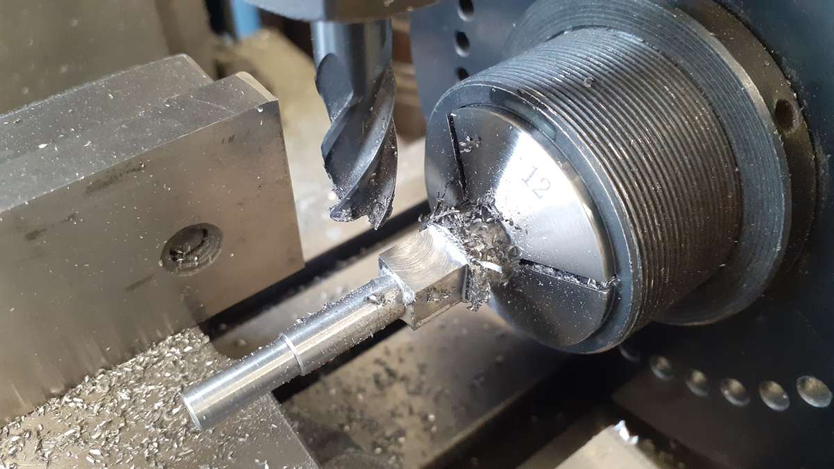

                                                The spigot on the bottom of the carb takes a non return valve that sits just off the bottom of the fuel tank. This is a fairly simple turning/milling job from a piece of brass stock I started by turning down one end of some bar to 8mm dia and threading M8 x 1 then drilled a cavity for the ball that acts as the valve. Next I milled a 10mm AF hex.
                                                Now holding by the 8mm diameter the other end was turned and tapped so it could be screwed into the carb body and a small hole drilled to receive the end of the needle
                                                The cap that goes onto the end of the M8 thread to retain the ball was turned and bored with a generous undercut to ensure the threads screwed all the way home.
                                                The final part was the needle which was turned, threaded and knurled from some 303 stainless.

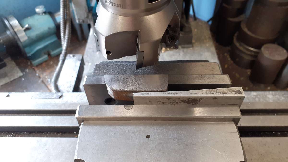

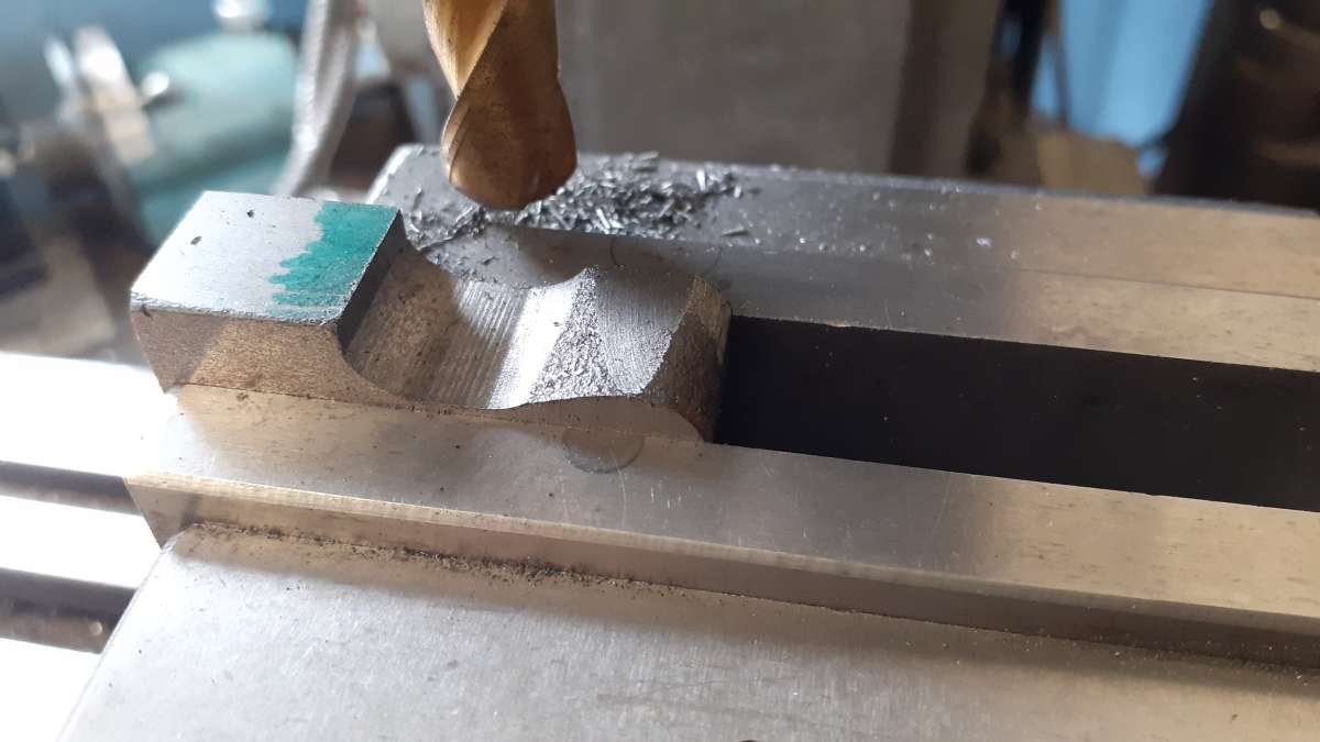

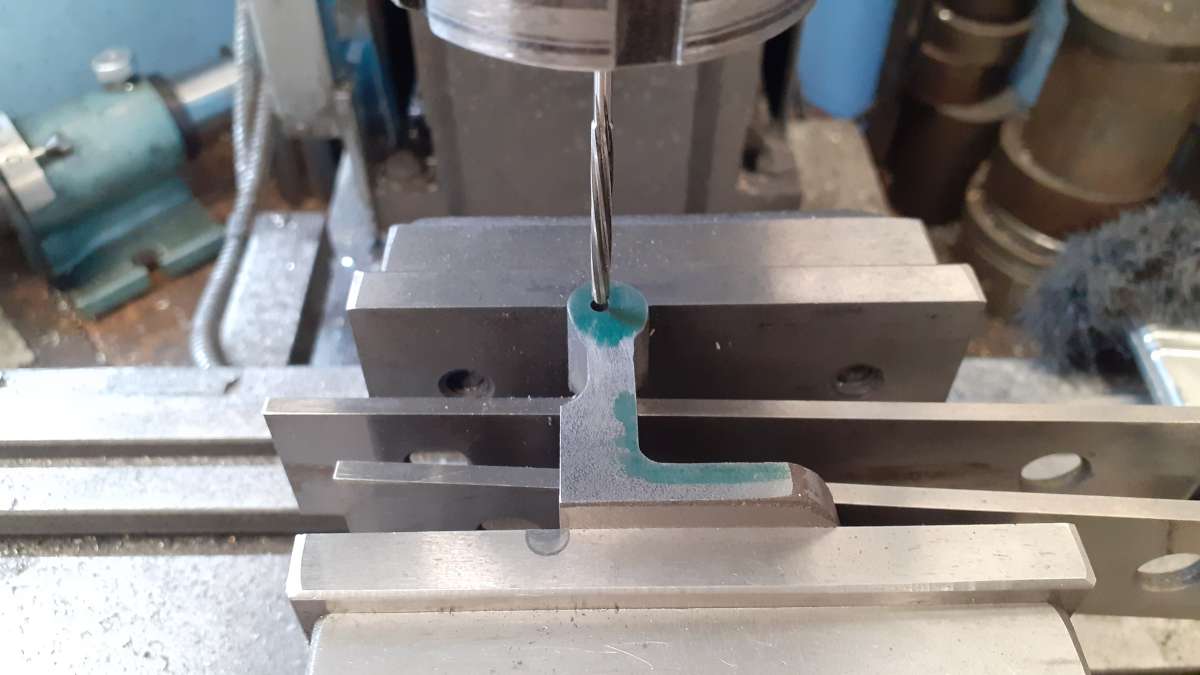

                                                  It’s about time I wrote up a bit more of this engine build.

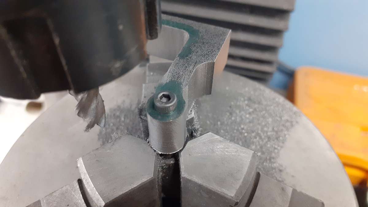

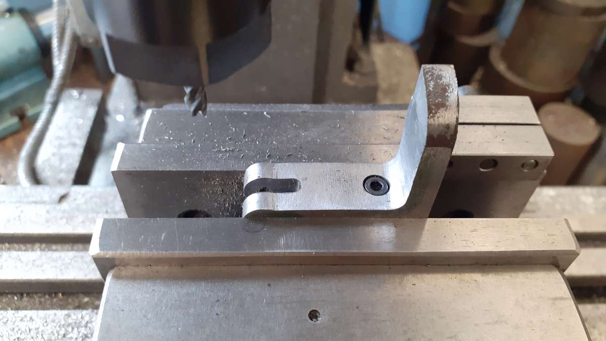

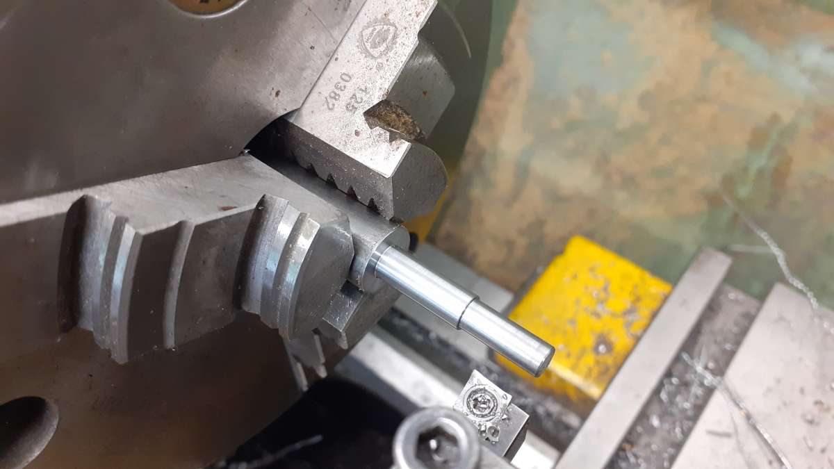

                                                  With a view to getting the gearing done I made the cam gear post first. Starting with some stock that wa slarge enough to get the rectangular head out of I turned two diameters, the larger for the gear to run on and the smaller to go into the hole in the engine frame.
                                                  20230701_091135

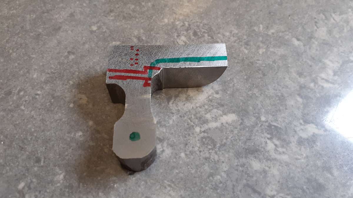

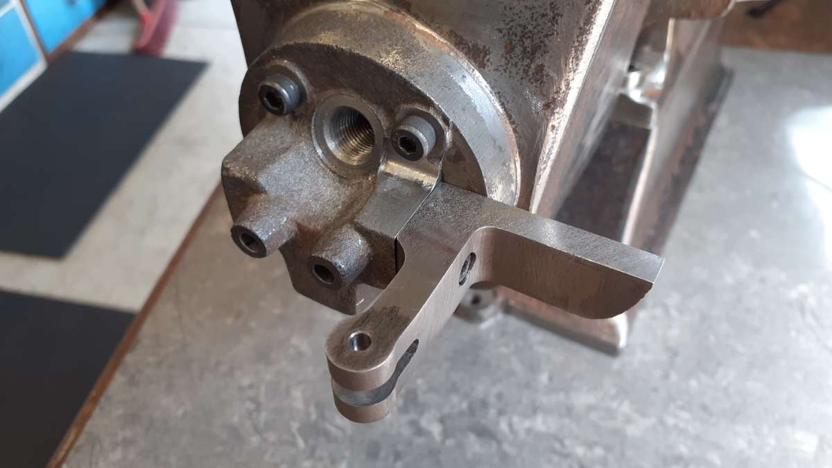

                                                  Then into the spin indexer to shape the clevis.
                                                  20230701_092147
                                                  After reaming the pivot pin hole and milling a flat on the spigot the clevis was slotted for the latch and then rounded over
                                                  20230715_111549

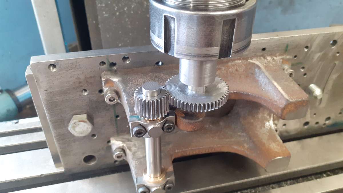

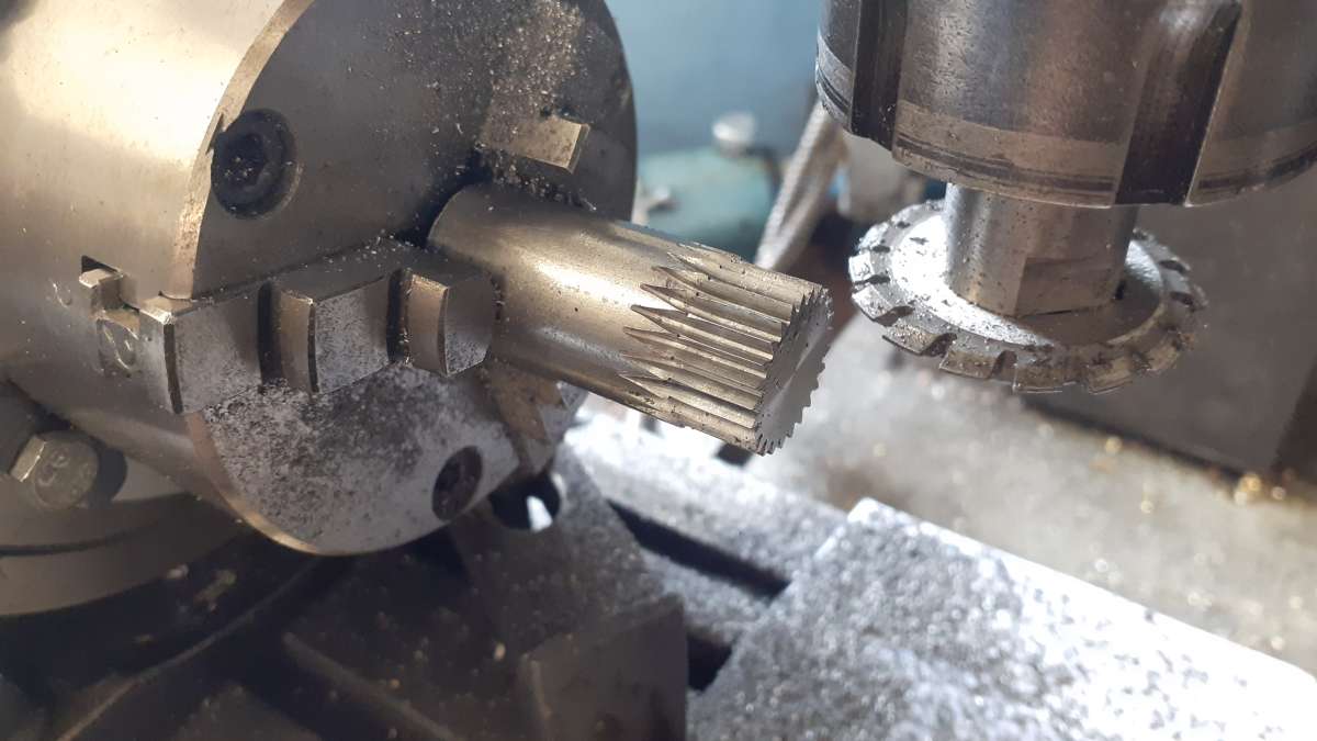

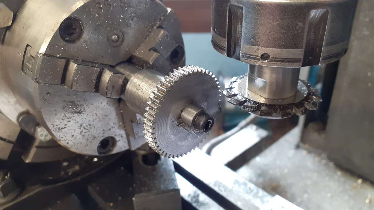

                                                  I spent some time working out different combinations of metric gear size and numbers of teeth and in the end settled on a 50/25T combination using MOD0.7 which are available online for those that want to buy or cutters can be bought quite cheaply.
                                                  I started by roughing out a blank for the cam gear and then machined the cam profile which I made with a little less lift to suit the lever lengths of the newer head layout that has the exhaust valve further from the rocker arm pivot
                                                  20230701_134901
                                                  Then with the gear blank mounted on an arbor set about cutting the teeth using the rotary table with dividing plates
                                                  20230709_102416
                                                  The 25T crankshaft gear was cut in a similar way except I did it on the end of a bar before reaming and parting off once the teeth were done.
                                                  20230709_133325
                                                  I like to set the gear positions using the actual gears so with a temporary crank shaft in place the small gear was slipped onto that and the larger gear on an arbor held in the mill’s collet chuck and the running fit and backlash adjusted by moving the engine’s frame in the X axis. Once happy the DRO was zeroed.
                                                  20230709_141129
                                                  After which a flat was milled and a hole drilled and reamed
                                                  20230709_142403
                                                  The MOD0.7 25/50 combination has a slightly larger PCD than the original design’s 1″ which put the hole a bit out of ctr to the cast lug.
                                                  20230715_082310
                                                  A bit of milling and filing soon had that sorted out and a hole drilled and tapped for the screw that retains the cam gear post.
                                                  20230715_085444

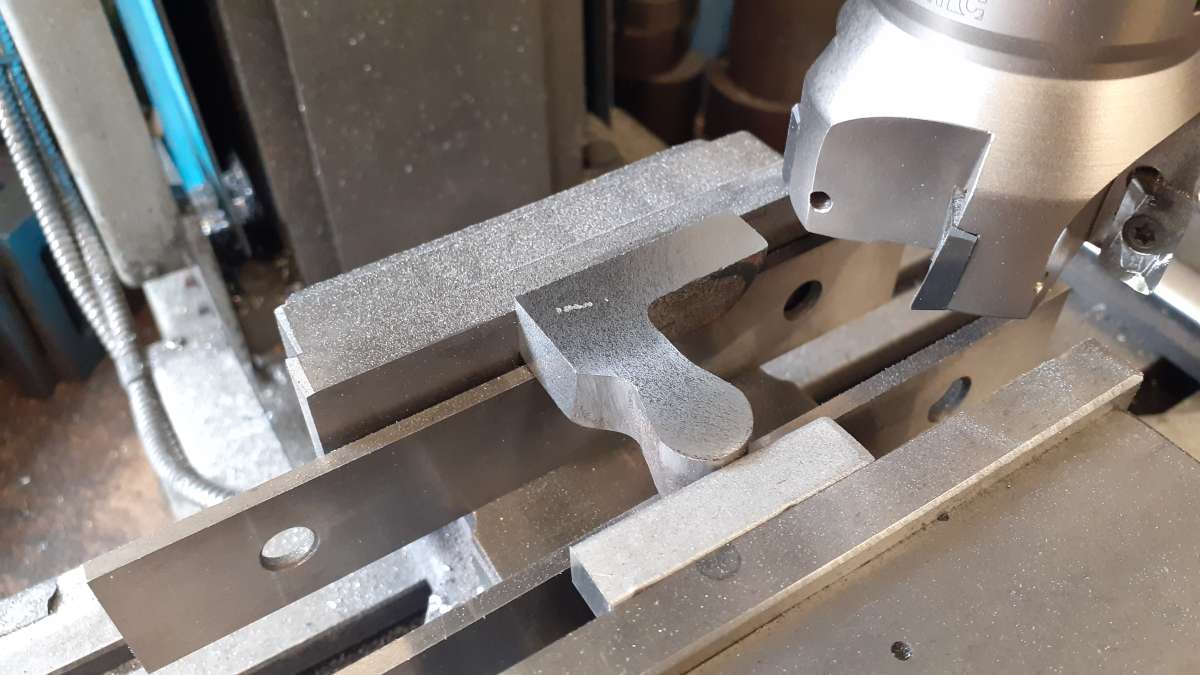

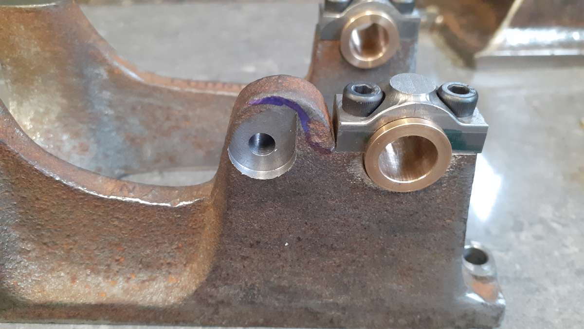

                                                    The rocker arm pivot is supplied as a casting but if used for the reversed valve layout does not put the pivot very centrally in the rocker arm so I spent a while studying the casting and working out a cunning plan that would still allow the casting to be used but shift the pivot point nearer to the valve.
                                                    The first job was to just take enough off the casting to remove the draft angles on the two edges that will mount to the head and also set these at 90 degrees to each other so I had a datum to work with.
                                                    20230722_091635
                                                    20230722_092055
                                                    I also skimmed the draft off around the pivot so that I could get a decent grip of the casting to bring it to thickness.
                                                    20230722_093132
                                                    20230722_093716
                                                    The casting was offered up to the head and a line scribed to mark where the mating area stopped and a ball nosed cutter used to tidy up that area to the line
                                                    20230722_095127
                                                    Then it was out with the Sharpies to refine the shape, I left as much material as possible on the face that was machined earlier which moved the pivot point further from the head so the green pen marks where the opposite edge needs the excess material removed and the red shows where the screws will go to mount it to the head.
                                                    20230722_113455
                                                    Drilling and reaming 3mm for the pivot pin
                                                    20230722_134100
                                                    Then rounding around the pin hole on the rotary table
                                                    20230722_142013
                                                    Last bit of machining for now was the slot for the rocker arm.
                                                    20230722_145454
                                                    Finally the bracket in place, I have removed a bit of material from the head so it matches the depth of the bracket. After test running it will be bonded on and filleted with JB Weld so that it looks like an integral part of the head casting. Edges will also be eased to make it look like a casting. There is still work to be done where the push rod goes but more of that later
