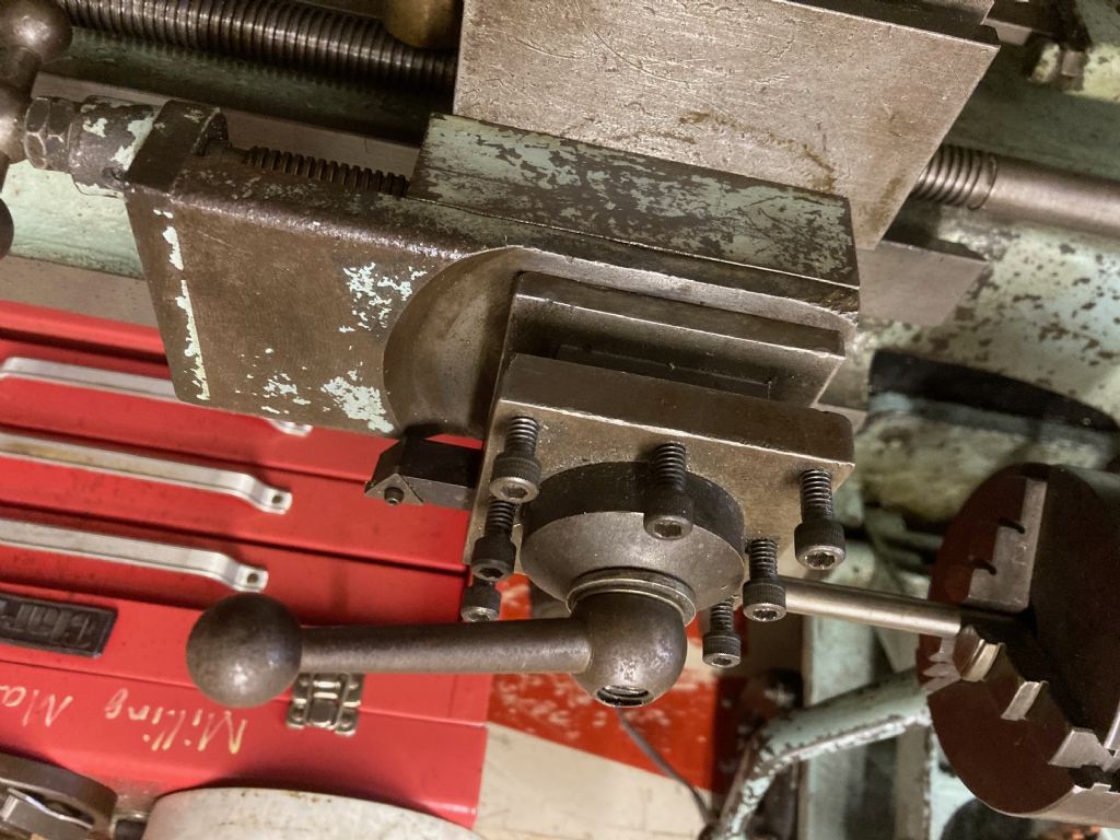

      Having recently bought a 1946 Myford M a few questions have come up, both general to the model and specific to my machine. I had a look through the forum but can't find answers to these particular ones, so, bearing in mind I am a novice, here goes:
      The toolpost arrangement seems odd. I have both the clamp-on type and the 4-way post which are designed to take tooling of up to about half an inch, but the centre height seems too high as anything over about 5/16" (8mm) toolling falls well above the minimum adjustment for centre height. Is there a reason for this? It would also be very convenient to fit a quick-change toolpost to get the height adjustment set up without shims. I am aware of the modification by removing the original cast-in toolpost but has anyone successfully bored out a quick-change toolpost to fit the 1-1/4" original post? I know most are hardened and hence difficult to do this with, but annealing case hardening is possible, or there is an unhardened one from Chronos. Has it been done?
      Whilst wear appears acceptable in most parts, I do have a lot of wear in the half nut with over half a turn of backlash. I have seen the bobbin-type repair approach but am not yet confident enough to attempt that level of work. Has anyone made these for sale? I also have some adjustments to make as there is a bit of end float in the headstock spindle – I have read the instructions (and the notes on adding/changing various bearings) but I can't claim to fully understand the pros and cons of the various approaches. It looks like the starting point is to obtain a suitably sized C-spanner to slacken the bronze collars, but I can't see any castellated nuts?
      I definitely have a missing oiler on the front end of the headstock and my understanding is that since this also serves to lock the bearing and spread it slightly, simply dropping oil down the hole is not a suitable substitute. Any ideas on where to find a suitable oiler or, better still, to find a drip oiler? I can get simple oil cups from RDG but don't actually know what the thread is?
      The whole machine has a wobble. Whilst everything runs true relative to its own reference, the wobble makes it difficult to check what is happening whilst turning. It seems to trace back to the motor – this has the bench-mounted counter-shaft/motor unit so whilst the motor pivots semi-independently, the whole assembly has some degree of coupling to the bed, both through being bolted to the bench and through the tensioning bar. The motor is a Brook Crompton and probably contemporary to the lathe. Any ideas why I am getting a wobble or how to stop it?
      I have a reasonable amount of equipment with it, certainly everything needed for now, but there are a few things which would be useful to add at some point down the line so am keeping an eye out for the original slimline 4-jaw chuck and a faceplate so that I can swing larger items in the gap. The two which are unlikely to turn up are a reverse tumbler and a milling slide. I therefore wondered whether anyone had successfully used these parts from an ML7 and if there were any issues in doing so? It appears that the ML7 slide should be a drop-on fit to the cross-slide (removing the top-slide and accepting that linear movement will need to be on the leadscrew). The ML7 reverse tumbler appears to be easily available and fairly cheap – can it be adapted?
      Finally, and somewhat trivial, but what colour should it be? Mine is currently Myford 'aqua' and I have seen a few others for sale in that colour, but it has certainly been repainted, The fixed and travelling steadies (which of course may not have originally been with this machine) have not been repainted and are a sort of murky brown/green/grey, similar to that shown on this page on lathes.co.uk – http://www.lathes.co.uk/drummond-m-type-post-1924/page2.html (see particularly the close-up of the headstock). However, this does not appear to be a recognised colour for Myford, as in Paragon don't list it, so does anyone have any idea what it is and if that would be correct? I don't plan a major rebuild but some parts would benefit from a clean and paint to keep the rust off, so since I will need to buy some paint I might as well get the right colour from the start.

          Hi Alec
          Sounds like your 4-way toolpost is off another machine and the metal under the tool is too thick,causing the toolbit to sit up too high. Pics of what you have there would help. The original Norman clamping type tool holder should hold 1/2" tool bits at centre height no problem. I would not chop the pillar off the topslide to fit a QC toolpost. Learn to use the others first and get to know the machine. Nothing wrong with using shims on a four way. It's all I do on my M-Type and my ML7.
          From memory the oiler bolt is about 5/16 BSW, with the end machined to a point that fits into the bearing wedge. Bolt has a square head and a hole through the middle for the oil. I made adaptors and soldered them onto mine so I could screw drip oilers into the adaptor.
          The C spanner fits onto the slots machined around the circumfrence of the round bronze rings that screw on to the front of the bearing.
          Wobble couuld be caused by old hardened V belts that have "taken a set" from standing for years.
          Colour, not sure. Drummonds were black originally. Myford may have changed that to war surplus battleship grey like the ML7 when they took over making the M-Type. I don't know.
          There is a good drummondlathe group at groups.io with a lot of knowledgeable and helpful M-type owners there. The Files section has a lot of good info in it. Also a Facebook page on Drummond lathes I believe.
          ML7 four jaw chuck could be adapted by bolting to an M-type back plate, which used to be available from lathes.co.uk some years back, but not sure these days.
          ML7 cross slide and tumbler reverse and just about everything else will not fit on an M-type. Totally different design and the M-Type was a lot heavier built. Tumbler reverse castings and gears and other such accessory castings are available at times through the groups.io Drummondlathe group. But it is not something that is necessary. Myford vertical slide will fit. T slot spacing is different but you can use one T bolt and one clamp etc.

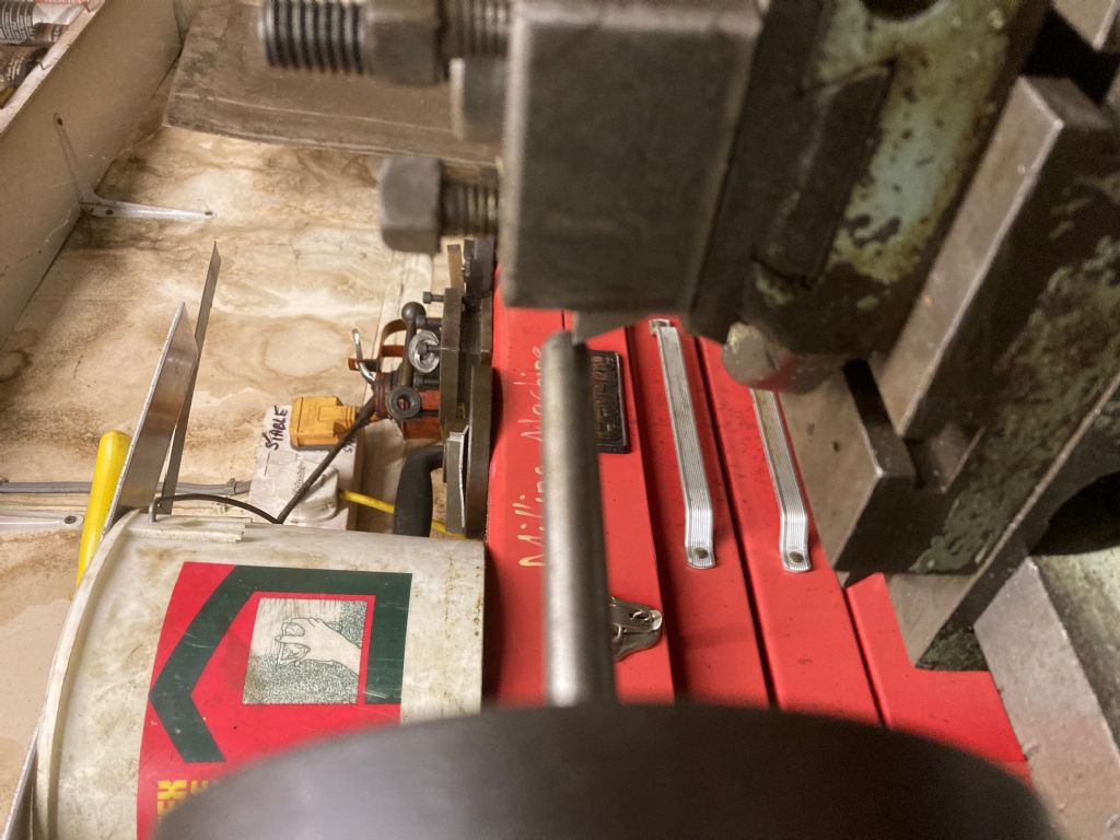

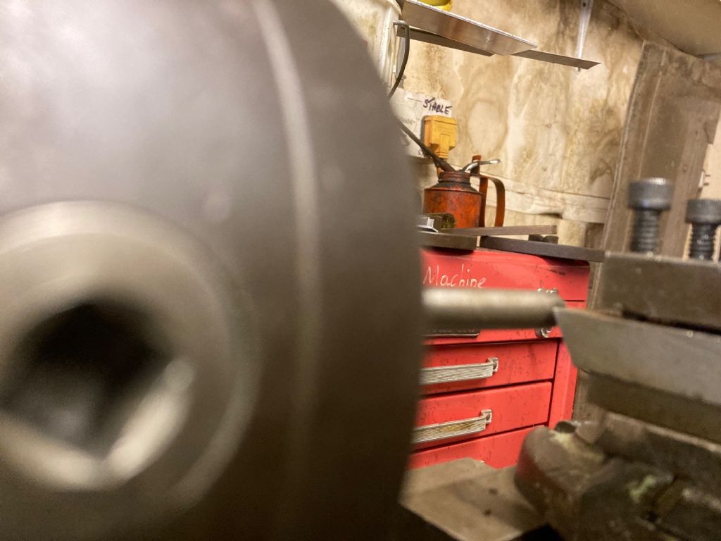

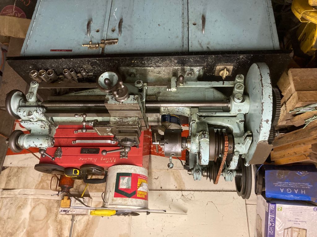

              Following your comments I had another look and observed that the Norman tool holder does indeed hold 1/2" tools at exactly the right centre height. The 4-way toolpost is about 1/16" too thick on the base which lifts it just above centre, so skimming the base off would be the easiest option (once I have a suitable faceplate or chuck). You can still get suitable M-type back plates but they extend the length of the chuck which reduces the capacity to use the swing so I will hang on until something correct turns up. I can just use a faceplate for now once I find a suitable one.
              Through a process of disconnecting belts in turn it is definitely either the motor to counter shaft V-belt or the counter shaft itself which is causing the wobble. The belt does not show any signs of having a set but it is the easiest option to try to eliminate as a cause so I will buy a replacement once I have worked out what I need.
              I won't be cutting the cast in toolpost off, but I do need some form of more rapid tool changing solution as a lot of what I want to do is repeat sequences of cutting, e.g. for nuts and studs. I don't want to have to keep swapping out the tool every couple of minutes on the Norman tool holder. A modern quick-change tool holder that I can bore out the centre on to a suitable size would be the obvious solution.
              The oiler appears to be more of an issue than I first thought. I can't see any sign of anything down the chuck end hole, suggesting that something has rotated in there. It is still free and smooth so hopefully not too much damage, but it does mean I now need to work out how to dismantle the headstock far enough to see what's going on.
              I have had a look on the drummond.io site and that looks very useful.
              I did attempt to add pictures but somehow between my laptop and the album on here they have turned upside down, so until I know how to reverse that I won't risk cricking anyone's neck by adding them to a post!
              Alec
              #603067
                Alec, once a photo is in the album you can't rotate them. It's annoying but the only reliable way is to make sure they're the right way up by checking on your computer with a photo-editor before uploading.
                However, moderators can twirl them in a post, and if I see any and aren't in a rush, I'll fix them. The 'not in a rush' caveat is because rotating photos sometimes messes up the format of the post and the thread it's in, and this takes much longer to fix.
                Anyway, for the delectation of Myford/Drummond fans around the world, here are Alec's lathe photos:

                  Thanks Dave, help appreciated, and I am sure there are many Drummond/Myford fans who will be delighted!
                  It's odd as they appear the right way up on my computer but reverse as soon as they reach the folder. Maybe I should try taking my photos upside down…

                          Your 4 way toolpost looks about the same as the one I made for mine. It takes 3/8 square tooling right on centre height. Works well. Although, I use a lot of 1/4 and 5/16 HSS anyway. Cheaper and quicker to grind up than the bigger stuff. I found carbide insert tooling does not work that well on my M-Type. Partly because the spindle seems a bit small and not rigid enough for the heavier cuts the carbide can take, and partly because mine is flat belt that slips under heavy cuts with carbide. Yet it will take 100 thou cuts with HSS no problem.
