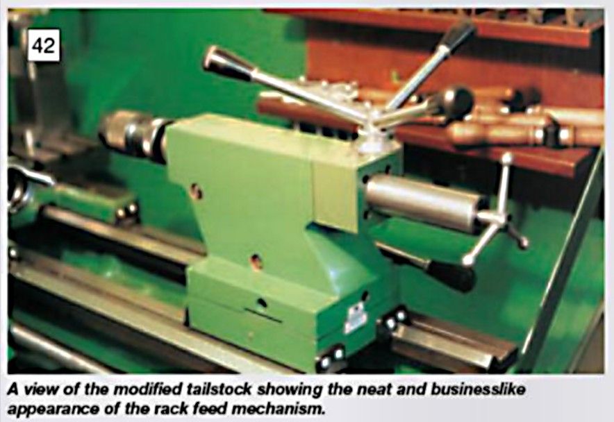

Both designs could be adapted to other lathes, Anthony Mount’s series on the Warco BH600 in ME featured a rack-feed tailstock modification, starting in issue 4207. On a smaller scale there’s also an excellent article on a rack feed tailstock for the Unimat (which could be scaled up) in issue 178 of MEW by Mr Rhodes.
Anthony Mount’s Rack Tailstock for the Warco BH600
![](/wp-content/uploads/sites/4/images/article_images_month/2014-08/tailstock.jpg)
