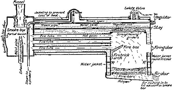

I have included a cross-sectional drawing representative of a full size, 19th Century locomotive boiler with a conventional locomotive firebox. The firebox crown is shown above the label ‘Strengthening girders’.
Model locomotive boilers are broadly similar in layout with some notable exceptions:
  • The firebox is generally too small to contain a brick arch.
  • Many boilers have stays connecting the outer firebox to the inner firebox crown, above the label ‘Strengthening girders’
  • Many models and more modern full sized locomotives are fitted with a superheater, whereas this boiler supplies saturated steam to the cylinders.
Steam is said to be saturated when it is at the same temperature as the water from which it evaporated; superheated steam has been heated to a higher temperature away from the source water.
